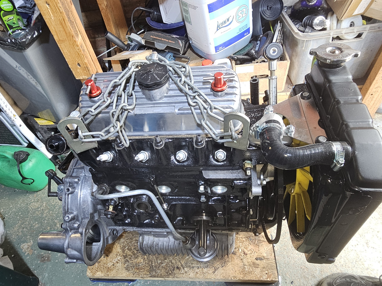

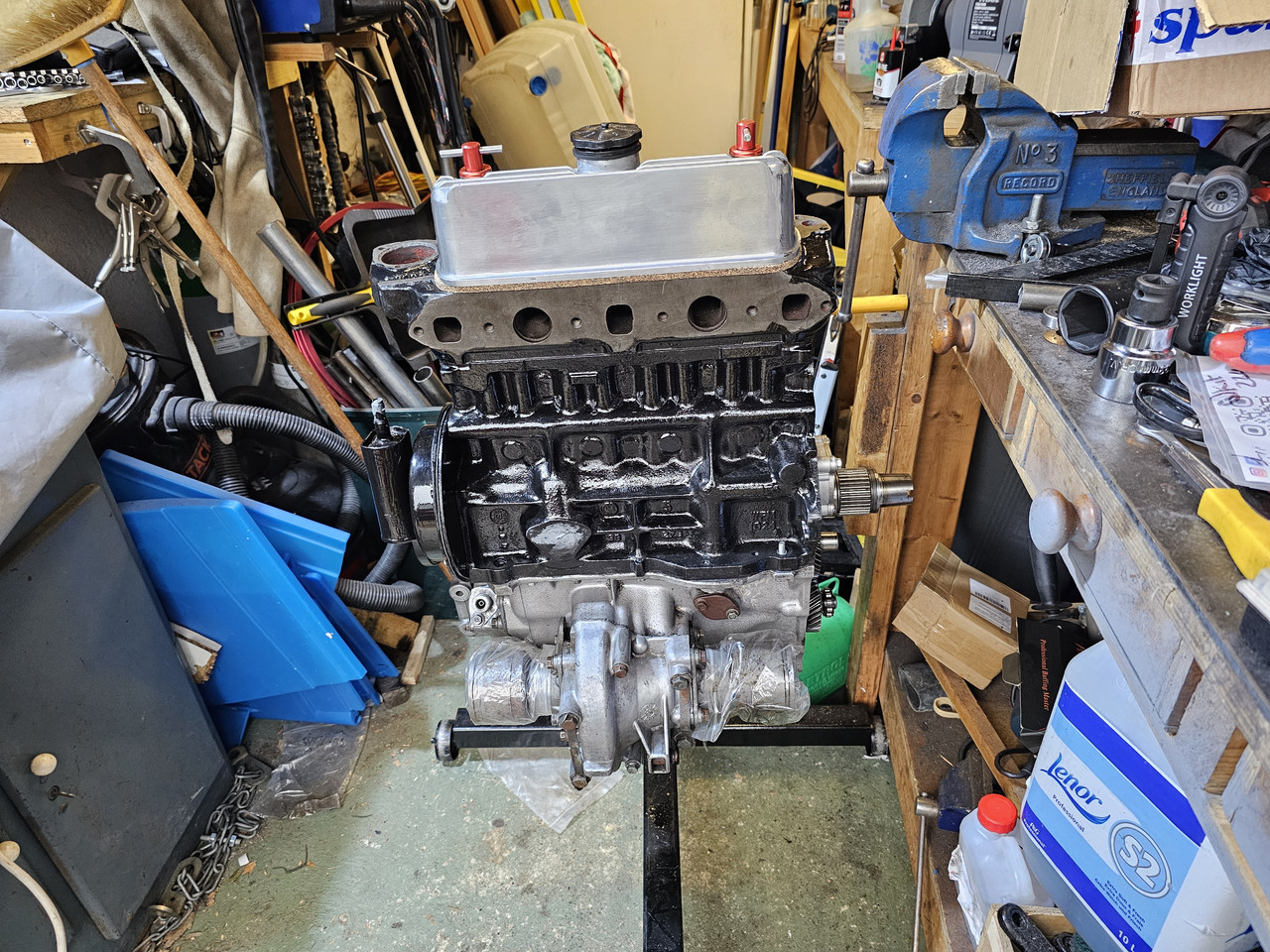

The thing is almost all back together as an engine/gearbox.
The new radiator arrived today so that's another item off the tick-list.

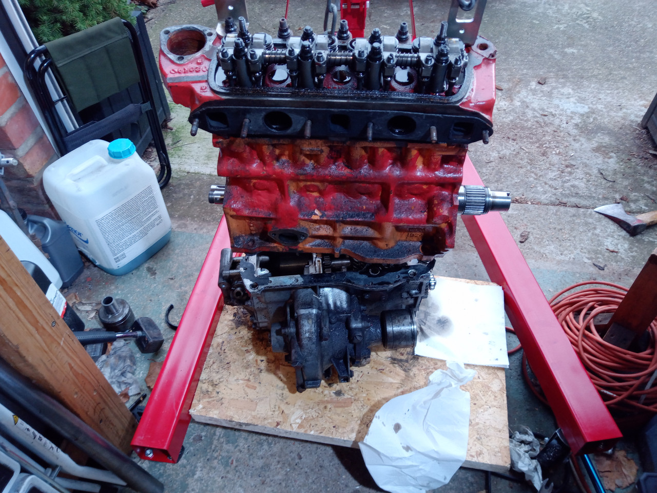

We are going from this sorry mess :
To this much nicer version.
It only needed a +20 rebore to 1293 but all the other stuff sure adds up.
I was pleased to find 2 thou' crank end-float, 4 thou' Evo1 cam end float, 5 thou' transfer gear end float.
Diff pin was on its way out (hardening failed) so a X-pin diff was put in, central oil pickup, new clutch etc.
If the weather is OK it might get back in the car this weekend.  :-)

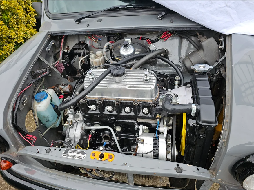

OK, radiator fitted, now looking almost ready to drop into the engine bay and put the ancillary bits on.  :-)

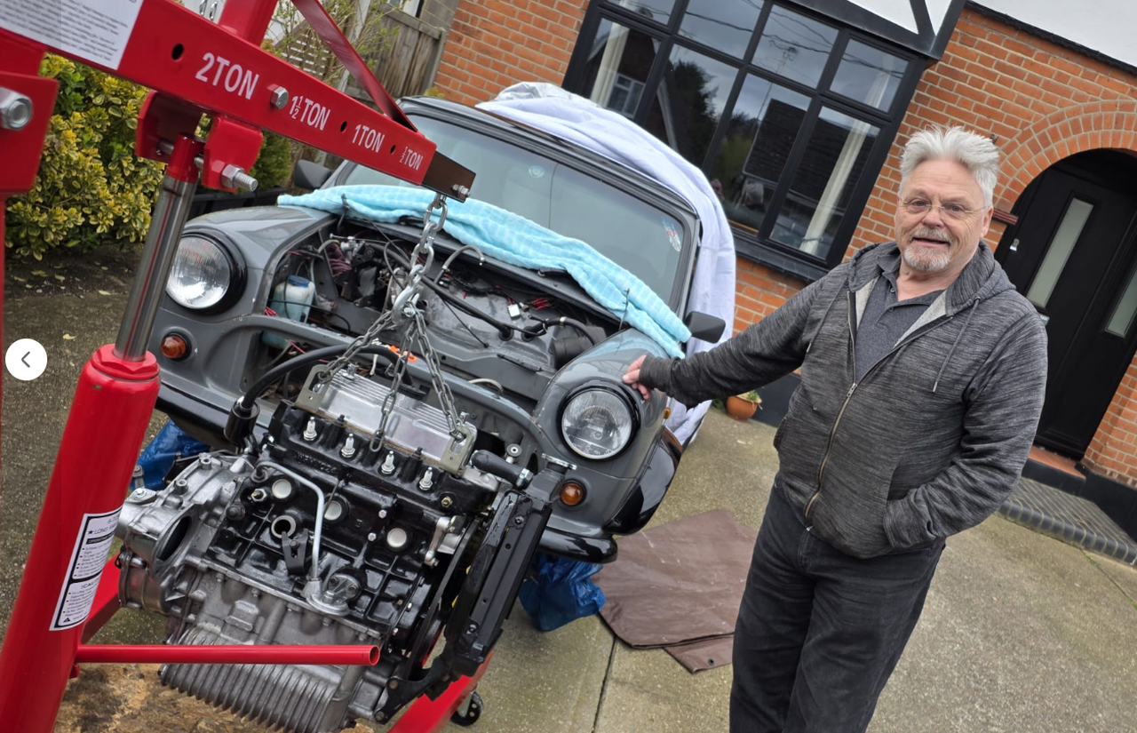

With the aid of an accomplice (my son) I took "Gwen" by surprise and deftly slipped it into her.
Job done! Worst bit was getting the engine-mount bolts bag in their holes.

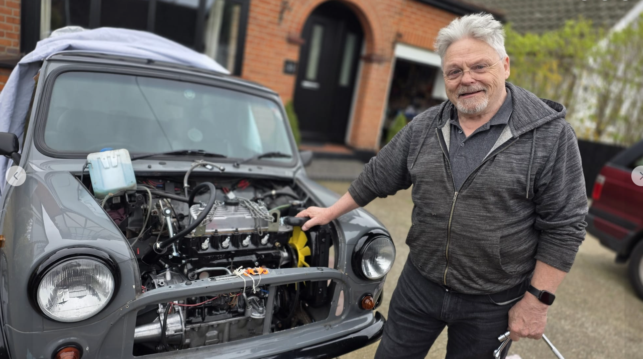

Today was all about putting the inlet/exhaust headers on, the carb and the tarted-up alternator.
If it is not raining tomorrow I may risk life & limb and lie under the car to attach the exhaust system back on and attach the lower engine steady to the gearbox.
Then it's the dizzy and the brake servo and bleed the brakes.
