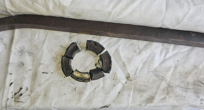

But then, I noticed a "clunk" on a RH turn and I thought   "Hmmmm... that's new", So I jacked the car up and checked for play N-S & E-W at the driving wheels.
BOTH were clunking with excessive play.  Got an assistant to stand on the brakes, and the wheels don't clunk, so it is the bearings not the ball-joints.
Took a wheel off to look at the hub-nut and found this....
I undid the hub nut and found that the split-washer was indeed "split".
It is the same "Clunk-Clunk" on BOTH front wheels (was solid with no play before).  I suspect this is pothole/road-seam impact damage.
However, I cannot trust that the bearings are not now FUBAR so both hubs probably need rebuilding (bearings and ball-joints) to be on the safe side.
2-Steps forwards and 1 step back at all times with this car it seems.  :-)

You have some luck and it seems all bad, what did you torque the hub nuts up to when you put it back together?
Shooter
#60 imack
imack
  • 2,382 posts
  • Location: Orpington, Kent
Posted 10 May 2026 - 04:27 PM
I've never experienced one of those split tapered washers fail, although these days I run the non split versions from KAD.
