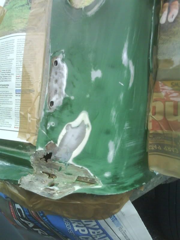

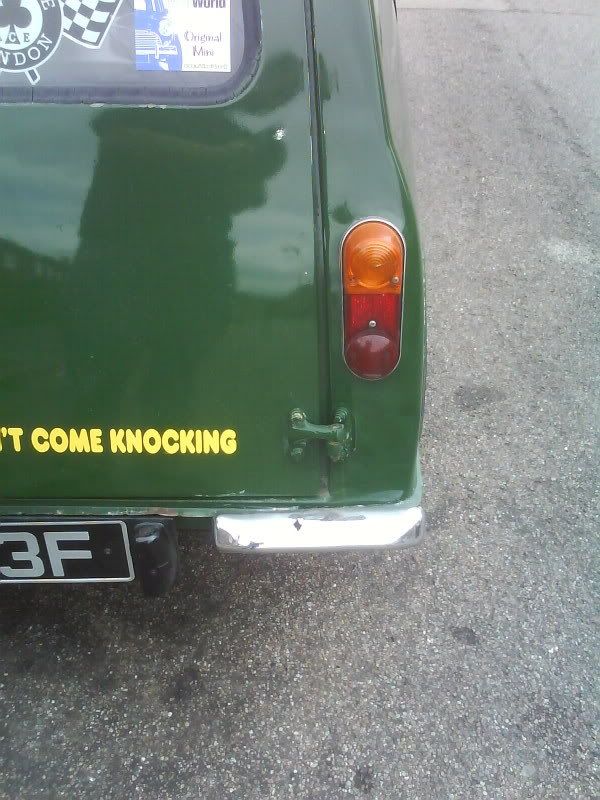

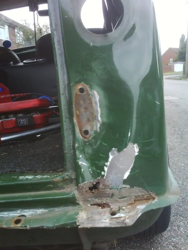

But someone decided to have a pop at Flubber, while I was sat on the roundabout in Hereford... Stupid people, they were in the wrong lane on the roundabout, didn't see me, bang, hit me right in the rear hinge :D
So set about today of repairing the damage... its not brilliant, but its done the job :D
First off, the damage...
As you can see, the hinge held the body, and creased it round... making the door gap VERY wide at the bottom, and pushing the door up, so making it hard to open the door...
After a bit of stripping, I found a bit of filler, hiding a hole :D BUT the bit of steel that down on that corner, is like new!!! Its great :P

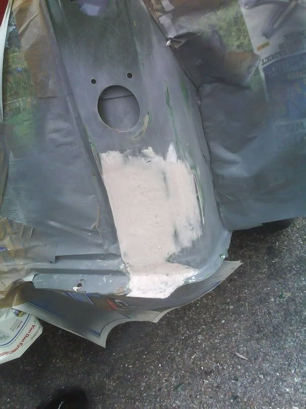

Rubbing back to allow a "key" for the paint, and rust treatment...
this is the second layer of filler that I placed over the damage, be assured, I red oxided, and then rubbed that back, and went over with Zinc Oxide primer, before fillering... so that I know its treated =]

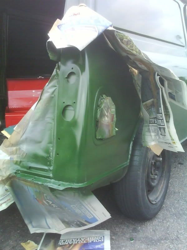

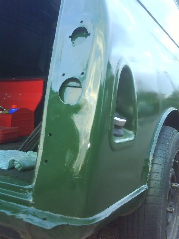

A Layer of primer, just to see where I need to skim a little thin layer over little imperfections...
First coat of paint...

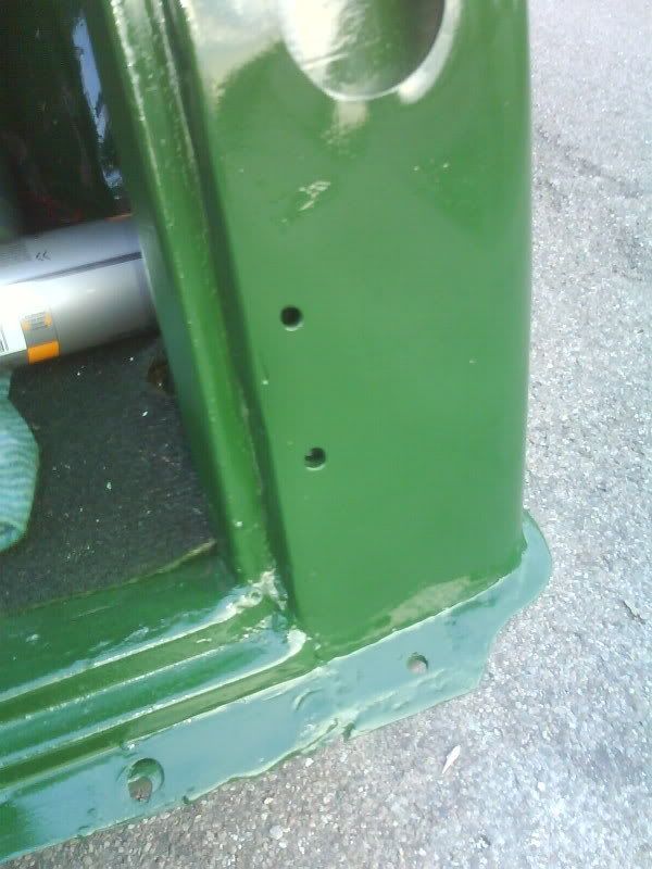

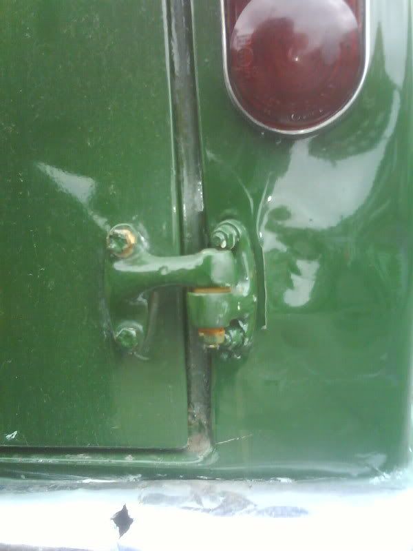

AND Finally, the final coat before rebuilding =] The Van is now in the garage, will start to rebuild it tomorrow, once the paint has hardened a bit :rolleyes: - not bad for a novice damage repair, and not bad for £20 of paint and filler, and knowing which end of a hammer I use ^_^

Theres still a slight "dent" but I can't do anything about it, only way to completely sort it would be chop the bit out, and welding a fresh bit of metal. So when its dry, you will see a slight wallow where the damage was :D But its going for a total respray hopefully sometime VERY soon... so this'll do till then :D
