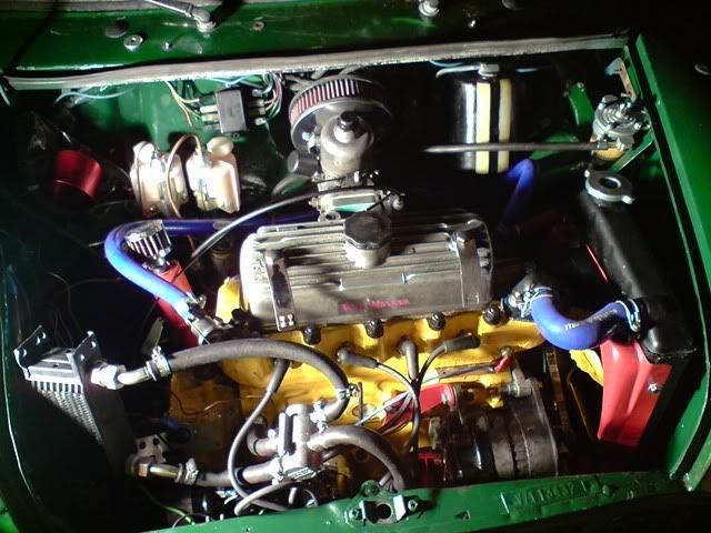

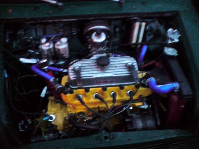

your engine bay looks like it's done in Benetton colours.
found a pic

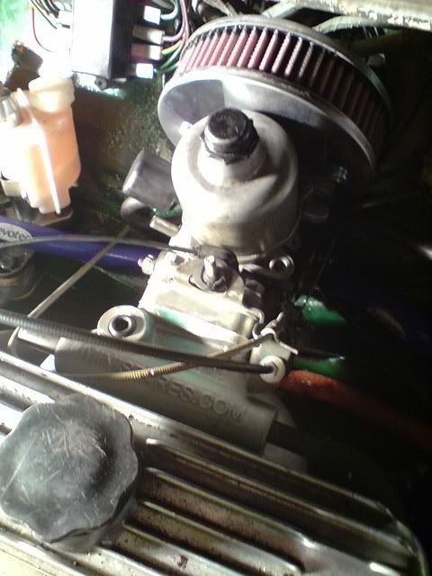

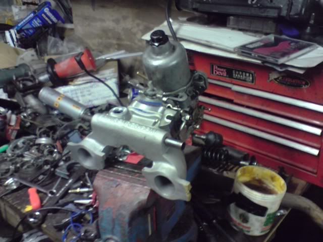

Ok after a few problems of it not starting on the new carb, I have taken the carb off once again, and sorted out the clearance issues with the inlet.
I found that I could not get a spanner OR a socket to fit onto the nuts that sit under the inlet, so I tickled it a bit to make it fit better, and I've also taken some advice with cutting the lower mounting areas out, so all I need to do now, is loosen the manifold, and lift, rather than taking the nuts off fully - thank you Minivanman >_<
Heres a few pictures from tonight...
The modified inlet...
Complete carb... no filter shown atm, as I am going to take the back plate to work to drill a few more holes into it, as it was intentionally a HS6 filter not a HIF44 filter.
