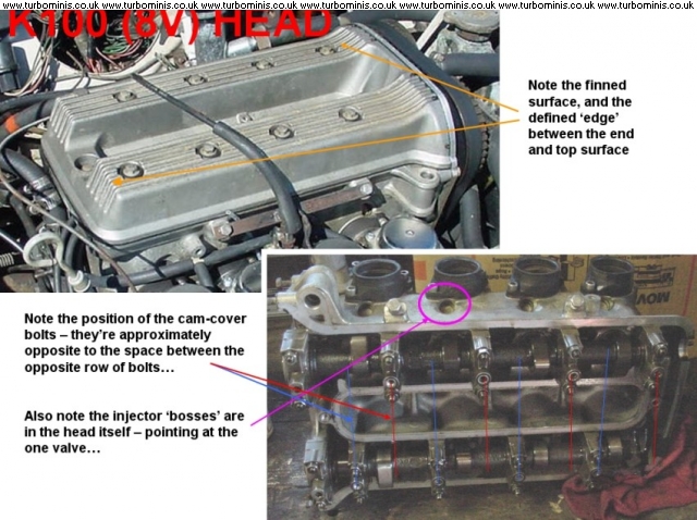

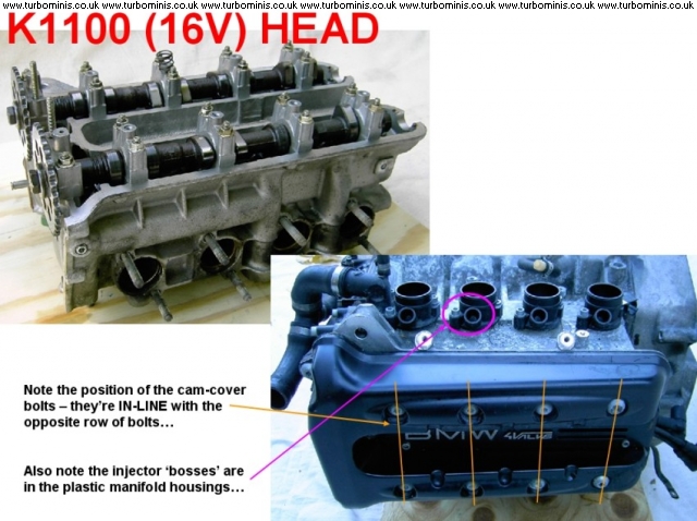

could be 4 valves per cam

nar, you can get twin cam 8 valvers, 4 valves on each cam.... but given that the title of the topic, and the description of the video says 16v...well, leaves me a little confused, either sprocket is being silly or him and therefore 'engine tuner' too, know something we don't >_<

but wasnt the k1100 a 16 valve bmw head ? and why would he lie about it :S sprockets jelous ?

Could be a K100 head (the 8v DOHC engine IIRC) I wouldn't know the difference meself! >_<

i think you are on to something sprocket, i too see no engine brake, just a drive flange happily spinning away at the back and no sign of anything on the flywheel end either!! maybe they were jsut doing a basic map setup and the person in the video got confused!! maybe its a very new setup with some sort of trick gadget that only nasa has ever seen before!! tho im with you it does look like a k100!

8v and 9.6K??
3 times the cost of the SC build which is 16v......
