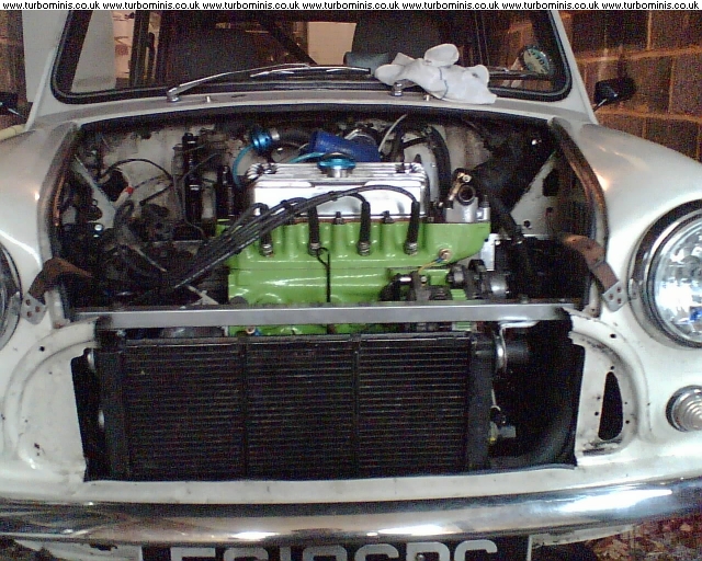

Im hot on your heels Udo...Lol
When do you think you'll have yours finished?
This is mine as of today.

Been following yours over on TM Matty, nice manifold by the way
Think you will be past me not on my heels with a turbo lol

Im just about to place my order for 100m odd of wire. Then its all good fun from there.
What are your plans with regards to rad? Are you sticking with the side mount or going a bit more flash with a front mount! :thumbsup:

Plans for the rad are to try and keep the front rad and fan (came with the package) but to get them further back so the grill fits (may have to look at differnet rads instead of the metro mk2 one in there) - John said it would be okay with a side mount twin core/supercool type rad but that leaves no space for the electric water pump

I had a fiat chiquecento (sp?) in mine fit it nice and snug.
I never got round to fitting fan on it but I think the only way you could do it would be to use a remote oil filter.

Cheers Matty, looking at it I think your right with regards to the oil filter which is a shame as the engine came with a nice SH Engineering alloy filter head but it may be the only way.
Definitely want to keep the grill as the more stealth the car looks the better!
Is that bar across where the slam panel should be removable ?

Posted 11 December 2007 - 11:09 PM
Yeah its removable, its bolted either end throught the inner wings. It makes it soo easy to remove the engine. :)
If you've got a pre engaged starter you'll also have to rotate it to get the solenoid at the top for extra clearance. :shifty:
It worked really well...only downfall is that it isn't made out of ally, so its a little heavier than most rads.

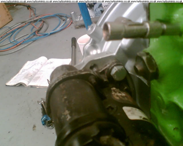

Whats this about turning the solenoid? as yes it needs a pre-engaged starter, so also got the wiring fun from the inner wing solenoid to deal with as I'm currently on the old style starter

Because the solenoid faces forward (more so on metro starter) you need to rotate the starter so the solenoid is directly above the starter. This free's up an extra inch at the front.
Like this...All you need to do is drill and tap the top hole in a new position then make a bracket for the lower mount and grind tiny bit off the casing around the starter gear so it clears the flywheel.
