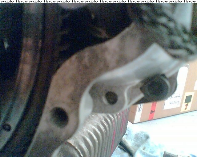

So I'm looking for a mini starter rather than a metro one - I'll have a search for part numbers or get my mate to help as he works in a motor factors.
You don't have a photo of the lower mount bracket you mentioned do you?
#123
Posted 12 December 2007 - 06:12 PM
does it still sit on the flywheel correctly? that would be my only consern
Why wouldn't it sit on he flywheel correctly? Your only rotating it in its originl location?
Here's a pic of where you need to relieve the gear housing.
And here's the lower bracket.
You can see here how it virtually sits on top of the starter. Obviously its not a problem for you but this won't work with a dizzy in place.
