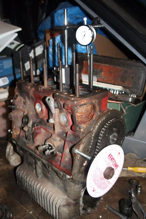

Measured the chambers in the head today and checked the cam timing.
Finally got hold of some pipettes off Ebay last week, so spent this morning filling one of the chambers to measure how many cc's it was. Came out to about 21cc, so I guess its either 21cc, or 21.4cc which is standard. So since I'm keeping the pistons the same, and not skimming anything off the block deck or the head, my compression ratio should stay as standard for this engine, which is 9.75:1. I would have liked it to have been a touch high, about 10-10.5, but I'm not trying to eek every last bhp and torque out the engine, so I'm not too fussed.
Then I thought I'd double check the cam timing. I don't have adjustable timing gear, so I can't adjust it, but I thought I'd check it for two reasons; because I've never done it before, and also the cam I have it reground, so wanted to make sure full lift was where it should be! I bought a DTI guage off a dude on here last week, so following the instructions gained from Calver's website (www.calverst.com) I used the guage to ensure that I had full lift at 106*, which I did. So thats all groovy! :lol:

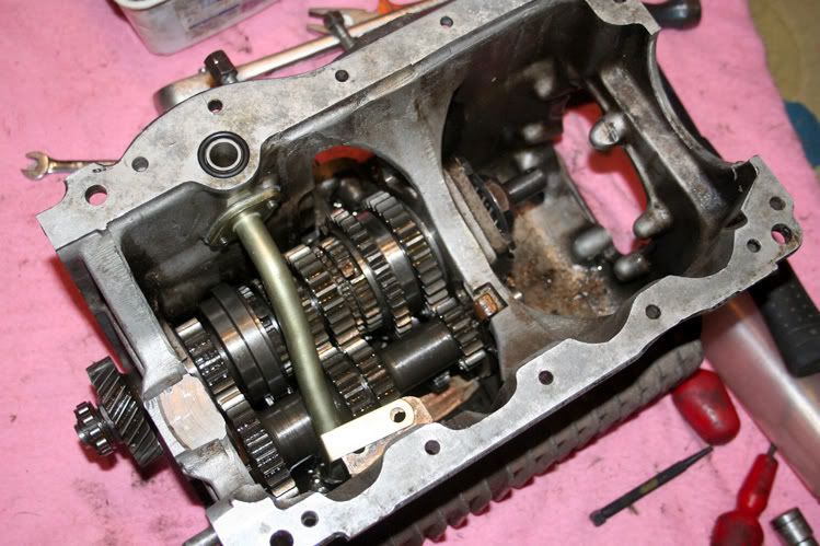

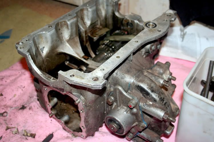

At last my gearbox is finished!! :sneaky:
I've had to use up holiday this week and next, so I had Tues and Weds afternoons off, and managed to get the gearbox all bolted together on Tuesday 'noon.
Posted Image Posted Image
(Click for bigger image)
Unfortunately, when I came to bolt it to the block I found I had used the wrong input gear. The case I've used is a pre A+, but I bolted an A+ input gear to the 1st motion shaft. So when you come to put the idler gear into its bearing, if you use an A+ one the idler gear shaft is too big for the bearing, but if you use a pre A+ idler gear, the teeth don't mesh to the A+ input gear.
SO, I need to take off the diff, so I can then rotate the gearselector shaft, so I can put the gearbox in 1st and 4th gear, so I unbolt the 1st motion shaft nut and change the input gear. So this will be the second or third time I've built the gearbox only to have to paritally strip it again!

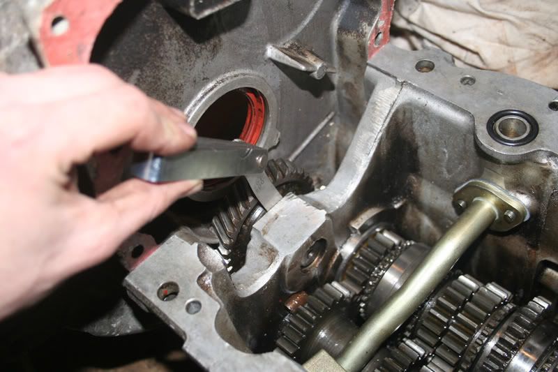

First of all I need to finish the engine, so I ventured back into the garage yesterday. Because I was now using a different transfer case I had to change the nose bearing and the race in the case, as it would no longer be a matched pair using the old one. I used the Guessworks method of heating up the transfer case and smacking it on a piece of wood, and initially forgot to take the circlip out, then wondered why it wasn't coming out at all! >_< Anyway, wasn't long before I had that changed over, which then enabled me to bolt the transfer case to the gearbox to check the end float on the idler gear, which was found to be 0.004". Lucky really as I don't have anymore shims for the idler gear!

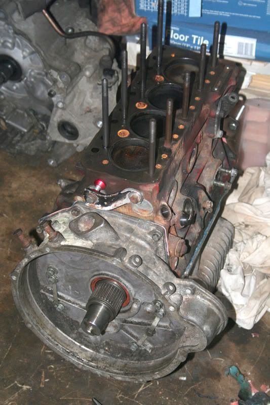

So after I'd done this, I took off the transfer case and cleaned up all the mating surfaces on the gearbox, block and transfer case, making sure I removed all traces of old gasket. Job done, I smeared Hylomar on both sides of each gasket, put the gaskets on the block, then the crank seal, then carefully positioned the block on top of the gearbox.
(Click to enlarge)

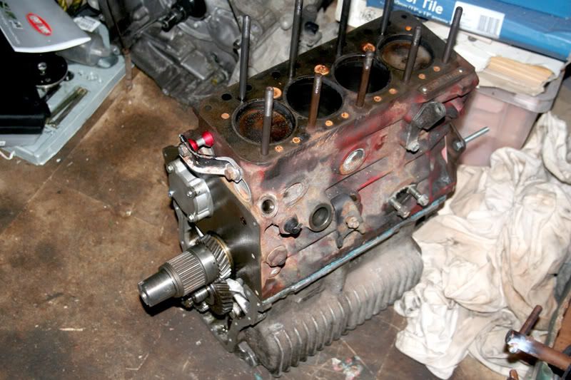

With the block and the gearbox back together, the Idler gear went on, followed by the primary gear. I checked the end float on the primary gear, and it was alarmingly at 0.011", with limits being 0.003-0.006". Now, I've read before that the C shaped retaining washer can get worn on one side where the primary gear keeps whacking it, so I took off the C washer and turn it around, measured the clearance again and it back to about 0.006", maybe a slither over. So then all was left was to bolt the transfer case back on...
(Click to enlarge)
