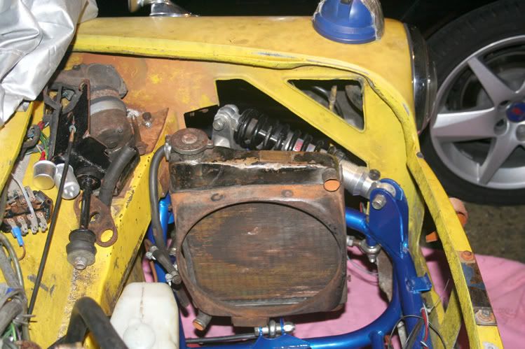

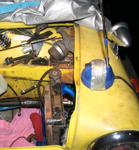

Bought some hi-tensile bolts today to bolt up the tower mounts. The existing bolts I had, the thread was FUBAR on two of them, so I just got some mate bolts of similar length, along with 250 nuts and 250 spacers (the lowest quantities they sold!). Just been trying to bolt them up and the bolt is about 5mm too short, just can't get enough thread engagement on them, so I'll be ordering a few new bolts from Simon tomorrow, along with a couple of locktabs. Whilst I had the bonnet off I decided to rest a Mini radiator in its normal place just to see how much room I have to play with.....
I don't think its going to fit....

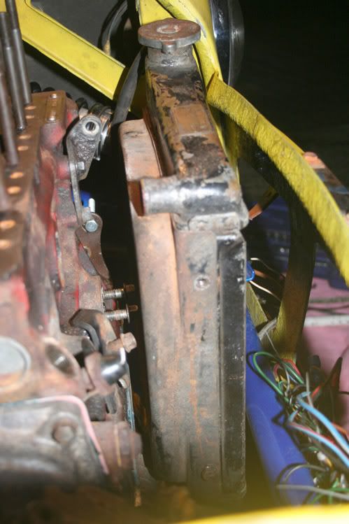

You can see that the water pump pulley is roughly above the tube that runs from the rear floor mount, up to the teardrop mount. In my pictures above, the radiator looks like it will be sitting pretty much butted up against the pulley, leaving no room for the belt or the fan!

Having said that, there is a tube that runs directly behind the bottom of the grille, so I'm not sure if this will cause clearance problems with a front mounted rad.
I'm going to try and get the engine on the crane and roughly in place tomorrow night to see exactly what room I have where.

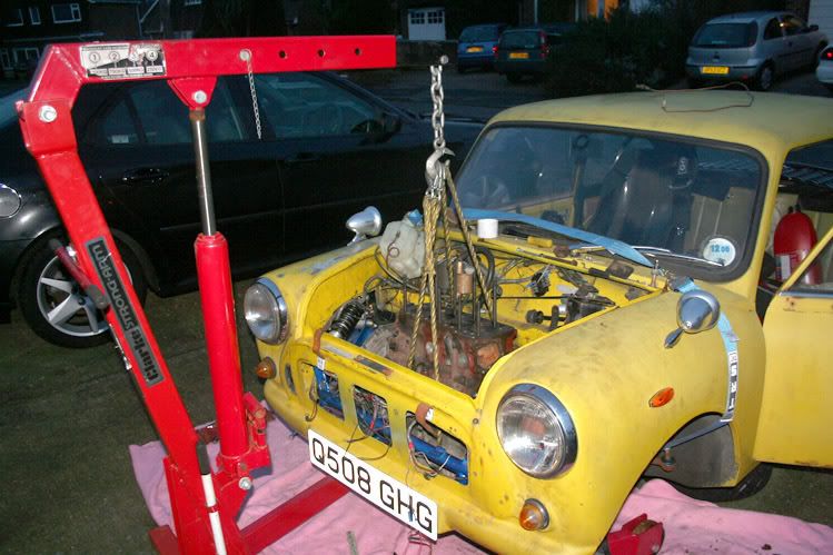

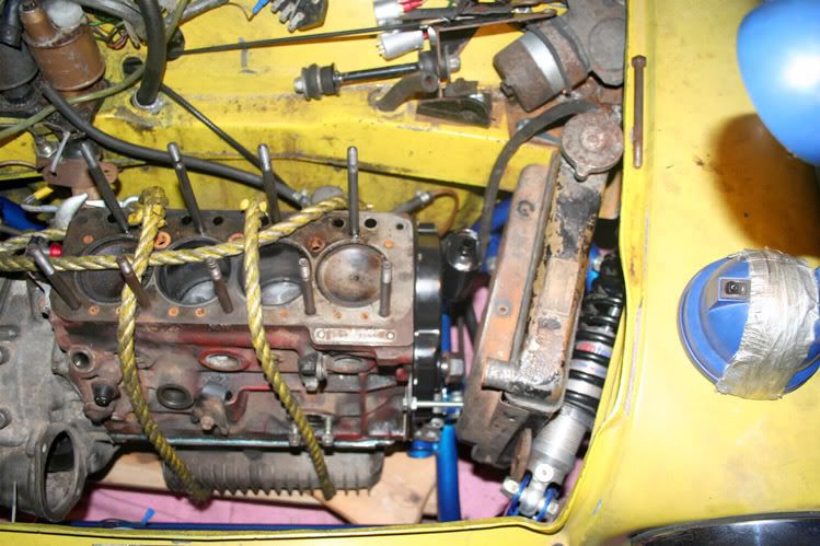

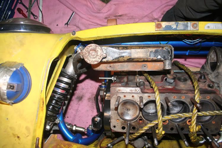

Then it was getting dark, bit cold and I had a feeling it was going to rain soon. I was also shattered! So I was in two minds whether to try and get the engine in place this evening, but I thought if I didn't do it today, the weeks weather ahead might not be so great, so I decided it had to be done!
Got it in place, then used the standard rad to gauge how much room I have to play with in terms of a cooling system!!

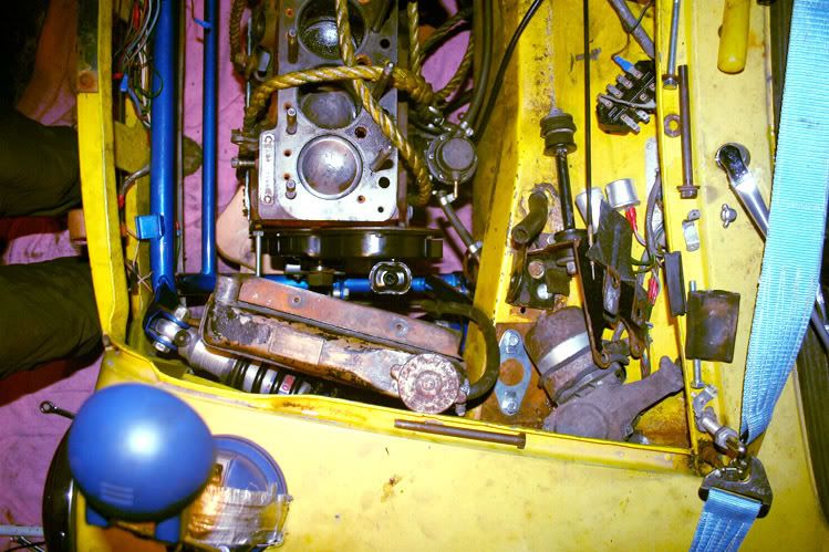

Side mounted:

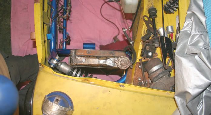

Front mounted:

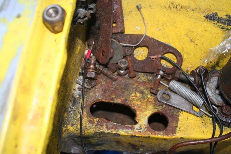

Also, after I'd taken the damper top mount bracket off, I realised someone made a bit of a booboo when they were drilling the crossmember for the tower mounts! Oopsy!
