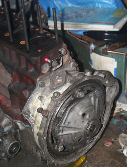

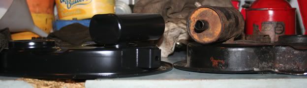

I ended up getting a new Mpi timing cover after I split the one that was on the engine, this has the advantage that the breather is slightly squished, so will have a bit better clearance on that side. You can see the difference in breathers in this pic:
Then I fitted the Ultralite flywheel, with Steel backplate and orange diaphragm.

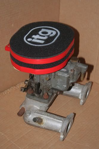

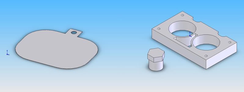

The other thing I've been working on over the past 3ish weeks is adpating the air filter backplate to fit the Weber, since they didn't have a filter for my specific Weber, thus requiring the modification. Initially I just riveted a plate over the backplate holes, then I was going to drill out the holes I needed to fit it to my carb, but this wasn't going so well. So, my next plan was to draw it up in CAD (recently switched from Inventor to Solidworks), and then get it CNC'd at work. This was going pretty well, til one evening I had pretty much finished drawing it up in Solidworks when my computer then crashed and I lost all that nights work!
After that I thought I'd just do it the quick way. Made a cardboard template of the backplate, screwed it to the carb and using a pencil lead on its side, did a rubbing to reveal where the carb mouths were. Now I just need to trace my cardboard template on to some sheet metal I have. Here's how it'll look when its all done:

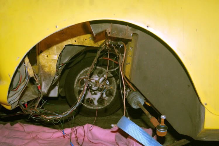

So, went about getting out the inner wings, of course I had to do that about 5-6 different times, each time cutting a shade more off only to find it still wasn't enough. Then, just when I thought I was going to end up cutting the whole thing to bits, I got it fitted!
