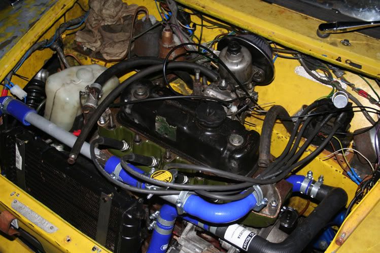

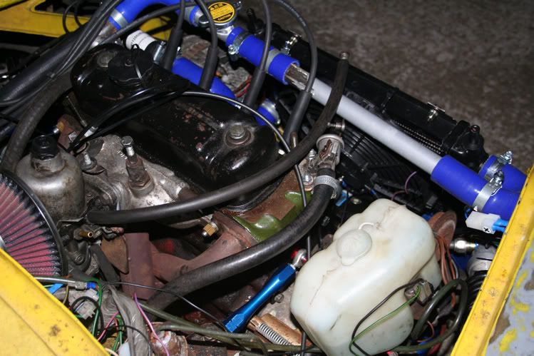

I got the afternoon off work, which allowed me to head over to Car Builder Solutions over in Staplehurst (about 45 minute drive). On the way I stopped over in Maidstone at Maplin and picked up an extension cable for the speedo sensor wire. The extension is no where near long enough, but I can chop the wire and splice in some more. Whilst at CBS I picked up a choke cable, an inline radiator filler neck (see picture below), an overflow/expansion tank, and some washer fluid tubing.
With this, it allows me to run a vented radiator cap. This takes care of venting any pressure build up within the system. Once pressure builds up, the vented rad cap opens, and any excess fluid can then travel down the take off into my overflow tank. The beauty of this system is that I can place the overflow tank anywhere I like, it doesn't have to be higher than the engine/radiator because the expansion tank is fully closed. Once the coolant then cools down, the radiator cap closes, causing a vacuum in the system which then draws the coolant back from the expansion tank.
So first job was to finish fitting the cooling system, which I did. All the jubilee clips were put on, and I made a couple of extra bracket to hold the radiator.The fan is then wedged a bit next to the starter motor, and held next to the radiator by one cable tie!

Current view of the engine bay:
