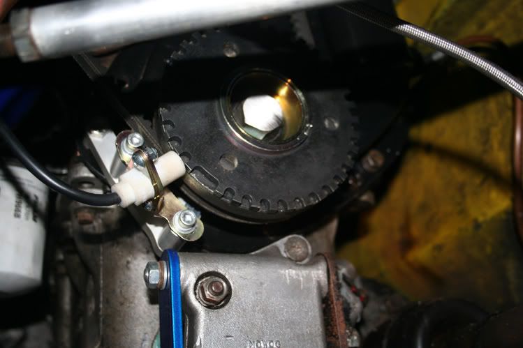

Here's a pic of the KAD crank sensor kit installed:
(Click to enlarge)

Spent the rest of today (after relocating the starter solenoid), wiring in the Megajolt. Took me AGES to work out the wiring on the EDIS module, and then a bit longer to work out how to earth the shielded cables! Finally got there though, and after twisting a few wires together I decided to just test the EDIS kit to make sure it would at least work in 'limp home mode'. Tested it for spark and found none. After spending many minutes talking to The Matt on msn I realised I had earthed pin 2 on the EDIS coil and not wired it for power! :P Changed that and spark a plenty! Then wired in the MJ module, and put connectors on all the wires, so its now in there a bit more permanently. Uploaded the 'Aldon Yellow' map from the Megajolt Community website and it fired up first time! Really really pleased. My main aim today was to get the engine running again, so well chuffed with it. Still got plenty to do tomorrow. Big thanks to The Matt and Bounce for all your help today! :genius:
