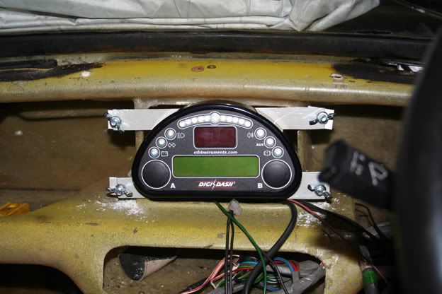

Wired up the ETB dash to +12V and an earth, it fired up with its flashy LEDs and stuff!

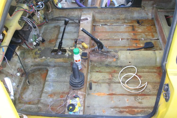

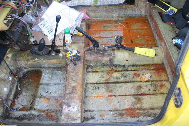

I finish up by giving the inside a good clean out and hover. It was quite a trickle of water down the road when I unbolted the seat and let the water drain out!

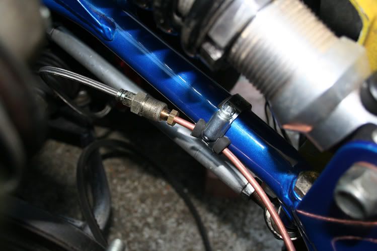

Been wondering how to attach the front brake line to the subframe for weeks now. I was thinking along the lines of a metal tab with a slit in it. The brake lines would bolt through the tab, then I'd put a jubliee clip through the slit and wrap that around the subframe. Well a new front brake line turned up today from Minispares (old one got crushed under the engine crane), and I just so happened to have an idea! I thought to myself that the brake line doesn't necessarily have to be bolted to anything with the usual fixings, as long as its secure. So I've put a small length of rubber piping around the brake line to stop it getting crushed and then put that inside the jubilee clip. Going to see my MOT tester to check that he's happy with it.
