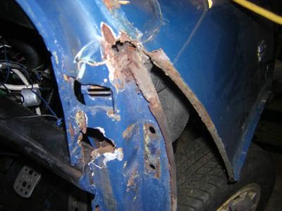

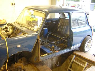

As I have finished all the jobs on my red Mini, I officially started work on the blue Mini today. Engine is all ready to come out, just engine mounts and driveshafts to do.
Stripped all the interior out, and inspected the rust. Needs both inner sills, door pillar, door step, and to my horror sills! The previous owner had covered the sills in filler straight over rust and holes! :saywhat:
Bit more work then I imagined!

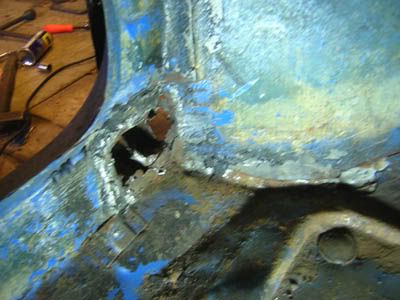

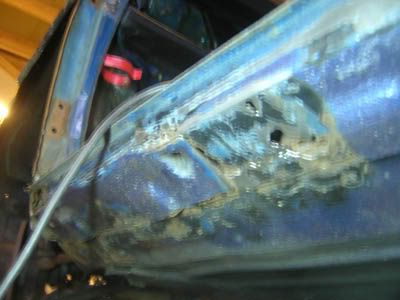

Found some more holes today :w00t:

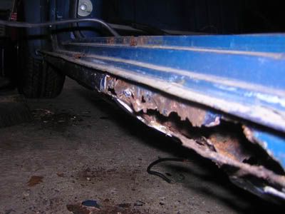

This is the worst side (offside), needs new sill, inner sill, door step and door post.

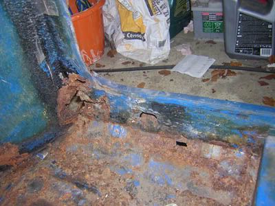

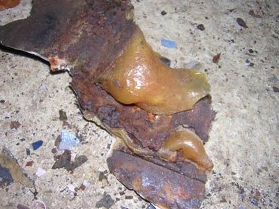

And what the sills were held together with! :w00t:

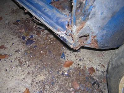

Also found some gripfill covering up a hole..

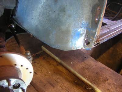

Other side isn't quite as bad.. will get away with patching the sill.

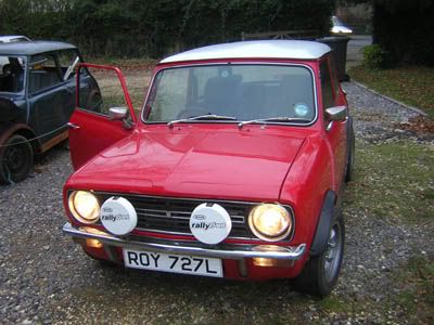

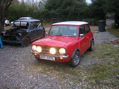

While I've got the camera handy, pics of my new spot lamps on the red Mini :cool:
Covers too..
