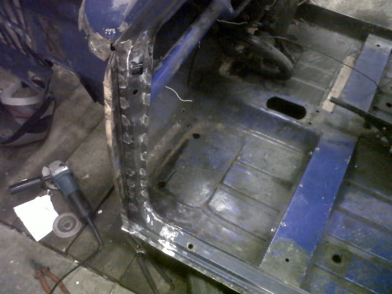

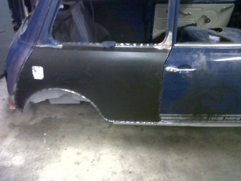

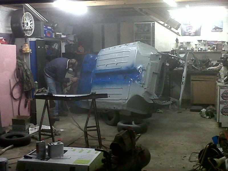

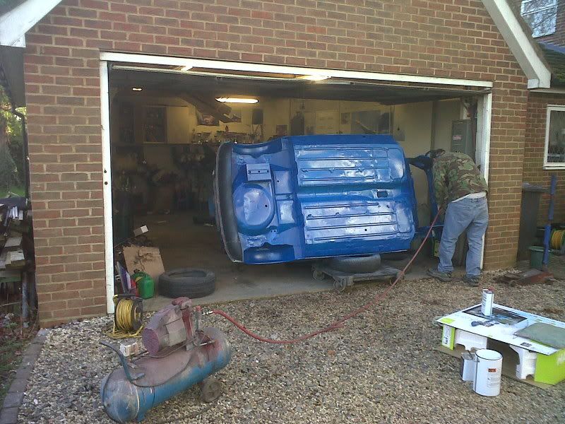

Posted 17 November 2012 - 10:46 AM
6 year update time.
Progress has been exceptionally slow as I've had a lot of other projects and had kinda lost interest with the Mini. But I'm trying to push forward and get it done now.

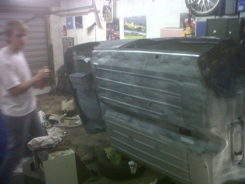

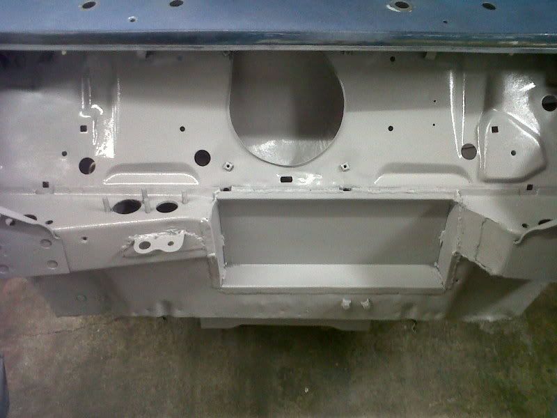

I did a fair bit of work in 2007 fitting a new floor pan, A post, sills, rear hinge panel, the bits under the rear lights & boot floor. Turbo box. And a few other bits chopped out and welded in.
2009/10, finished the underside, fitted new NS A post cover and fitted the rear valence. Rebuilt rear subframe.

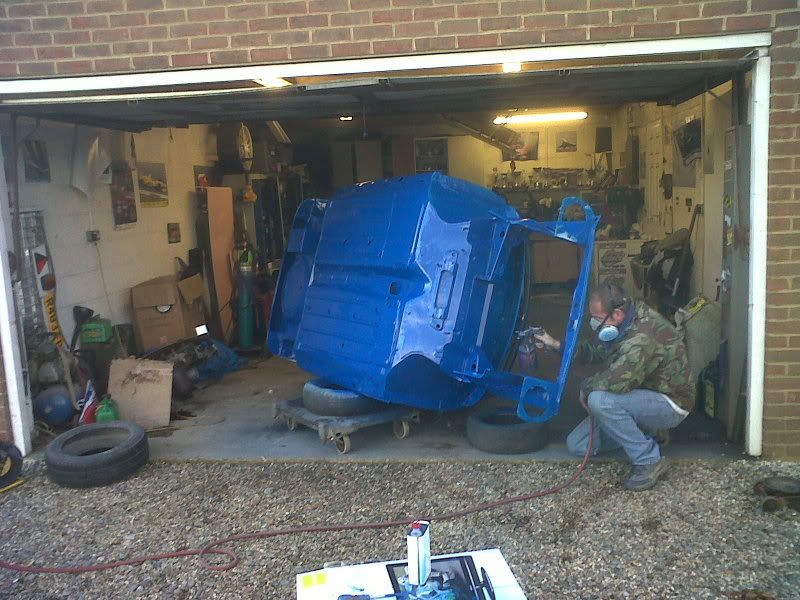

Unfortunately after I finished the underside, I painted it all in Hammerite. When the stone chip paint was sprayed on to it , it all reacted :( So the WHOLE lot had to be rubbed off and I had to start again, this time with etch primer, stone chip and top coat.
2011, fitted new rear 1/4 panel and painted the underside and engine bay.

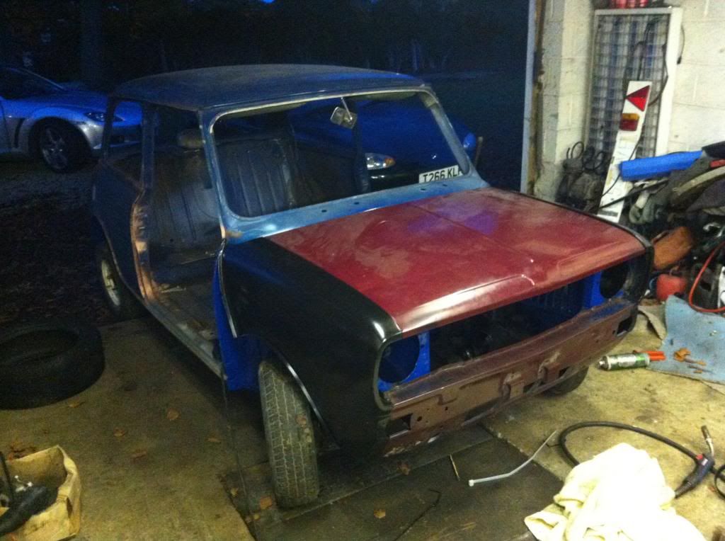

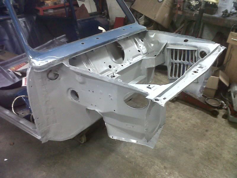

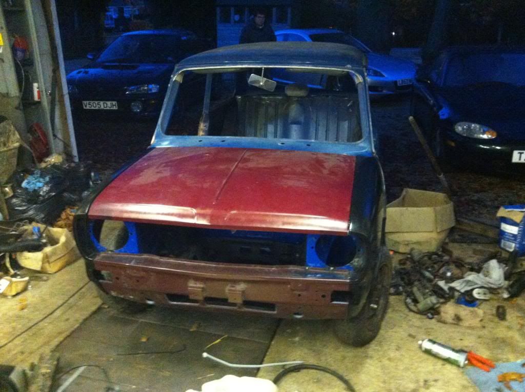

2012 - Fergot about this car for a bit, and then last weekend I fitted the front end (well, alligned it all up and tacked into position).
Edited by Sam, 28 November 2012 - 10:22 AM.

Front end is now welded & will be fitting the A panels at the weekend.
