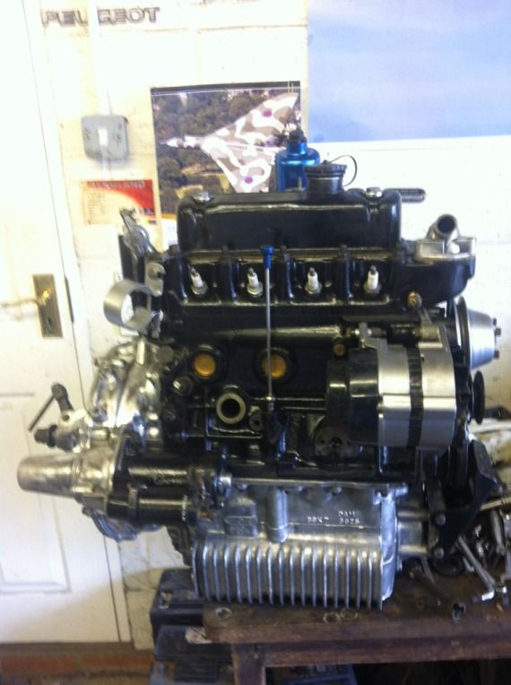

Engine finished

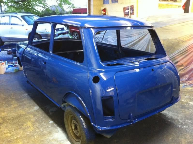

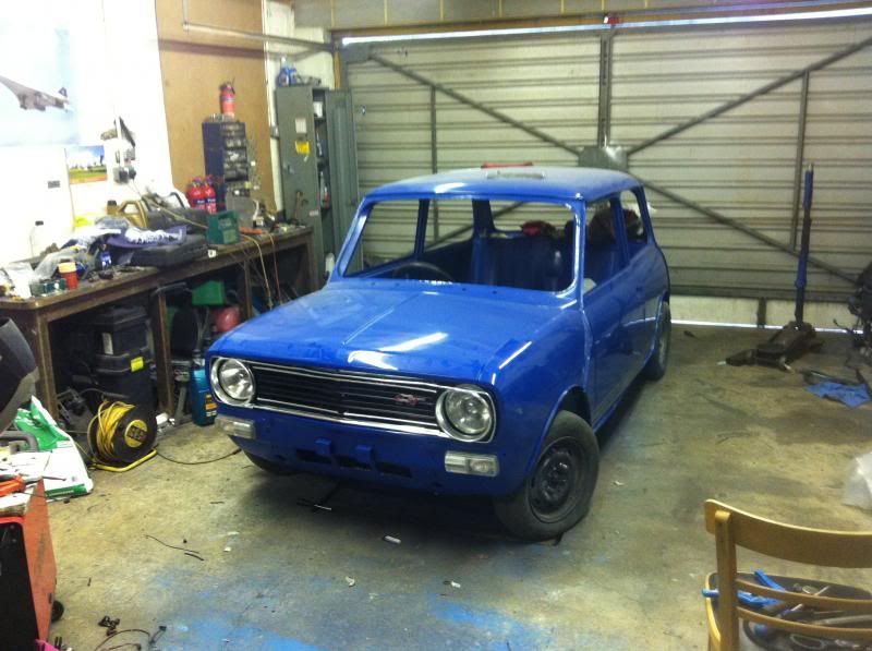

Car painted!
1153966C-B55C-4307-994C-7A1500409DBF-226
FDA84DEE-BE8A-4683-8584-522BD804DA1C-226
6F7EB4B0-AA86-4160-987E-69B407BE068F-226
The paint has covered well. Unfortunately there are a few bits in the paintwork - dust & probably overspray that has landed on wet paint, but will rub back and cut and see what it comes up like.

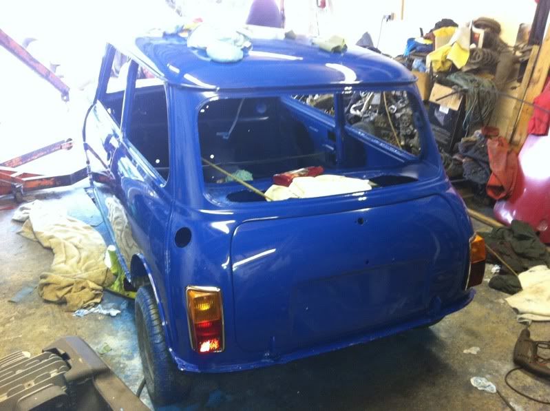

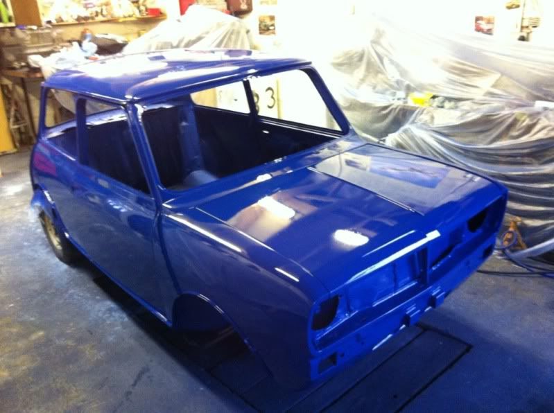

Car has been flatted back with P2000 to remove the orange peel (long job by hand). My brother has been cutting and polishing by hand (another long job). By about half way round, I bit the bullet and bought a Meguirs polisher. Almost done now
69072F7D-8911-4ADB-9DC4-354BAD9107B3-534

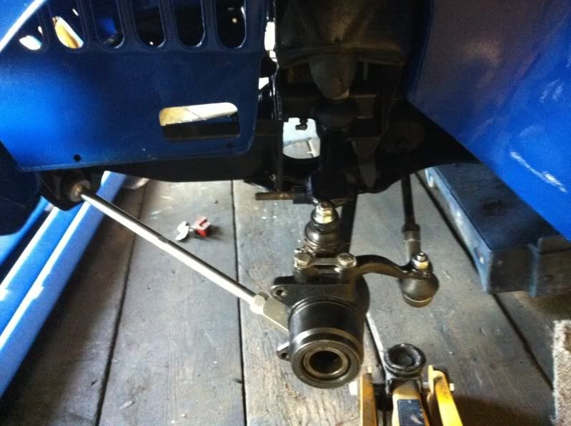

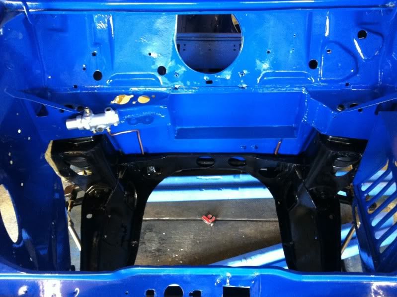

I put the front subframe back together. New rubber cones and knuckles. New bushes. Lots of new nuts and bolts.
Fitted brake line and fuel line
Seems nice to finally be putting stuff back on the car!

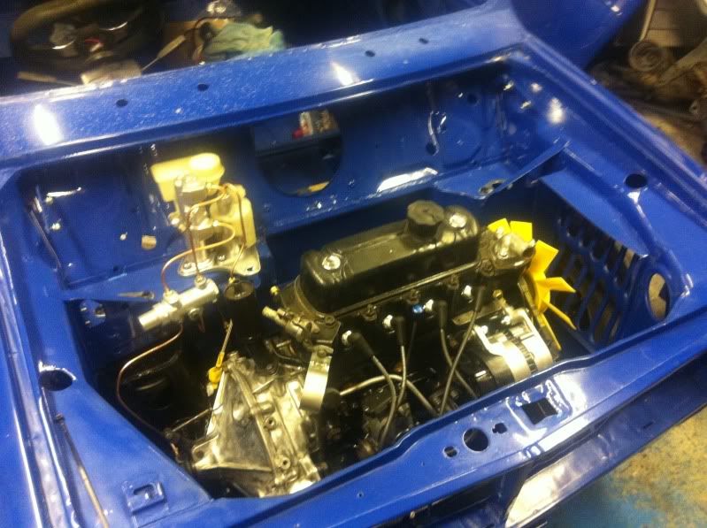

Lots more done since last update. Pedal box, steering column and master cylinders in. I have made all the brake lines up and fitted those.
Fitted hubs, brakes and shock absorbers.
And fitted the engine :)

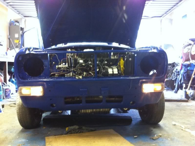

Progress has been quite leisurely recently but I have got a number of time consuming jobs done.
First one was mounting the fuel tank. When I replaced the boot floor, I fergot to save the bracket for the tank strap, so I had to fabricate a new one. Really pleased with it - used the metal folder at work and it looks original. :D
I came to fit the heater box and realised I couldn't fit that either because of the turbo bulkhead box. Made some special brackets up, again using the metal folder at work.
Plumbed up fuel and coolant hoses.
And today got it running :D  Sounds amazing - and the throttle response is incredible.
