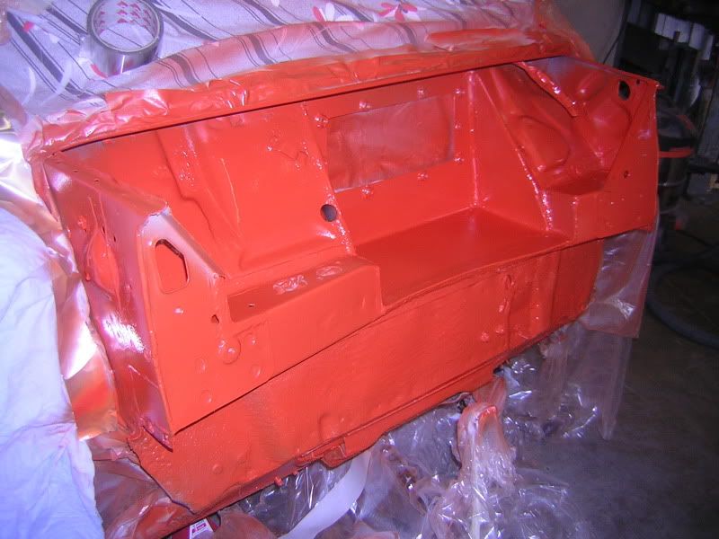

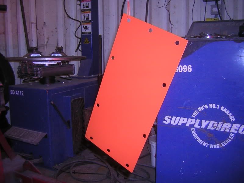

Well I haven't update for a bit but have been spending a lot of time at the car. Too much time as I've forgotten what the girlfriend look like :dontgetit: Starting to get totally fed up with going all the way there everyday to do work. Much easier if it was at home but that's just the way it goes.

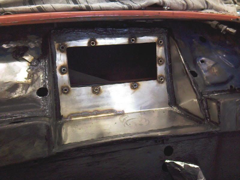

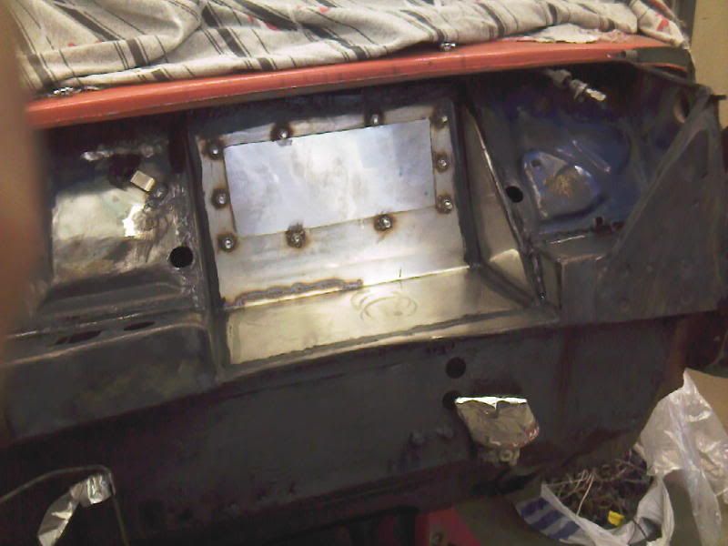

I have been finishing off the bulkhead. Welding up any holes I don't need and adding some brackets and such. Got the box welding completed.
Then I made myself a little access point so I can get to the back of the inlet area. Turns out the box is now even stronger as there was a little flex when you pushed on it before. Now it's totally solid.

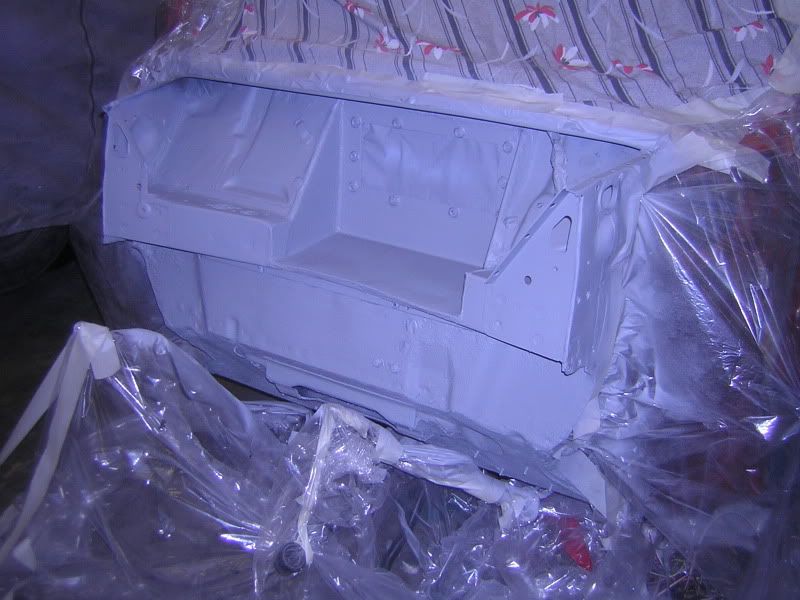

so it all got some primer on it

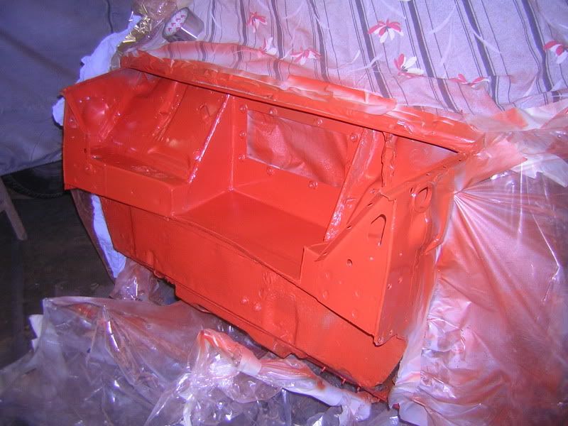

and then a slash of colour. So glad to get rid of the old blue nasty paint. :teehee:

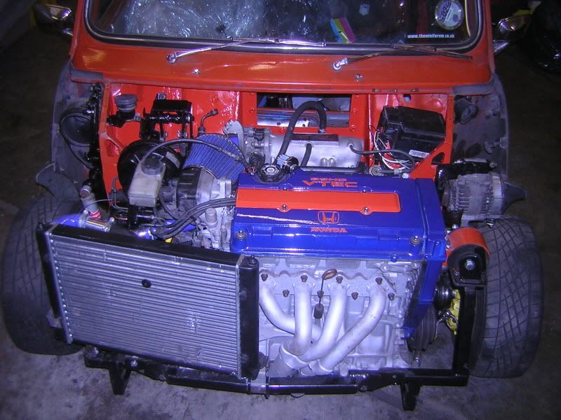

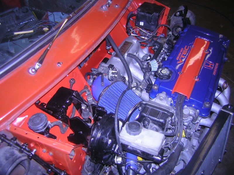

Did some work on the back of the engine when it was out. Tidied up the loom, redid the intake as it was leaking a little water, Got the alt bracket secured on and sorted out the heater hoses ready for fitting to the car. Also found out some good news that the new bulkheadbox is not low enough to effect the heater placement so no need to mess up my centre console :thumbsup: about 5mm clearance.
so now that is gonna be left for a few days as I'm in work tomorrow and then we're putting the engine back into the car for the final time :cry: :teehee: :teehee: :sneaky: :thumbsup:

Any reason why you would want to get to the back of the inlet?
Good work on the bulkhead box and the clearance with the heater, looks sweet now with some paint on it :thumbsup:
#500 miniman.matt
miniman.matt
  • 495 posts
Posted 12 April 2010 - 06:32 PM
Good work on the bulkhead box and the clearance with the heater, looks sweet now with some paint on it :P
trust me from doing this its so tight and theres valves and other stuff there not to mention access to the bolts to actually attach the inlet.

cheers guys. Kam it's like matt said. lots of things there that might be good to get at and access as we all know is shocking so forward planning maybe. Your doing more work on yours, you know you now want to do this :P

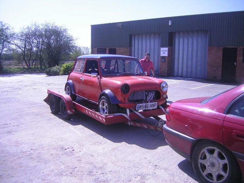

Well I worked hard into Friday night. Was there till about 1:30am. Didin't get the car to a running state but got it so the suspension can be sorted. Then Saturday morning got up early and good old Spenner got the trailer and we got the car to Pitstop for setting up.
It was hard work as the trailer was dodgy as hell (sorry spenner but it was) :P and had put some new track rod ends on late the night before and the toe in was mental so we could hardly push the car. So the toe was sorted, I broke out the welder and fixed the trailer and she's out and getting some sunshine before having a weekend off and getting worked on monday. They are gonna have a good look over her too to make sure I've not missed anything. Fingers crossed :)
