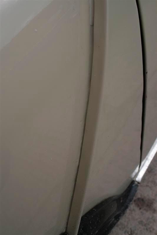

The front valance is just disgraceful!
I would ask for a full refund and just forget the bodyshop completely and go somewhere else... But he's worse now than when he went in, so I would lose money! >_<
Guess I'm just gonna have to trust them to put it right, properly, this time?

Has Reggie taken to the bottle?
Hanging around in truck stops, caught on camera with his mouth wide open (probl'y singing bawdy songs) 'n his brightwork all askew tch tch.
The bodyshop aren't responsible foe the flexing between his panels that caused the cracks, but they did take the job on.

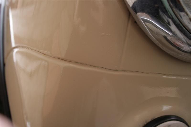

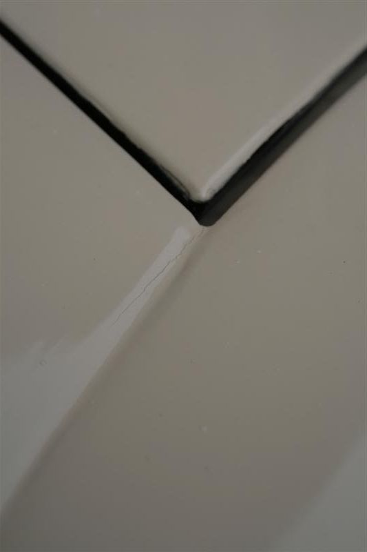

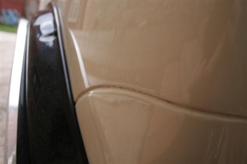

Nope, they're not - I know that.
But as you say... they did say that they would get rid of it. And I would have expected it to last more than 4 days.
I'm not angry at the fact that they've cracked, as they said that they will rectify it, by using a flexible sealer. What I'm annoyed at is the time taken to actually bother to do anything about it and the amount of times that they have come up with excuses - or not bothered to phone me.
I have been there numerous times and I'm told that they will be in touch. Which they never are.
I'm also annoyed about the fact that they seem completely careless! How hard is it to take the whole chrome finishing strip off? It really isn't! Yet they feel the need to snip it in half, just to make life 'easy'?

Beany baby, so sorry to hear of all the C**p you're being put through. Best thing I found to do is to seam seal only the very bottom of the join, hardly any panel movement further down and means you can have a nice crisp line nicely painted.
You could always suggest they fix them how rover did originally,... with 2-3 spot welds joining the scuttle lip and wing lip together.....
