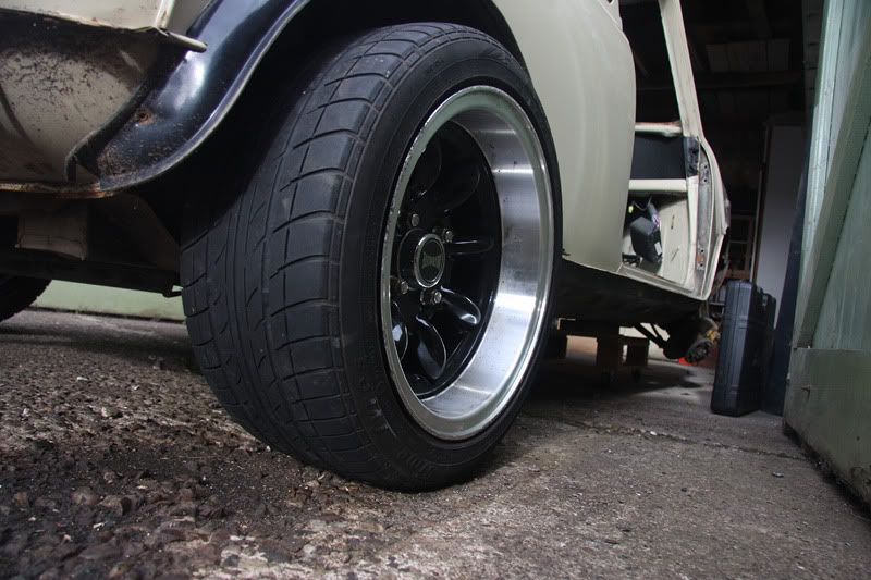

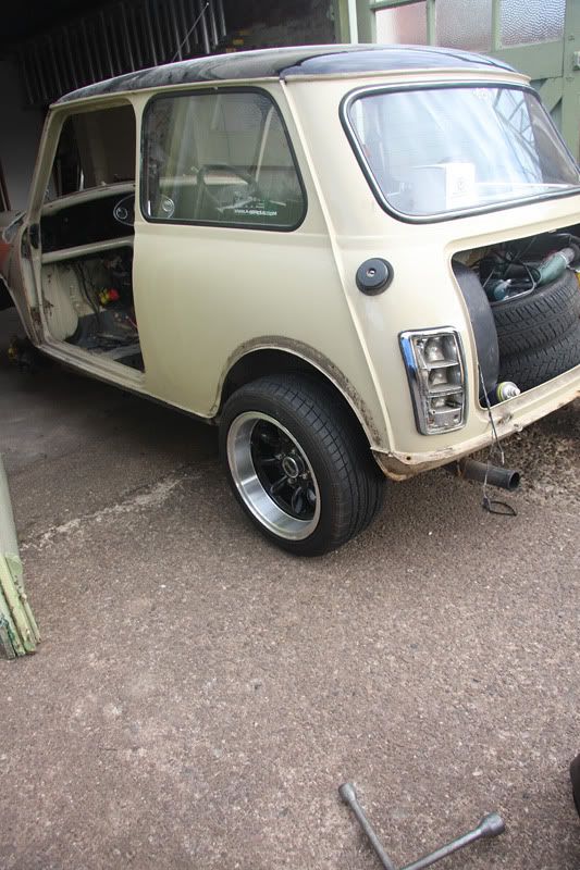

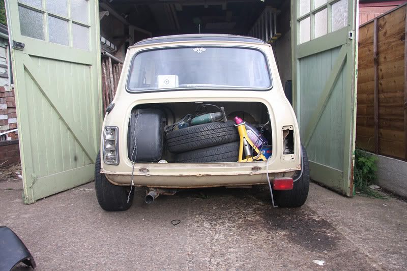

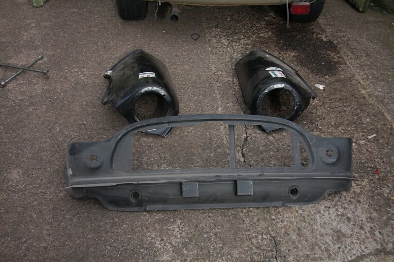

Couple more! :lol:
Front:
Back:

Great going Jean, I'm in awe :lol:

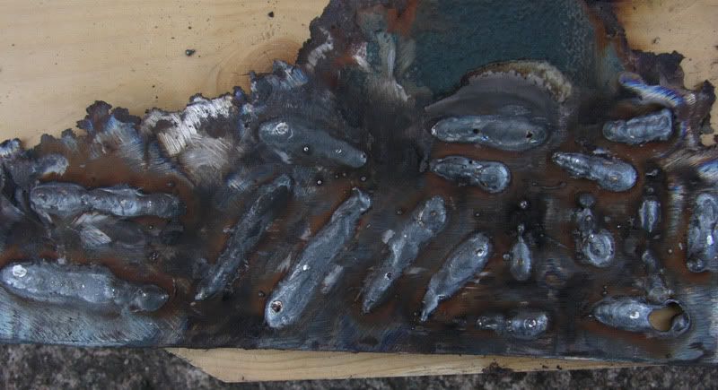

Posted 12 September 2010 - 01:00 PM
Aw, fanks, you! :lol:
More practicing on joining next, methinks :angry:

#1175 pikey7
pikey7
  • 3,824 posts
Posted 12 September 2010 - 08:31 PM
not bad for a virgin ;)
did you try any puddle welding?
and where's the rest of the wheels? That's all we get? :lol:
#1176 Bean
Bean
  • 8,054 posts
  • Name: Jean
  • Location: Malvern
Posted 12 September 2010 - 08:33 PM
Welding in the rain? ^_^ No? ^_^
:angel:
Seeing as it's you ... :lol:

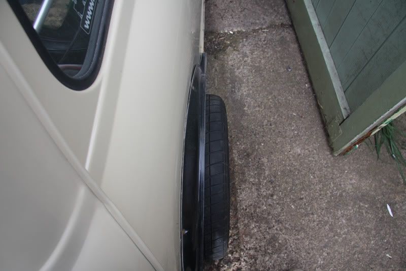

You only get the back ones though - He has no hubs up front that I can attach the other 2 too! ;)

think you need wider arches :lol:

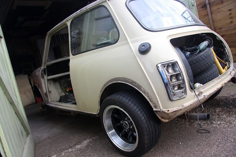

Posted 12 September 2010 - 08:51 PM
That's OK - I already have a test-plan for the arches! :thumbsup: :lol:
I dunno about you, but I think he looks great on 13's! ^_^ I spent 2 minutes changing the wheels, then went to make a cup of tea. Spent the rest of the time just sat on the driveway looking at him! ^_^

13s are the best! :lol: Might need to lower him a bit aswell though... depending on which arch (like i can't figure that out! ;) )
so why haven't you welded the front on yet?

Posted 12 September 2010 - 08:59 PM
because I couldn't get the front end off, then just felt sleepy, so stopped! :angel:
:lol:
I don't have a spot weld drill bit and didn't want to attack the wings with a grinder, so thought it best to wait until I can do it neatly. K reckons the passenger side wing is the original one - It does look like it's never been touched. Which is nice! ^_^ So I'd rather not butcher it, considering it's still in decent condition.
I have all new panels ready, though! ^_^
And yeah, he is sitting very high. But I couldn't see if it was because I'd just jacked him up, because he's not sitting right at the front, or something else. He will be lowered though, as he's having spring suspension & hi-los all 'round ... and depending on whether I feel like it, adjustable shocks.

Oh, and what is puddle welding? :lol:
#1182 1984mini25
1984mini25
  • 8,850 posts
Posted 13 September 2010 - 12:24 PM
When you drill a hole about 8mm ish in the top panel your welding then start in the middle of the hole welding on the piece below, then sort of work you way welding from the centre in a sort of spiral outwards.
Aaaah - I know what you mean - I just didn't know the name! :) Not yet, I haven't - But I will move on to that soon, I hope! :)

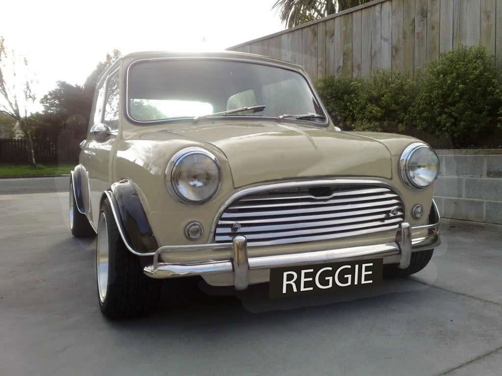

Oh ... and this is what I'm aiming at :P
Not decided on the grill/overriders yet - We'll see :huh:
