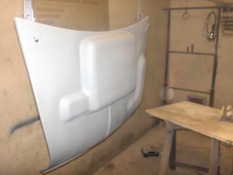

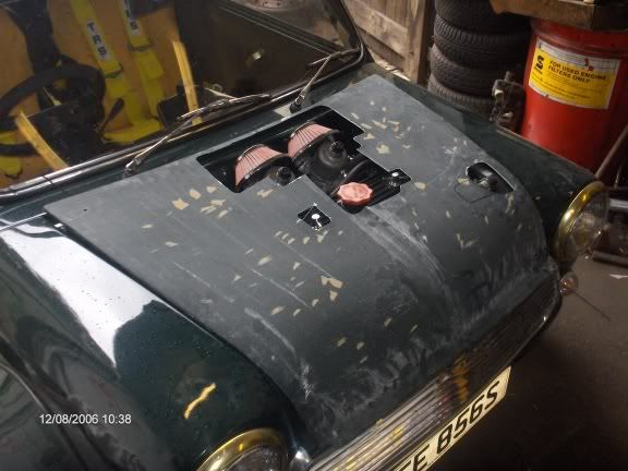

I hope Andy doesn't mind me using his pictures for his Minus but this is how he got around the problem
Two £3.99 roasting tins welded together and sunk into the bonnet,

Front edge where the bonnet curve's down is shorter on a minus to compensate for where the body has been lowered. Believe it was done this way to allow a standard grille to be used.
Minisprint on here used to supply new bonnet's (got mine from him) so might be worth seeing if he's got any left. You could always cut it and make your own bulge.
