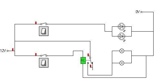

Are you fitting a relay on these lights?
Its looking good though.
Edited by Jackman, 06 January 2009 - 10:29 AM.

Nah I won't be, illegal isn't it?

To relay the lights... nope.
Its to stop the huge load going through the switch and melting it. I have done it on mine.

Ah I thought it made the lights more brighter, easy job to do then?

Crude Diagram.
The first switch is the sidelight so that will just turn on the two sidelights.
The second switch turns on the main beam.
That uses the relay to power the lights seperate rather than through the switch.
Do you understand that?
Edited by Jackman, 06 January 2009 - 10:43 AM.

Yup suprisingly I understand that, gotta sort my current electrics out before I start adding extras in though.
Cheers.

Cool. Its not that hard really and its well worth it.
