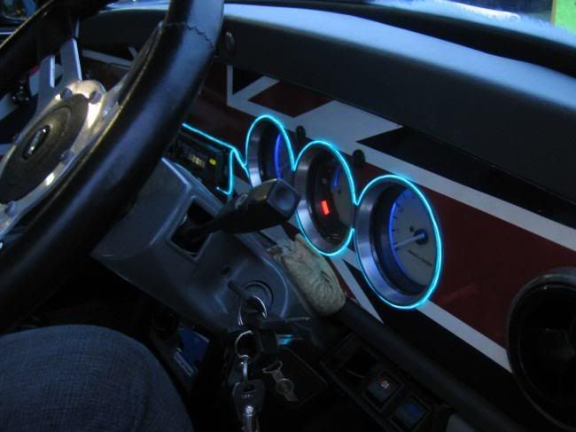

yep,thats the ones that shifty sorted out for me,ive routed them into the pods on the top dash.( see pods in piccy )

its easy , ive done it , okay on the back of your clocks if you have a rev counter theres 3 bulbs in the rev counter its a the top in you petrol and temp gauge its the middle bulb and in your speedo its the top again these are like little black pods that jsut pull out , once you have pulled them out the bulb will be mounted to them , ether repalce the bulb or paint them red like i did , its easy 30 min job max ,

i did mine about 4 year ago with blue led bulbs, was alright but i found the way that the dials are backlight, they didn't shine through that well.
I also added some blue neon wire round the dials
