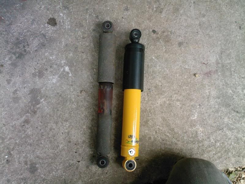

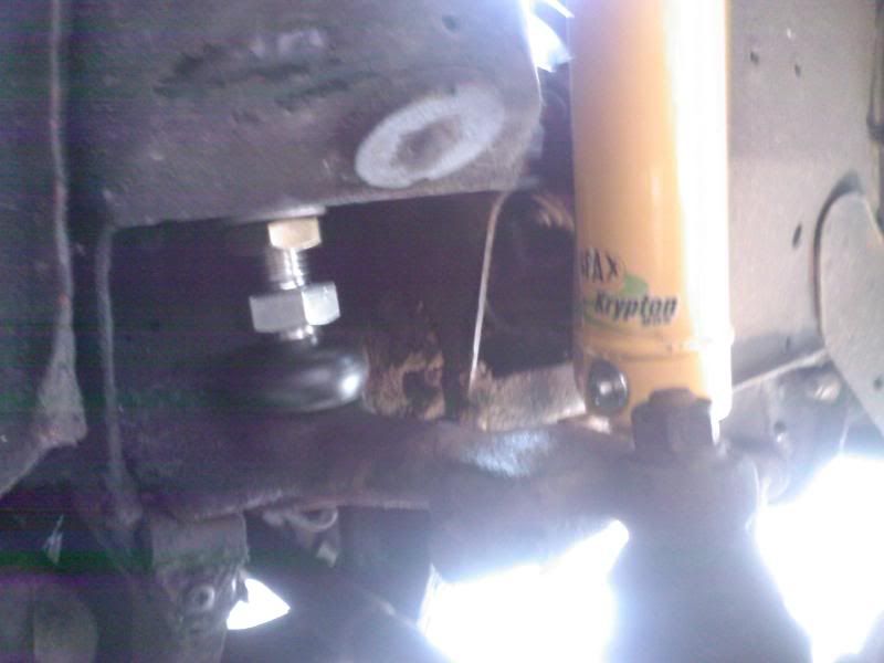

I have been debating for some time lowering it and putting some different wheel arches on the car. make it look a bit more purposful. So i ordered some front hi lows (already had rears), some spax lowered yellow dampers and some fibreglass arches. I also bought a new windscreen seal as mine was letting water pour in (i had to drive home from with 2 to 3 inches of water in my footwells the other day).
After cleaning my garage and sorting different parts i had in it onto shelves i started to change the back dampers. This went very well and there were no problems at all. The front ones were changed without any problems either, which came as a surprise considering the dampers dont appear to have been removed since the car was built. So far i have left the hi lows at the standed ride height to allow the suspension settle and allow me to adjust the dampers until i'm happy with them, then i'll make it as low as is practical.

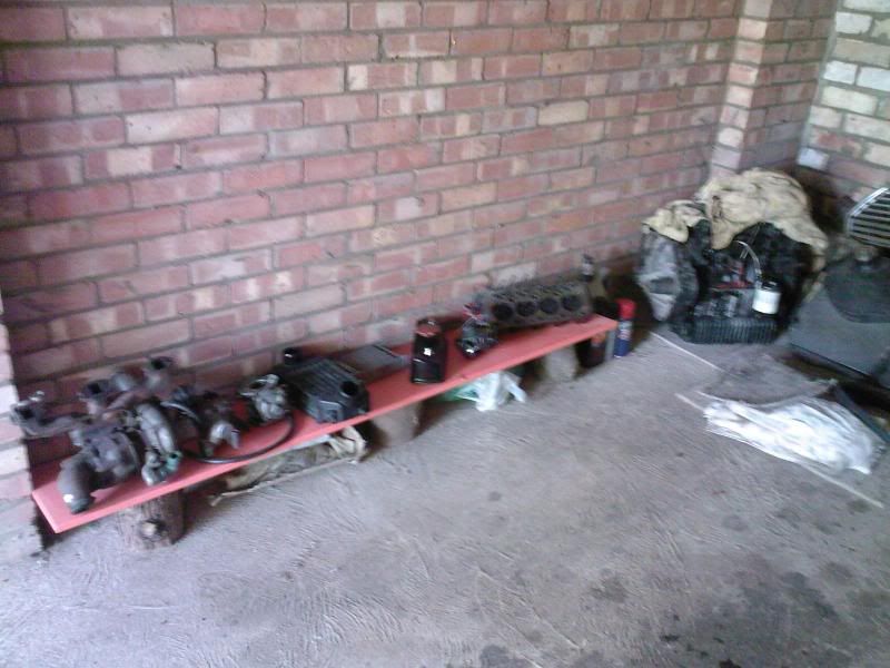

Turbo parts shelf in the clean garage!
Front dampers. old and new (spax lowered)
Front damper and hi low fitted

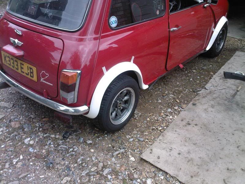

Arches taped onto the side, still need to be cut, fitted and sprayed

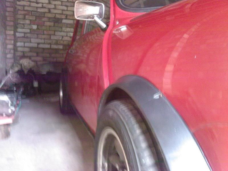

The wheel arches are fibre glass ones that were specially made for Deans Minis (www.deansminis.com), i managed to get the last set. They are similar to the wood and picket ones but are thicker fibreglass. Also they curve around onto the rear valance which finishes them off better than the w&p ones in my opinion. I think they're 2.5in wide, i'll check tomorrow, but i know they just cover my wheels.
anyway i haven't really done as much on the mini as i wanted to but hopefully that will change after MITP when i hope to buy looks of engine goodies!
Work done over the past week:
I have started to cut and file the slots in the wheel arches so that i can spray them up and have them on before some up coming shows. I've realised that im going to have to cut some more metal out of the front arch so i dont have any rubbing issues when i turn.
After i'd let the suspension setting for a day or two i decided to adjust my new dampers. I followed the manufacturers instructions and turned them up until it felt right. then my curiosity got the better of me! "how stiff can the hardest setting really be?" i thought! so i cranked them all up to max, after hopping down the road for half a mile i'd had enough and had to turn them right down again. once i had sortied the dampers out i adjusted the hi-lows to get the low down look. After burning off a lot of my rear arches (not the new ones) on the way to work i had to raise the hi-lows up a little nit again. Now its at a safe height that still looks quite low.
Up until recently i had overlooked the suspension and concerntrated more on the engine and styling but since i upgraded it i have been amazed at the difference it has made! the handling is far better and it's much more comfortable too. This is probably the best upgrade that i've done to the mini so far.
Here are a couple of pictures of it when it was too low. It was actually a bit higher than that (not much), but it was sat funny on the drive which made it look even lower!
