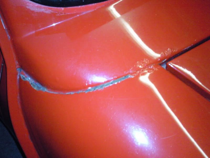

I also had a little prod around the rust bubbles on the front end to see the extent of it. At the moment it seems like its mainly surface rust but i also found a point where the front panel had a little split in it. I'll have to have a better look around it (when it's warmer) before deciding whether i'm going to repair and respray the affected areas or go to a fibreglass flip front (which i am very tempted to do anyway!).

Anyway, here are a few pictures of the rusty spots and split i had a prod at.
Guennie
here's the split

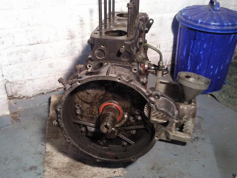

Block

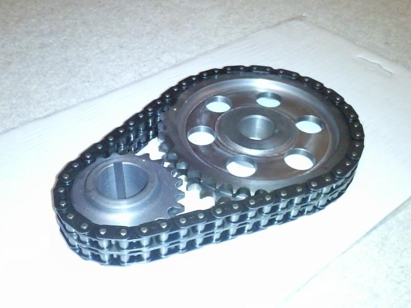

Lightened duplex timing chain

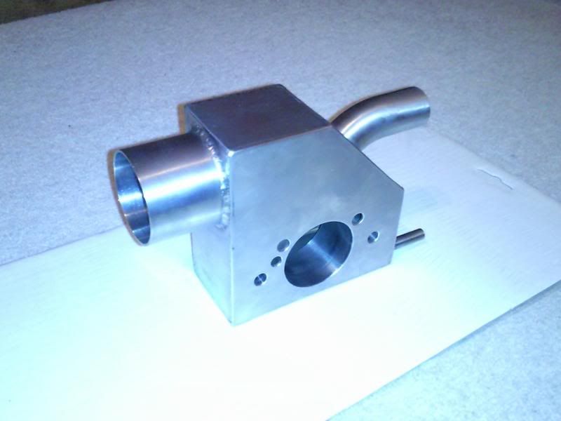

Plenum chamber (modified for intercooler and dump valve)

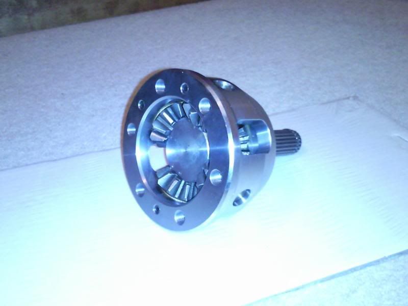

X pin diff

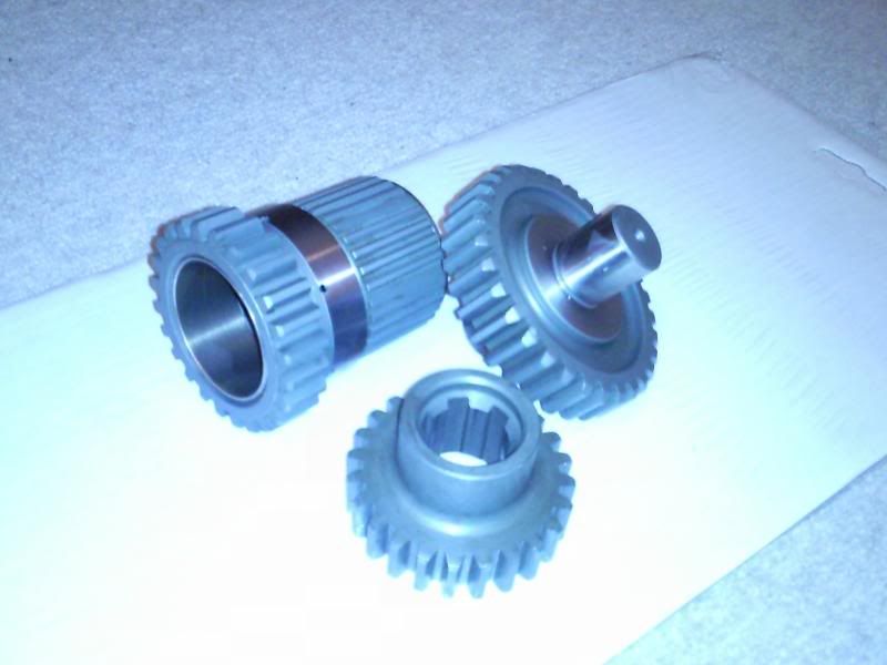

Straight cut drop gears

Who knocked the plenum up? Looks like a nice tidy bit of work :)

Who knocked the plenum up? Looks like a nice tidy bit of work :(
I bought the Plenum from a guy on the Turbo Minis forum. I think his mate had made a whole load of them a while ago. It's really nice though, and the welding is absolutly spot on!
