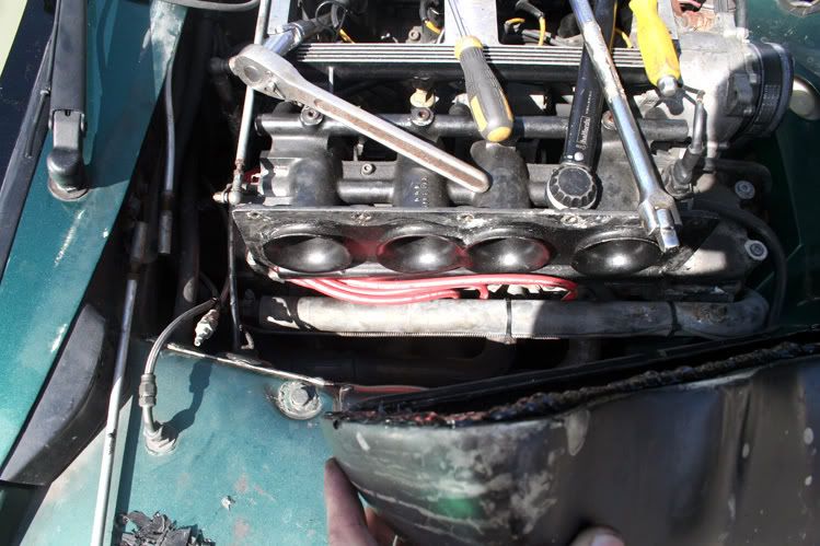

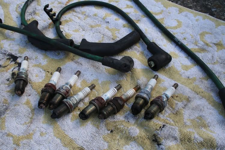

Spent the whole of Saturday working on it, had to change the plugs and leads. It wasn't ever so difficult, although I did spent a good two hours modifying a spark plug socket to enable me to get it on the plug! As you can see the plug is sunk into the block, and the head studs/nuts and exhaust and cooling pipes make access a little on the difficult side.
Anyway, got the old plugs out and leads off:
And new plugs (NGKs) and leads (Magnecor competition) on:

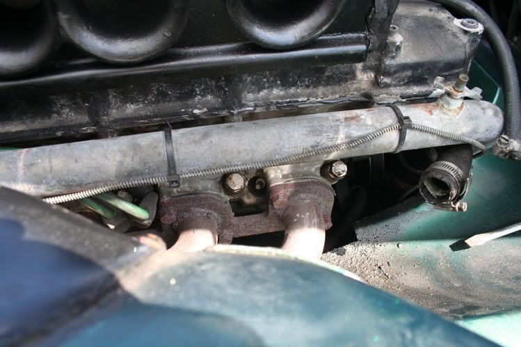

The car ran much much better after this, especially pottering about out of the power band. Sounded and drove much smoother. Unfortunately whilst doing this work I noticed that both exhaust manifolds have cracked! :thumbsup: Both in the same place too. At first I was expecting a big bill (brand new they are £300 each), but then thought I should be able to get them welded. After enquiring on PistonHeads I found out they are only mild steel, so I can weld them myself with my MIG welder! :D Just going to be a weekend job to get them out, mended and put back in! ;) Oh, changed the burnt out wiper hose whilst I was in the engine bay for a new section and windscreen washer work fine now! :w00t:
