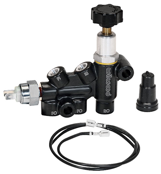

Ok so this is a 74' mk3. The previous owner gave me a new single line master brake cylinder. But with the old stuff their is a dual line master cylinder with the yellow tag. I was thinking of buying a new dual line master cylinder and change everything to the dual line front rear split. Will this system fit my car? I have 4pot metro discs on the front and normal drums on the back.
Will the wilwood Combination Proportioning Valve work with this new setup instead of buying this( http://www.minispare...ic/FAM7821.aspx )? which is out of stock and more expensive than the wilwood one.
