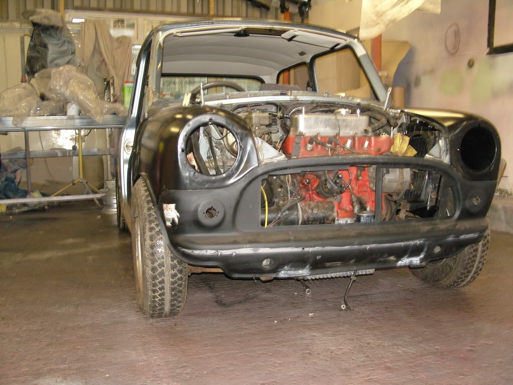

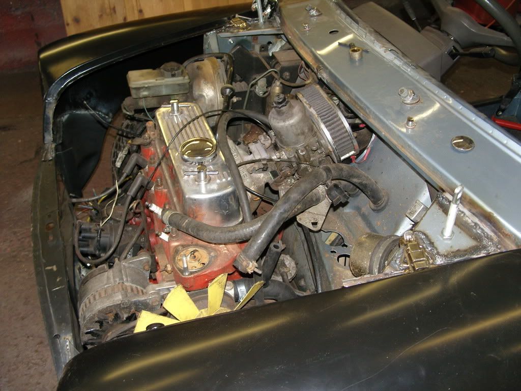

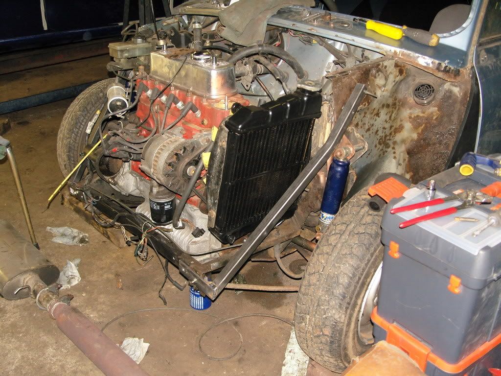

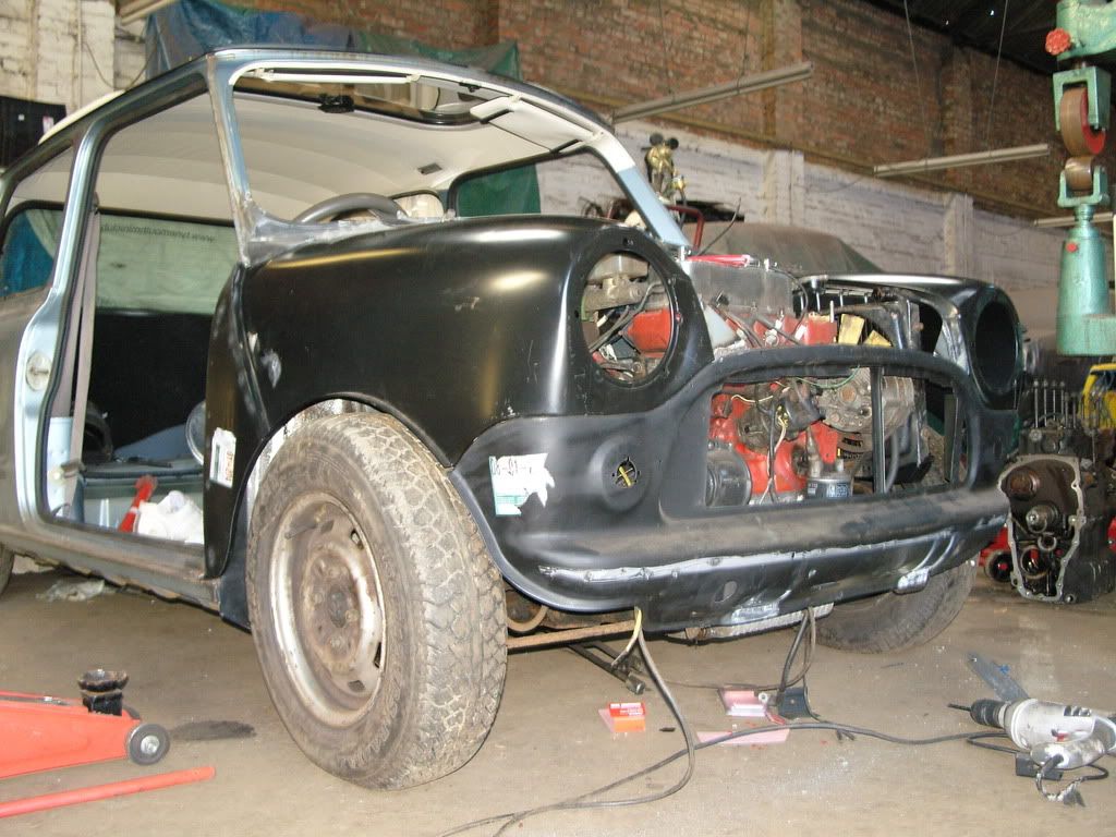

Posted 08 March 2008 - 10:31 AM

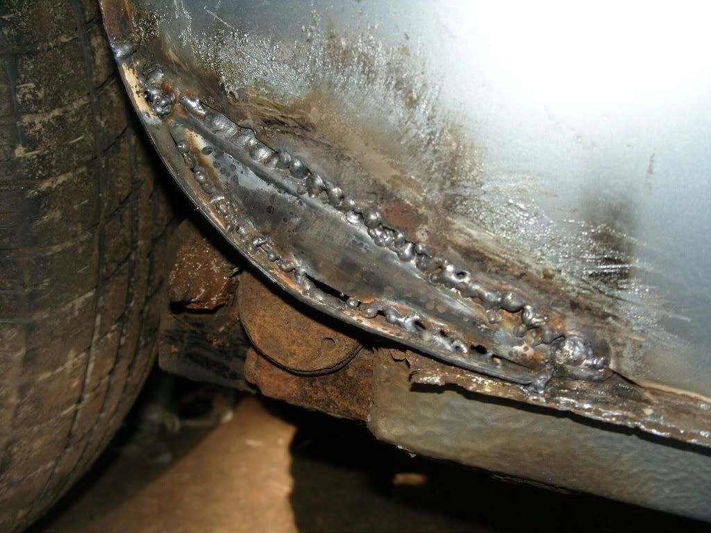

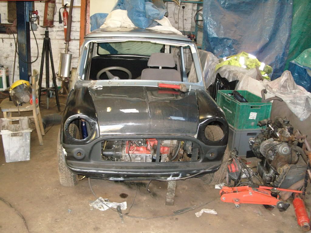

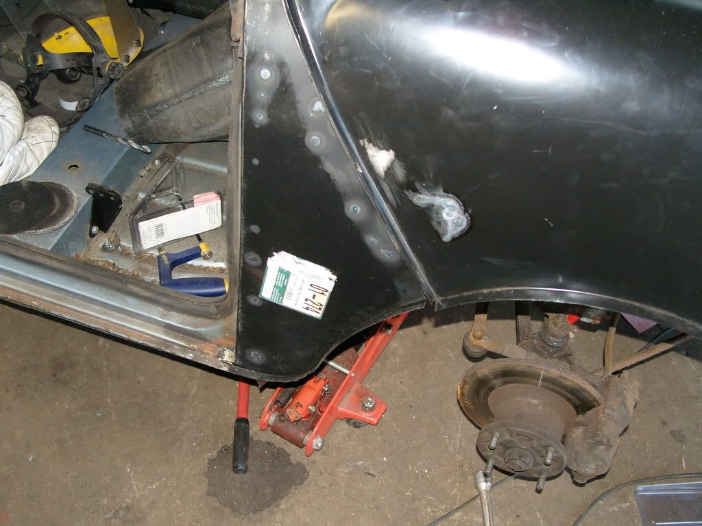

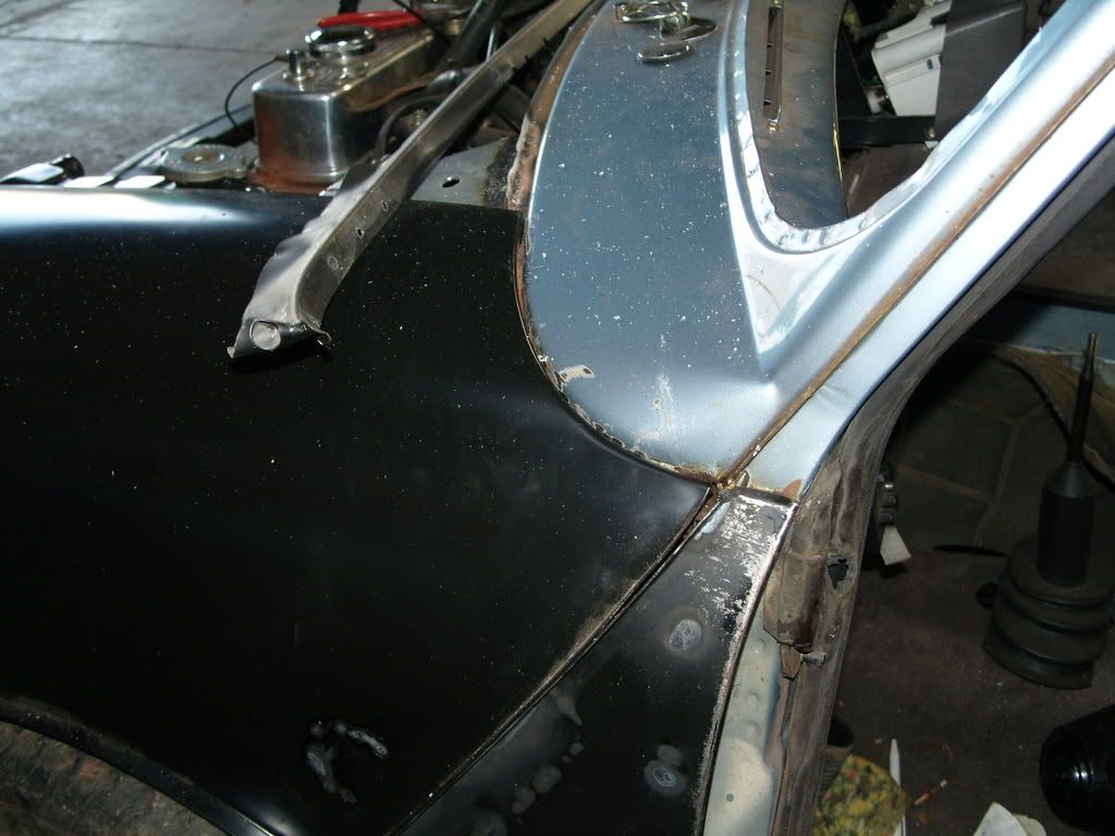

some piccies of what got done yesterday

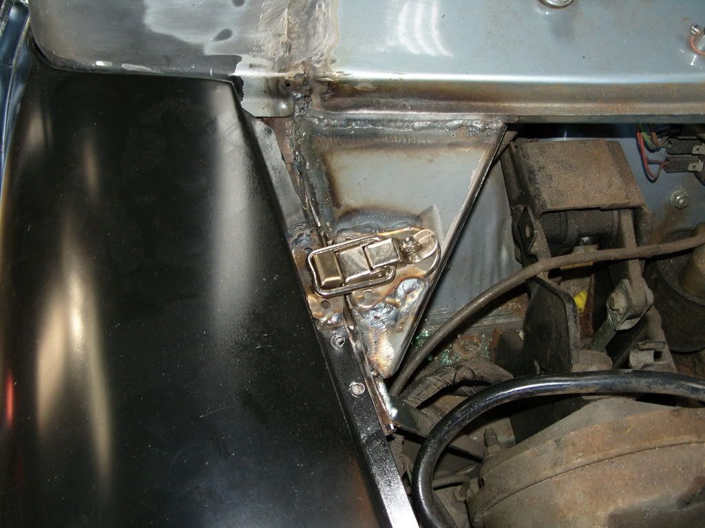

welded in these catches to hold the wings to the car

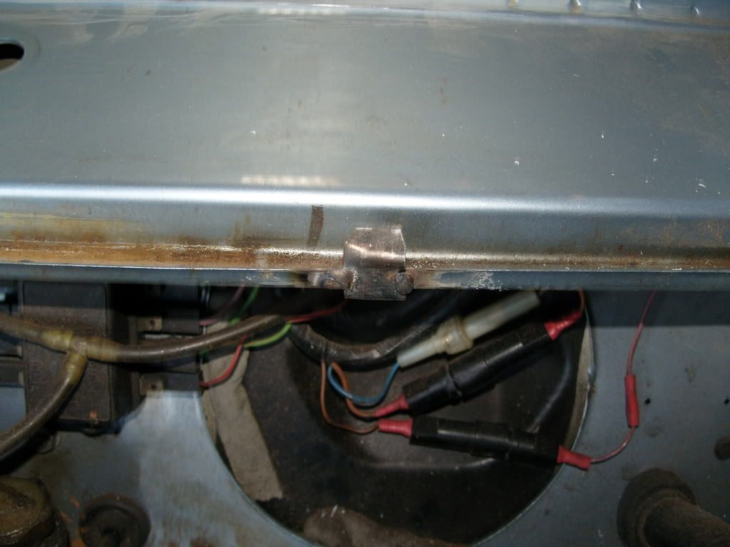

thats also done between the wings and A panels

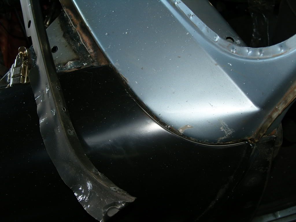

rear quarter repair
lines for wings meeting scuttle
removing the bumper lip

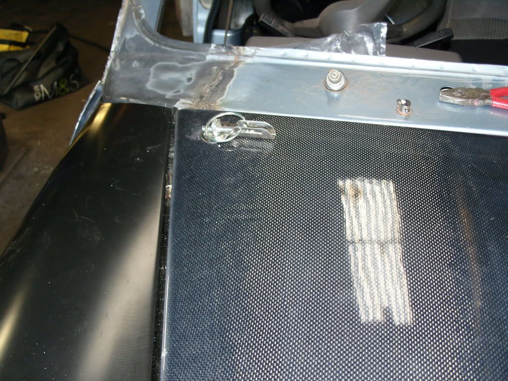

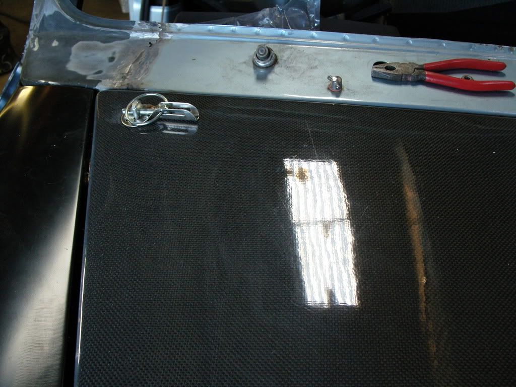

had to weld this in to raise the bonnet at the back as it must have sagged a little in the middle
bonnet lines
i think the bonnet is slightly narrower than the average metal one, lines seem to be a tad bigger.
>_<
