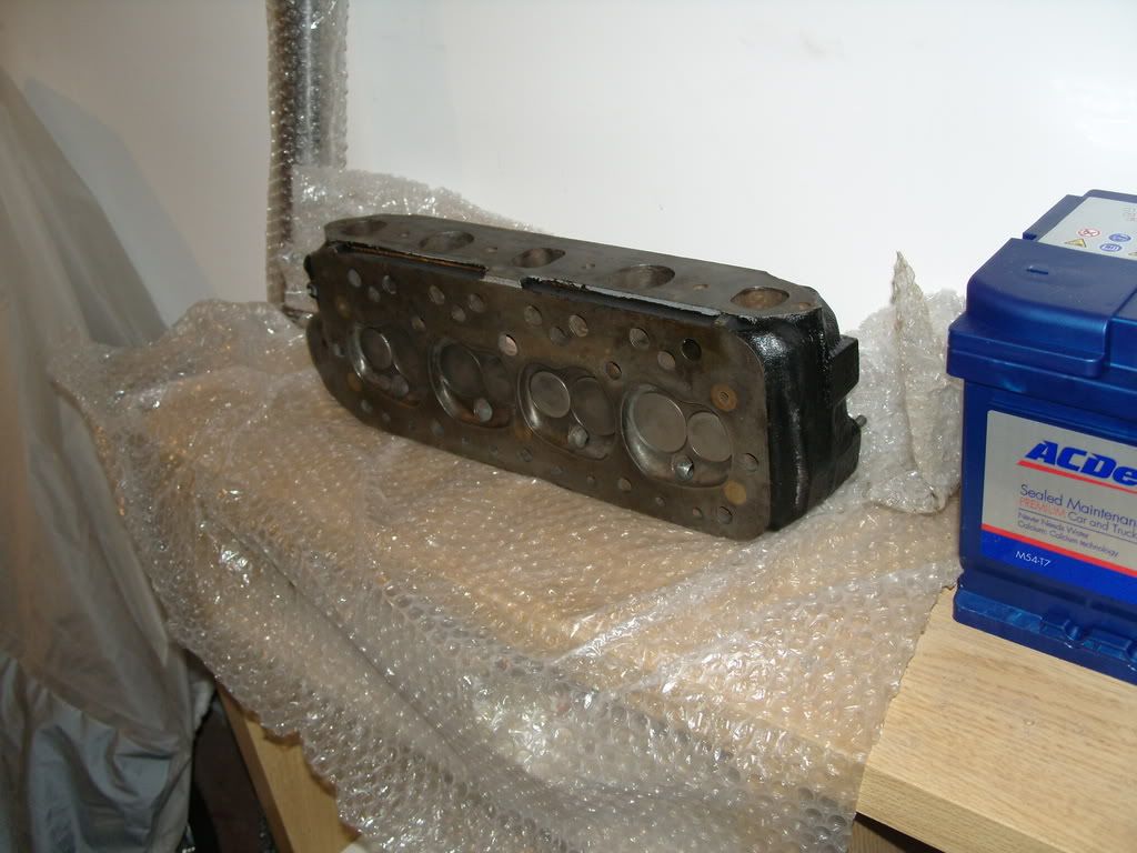

Mg metro block bored 60thou to 1330cc
Stage 5 cylinder head, 37.5mm inlet, 30.6mm exh
Kent Megadyne 286 Cam
Turbo oil pump
Duplex timing gear
Fully rebuilt bottom end etc.
HIF44 Carb, with weber style K&N filter and a Straight through exhaust system.

So the quick spec.
Turbo oil pump
Duplex timing gear
Good lord! i thought it was just a standard rebuild, where did that lot come from?

stage 5 head

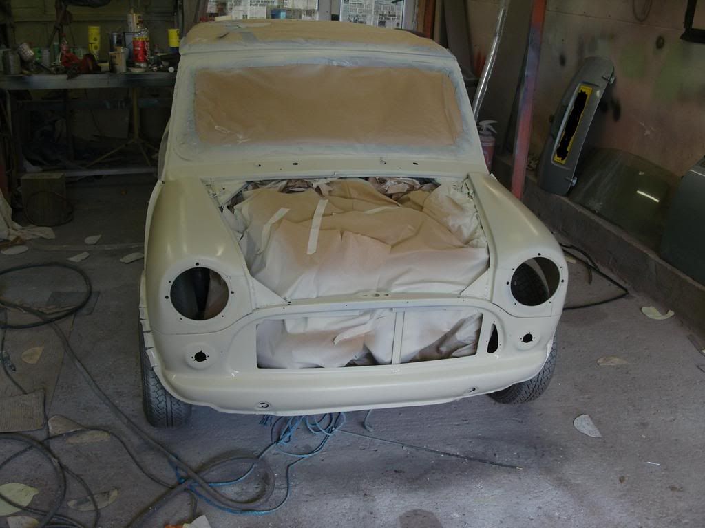

might be in primer tomorrow night ?

a coat of 2k primer to go on tomorrow, and top coat and laquered on saturday
then we can start playing with new bits and bobs
