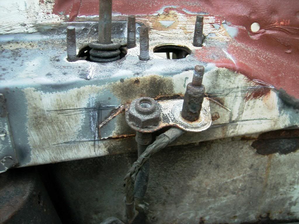

then yesterday i repaired the bulkhead
first layer
second layer

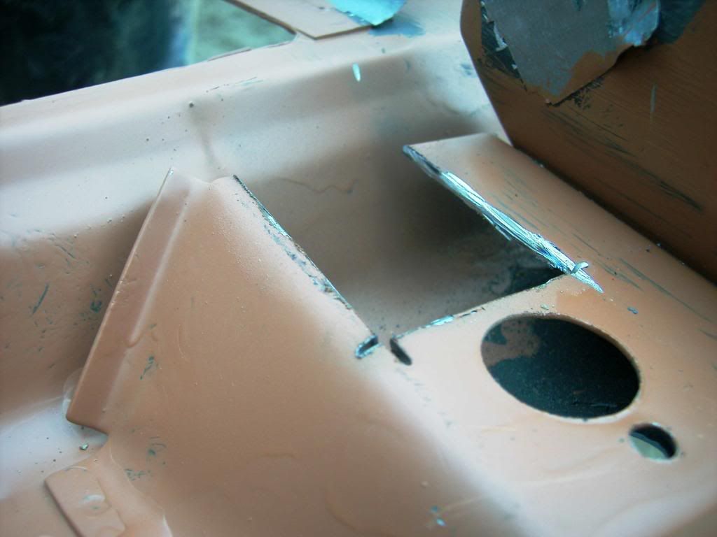

then a tackled the shock mount

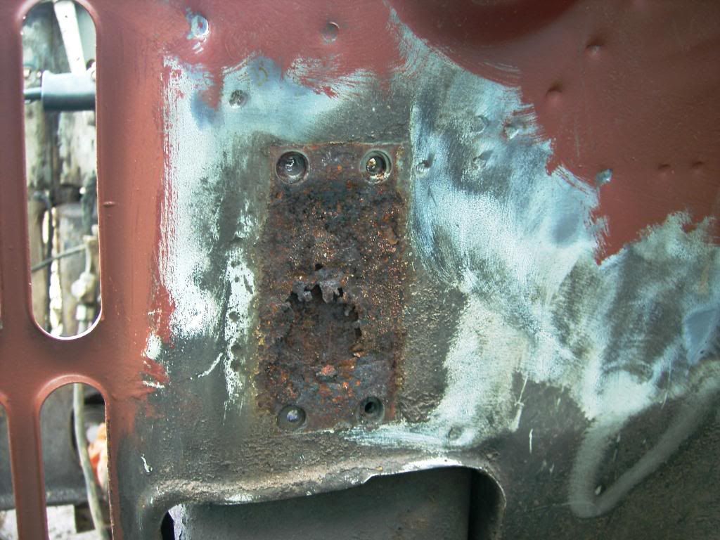

repaired and cleaned up the inner wing

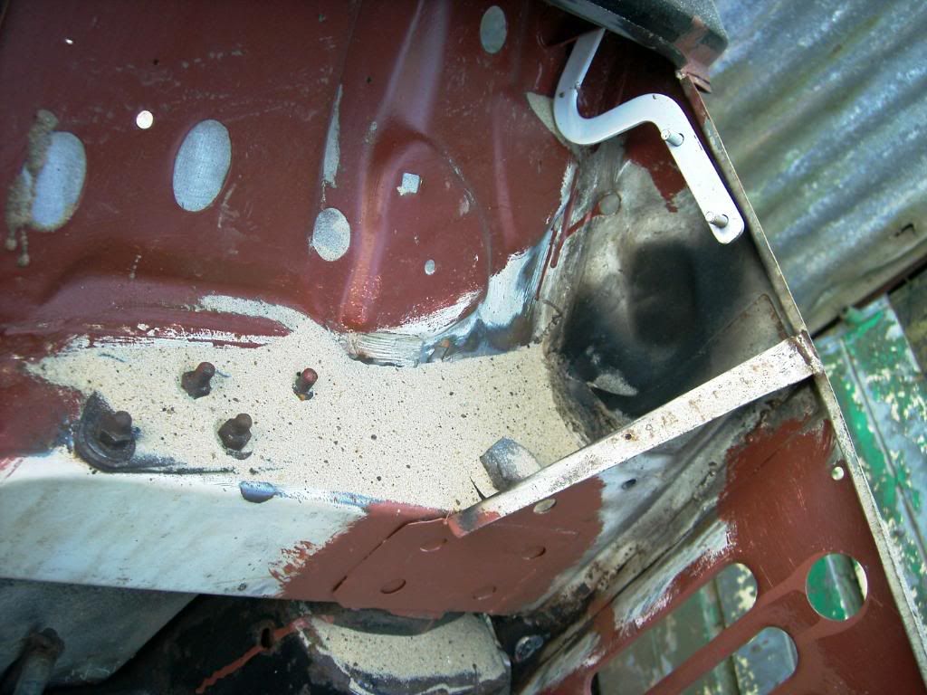

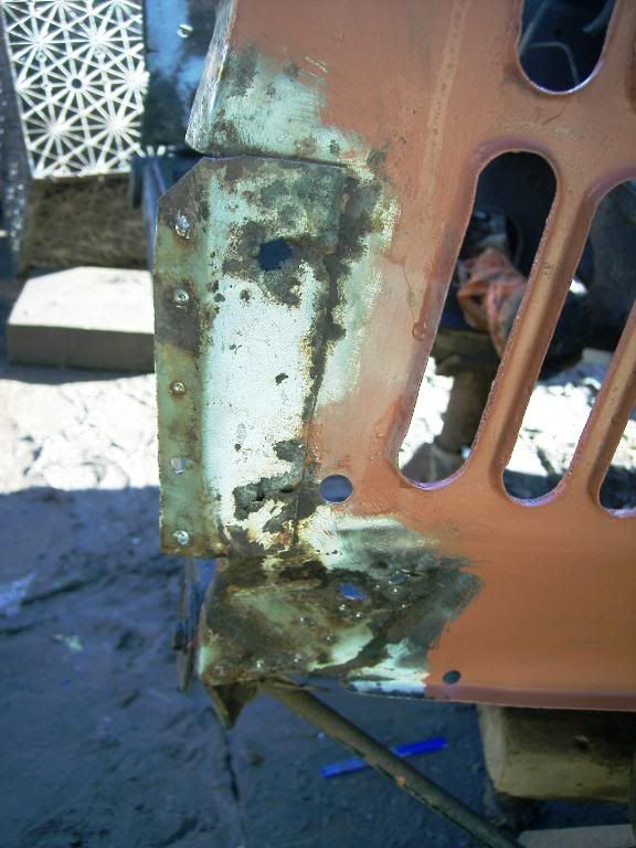

ok so today started with the rust on the inner wings
and repaired

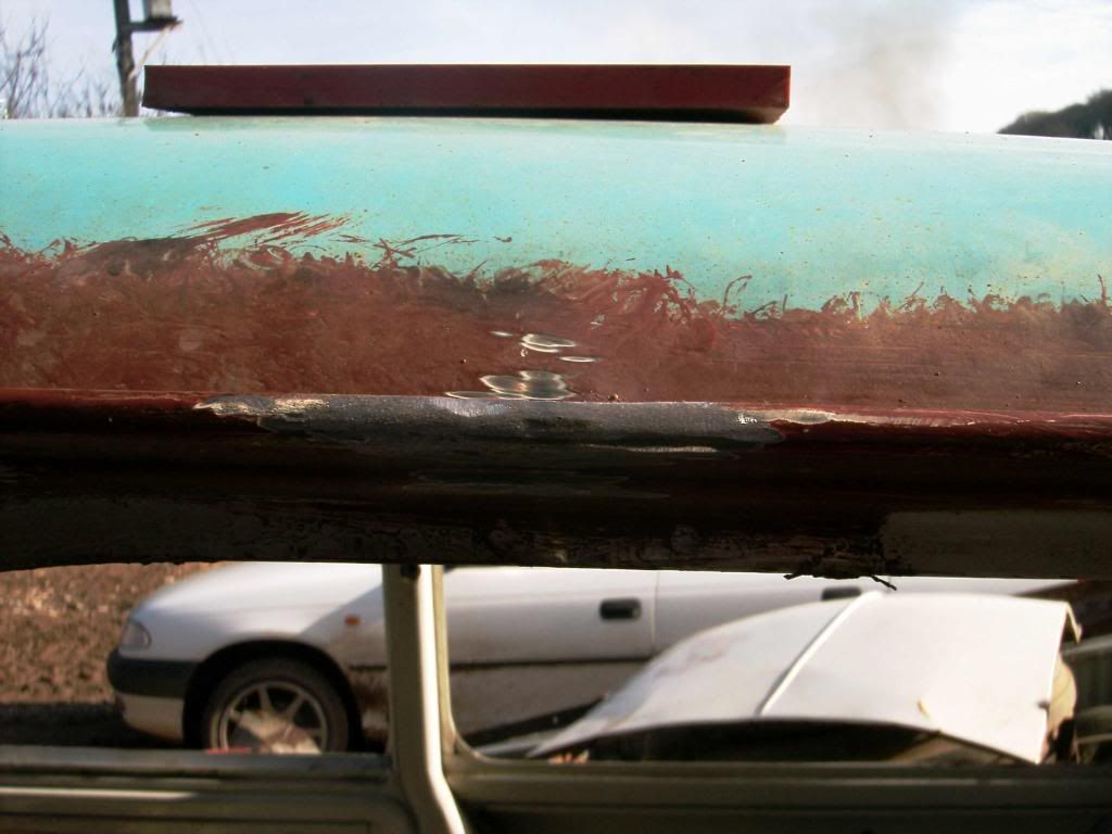

i also blasted in the corners of the roof gutter on the body, as its impossible to get in there with anything else, and is one of the only places were my mini is rusting.

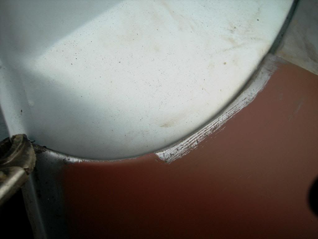

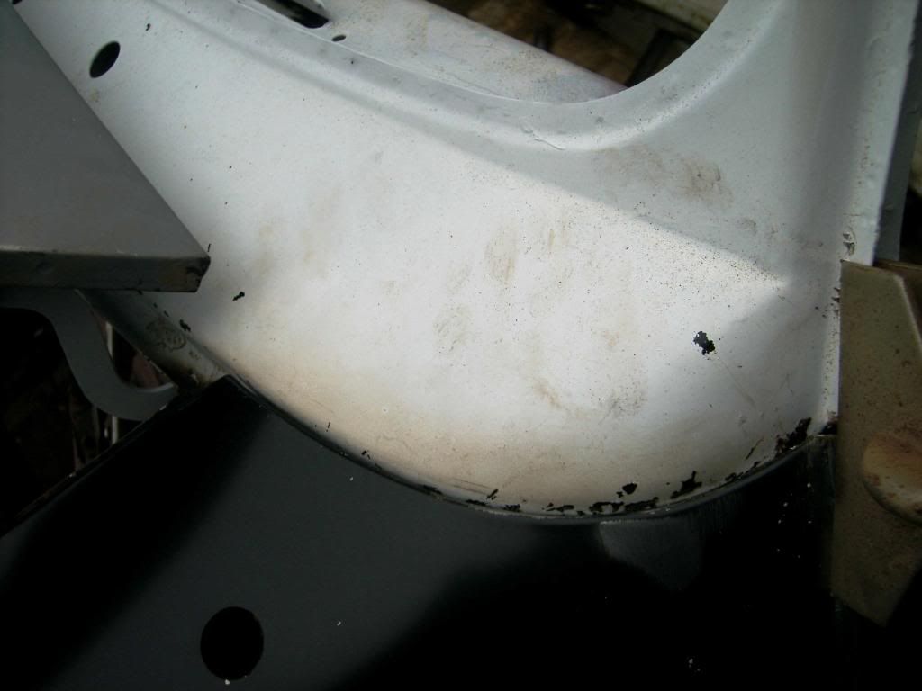

then i cleaned up the inner wings and replaced this
with a lovely new one!!!
then red oxided everthing and painted the scuttle and windscreen surround/roof gutter white

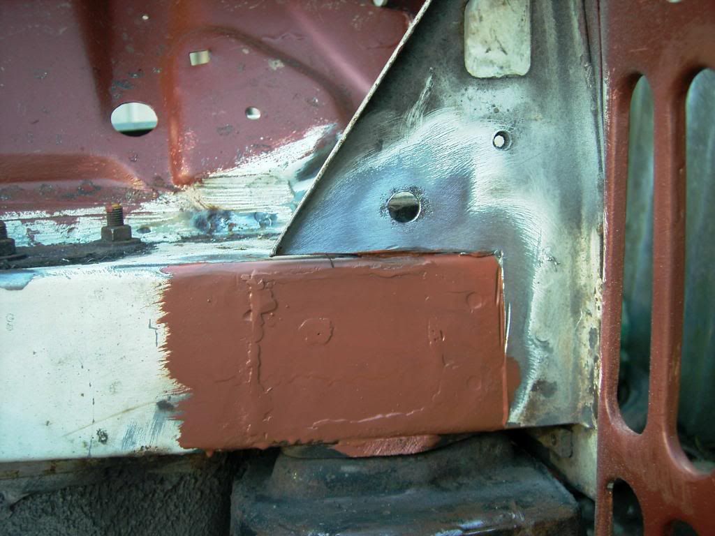

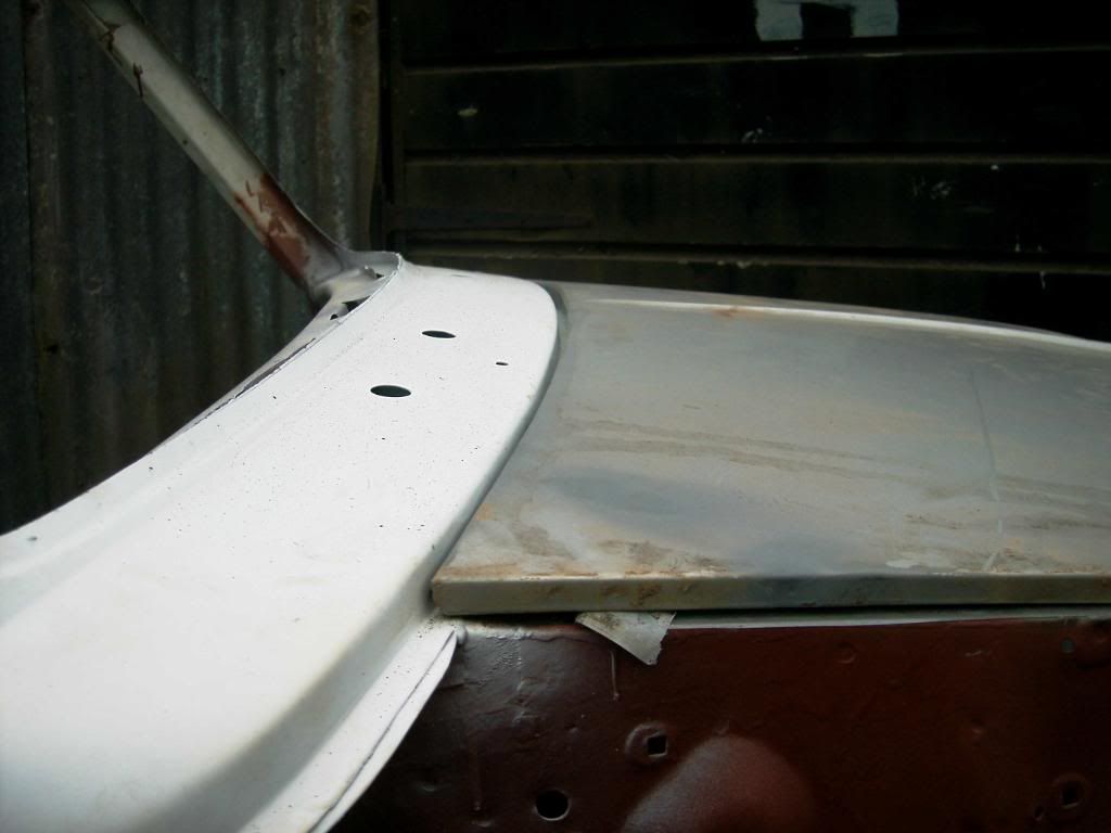

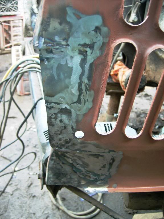

so the plan for tomorrow is to replace the top corners of the inner wing, where i got a bit carried away when we fitted the scuttle!!
and clean up the new panels (ones been sat for about 5 years) ready for the fit on the weekend. they aren't gen panels aswell as i brought them before i started the build and knew how bad they fit, so fingers cross everything will go on alright!!!!

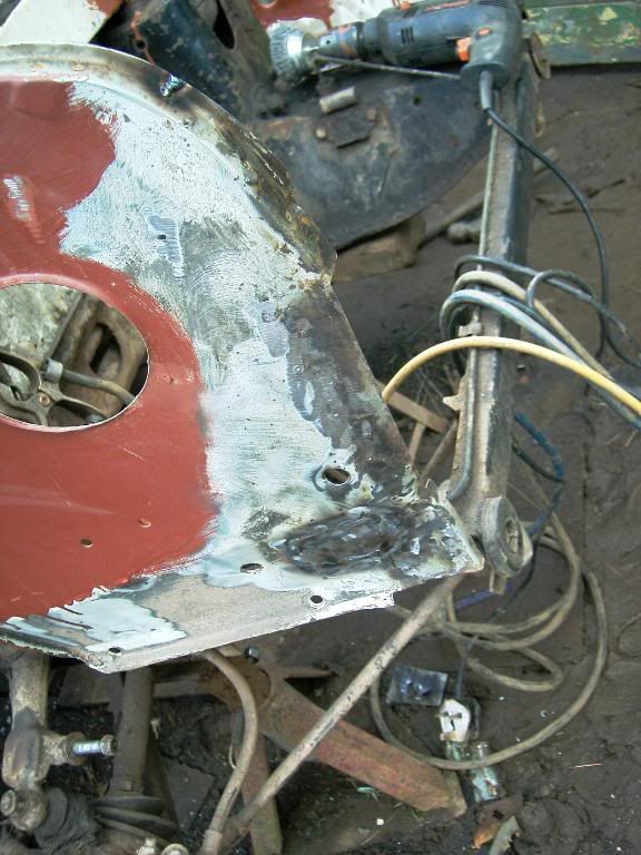

the driver wing started like this.....
i couldn't believe it was so bad, i stripped it back a few years back and painted it with the paint we were using as a unrust..... it was pants!!!
anyway quick wire brush/ sand disc on the drill, and sandblaster, it came up alright, so now its red oxided and all ready to be fitted

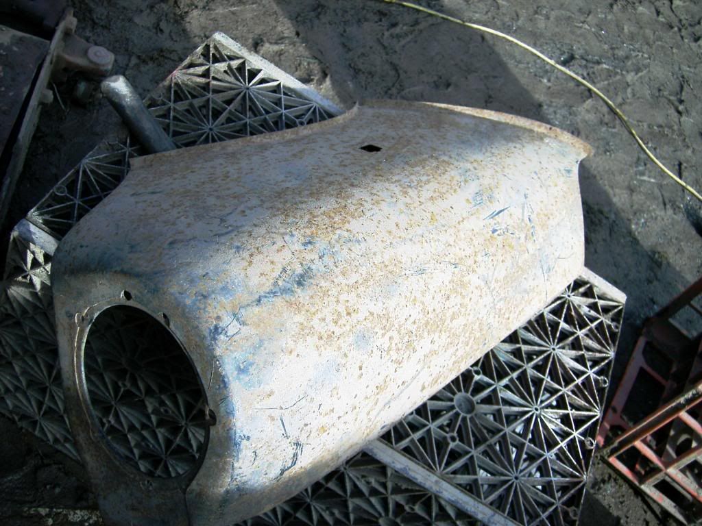

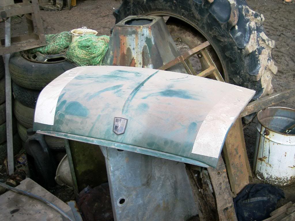

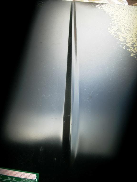

the other major shock for today was the bonnet, i brought it at bingley hall in 2007, as i knew the sky needed a new bonnet, any way,
so i unwrapped it to find
which the centre line is no way near the normal line
so i was hunting round for a another bonnet to use, and found that almond green one, but thats quite rusty, well too rusty for the sky!!!
a pale metalic green one, which again had rusty issues, than a silver one with a bit of surface rust, so that came out and i'll be using that
even if the new bonnet fitted perfectly i would hate that centre stripe and it would bug me forever!!!

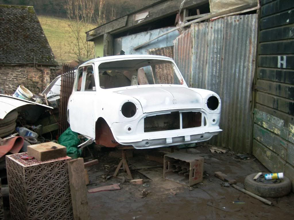

ok so yesterday i put the bonnet on and bolted the front panel on
the bonnet
much better than the cheap pattern!!!

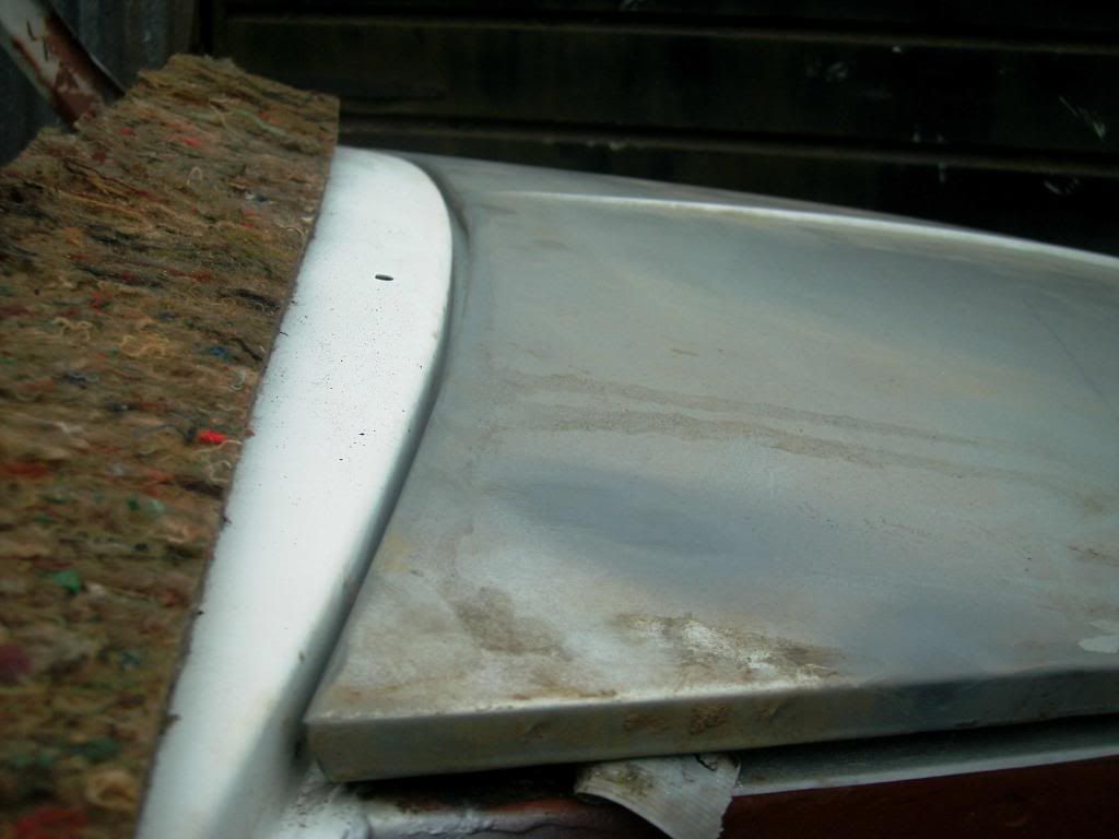

welded up the crack
fitting it after much fidding around, it sat too high in the middle
so i took it off and bent it to fit

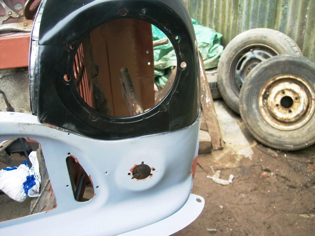

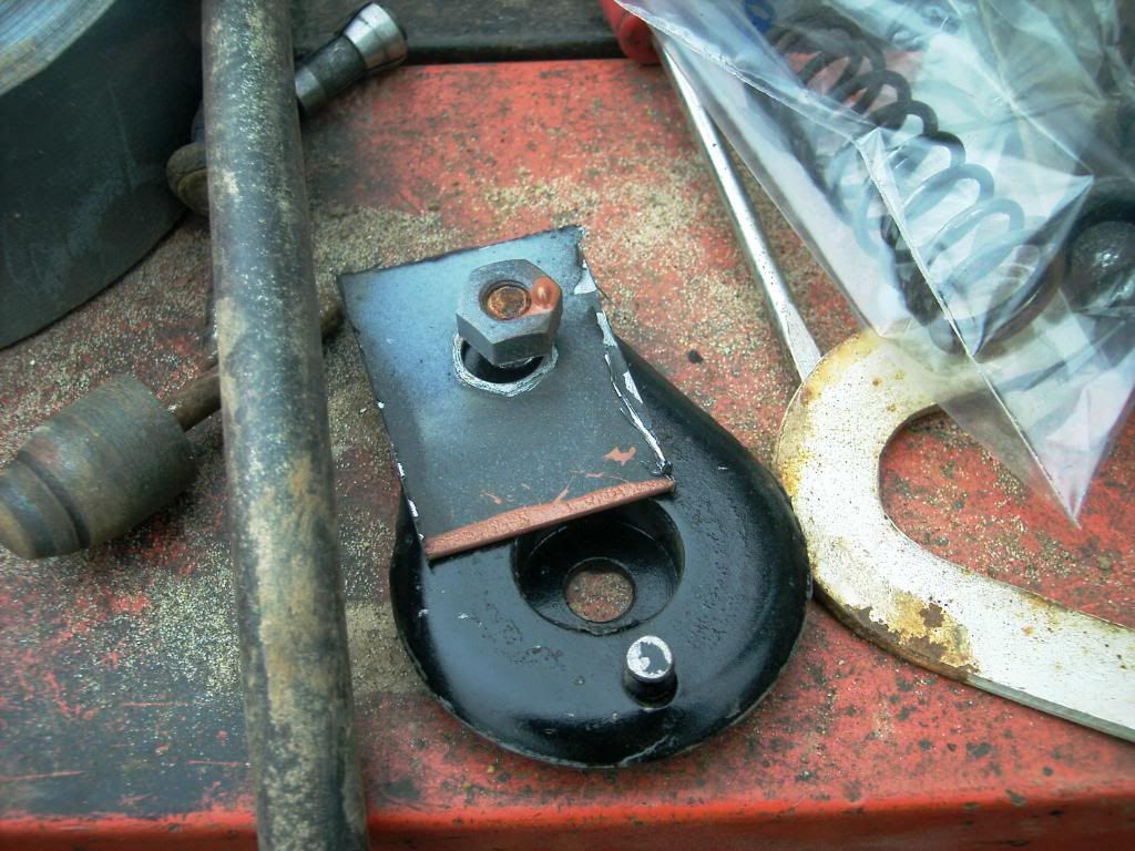

then started on the front panel, tried to bolt the teardrop mounts on and the hole wasn't in line to bolt it one, but i could get the bolt in, so i tighthened it up, then
the nut came out of its holder, so i cut it out of the front panel
welded the nut back on, and welded it back onto the front panel
for the other side, i just made the hole bigger on the mount!!!
so bolted the front panel on
shut the bonnet

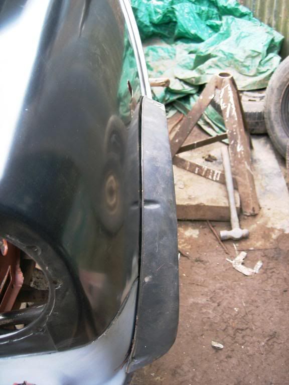

hmmm, the other side was fine, but the front panel was thicker on that side than the other!!
anyway, so rested the wings in place
drivers
lovely fit at the scuttle, but the front panel was out
passenger
scuttle was out
and didn't even bother with the rest!!!

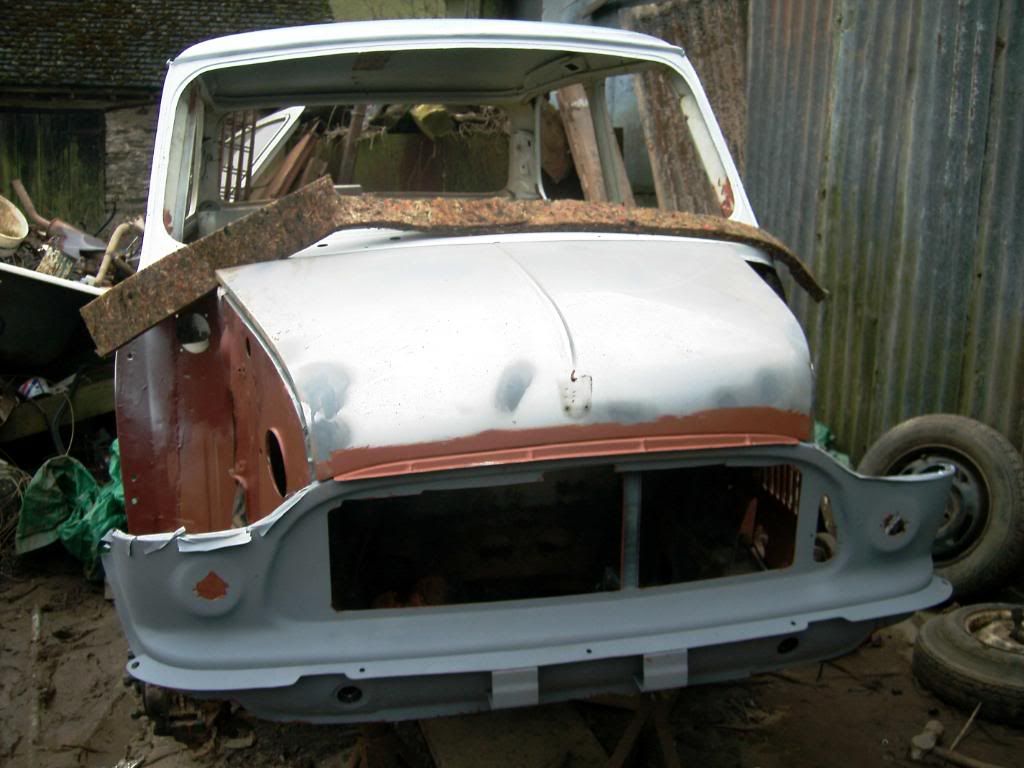

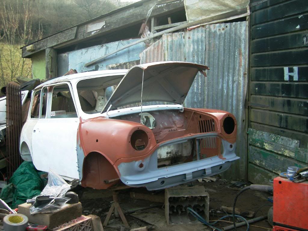

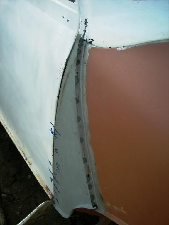

so today, with my panel beater dad on hand the scuttle gap went to
and with a lot of work
the driver wing went on without any alternations and dad managed to pull the gap on the front panel out
then driver a panel
and door, after i had to add another door shim to the top hinge, it must of disorted when i welded the inner finch in!!!
then passenger a panel
which is almost there just needs a little bit more work, but it got too dark to do it!!
so thats it the front end is in place, held on by 3 rivots and about a million clamps!!!
tomorrow we will do the final work to the a panel and a bit more clamping, then the spotwelder will do all the hard work welding it on!!! then we'll drop the front subfame to get the spotwelder on the pig ears to spot them on!!!

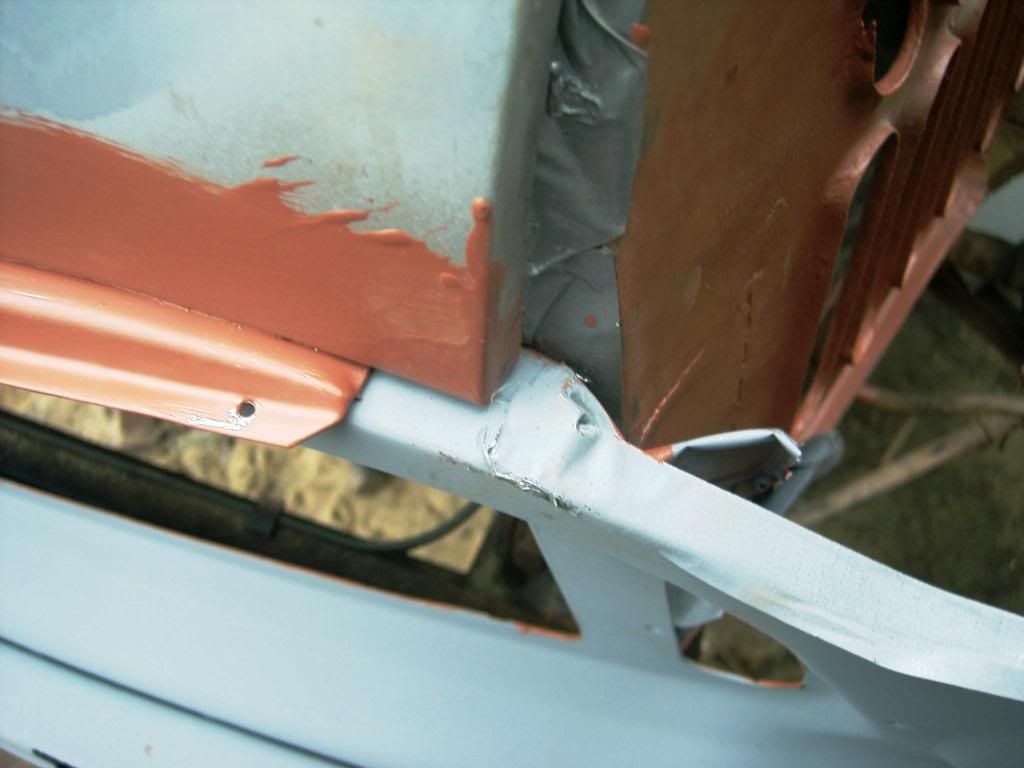

anyway, the front end is 95% welded on, we just need to be the 'pigs ears' on the front panel with the spot welder and braze the front seams around the headlights and bumper lip!!!

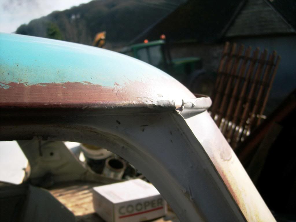

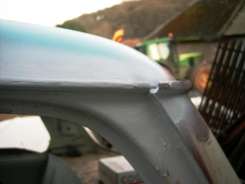

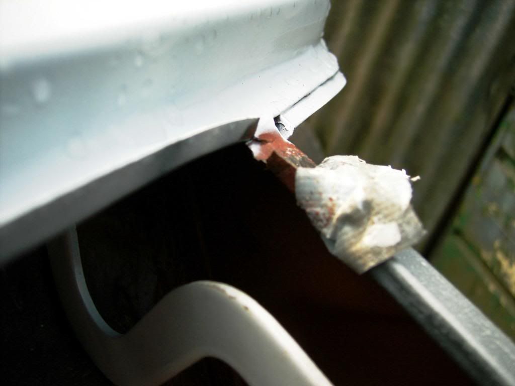

ok so i came up before dad and tackle the roof gutter rust

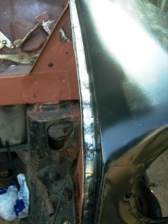

then dad came up and we spot welded the wings to the inner wings
and the driver a panel
then with a bit of adjustment (with a hammer) to the electodes to bend them out to get into the seam the passenger a panel
we couldn't get the spot in the inner arch and on the headlight seam, so dad mig'ed it, he like to take over....

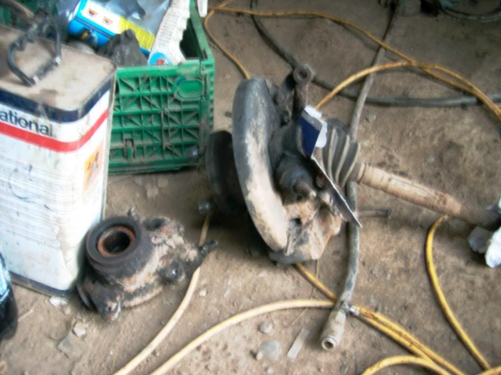

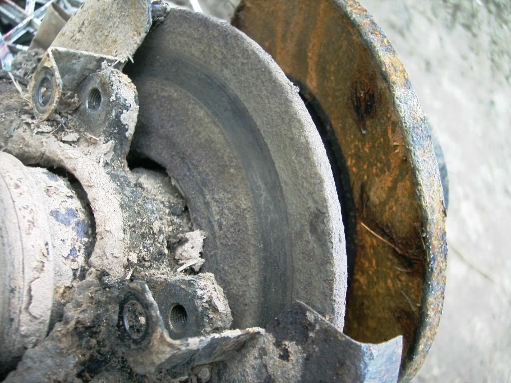

and i took the hubs off
i couldn't believe how thin the disc were, compare to one that was on my mini for about 2 years/30-40k
yeah i'm sure they were brillient brakes, i think the sky hasn't quite been aswell looked after as it should of done.....
so anyway i stripped the hub down to this

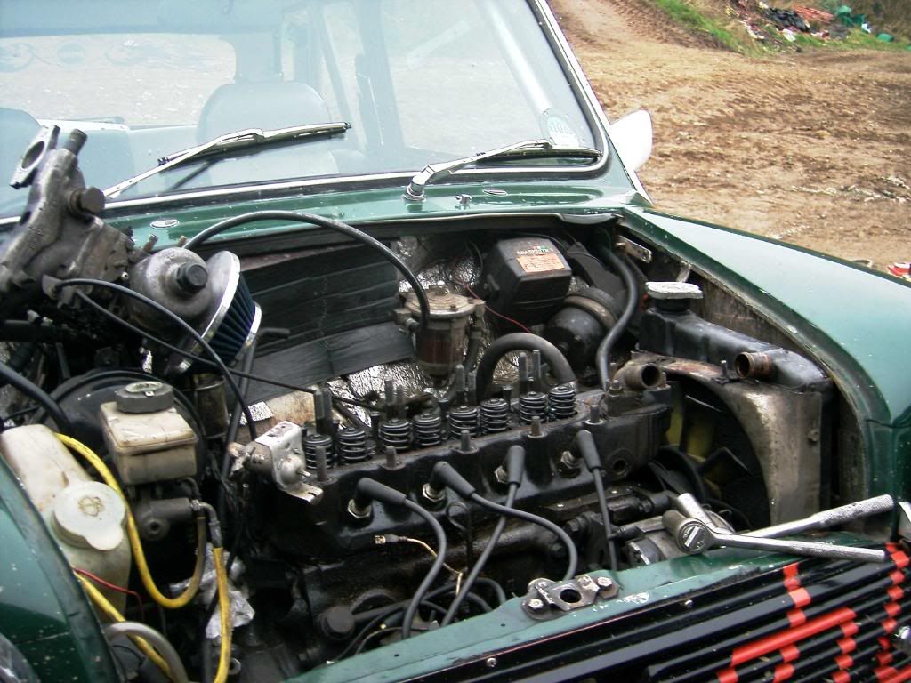

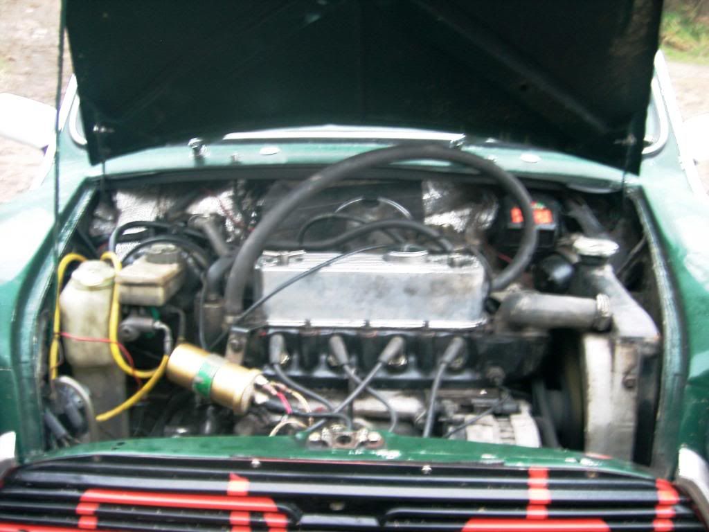

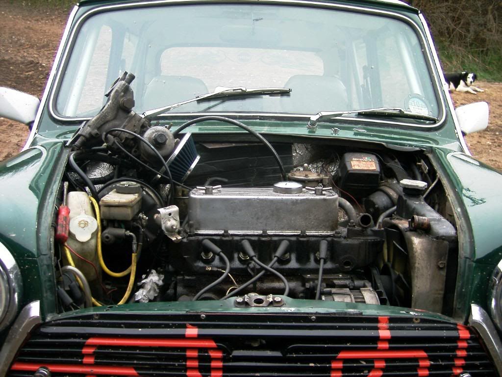

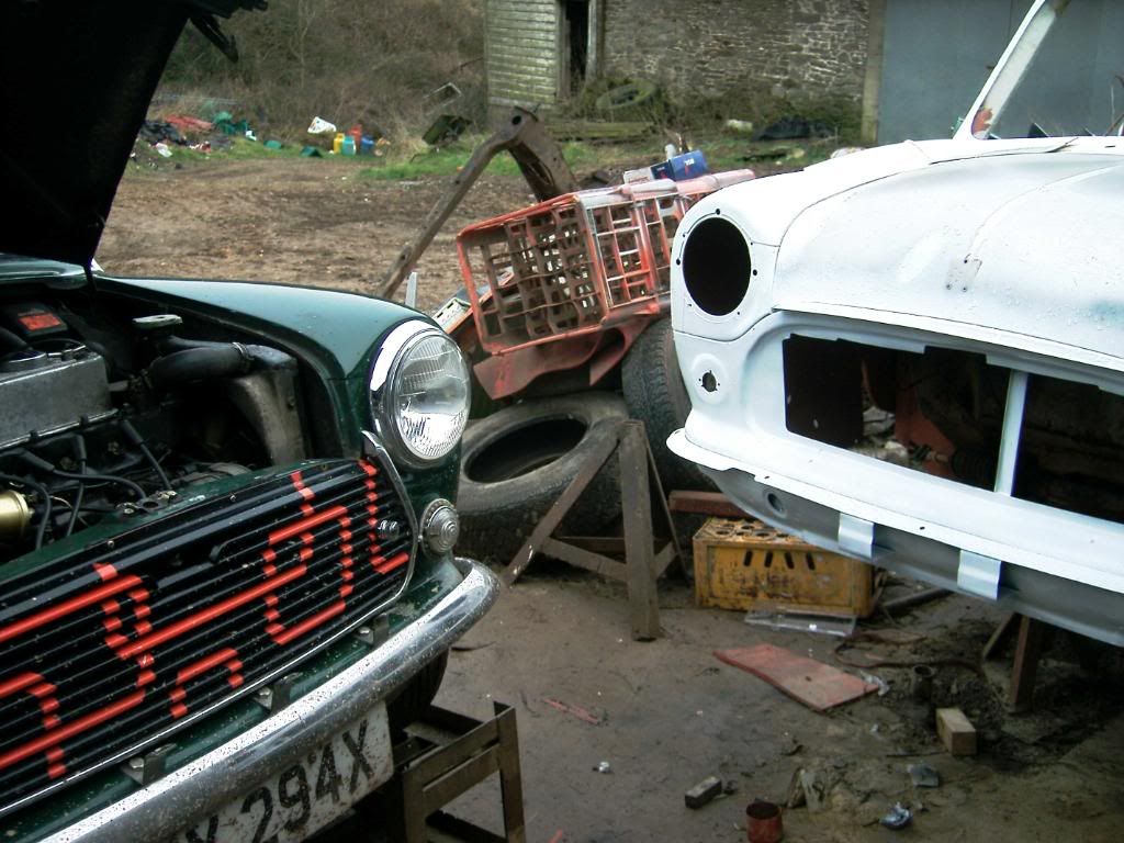

any way, so this is a none sky update, but a tommy update, my mini!!! (tractor tom, because of varies exhuast blowing/head gasket/valve blowing and a dieing ider bearing) but tommy because he is lovely with his 1330 mg engine that we reuilt in june 2007 and i've done abour 30k in him since!!!

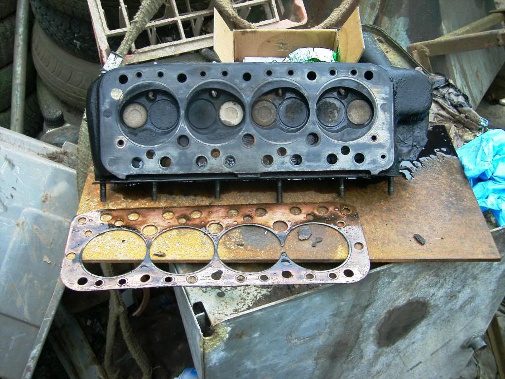

so headgasket change
i got dad to tow me to the farm, because i really didn;t want to even try to start him, let alone drive him and risk damaging the engine or head, because last night he would only start under full thottle, and wouldn't even consider ticking over, and thats when he was warm.....
so got towed up the farm (saves petrol!!!)
parked up next too the sky...
before
carb to one side

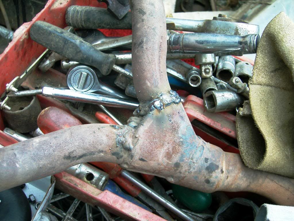

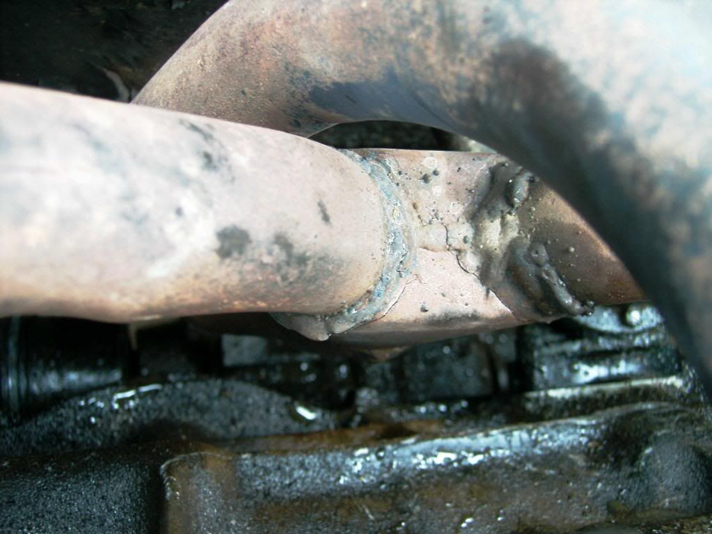

crack exhuast manifol
welded exhuast manifold
rocker box off
then head off

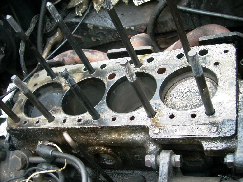

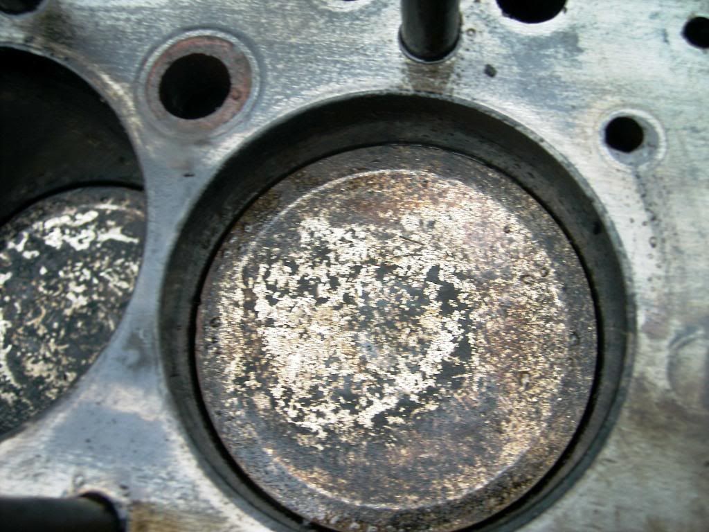

i'm quite happy that is wasn;t in the 2-3 middle one, thats my usualy favourite!!!, as you can see the carb is favouring the first 2 cyclinders and giving them a richer mixture!!!, but not a bad mixture and hardly any choke up, i reckon its done around 30k

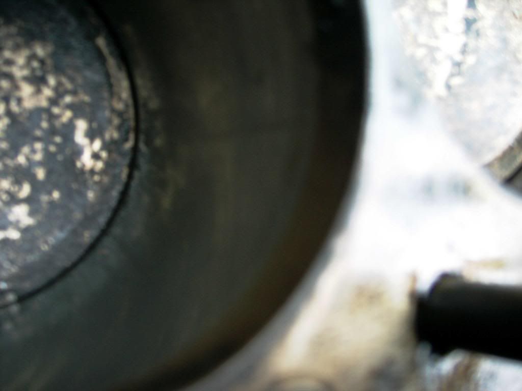

then engine and seeing the bore wear, the last time we saw this it was all brand spanking new and shiney.... not so much now!!!! LOL
Posted Image,
you can't make out the 060 marking in the middle of the piston!!!
the is a bit of bore wear, but nothing major, a few scores bit like 2!!!, (of the pistons that were down!!! LOL) the no.1 bore is a bit wierd, but nothing major, so i'm quite happy!!!
we live at a bottom of a steep hill, so every cold morning he get a thrashing up the hill, which worried me a bit, racing a cold engine and all , but all seems well!!!!
so anyway put the new HG on, (after dad tried giving me new for a one litre) put everything back on
cleaned my engine up a bit so it resembles silver.... (with a bit of red where the paint has came off) after dad asked me what colour it was meant to be!!!!
changed the rockers as mine had a bit of wear on, tightened up the fuel pump as it was worringly lose, erm changed the broken heater tap for a heater take off and changed that 1/2" hose to 5/8" (or 3/8, i get confused)
welded up the exhuast, then dad adjusted the tappets, put the rocker box back on, turned the key, started first time, with no sputtering or nothing, considering it had been dizzling for about a hour or 2
ran for a bit with no water, re torqued the head and reset the tappets and off we go,
just gotta changed the bent tie rod, from my being pants at being towed!!! LOL, better than wrecking the engine tho!!!!, i must fit a towing eye, that would be good.....

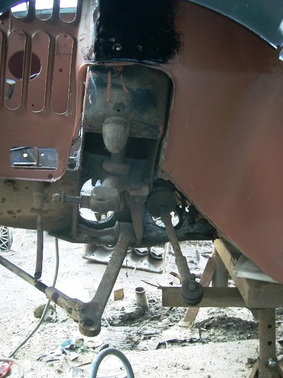

i did do a bit on the sky tho, i removed the steering colum and rack, the rack is really harsh, because both of the gaitors are broken, so there is hardly any grease in it, but no play tho!!!
