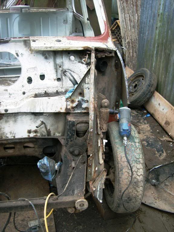

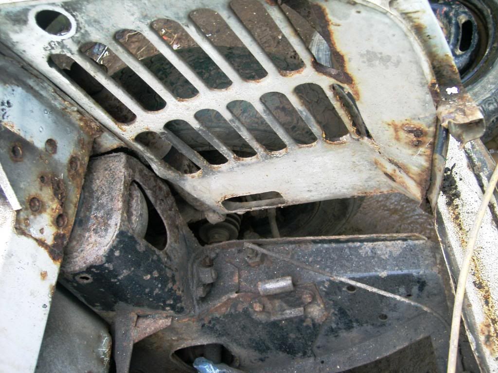

ok so to i've done quite a bit, went up the garage and took the front panel and passenger wing off
here is my lovely repaired inner wing
and no less than 13 spotwelds held the pigs ears for the front panel on the inner wing
http://i287.photobuc...ta/PHOT0152.jpg
is there really any need for that many!!,

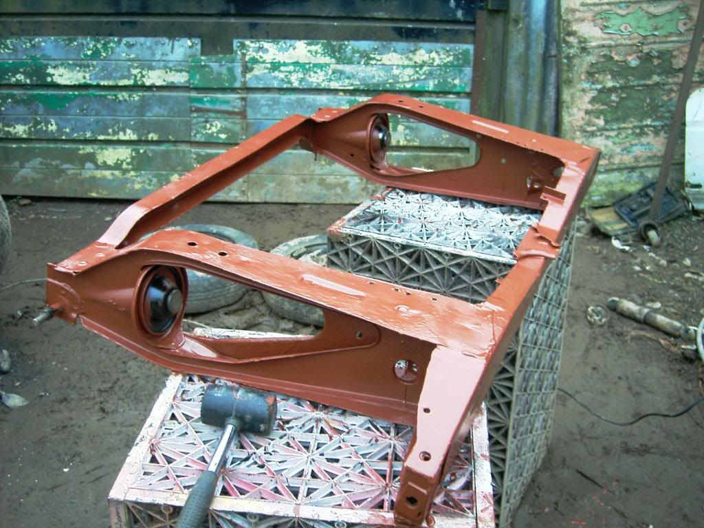

i started on the rear subframe again
and painted in red oxide

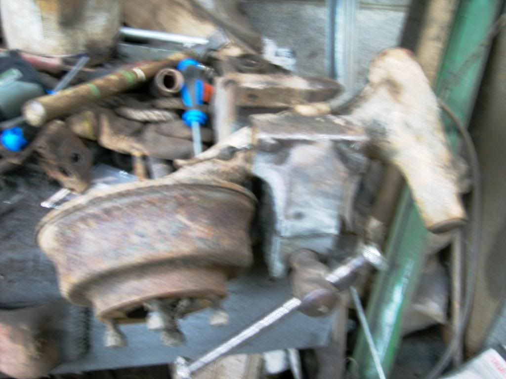

so i took a break from welding today and stripped my radius arms etc
so manky arm

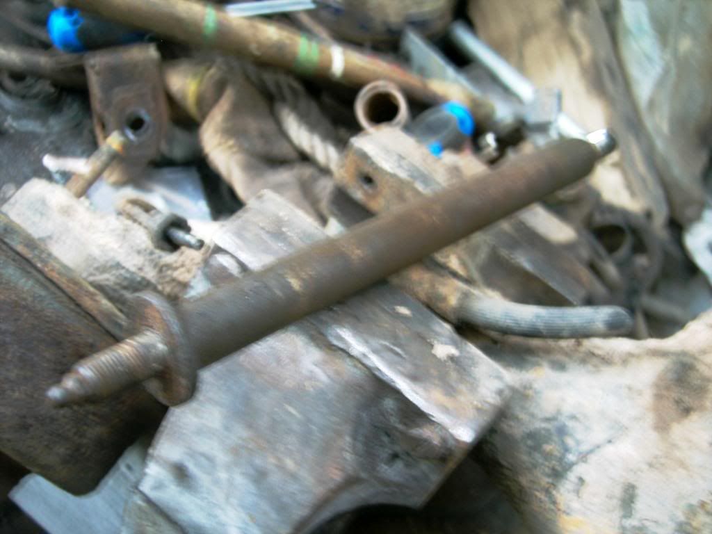

and manky pin - there's not much wear on it, just serious lack of grease!!!, i've got the rebuild kits, so i'll use everything apart from the bearings, as we don't have a reamer thing

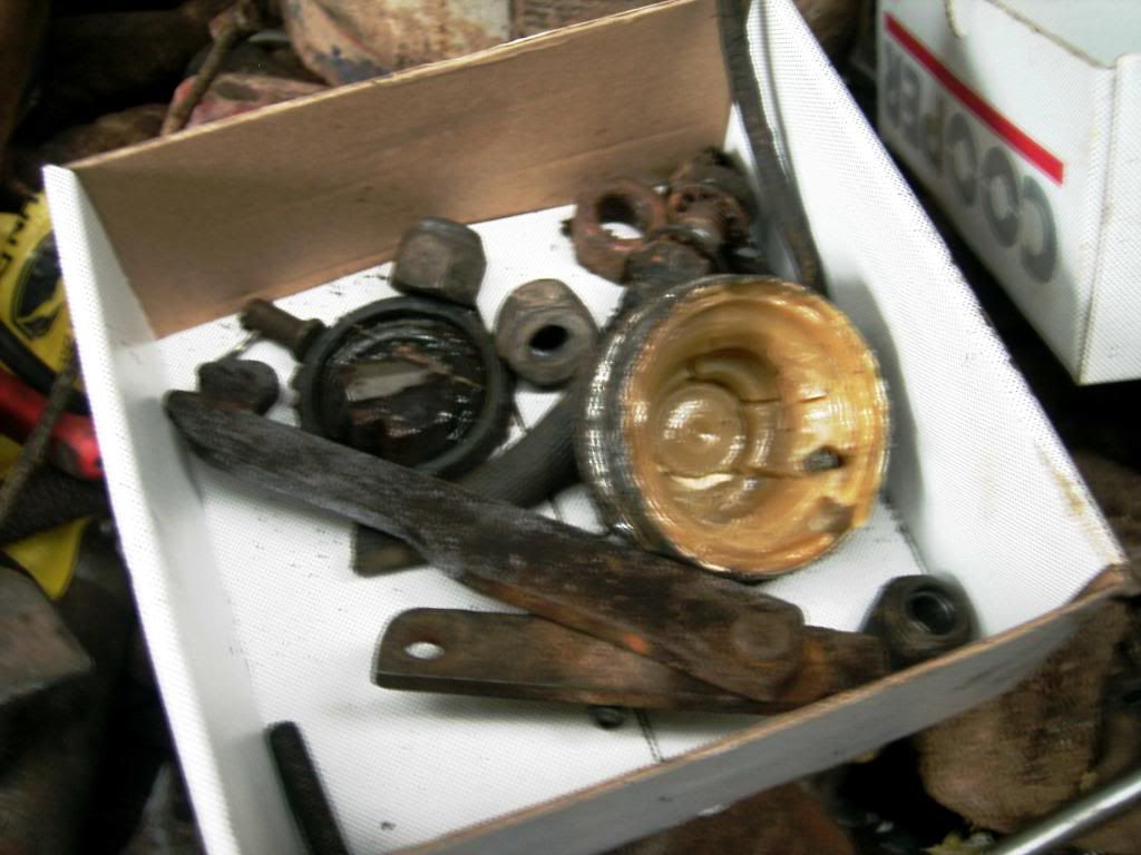

heres the box of bits that came off

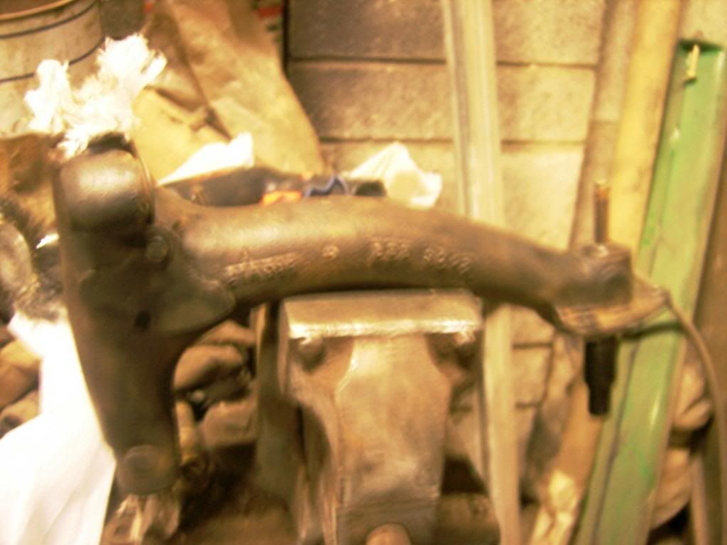

it looks like the bearing has never been off!!! (at this point dad started to get annoyed with the modern car, and came and had a break and took over stripping the arm!!!)

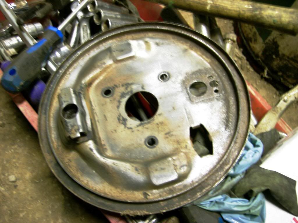

i stripped the arm right down and got the wire brush on the drill on it and it came up really nice
as did the back plate

i painted the subframe half in black hammerite :), and a few bits in red oxide

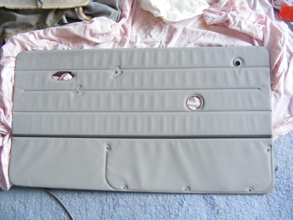

then reglued the backs of the doorcards, so they now look like this ready to go back on

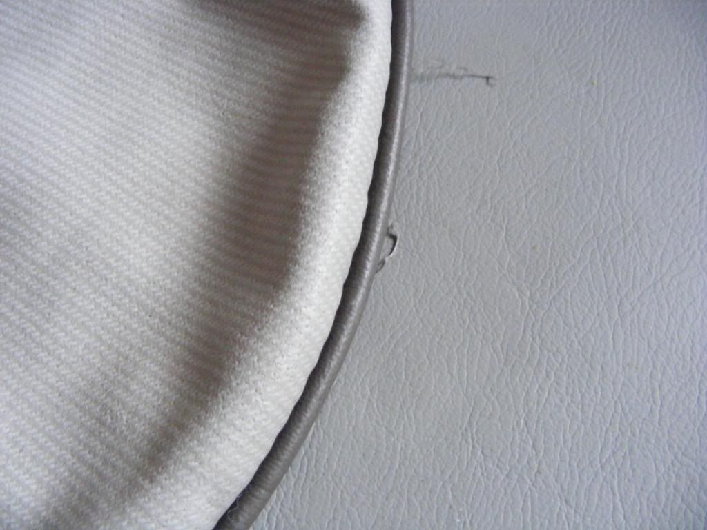

then i finished cutting up the spare seat covers, and started making the bits for the new custom covers
here is the grey for the piping match against the original
and the grey for the back against the original
i'm also making new rear wheel arch covers as the old ones are abit manky and the grey is a near perfect match to them
