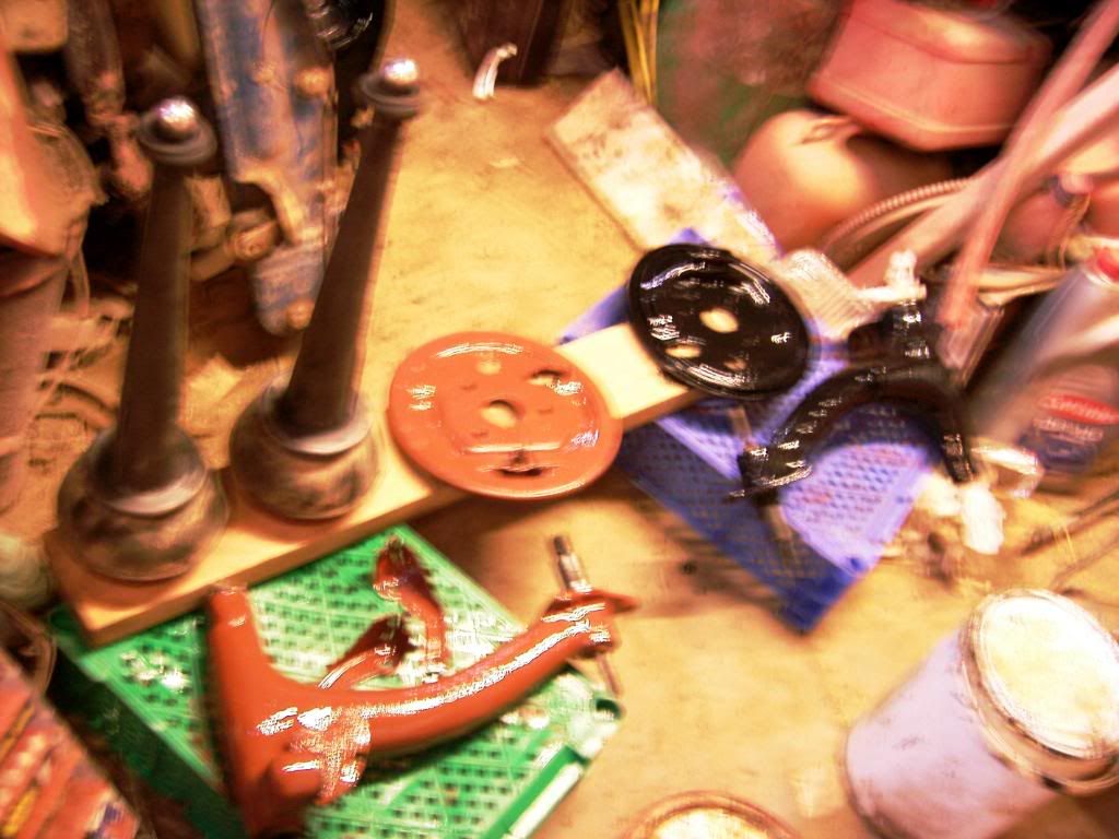

finished painting the subframe and red oxided some more stuff (must get some more hammerite!!!)
then came home and had to respary most of what i painted yesterday, because i missed loads :D

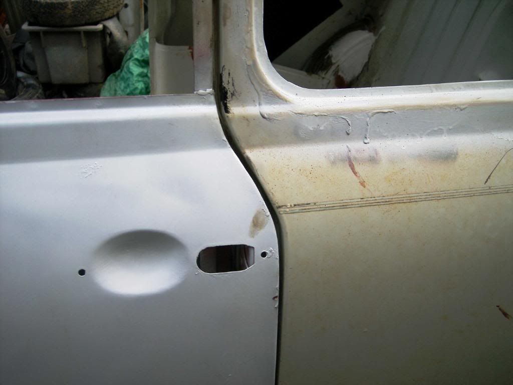

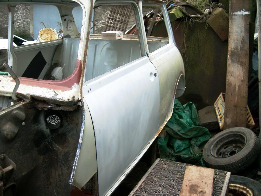

since the weathers got a bit warmer, i've spent a bit of time on the body work

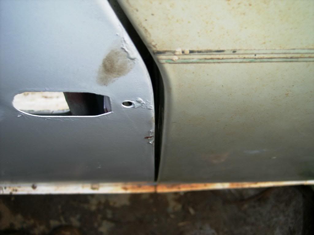

first off was to refit the passenger door, i bolted it on with the original shims, closes it and was left with this panel gap
nearly perfect, i can't believe how well this door fits compared to the other side, but it was a bit high
so i took one of the original shims out and put in a new one
so that was that like 10 mins to fit and line up the door, well happy!!!!

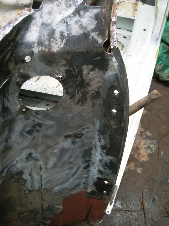

then i wire brushed the rest of the scuttle to find the spotwelds, and found some holes
its a good job a got a new one!!! LOL
took the scuttle and a panel off
lovely non holey inner finch

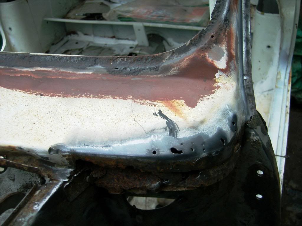

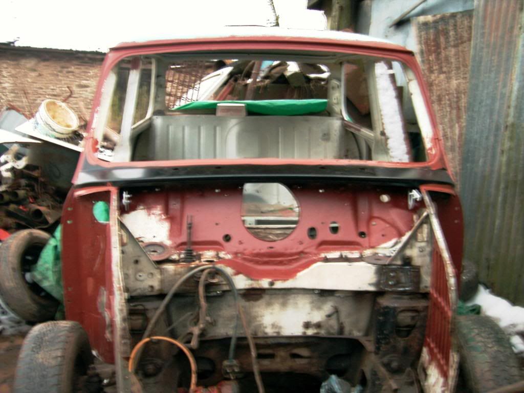

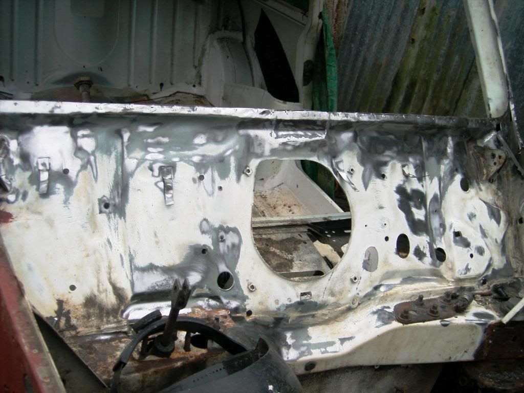

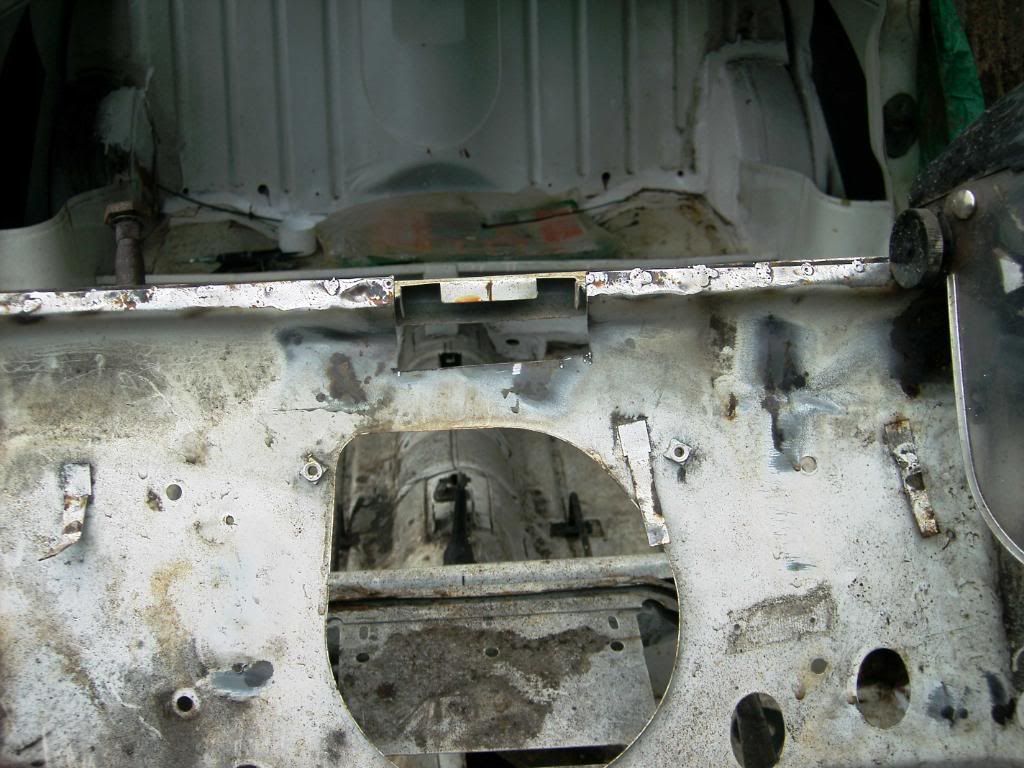

then today i've attacked the bulkhead, cut out the rot in the middle
and replaced
repaired the centre of the roof gutter
can you see??? LOL
then cleaned up the bulkhead
and inner finch
then started to attack this rust
cut out the first skin
cleaned up and cut out the second skin
i've replaced the inner skin, and red oxided all the bulkhead and roof gutter.
tomorrow i'm hoping to get some sand to snadbast the corners of the roof gutter and corners in the bulkhead, take the new scuttle up and see how far it goes up the a pillars
then finish repairing the bulkhead, take the front wheels off and clean behind them and repair under the passenger front shock mount
i reckon there is 4 more repaird to do on the front end, then 2 roof gutter repairs, then its just the front end then!!! whoop whoop

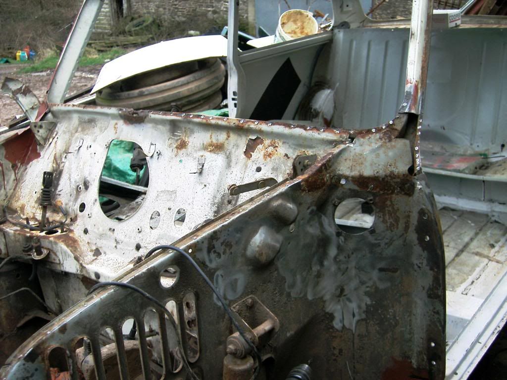

yesterday was far too cold and snow to do any work outside, so i spent most of the day trying to figure out how to make the old covers fit the new seats!!!!
then i went to get some sand for the sandblaster, and had little play with one of my old weller wheels, and gave a few parts a quick coat of paint, before it got really cold and the slushly snow started to freeeeeze!!!

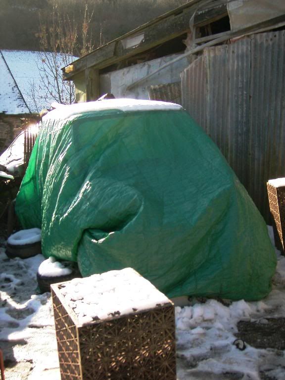

today, was the scuttle day, so the plan for today was to get the scuttle on, i went up to find this tho!!
so after getting the tarp off, which was made quite hard with all the snow on the roof, sometimes i wonder if i'm a bit mad spending the day out in the cold like this!!
but hey, as the body had quite a bit of condensation on, i took off the passenger shock mount and attacked it with a hammer and chizel underneath, to find a hole, just like the other side!!!!
then preped the body and new scuttle to be fitted
then out came the lovely new spotwelder, which dad had spent all morning wiring in (its a random fitting, not just a normal plug!!!)
and....
it took a bit of working out, but we still have the front end to the trailer, which we went up and measured where the scuttle is meant to be!! and hey presso
one scuttle spor welded into place, we've learn't that a spotwelder meant for 1mm + 1mm, will easily weld the 3 layers for the scuttle of 0.8mm metal, well happy, but we also learnt after some errors, that you need to have all the metal 100% paint free and the tips of the spotwelder nice and clean and also the timer is used instead of amps on a mig to control the strength of the weld!!!
it was soo easy with the spot welder tho, and no mess to clean up and grind back!!!, we also put in the scuttle closing panels, new bonnet hinges, and then i got the mig out to finsh the job off and painted it all buff oxide, because the red oxide ran out....

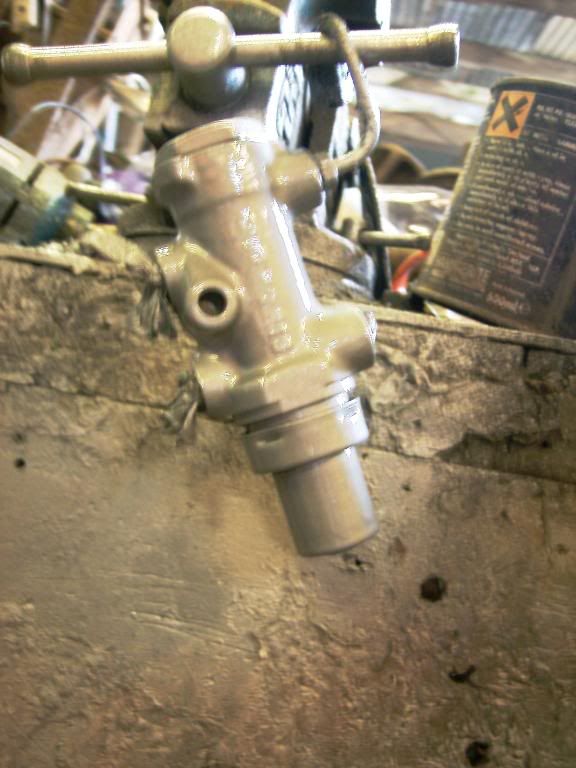

so i stripped all the anicaillopiiiejs (can't spell) off the engine and put all the bolts in labels bags so i don't lose them!!LoL
then sandblasted all the bits to be repainted, including the heater take off, which then showed loads of holes in it, so another thing for the list to buy!!! LOL
then i came home and primed everything ready for painting
