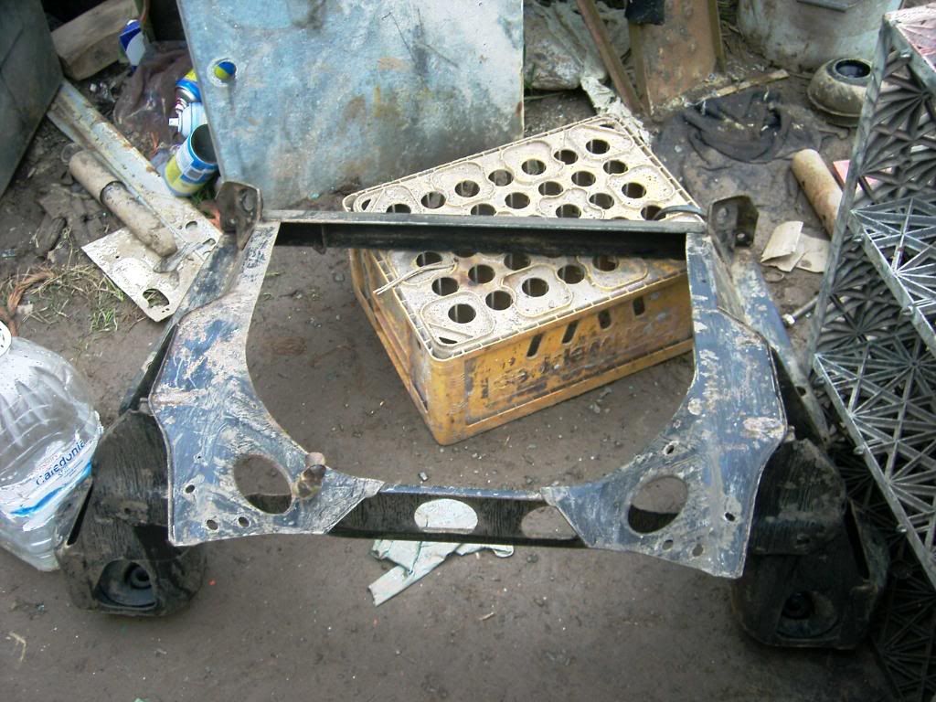

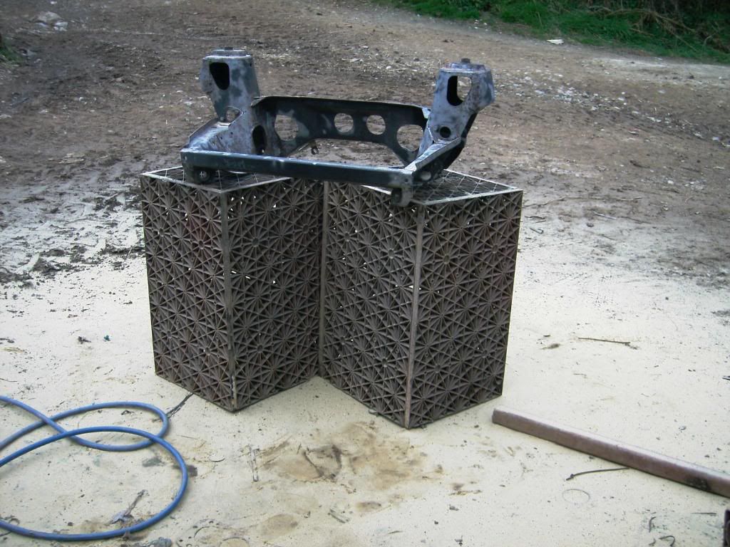

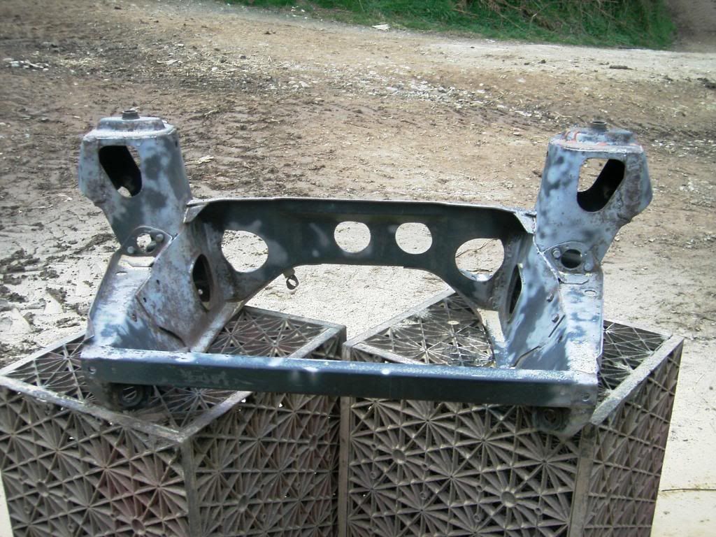

ok so yesterday and today i being making seat covers for most of the day, then yesterday shot blasted the subframe
one whole bag of sand...
then cleaned up a few other bits
and painted
then today i didn't take any photos, but painted the underneath of the subby, erm, refitted the shock mounts, after i lost the bolts for one side and robbed them from the front end of the trailer.....
stripped down the passenger hub, and gathered a big box of parts to clean up, and cleaned up all the old gaskets on the engine ready for the new ones, i gotta change the core plugs before most of it can go on tho!!!
its a bit random at the moment, because i don't really know what to do, the only thing that is ready to completely build up is the rear subby, but i haven't got the space to do it at the mo, so the plan is to refurb the engine, then the front sub, then put the engine in the sub, put that in a corner and rebuild the rear sub!!!

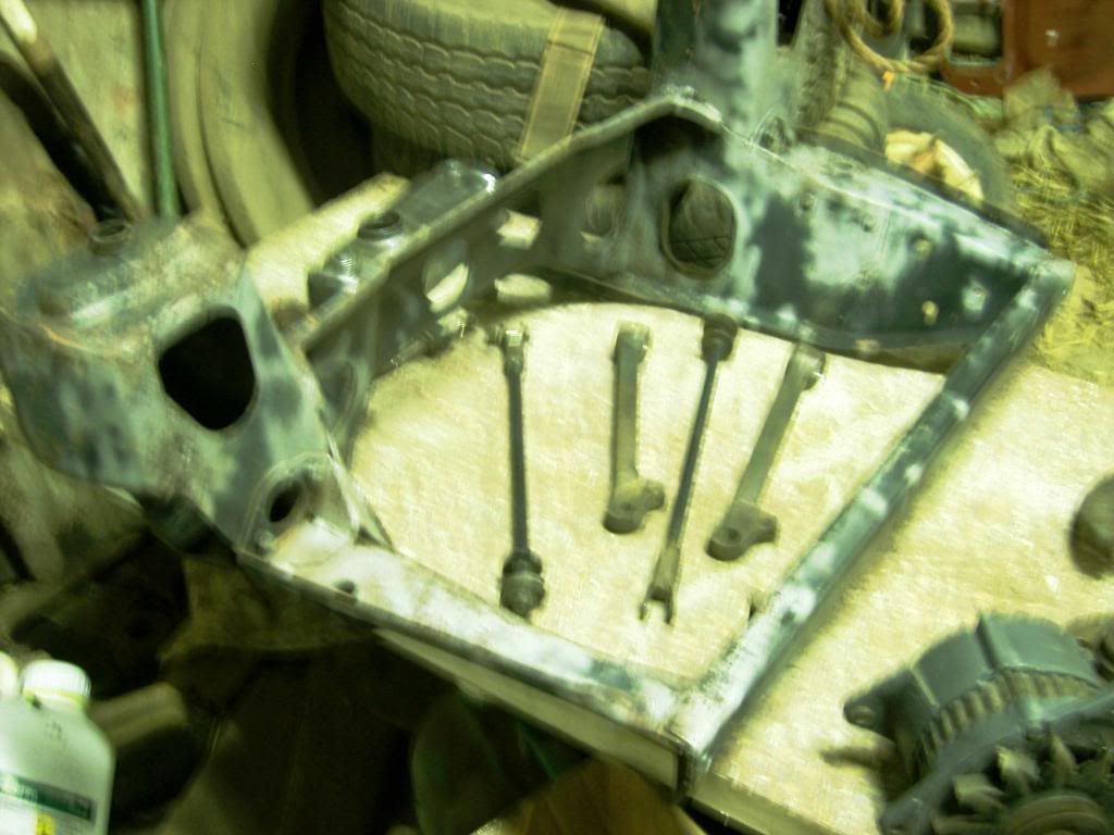

ok so today i've started to paint the front subby and all the red oxided bits from yesterday

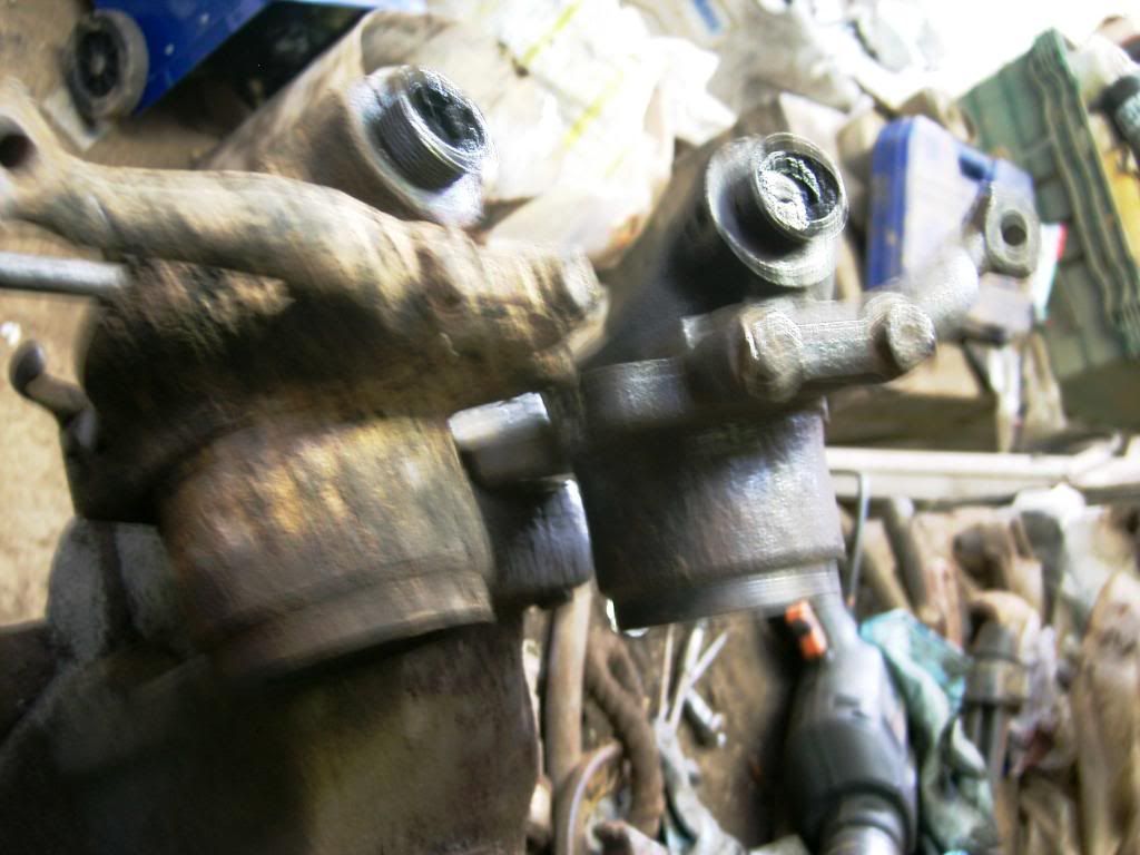

than cleaned up the capliers
[Posted Image
hubs
and top arms

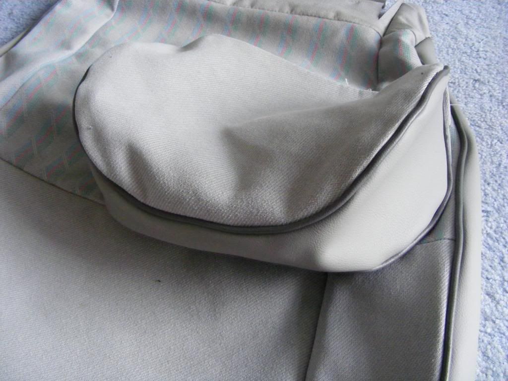

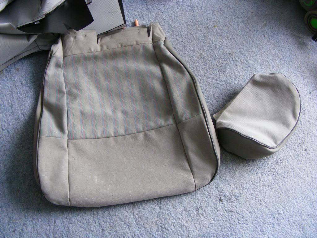

oh and the seat covers that i've made for it

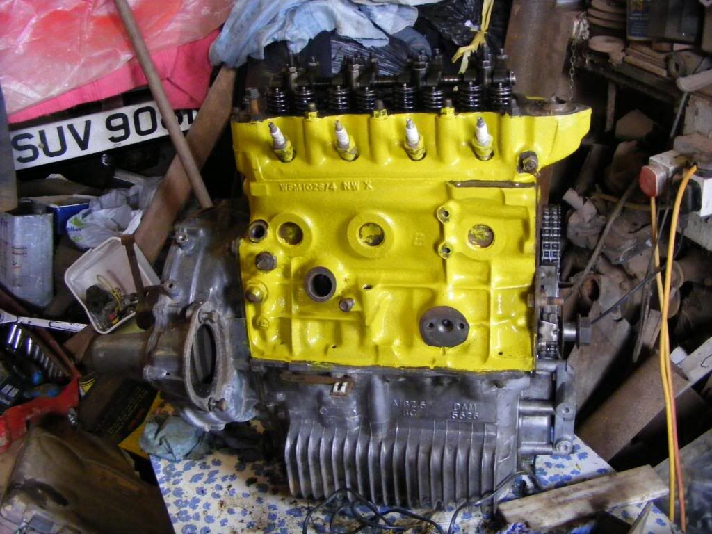

and my engine ready for its new core plugs and bits bolting back on!!!!

lookin good sky my cars gonna be getting some very nice new toys as i just sold some seats :D
love the fact uve done the engine yellow how long will that last and wheres the black stripe could have been a bumble bee engine :-

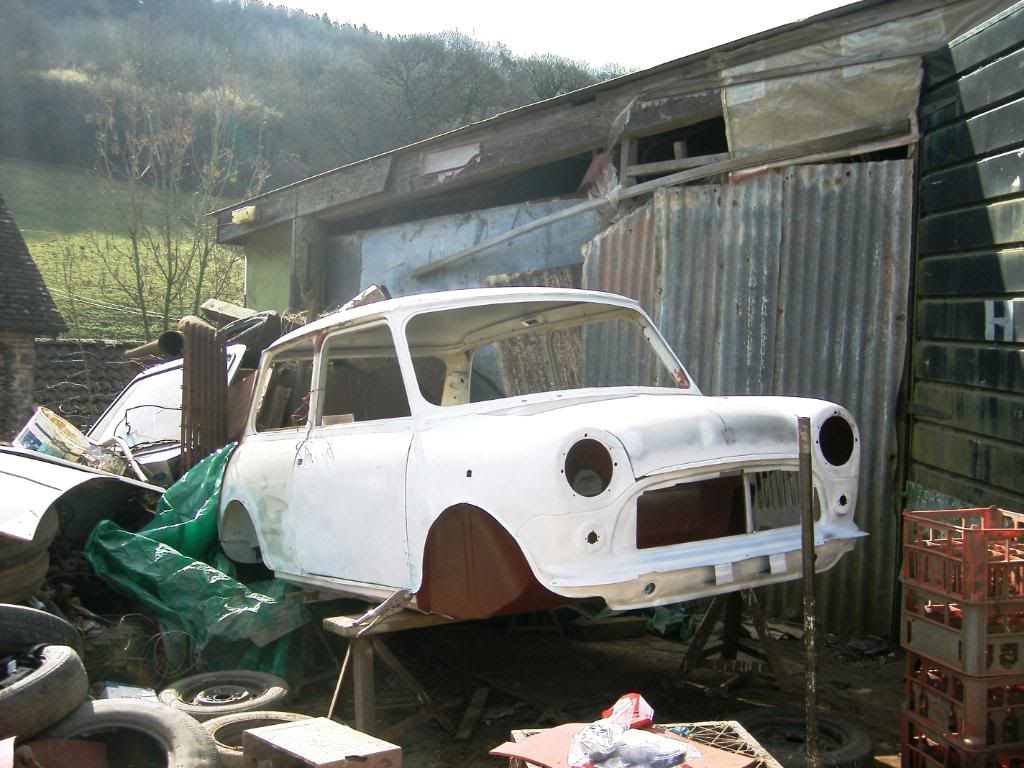

right with the sun shining
and the sky sitting in the sun
i decide to have a massive clear up of the garage, so we can actually use the work bench and walk around the main area, ready for the sky!!!! (HOPEFULLY)
note the massive tractors!!!!
its a work bench honest!!!!

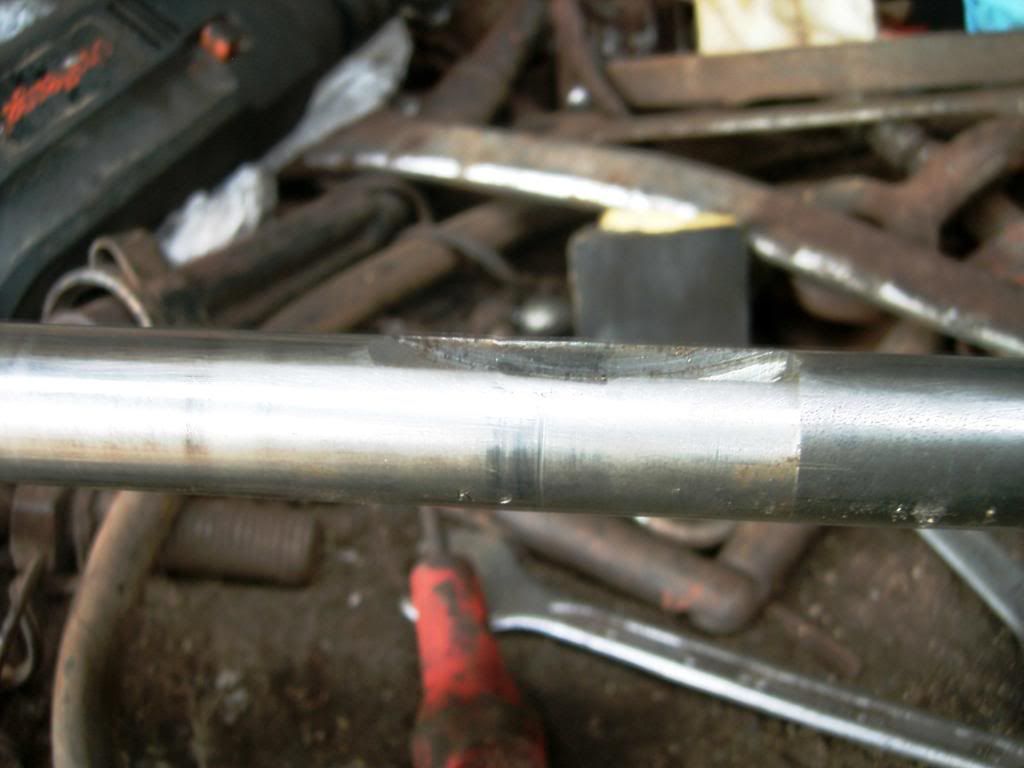

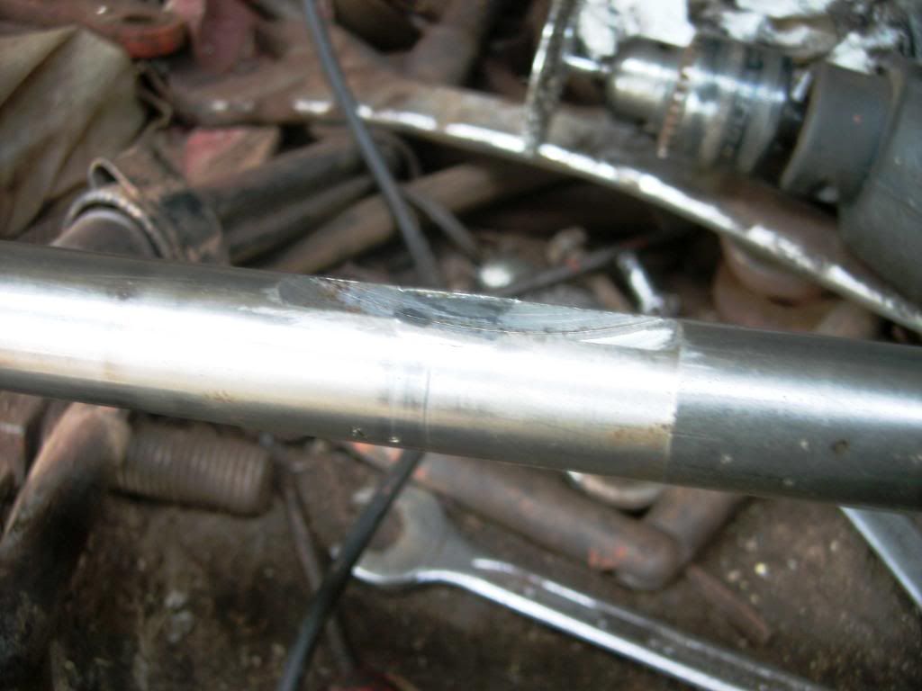

then when i took the steering column apart we found this:
it looks like the steering lock has been forced.......
so that combined with the damage on the doors around the handles makes us think it might of been stolen at some point.....
