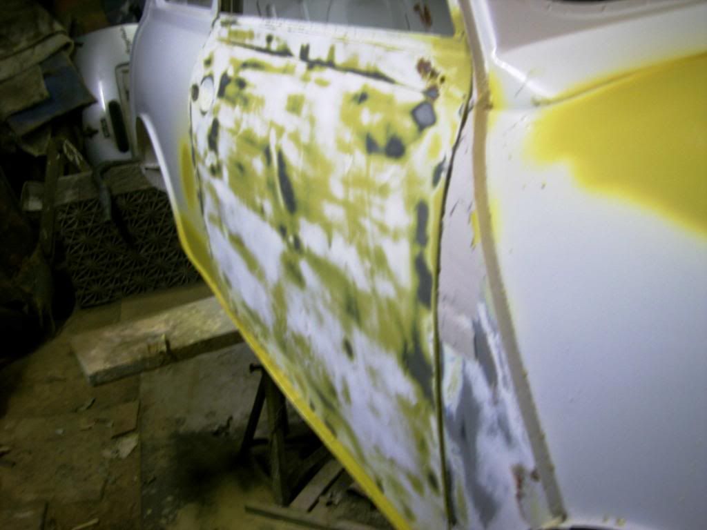

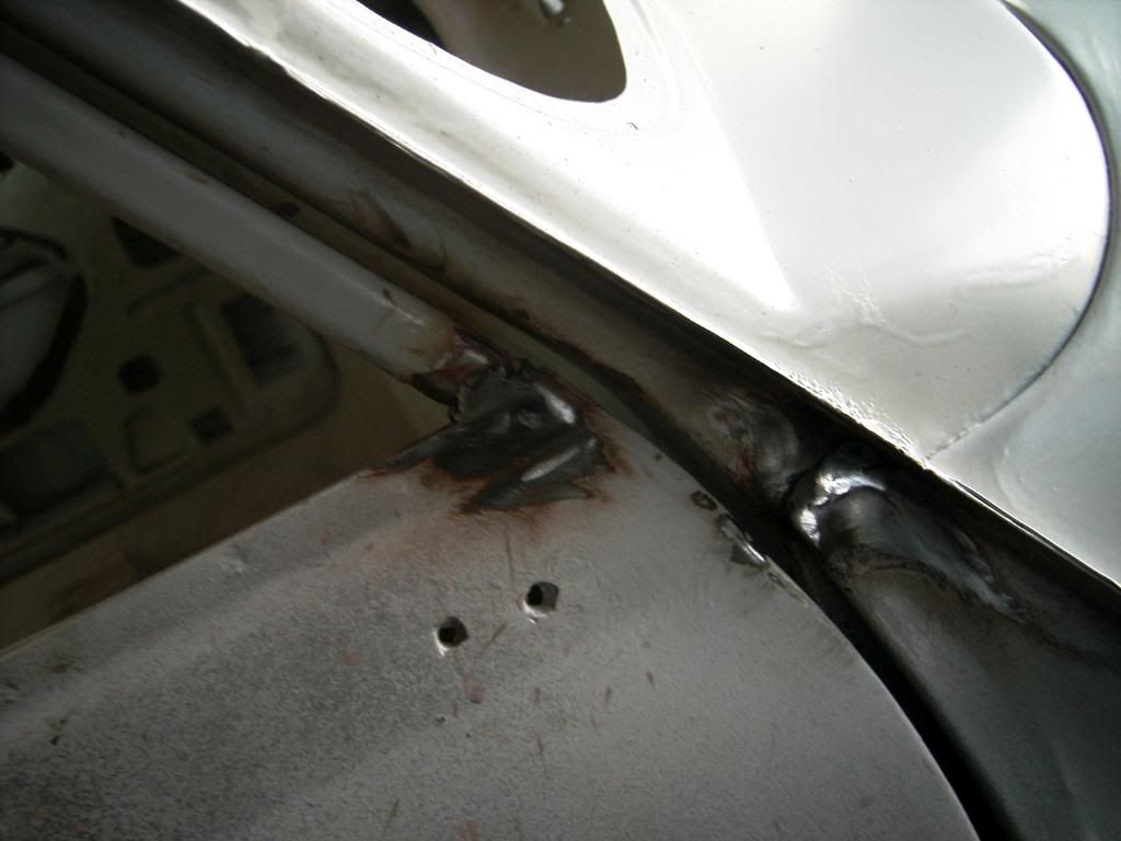

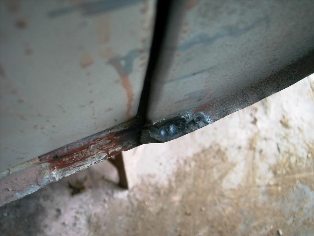

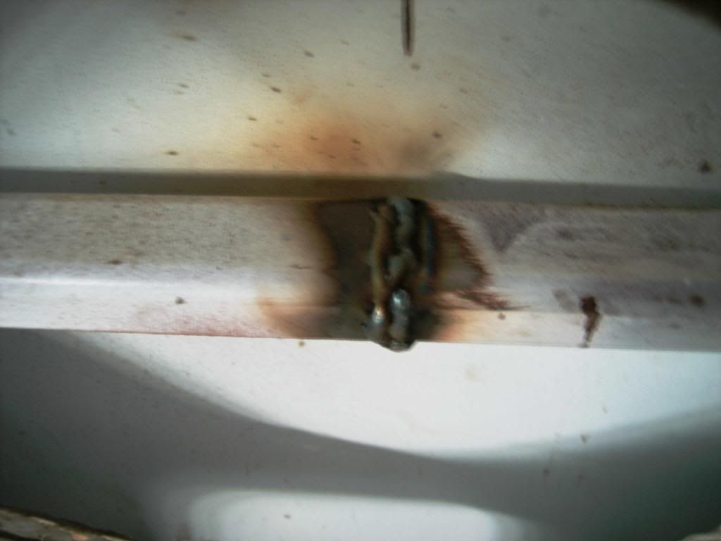

right i now love my drivers door
it really just wasn't good enough with what we did yesterday, so i took the plunge and
cut thru the bar, twisted the door, and hey presso lined up perfectly!!! undid all the knocking in of the outer lip we did, twisted it some more, then welded the bar back up....
job done, i really glad i did it, else it really would of bugged me!!!!
then as the welder was out, welded in the a panels
oh and the top of the door skin on the drivers skin as the welds had cracked!!!!
and got the spot welder out and spoted the final seam support on

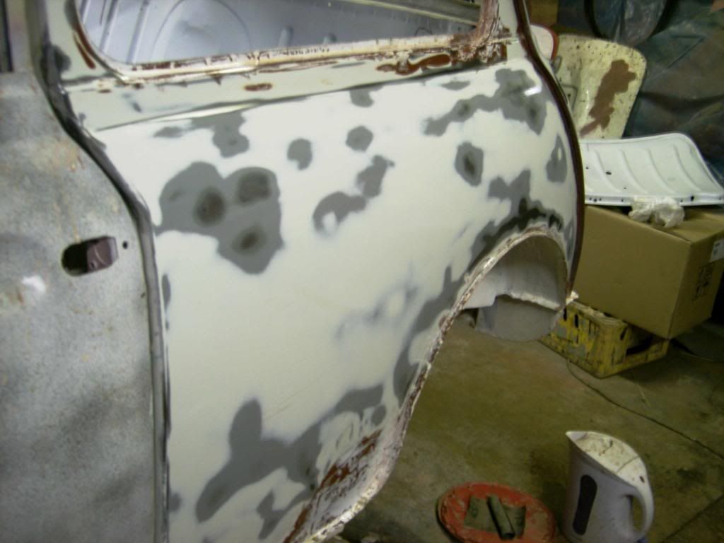

then finished the rear quarter
and passenger door and door step
then put a bit of filler :wub: on the bottom of the rear quarter where the repair is, and the doorstep where it is repair :D
the dreaded filler!!!! :dontgetit:
so tomorrow will be a panels, drivers door, and front panel, then try priming again!!! :P

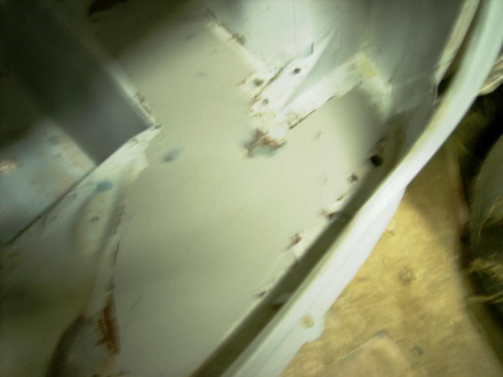

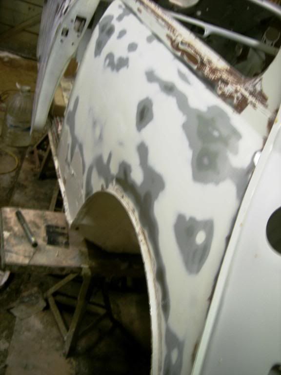

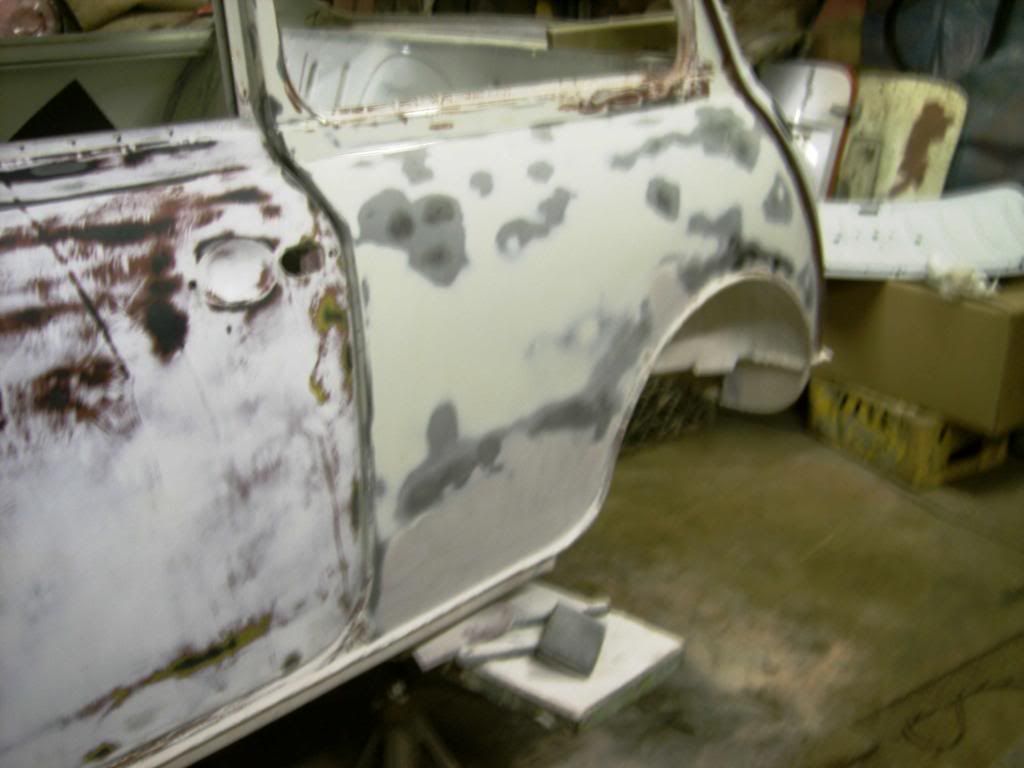

so today
sorted the rear quarter
rubbed down the a panel and put some filler on
then i went home to get some spray putty, because i forgot to take it up, went to go back up the farm, turn the key nothing!!!!, damn minis!!!, on of the wires on the soldnoid had broken off its connector, 5 secs, fixed (bodged a bit, but i need to tidy up my soldnoid wiring soon anyway) spary the putty on the sky:
bloody reacted with the white paint!!!, grrrr, i also put it on the few bits where there was dents and had been primed and that was fine, stupid paint!!!!!
anyway, so cleaned up the braze on the front end,
rubbed down the driver door and a panel
and started to tidy up the boot floor (more filler cough cough)
i've also just a bit of filler to bring the edges of the front panel out inline with the wings.
tomorrow the plan is to rub down the filler, and the drivers door step, then front panel and bits with the putty on, and hopefully bonnet and boot, then some more primer, (if i can remember how to mix it!!!!)

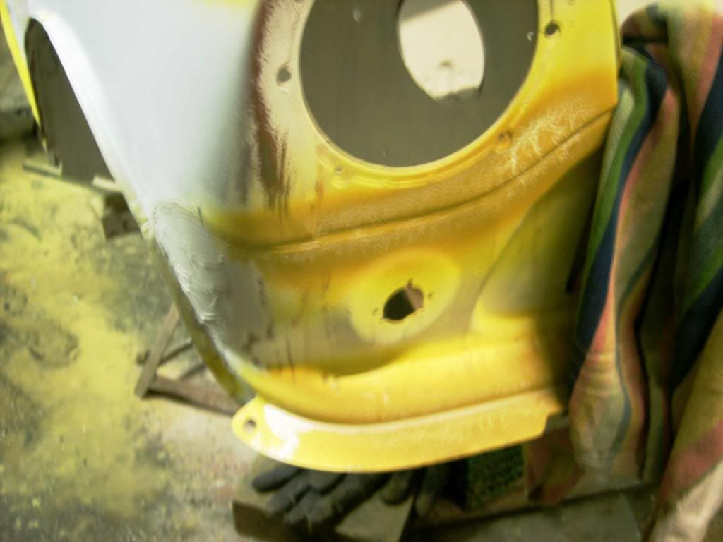

any so yesterday
rubbed down the front panel,bonnet, and boot
and sorted the filler on the front panel, a panels, and drivers rear quarter
and sorted the dink in the roof and marks on the roof gutter
then started on the primer again!!!!, dad came up, but didn;t help me (apart from telling me bits i had missed)
first coat, then second coat
hardly any runs so i'm well chuffed!!!!

i know i'm well chuffed!!, i need to put in some more harder tho, because it was a bit soft at about 3 this afternoon.....
then last night i sprayed stonechip in the boot, then under neath which all reacted with the white paint i used, so i gotta strip it all off today, repaint in the red oxide, which won;t react, then re stonechip (when dad has brought me some more :D)
