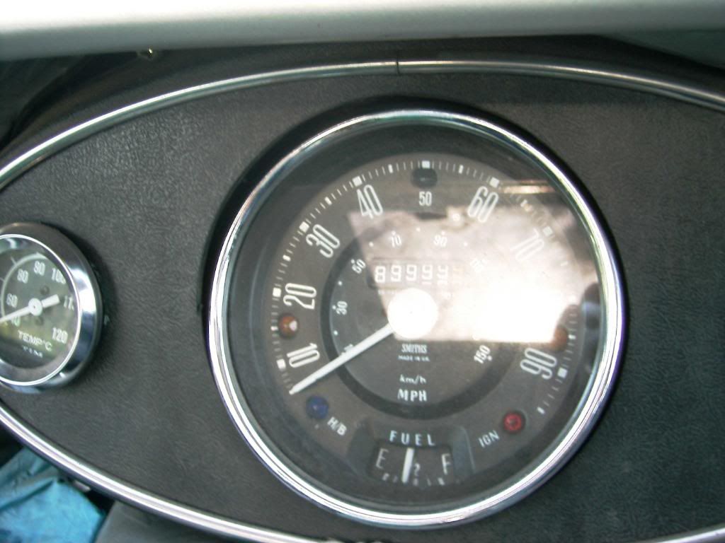

did this to my green mini
90,000 miles!!!, can't believe it was on 47k when we got it....

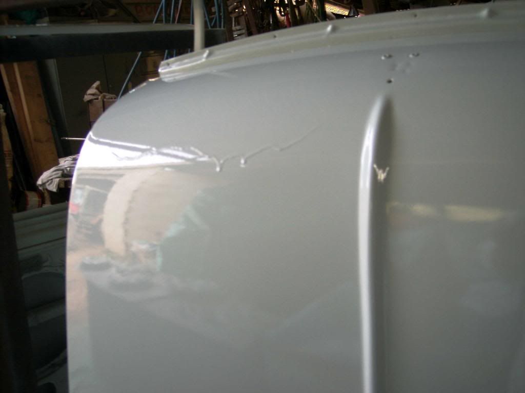

but there are quite a few runs, i think dad struggled to see how much paint he was putting on because its so white, so its kinda invisible, its nothing that can't be flatted out tho
here are the worse
