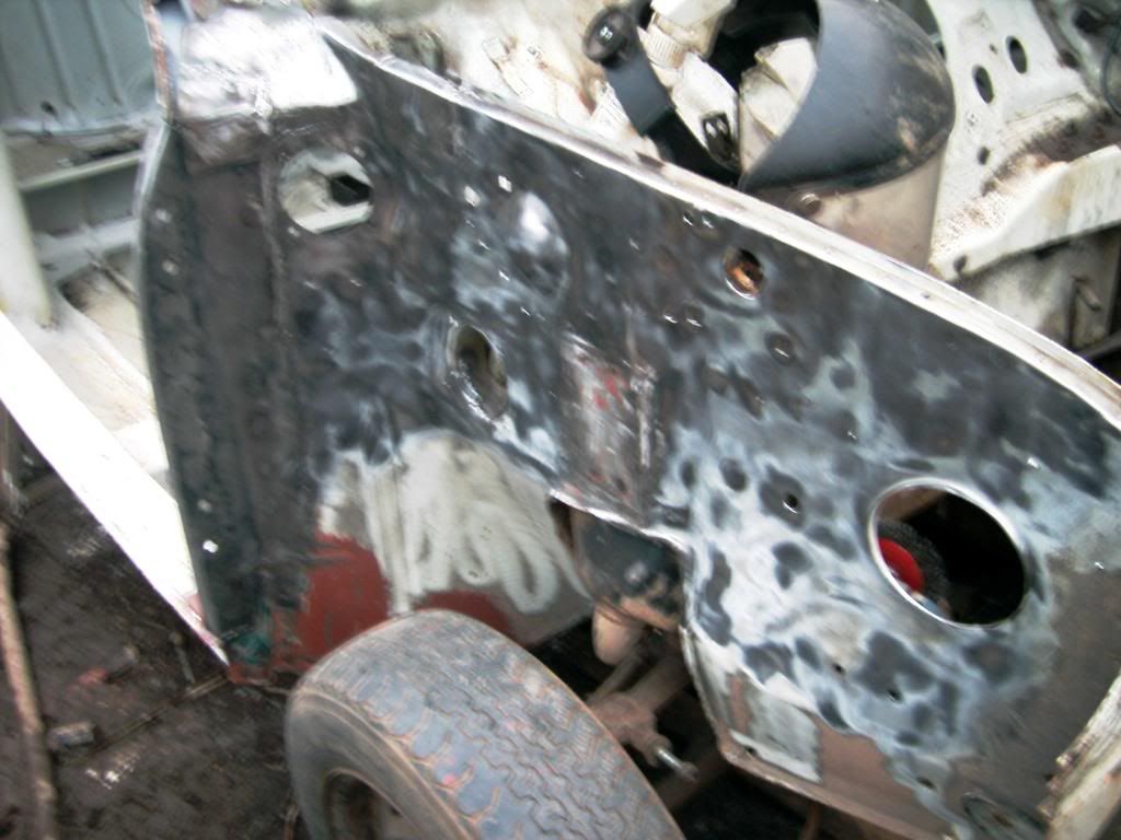

ok the sky, i faffed about most of the moring, making seat covers for someone!!, then went to the garage about 1ish, then spent 4 hours preping the body for the new inner finch and modify it to fit
NEVER BUY NON GENINUE PANELS they are seriously pants!!!, it worth the extra money not to faff about making the panel fit!!!!
so

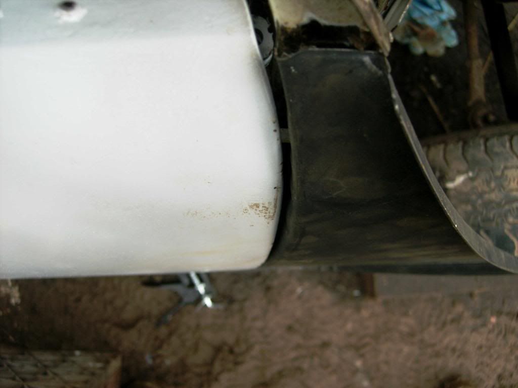

took the air vent thing off (had to grind it off because the screws weren't budging
and the bottom air vent thing
along with a bit of the inner wing!!

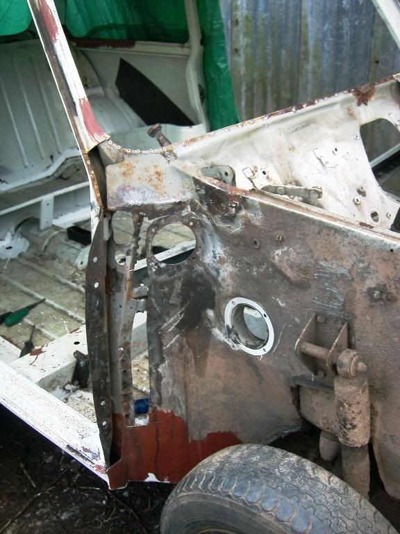

then cut all the rusty inner finch out
this is the bit that took the time, geting all the spot weld off, they are really hard to spot!!!

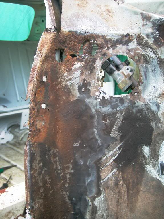

then found some rust in the a post, where the bottom dash rail is welded on
and welded the resulting hole up
then clamped the new panel on
then finished preping the new panel
so thats already to weld in tomorrow, i'll put the door back on (again) and put the a panel in place just to make sure it all lines up, then weld it in
then take the driver wing off and go to a employmeny agency to get a job!!!, to get some money, so i can make a order with mini spares (again)

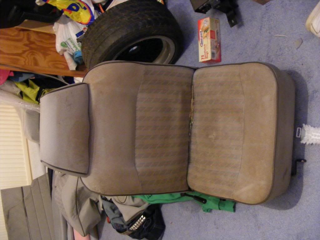

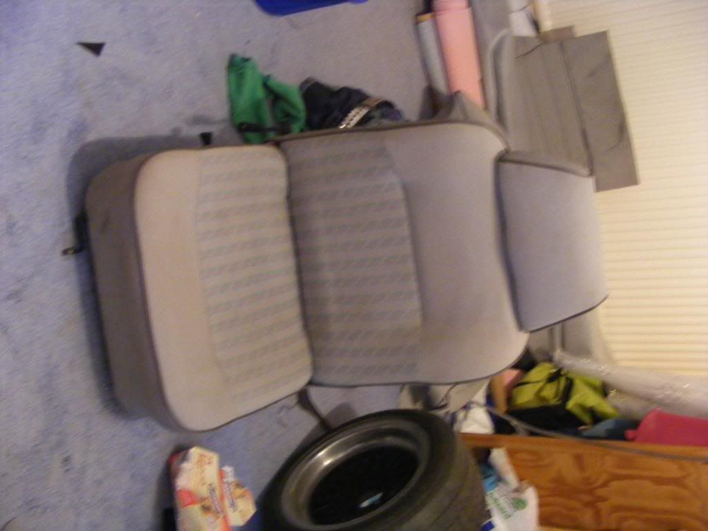

also i've started cleaning up the seats
drivers (covered in mud from when i was using the sky to feed my horse hay)
then a qucik rub down with a dry scrubbing brush
then this is the passenger, i got bored tho, so i'll clean it tomorrow!!

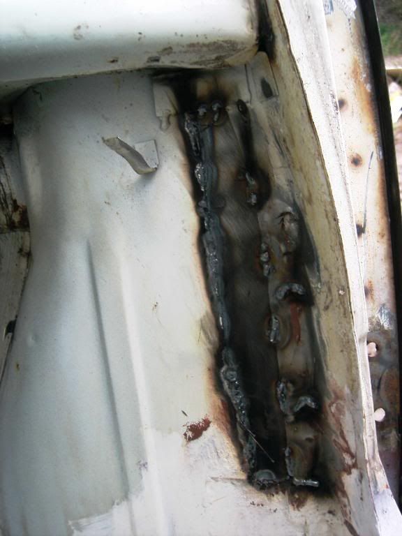

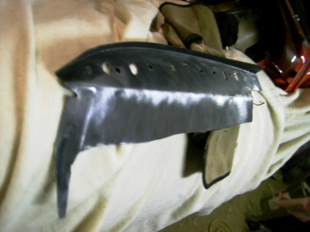

ok today i bolted the door on and clamped the inner finch repair on , and guess what,
it was miles out!!!

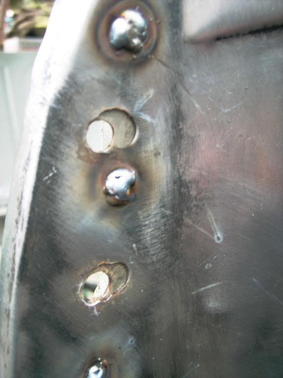

the panel stick out over the door, which would of meant that the a panel would stick out more that the door, so off with the door and panel to file out the holes AGAIN, and make it a little thinner, then repeat 3 times till perfect!!! GRRRRR non geninue panels!!!

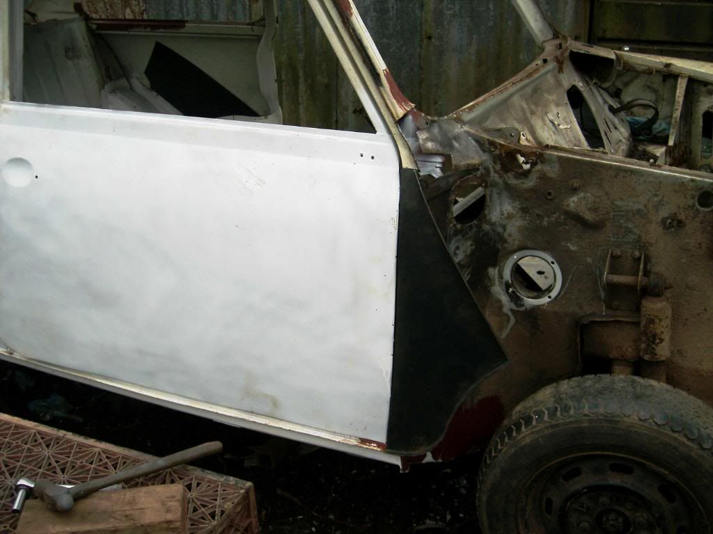

again way, put the door on and placed the a panel in place
so with the panel in place i welded it in
and the inside
how much i had to move the holes
top
bottom
i;ve also cleaned up all the interior, the door cards have scrubbed up really well, so i'm dead chuffed with them, the seats are still a bit grubby tho, so i'll have to look into something to clean them
and i've also been cutting up some sky/rose covers for my custom front seats......

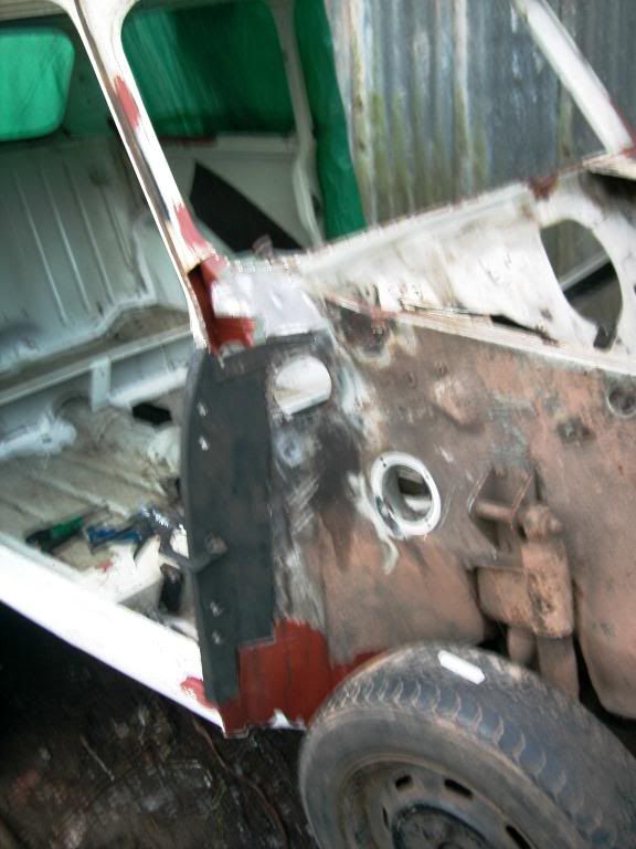

so tomorrow, is grind the welds inside down, then paint, repair the inner wing, get the front panel and passenger wing off, ready for the inner wing to be pulled out!!!!

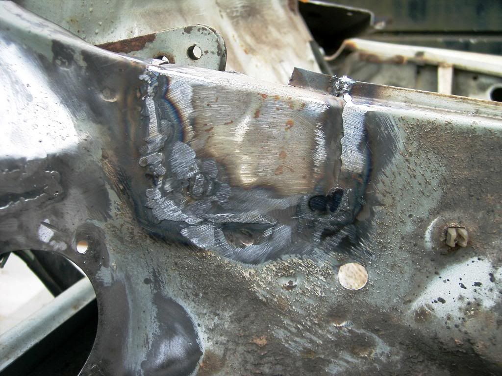

after a nice lie in...

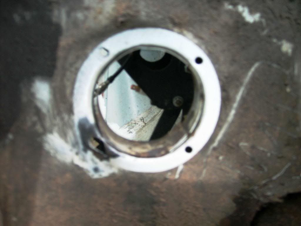

filled the top of the inner finch and cut the rust out of the top of the inner wing
and repaired

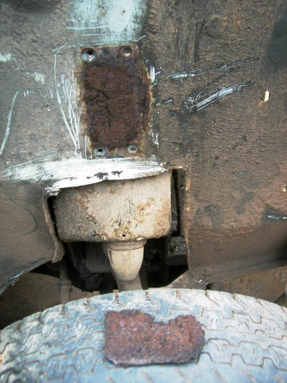

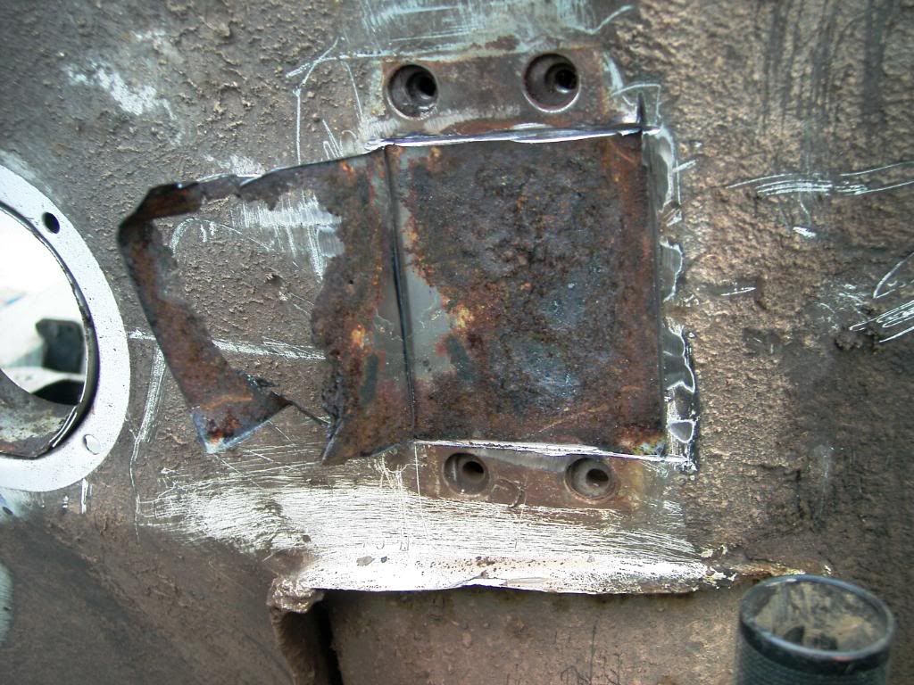

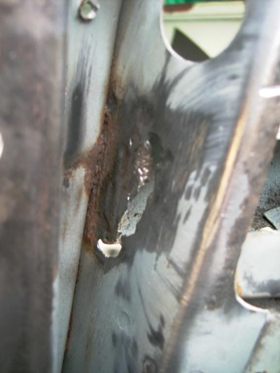

unbolted the shock mount and a chuck of metal fall off
not impressed, it looked fine, but i took the mount off because i know its a common problem area...
well i was right, so i attacked it with a wire brush, then cut around the main area of rust, and peeled the first skin back
ummmm, not good, so i made the hole in the first skin bigger so i could treat the rust underneather propery, then cut the rust in second skin out
cleaned up inside, and red oxided, then painted the inside of the first repair panel, welded in, painted that repair, then the inside of the second repair and welded in, (making sure the shock mount would go back on!!)
then cleaned up the top half of the inner wing, the wheel got in the way of the rest!!!
red oxided and started to drill out the spotweld of the passenger wing, then it got dark and my feet started to freeze!!! LOL
