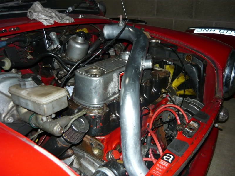

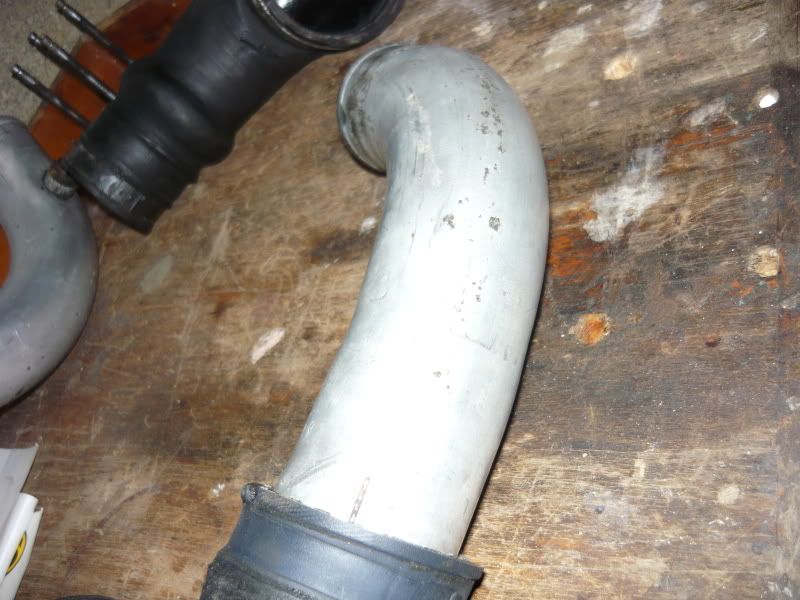

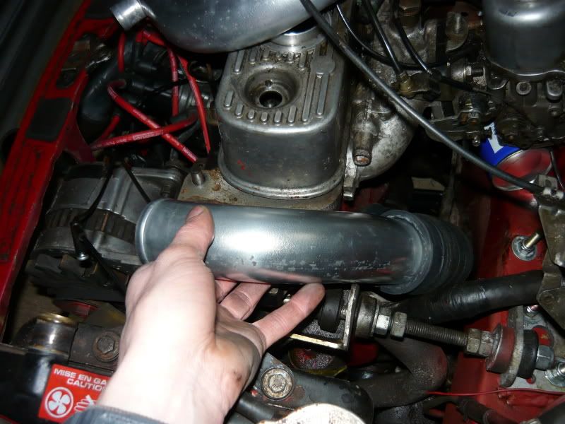

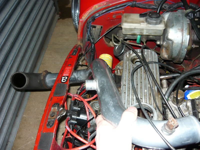

"Aquired" some hard pipes and flexi turbo hoses from work off a 2.3 turbo saab that we are breaking for parts. Took them to the mini, and great news, the flexi 90 degree hose is the perfect size for the turbo, and the hard pipes are the same size too, so looks like they are ideal. I also offeredup the longest hard pipe to the plenum, and the pipe is pretty much perfect without cutting/modding anything. The pipe has a couple of angles and goes from the plenum to the front grille for a front mount intercooler! I'll add pics when I go up on saturday. Hows that for luck that a Saab turbo pipe is just what I needed for a turbo mini!! and they were free!

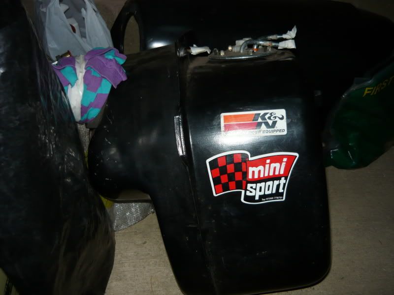

Here is a little pic!
Also a couple of stickers that were already on there!

Posted 28 March 2009 - 07:13 PM
Not bad for free!

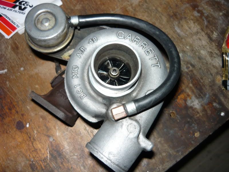

Also cleaned up the turbo a bit

Posted 28 March 2009 - 07:45 PM

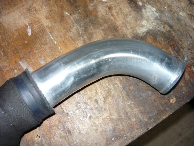

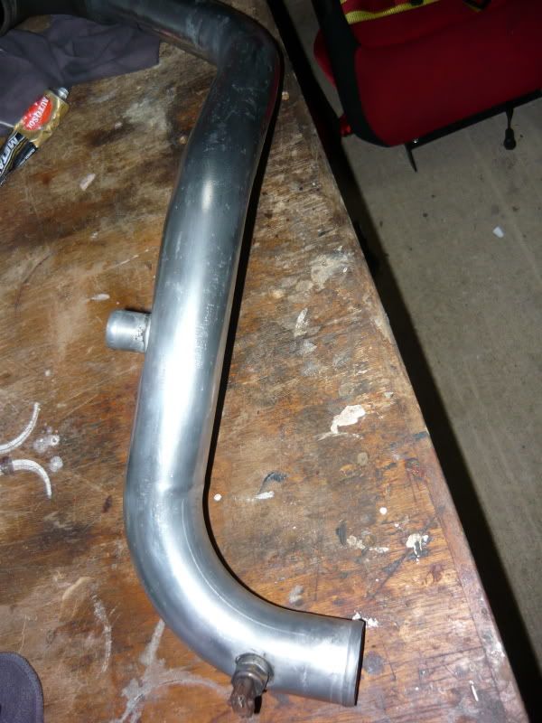

Also gave the hard pipes a quick clean with autosol, here is a few before and after pics.
Not bad for free!
if you need it welding (TIG) let me know

Posted 28 March 2009 - 07:51 PM
Nice one mate

Posted 28 March 2009 - 07:55 PM
Not bad for free!
Thanks, come to think of it, there is a dump valve take off that is used on the Saab, but not on the mini that may need to be blanked off in some way?
Thanks,
James.

#179
Posted 28 March 2009 - 07:59 PM
Not bad for free!
Thanks,
James.
if you need it modding ie shortening or outlet turning just cut and mark position and i'll
do it.....
#180
Posted 28 March 2009 - 08:00 PM
Not bad for free!
Thanks,
James.
could weld a 3mm thick blanking plate on or fill the hole and polish up!!
