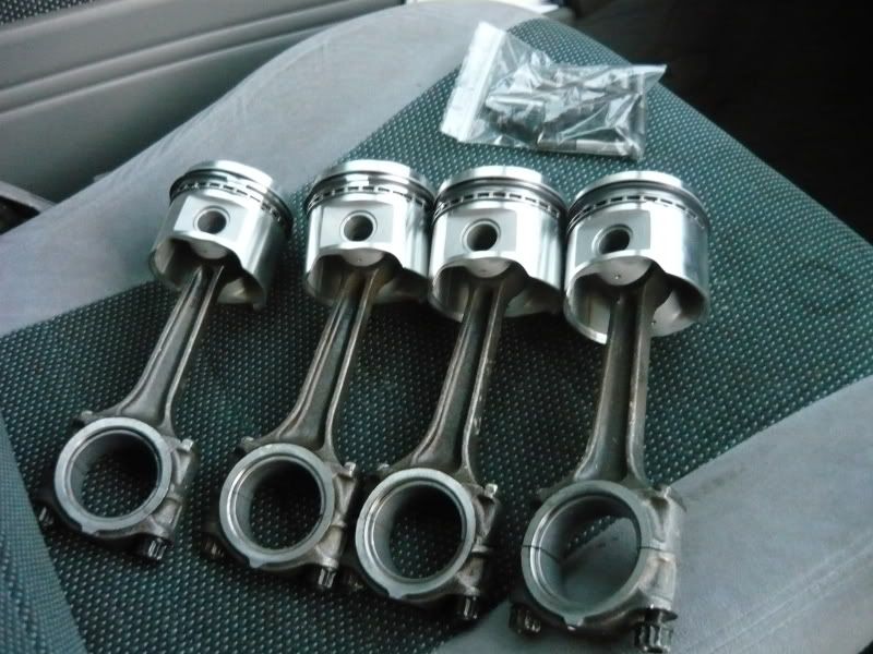

Picked up my engine from MED with the bores all honed and new cam bearings fitted.
Also picked up all the internal engine components from MED.
The Omega's pressed onto the rods!
Also the new rod bolts

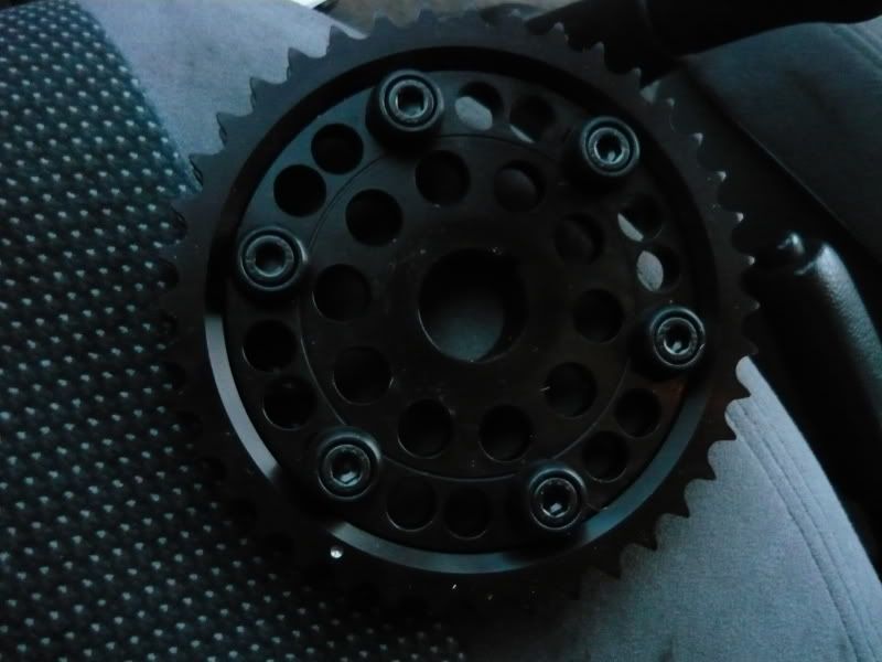

The new piper vernier duplex gear

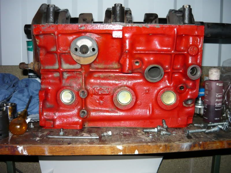

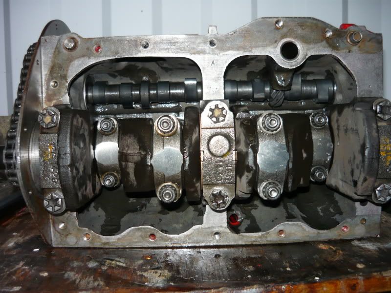

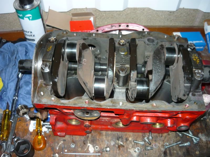

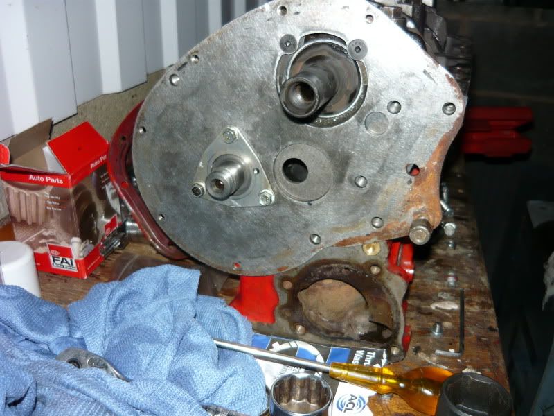

Took the block and crank to work and gave them a good clean in the parts cleaner!. Mainly to remove the dirt and the metal from when the block was honed.
Fitted the new Main bearings and the thrust washers, then dropped the crank in. Tightened down the main bearing caps.
Fitted the new cam followers and the new cam. Fitted the timing plate and that triangular plate that goes on the end of the cam.
Tapped in the new core plugs.
Here is a few pics!

Dropped the pistons in, fitted the oil pump and put the vernier on. Its only lined up dot to dot at the moment, not been set up with a DTI gauge to spot on timing. I phoned Tracktive Solutions today to see how much they would charge to set up the cam timing but they said they are too busy really and I would be better taking it to a mini specialist.
here is a few pics :
