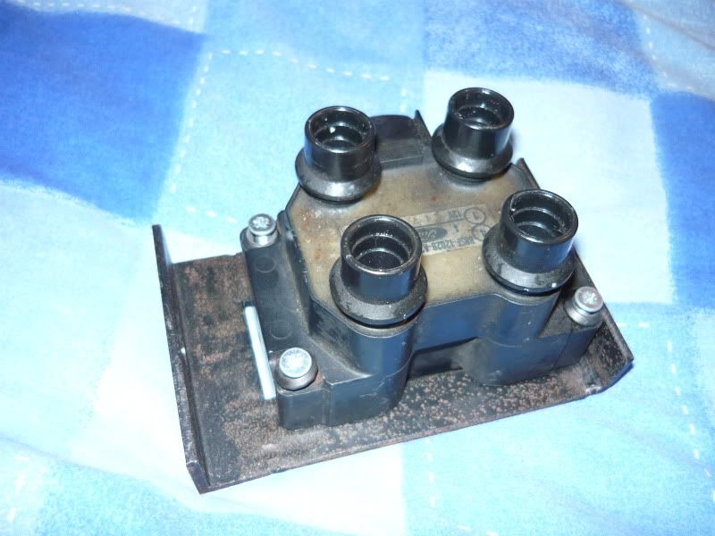

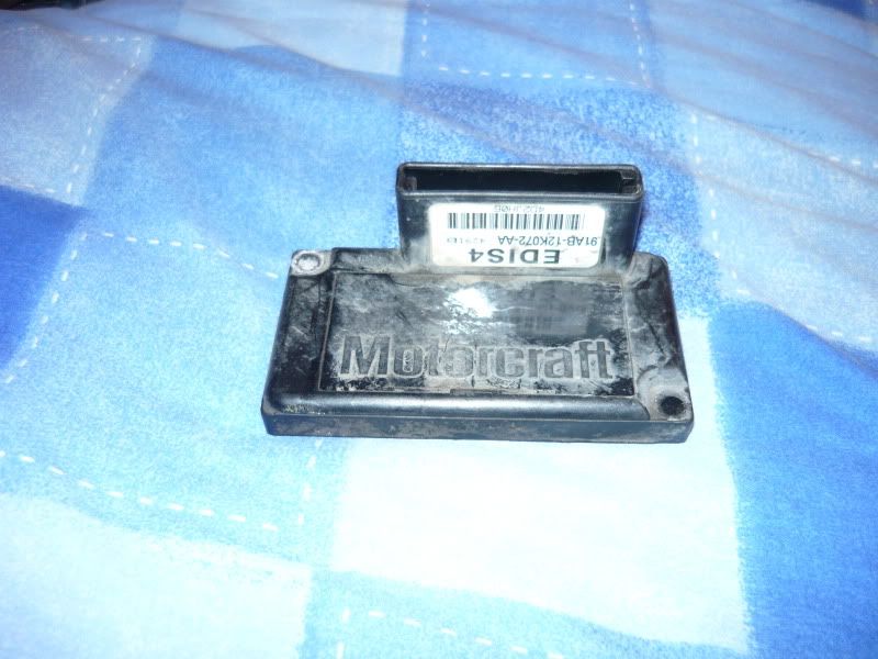

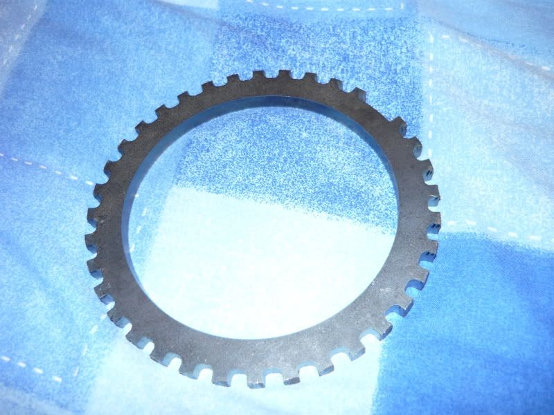

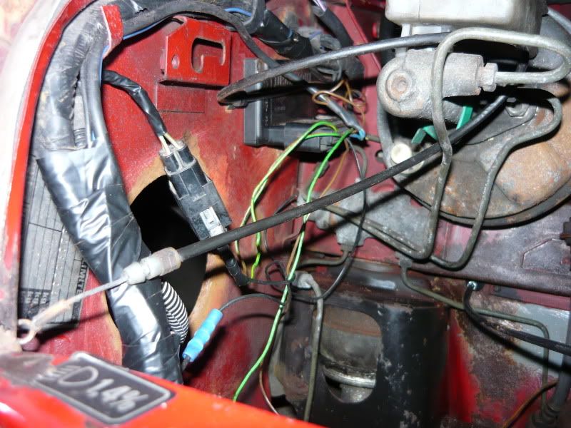

Bought a Megajolt setup earlier in the week from the classifieds...
It was delivered today...
Brand new MJLJ V4, with a base map preloaded onto it, never been used.
Came with a Ford coilpack, EDIS unit, VR sensor, an A series trigger wheel and the full Ford wiring loom, which means I can leave it untouched apart from connecting a +ve and -ve to the EDIS and the MJ unit... I'll then only need to connect the PIP ans SAW wires to the MJ and wire in the rev counter and I'll be away :D
You will see in one of the pics I laid it all out how it will go, and it stays pretty much complete.
thanks for looking :thumbsup:

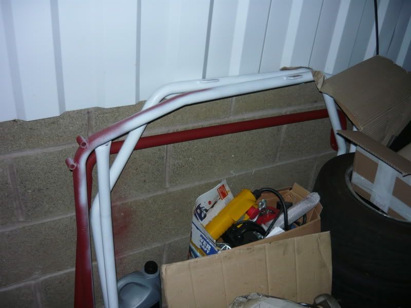

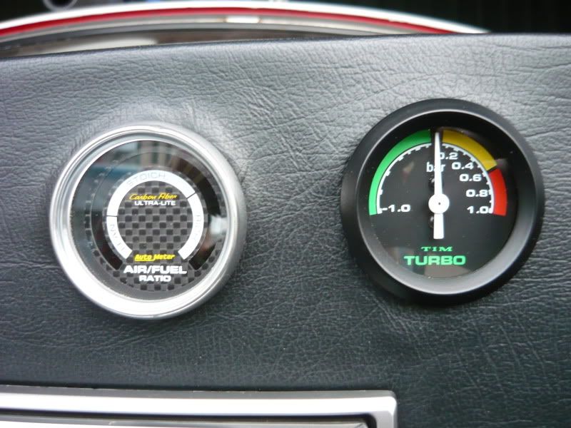

  • 1,188 posts
Posted 24 August 2009 - 06:17 PM
Hi,
Just to update a bit more work from the weekend.

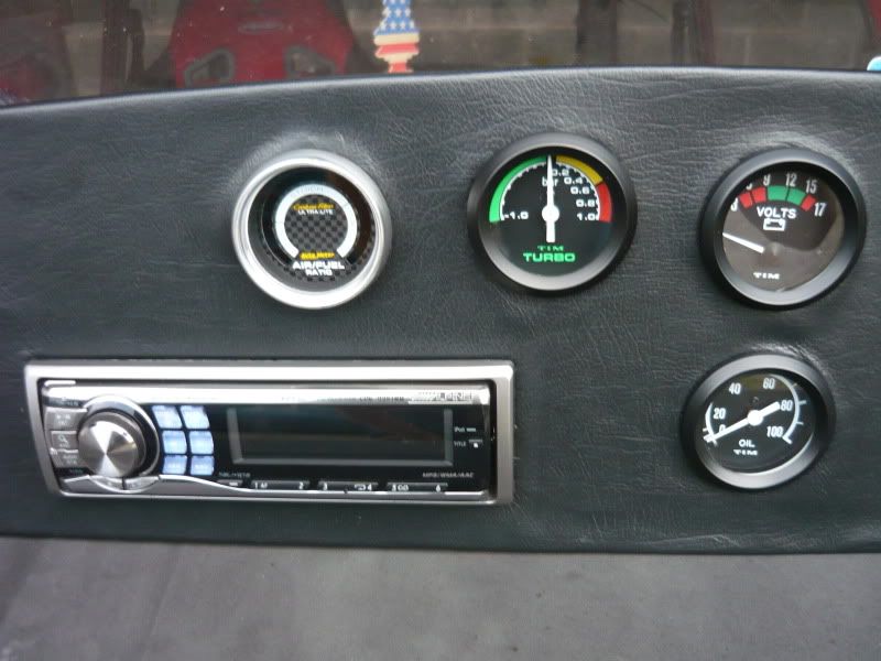

Fitted the boost gauge and AFR gauge into the dash.

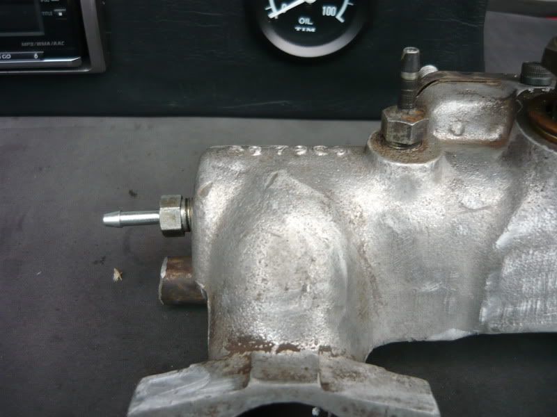

Drilled and tapped the inlet manifold for a couple of vac pipes. Thanks Dan for the use of the taps.
Sprayed the roll cage but ran out of paint...

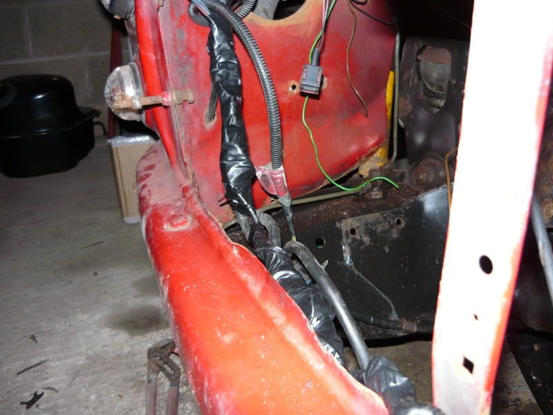

And positioned the EDIS where its going to be (nut and bolted through the inner wing) and routed the wires as needed. Then taped into the loom.
