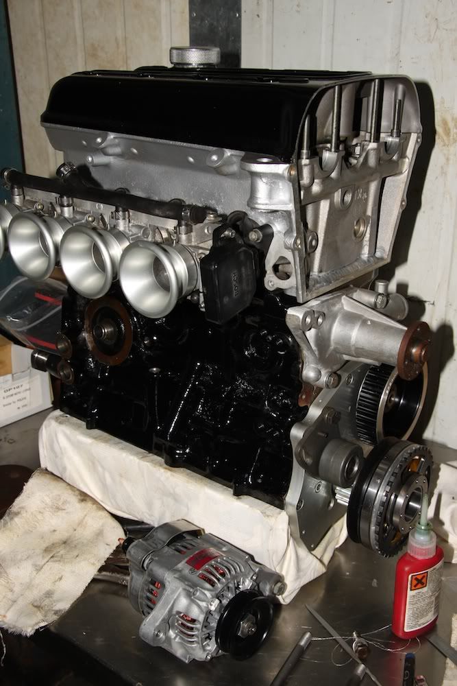

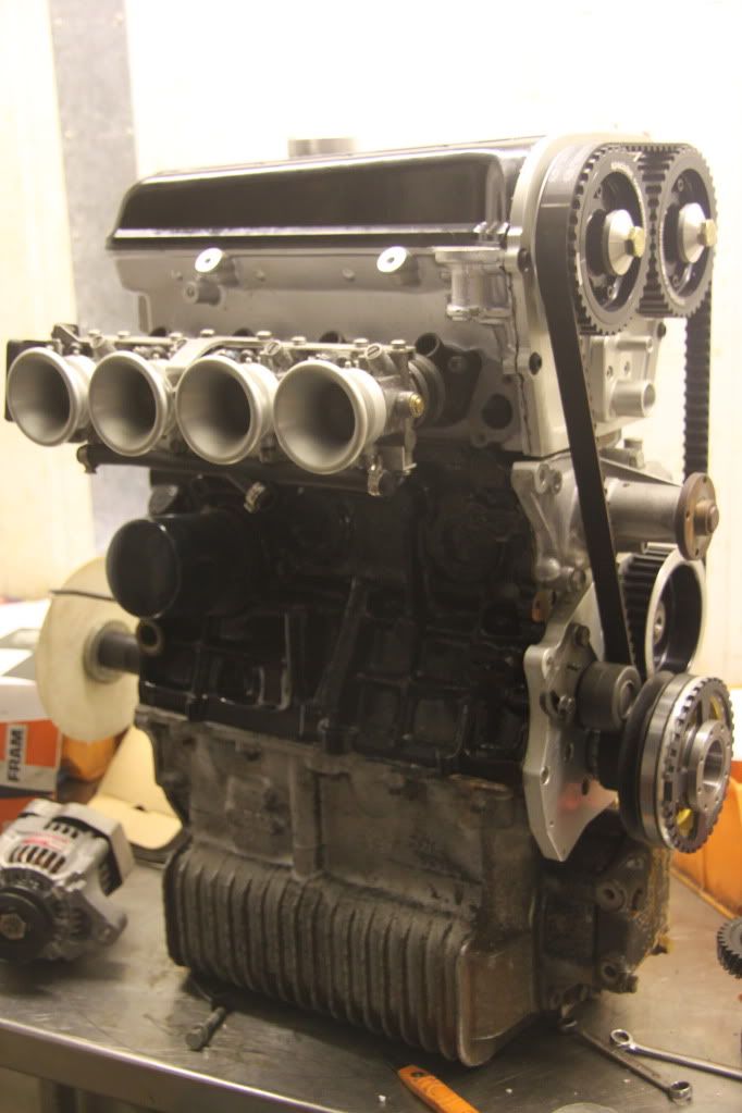

As for the engine, I think i'm making that a winter job now, as i intend on removing the subframes and replacing them as well. But it is still in the process of being built, below are a couple of photos. I suppose it depends how quickly i can get enough money together to do it all!! I do have the majority of the parts, but still need a few like exhaust link pipes, starter motor, rad, hoses etc.
It's all torqued down, I just need to fit the cams and time it up - which i'll be doing in the next few weeks - so keep checking back for updates :P

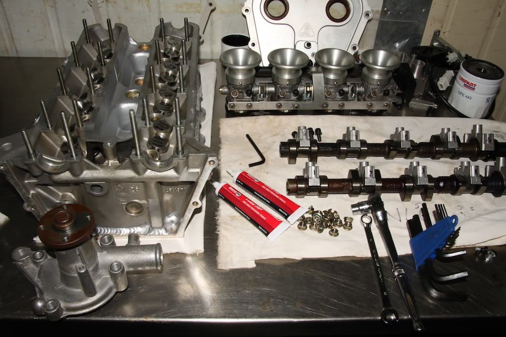

Well, today I managed to get the cams bolted down and the engine is now bolted to the gearbox.

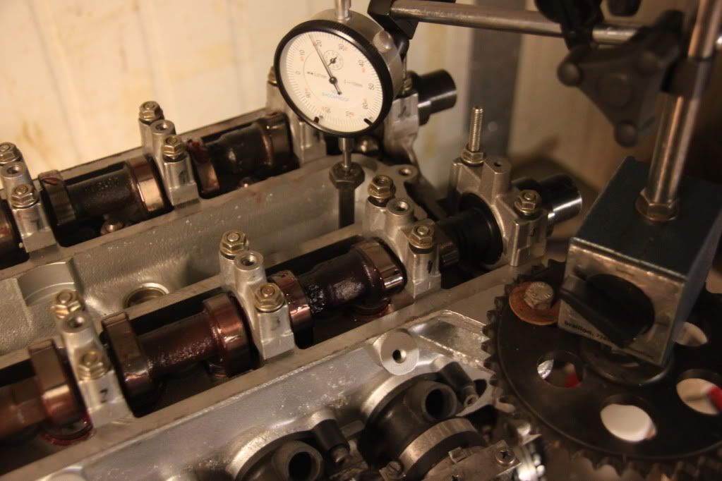

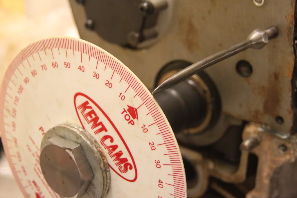

Today I spent timing in the cams, not a fun exercise when you have to keep un doing the tensioner to reposition the vernier pulleys :D But its done now!!
Getting TDC
My pointer I fashioned out of a 5/16UNF bolt and bent push rod :)

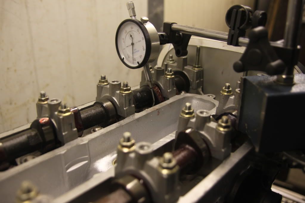

Getting the correct valve lift
Ta da, it's nearly finished :D -

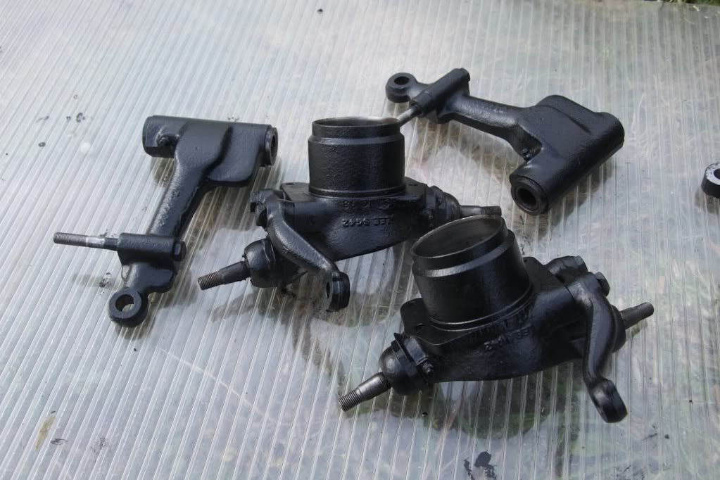

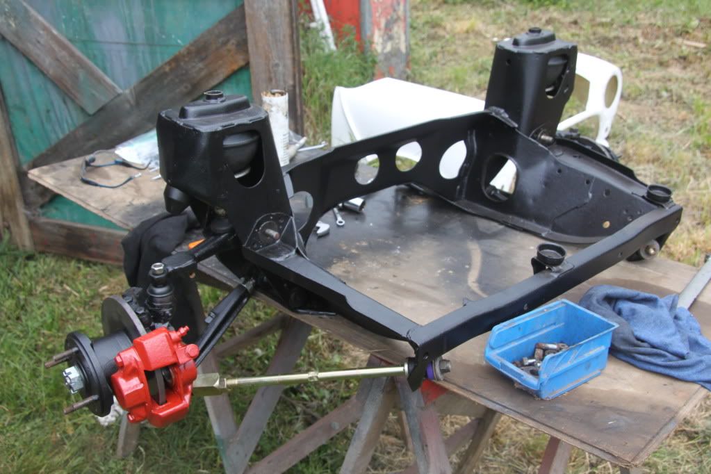

Today I started to build up the front subframe, with all the nice painted bits and using new rubbers, CV's and bearings. I also ordered alot of stainless steel nuts and bolts for various bits on the front and rear subframes, because I don't like putting old rusty ones back on, an expensive exercise :techsupport:

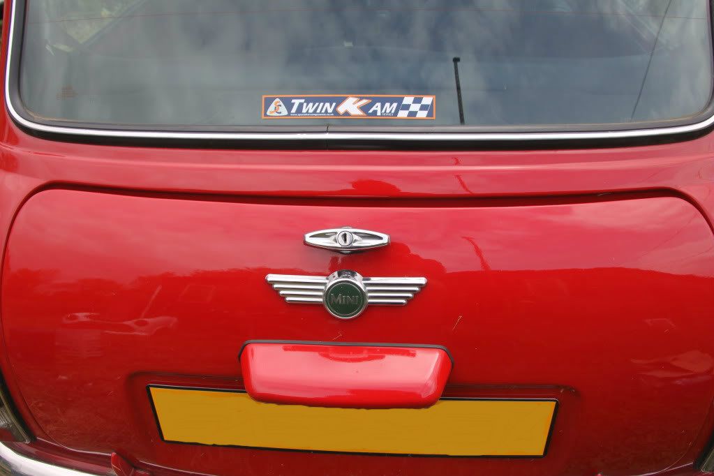

I also did the most important part of the engine build, and put the Twin Kam sticker on the rear window :lol:
