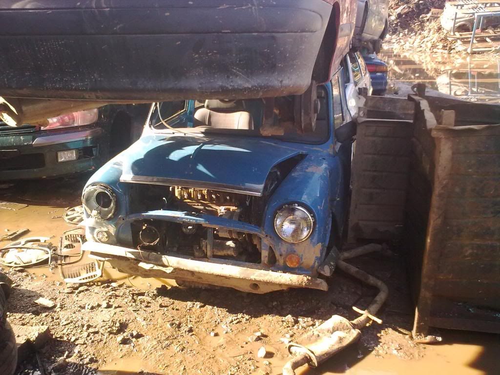

day 27 started in the scrap yard
pooor mini :shifty:
it was really really really soild!!!! its such a shame >_<
but we still got a shed load of spares off it - mostly to go in my spares pile for the sky :o

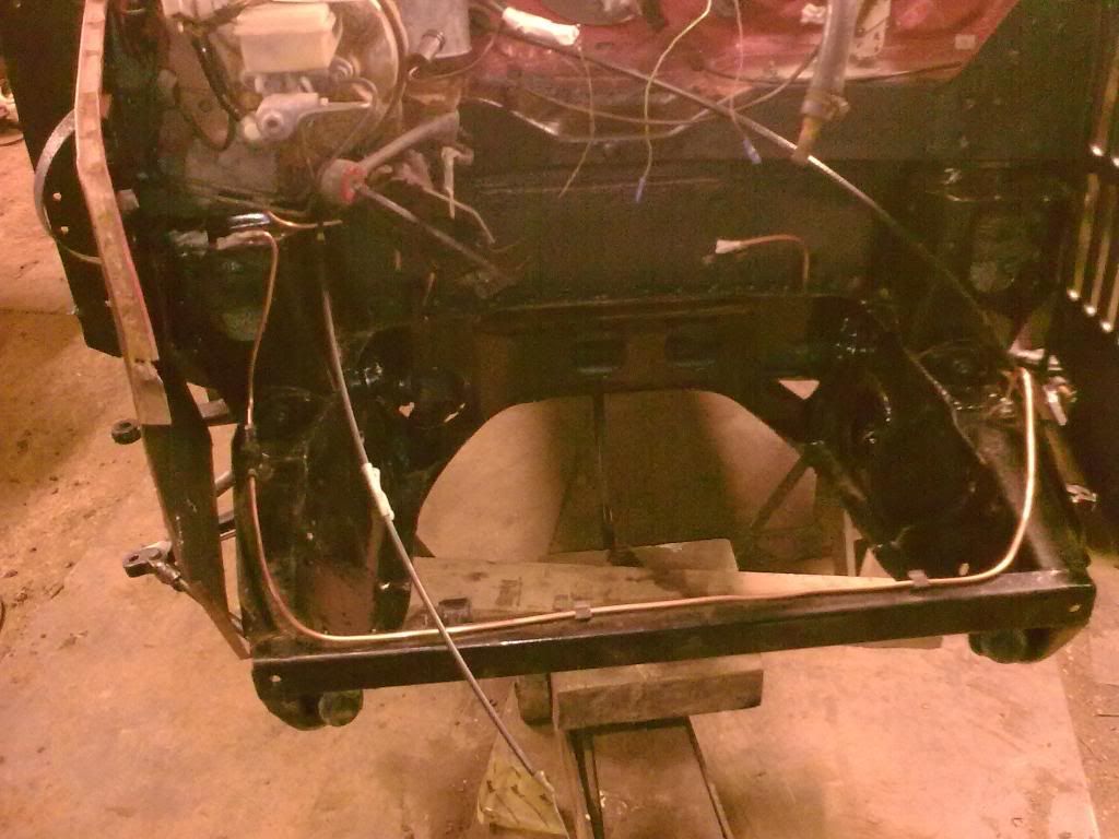

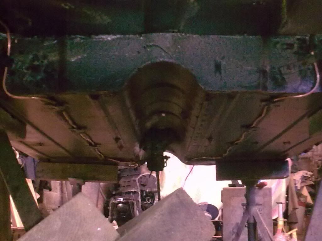

then i made the front to rear brake line

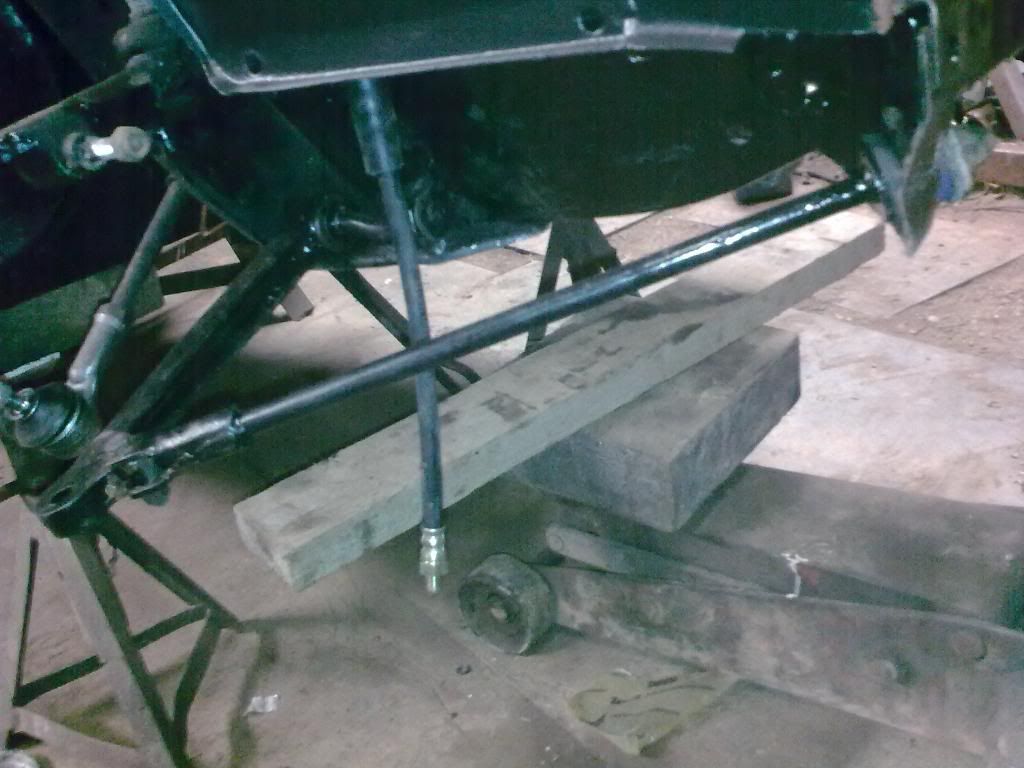

and woo fitted it and the fuel line
i did make the brake line FAR too long but hey - its better than being too short!!!

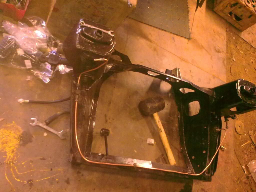

then i made the new brake lines for the front subframe
i'm really happy with them they looke lovery!!! i also fitted the new flexis, then pecks put in the new subframe mounts and i fitted the bottom arms + tiebars with new bushes
then we bolted it back into place
happy days :o

Why not have that mini in the scrapyard? Even if it wasn't another project for you you could sell it so someone would be restoring it and prob make some out of it as well. Also builds looking fantastic as always.
there was a car sat on the roof!!! and most of the panels are bent :shifty: - its probably in under the scrappage scheme too so won't be able to put back on the road >_<
someone has been there before us and trashed the steering column/stalks/and wiring loom :)
Oh I see, I just thought it was up above it as it looked like that from the pictures, well to me.

even on the scrapyard the mini is holding strong, looks like an '87, even the engine is worth looking at. The Criminals!!
i think it was a 89 ish one, because it had a servo and the engine number is 99he... which is the same as the sky's, but it is a auto!!!, it also has got the enclosed bootlid rather than the open frame type again the same as the skys..... it just a shame its got a massive dent in :lol:

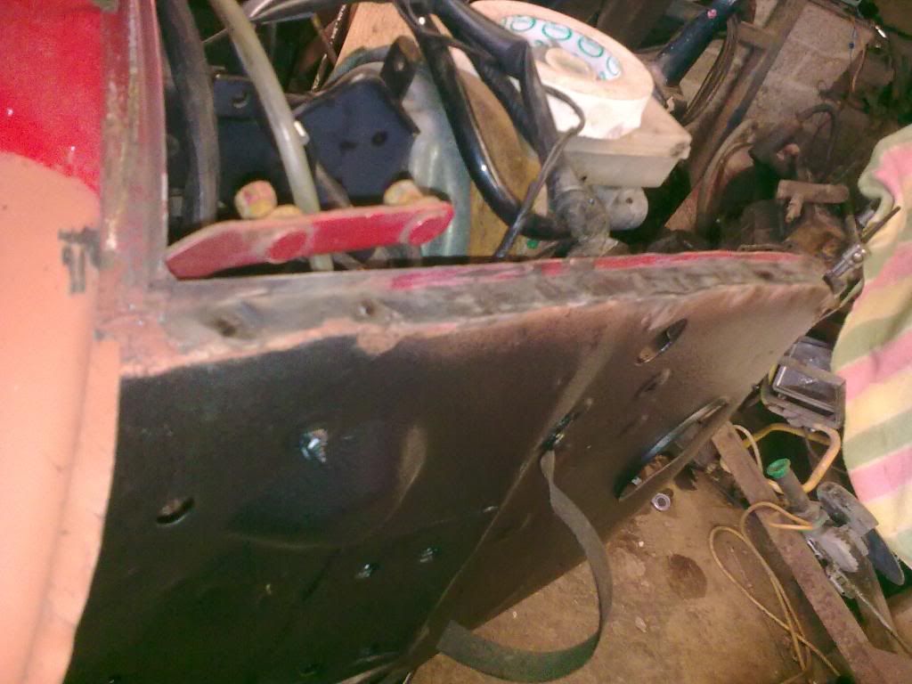

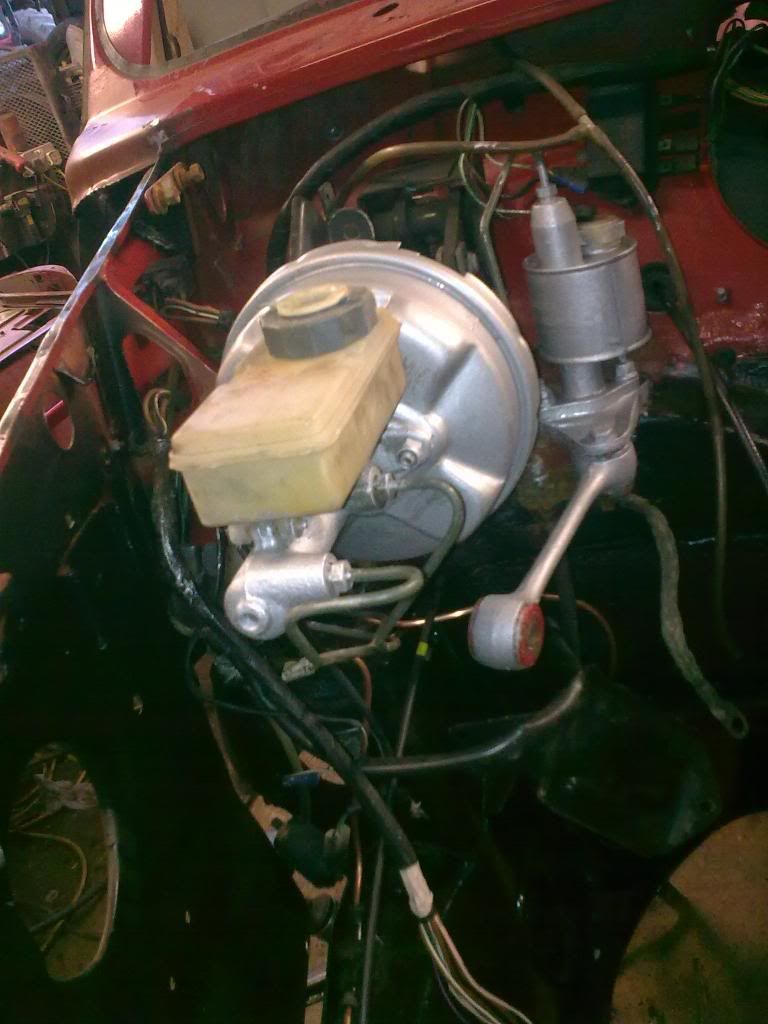

pecks cleaned up and repainted the servo, clutch cyclinder, head steady and the mounting braket

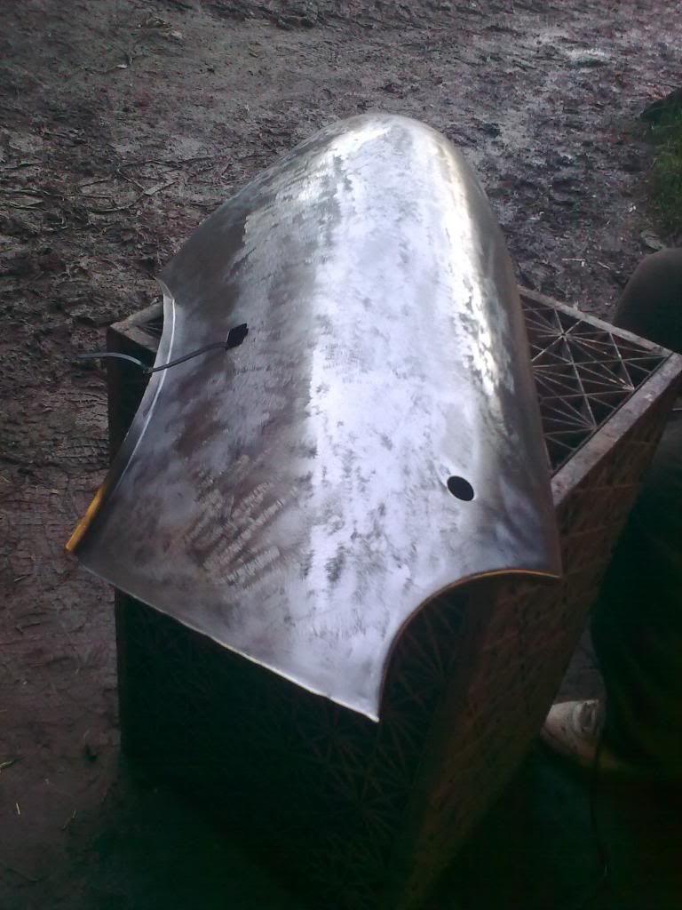

then spent the rest of the day cleaning up the 'new' wing
we got it about 3 years agoas part of a lot from ebay and they have had it for a few years with out using it!!, its a genuine wing, but was covered in surface rust!! - so thats pecks job for the next few days!!!

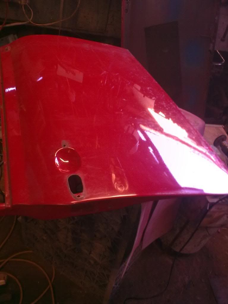

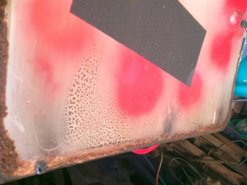

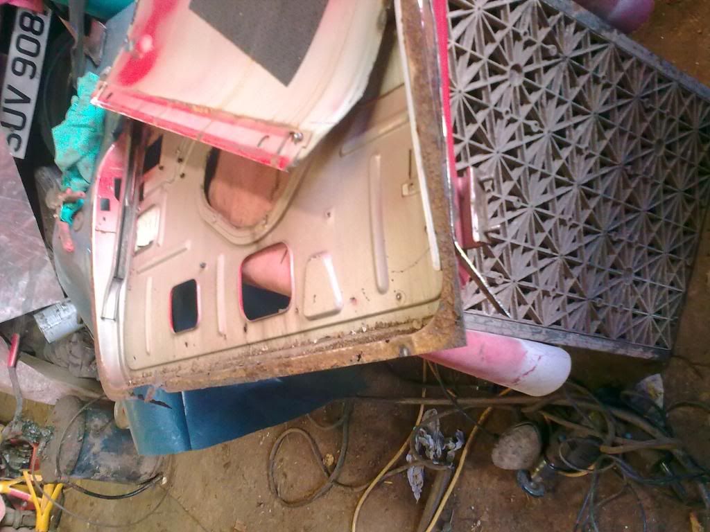

and i have been repairing the doors - i did the passenger one first as i thought it was the worse because the skin was more rottom on the bottom
so these are the repairs
easy!!, the passenger door is now all ready for the new skin :lol:

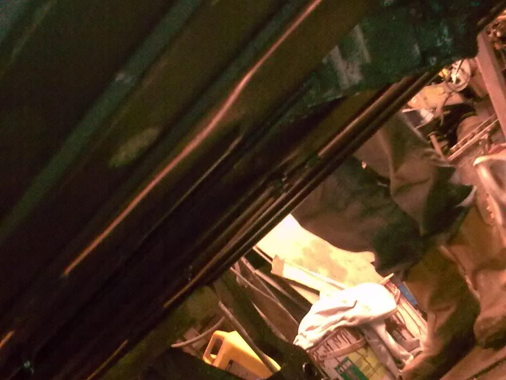

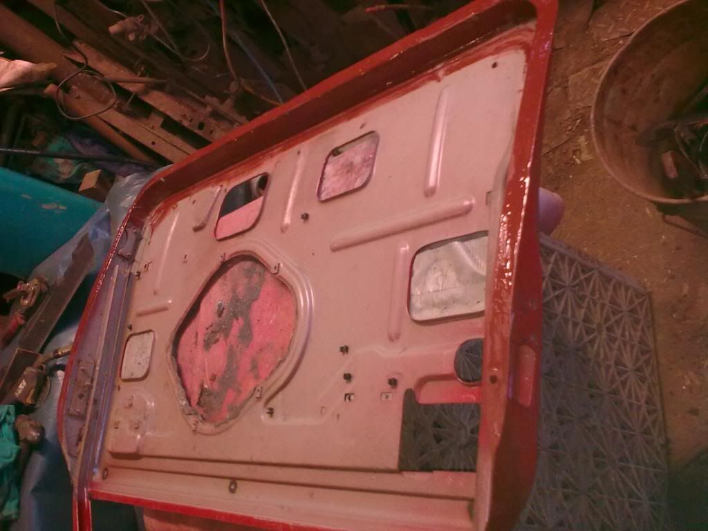

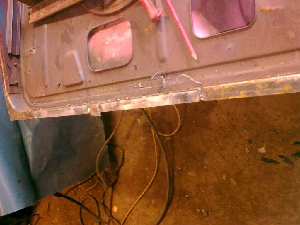

and the drivers
skin off
old skin
the remains of the door
:roll:
that would be the whole bottom lip that needs replacing then!!! - this is what happens when minis aren't waxoiled!!!!! -waxoil = no rust!!!!!
so repaired and painted
i just need to take one of the hinges off on this side to grind back a random weld that was holding the skin on.....
i also rewelded the damage from the spotweld drill on the top of the inner wings
and ground back these to work out where i need to replace!!

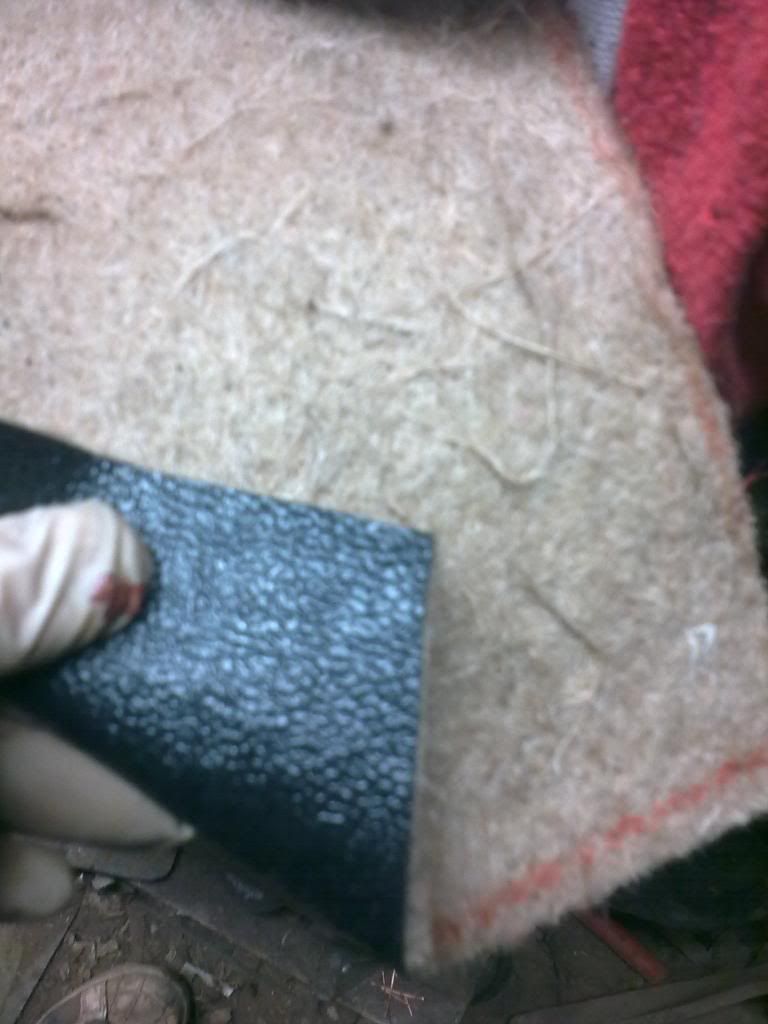

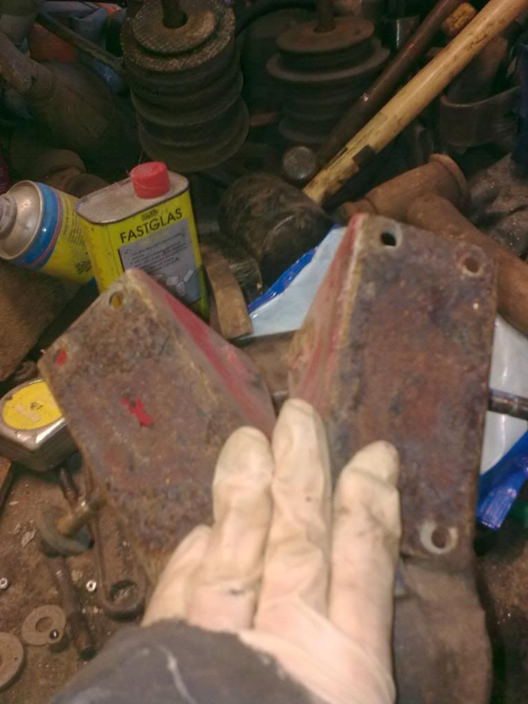

and does anyone know where i can get some of this
i got this bit from a mini show and i want some more to use as a bulkhead liner.........
the plan for today is repair the shock mounts, grind that weld back on the door, refit the engine....... and then either start building up the front suspension or make new brakelines for the rear suspension and refit the rear subby......
