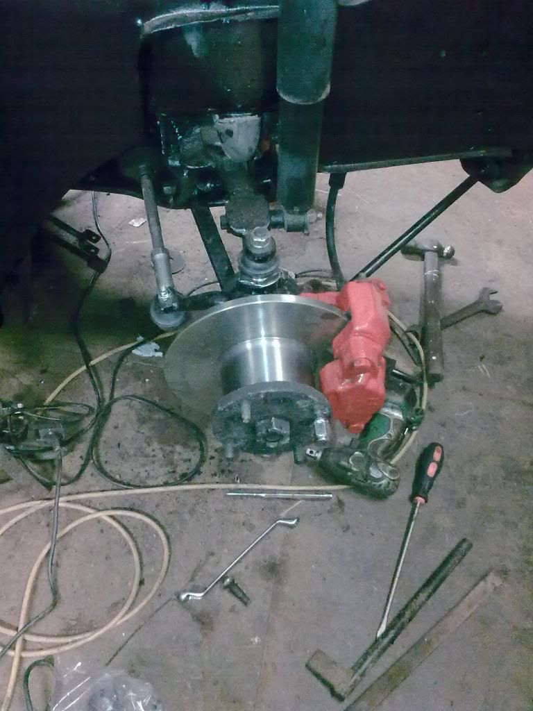

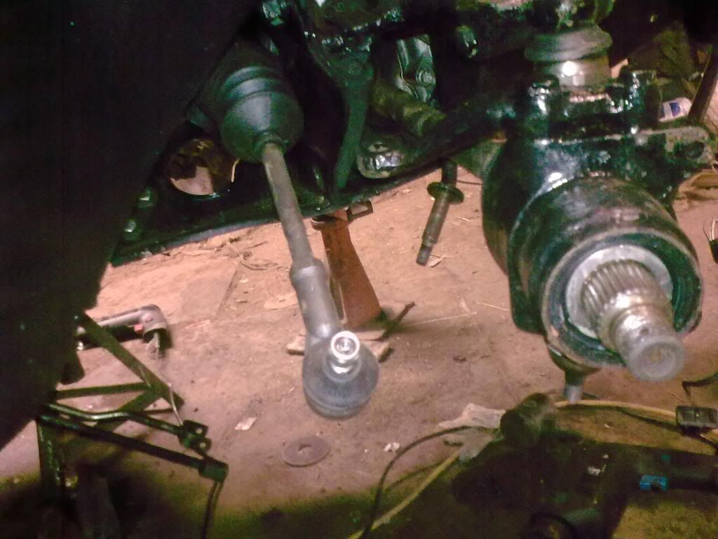

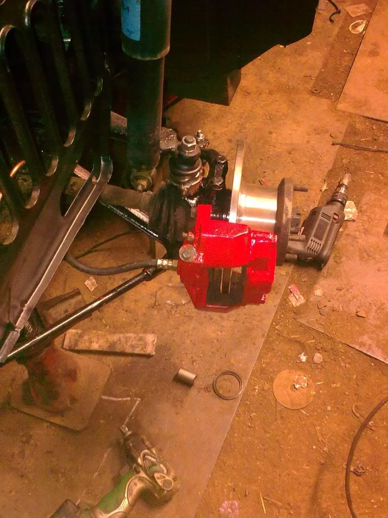

got the bottom arms the wrong way around!! FAIL - i didn't think they were handed, but the holes for the ball joints are tapered..... FAIL, so after quickly swapping them over - i built up each front hub - including untwisting the brake lines - GAY job!!!
we still need to get a brake pad fitting kit for the new spilt pins i have the new clips but the old spilt pins are knacked and one side they are really thin ones used.......

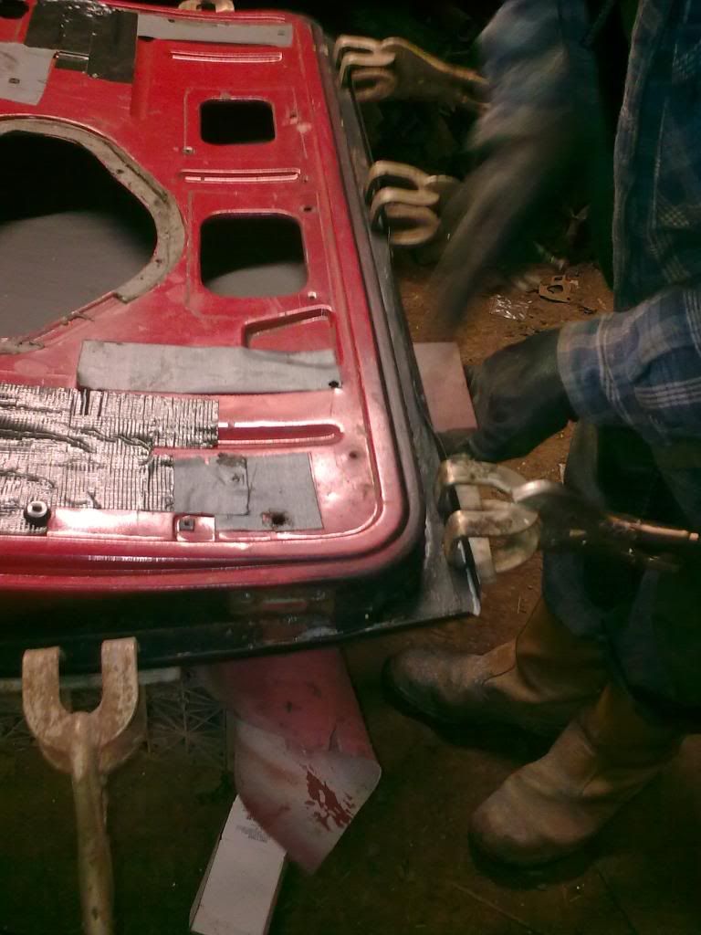

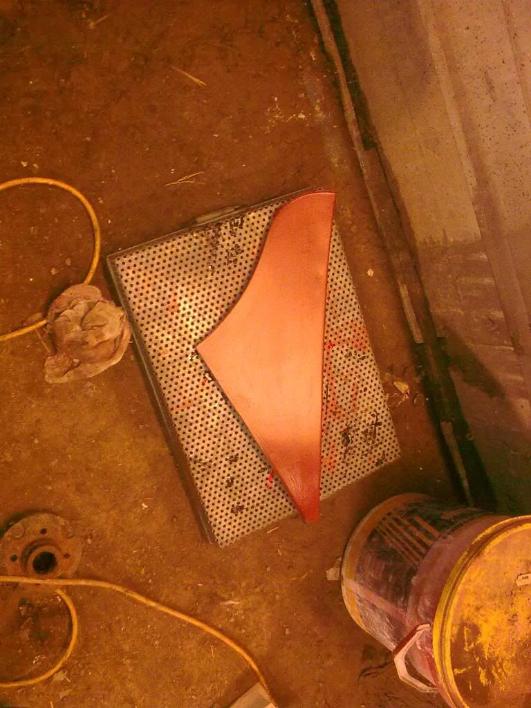

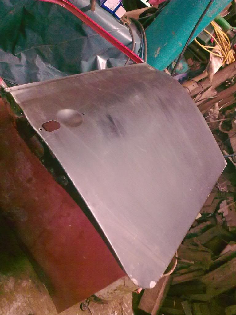

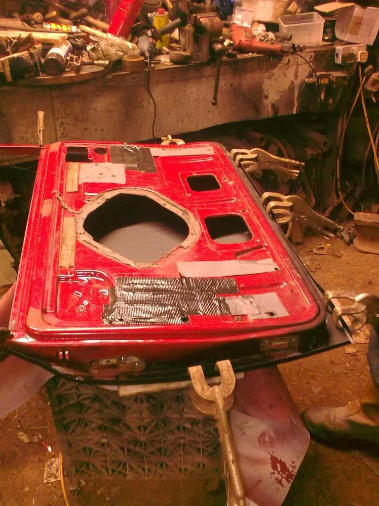

then Fonzy has been doing this to the passenger door - which i REALLY appreciate :kiss:
and done and welded on.....

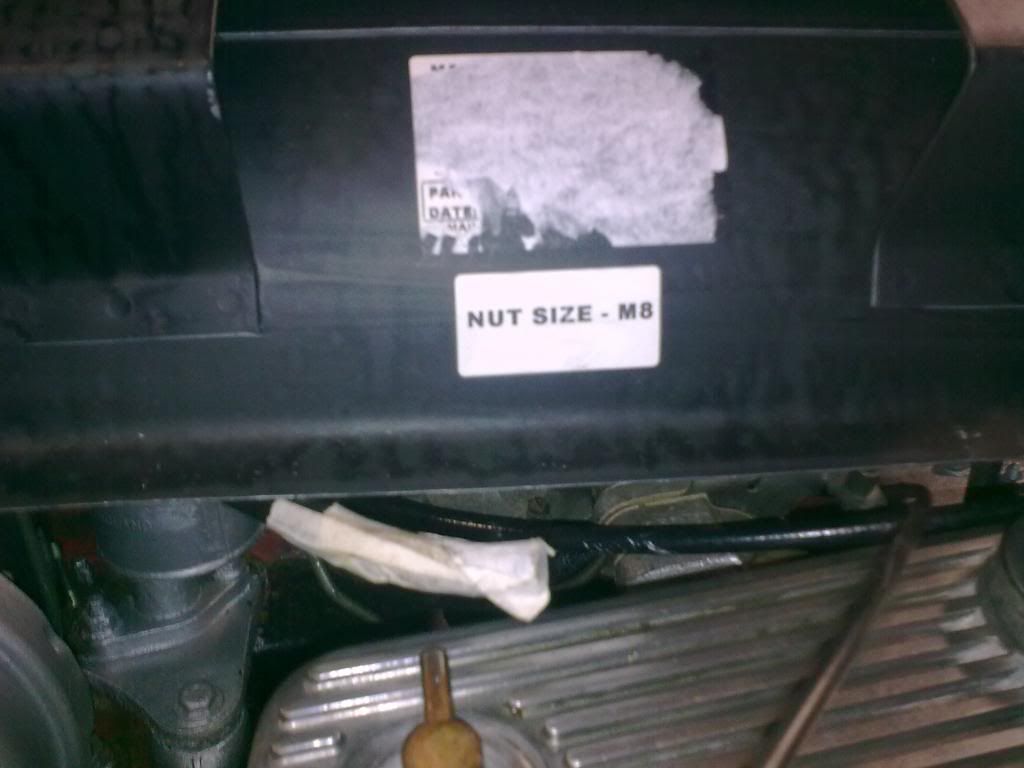

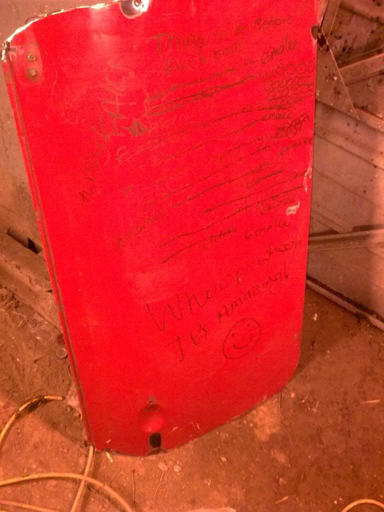

then i unwrapped the new front panel and found this REALLY helpful sticker

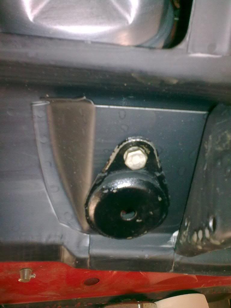

and found the said bolts and
new mounts :w00t:

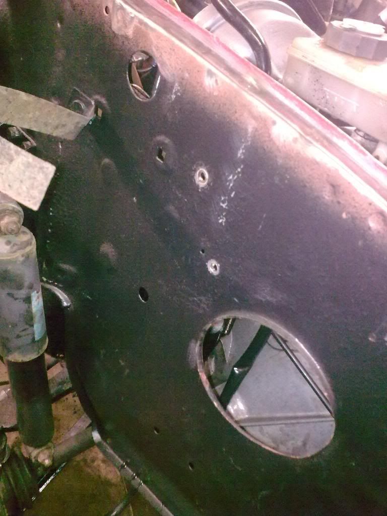

i'm gonna get wooo to paint the inside of the front panel while it off and easy to get to!!! and Fonzy is Looking forward to the challenge of making the new panels fit!!! -he really is.... honest!!

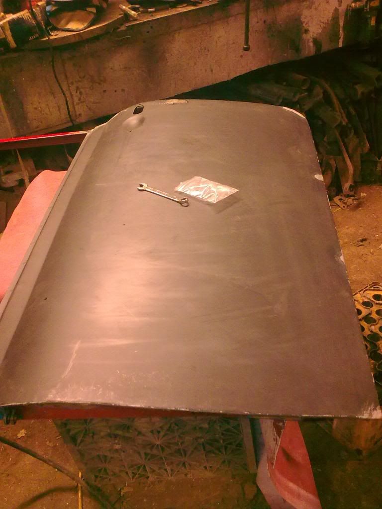

and also got the new bonnet out....
just gotta grind off the extra hinge mounts for the MK1 hinges and i think bend it up slightly in the middle!!!

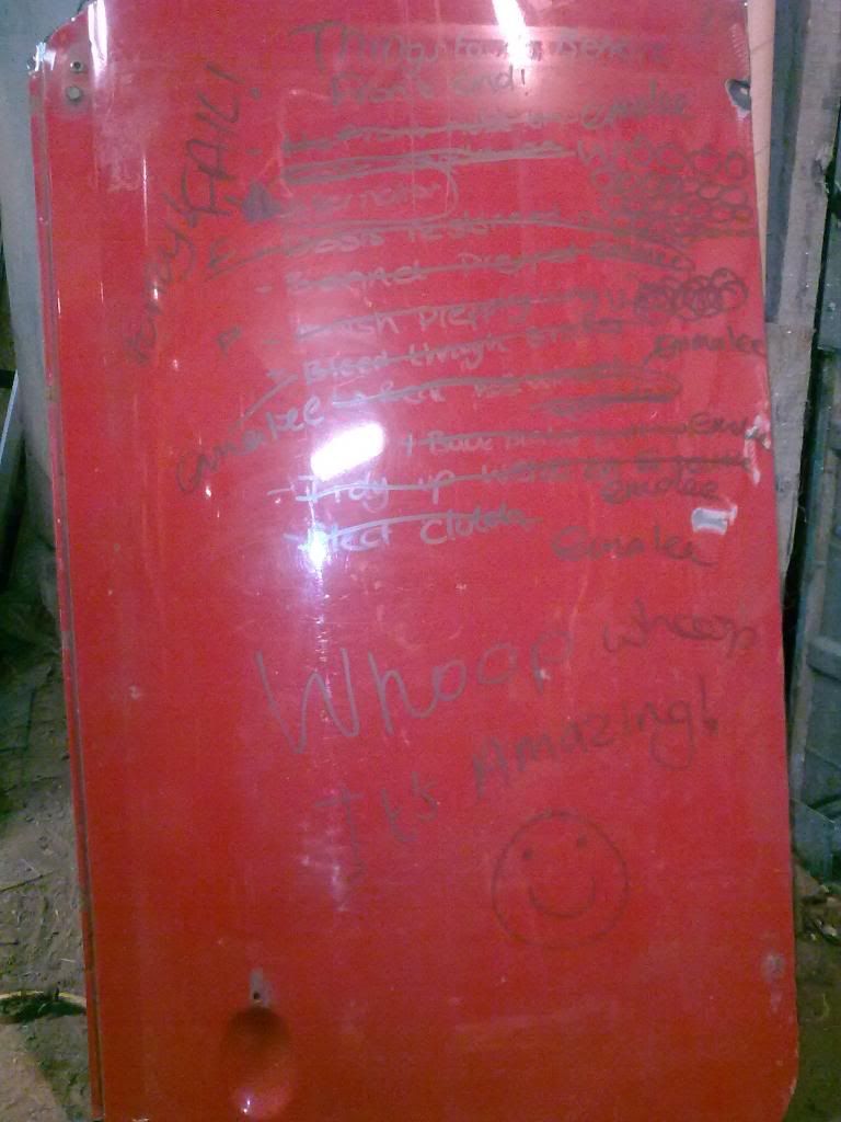

day 34................
didn't think it would happen but.....
the list is all ticked off - well apart from the alternator, because i haven;t been above to get the fan belt :tumble:
sooooo happy its all done tho!!!!

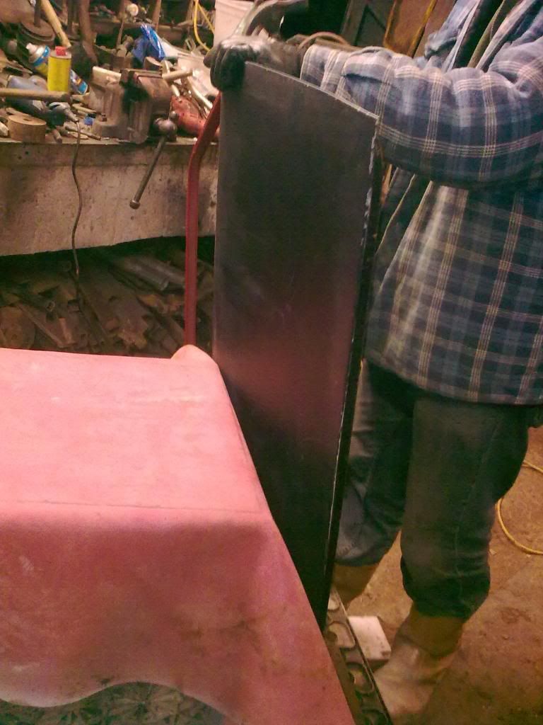

then helped fonzy briefly refit the drivers door to see if it all line up - the skins we had from seems a bit too long.. so we wanted to make sure it wasn't gonna cause a problem and it was fine :P

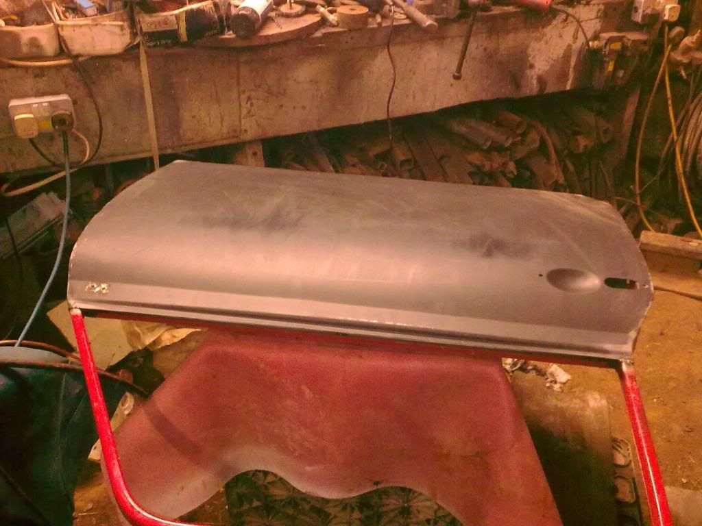

Then Fonzy reskinned the other door and welded it all up

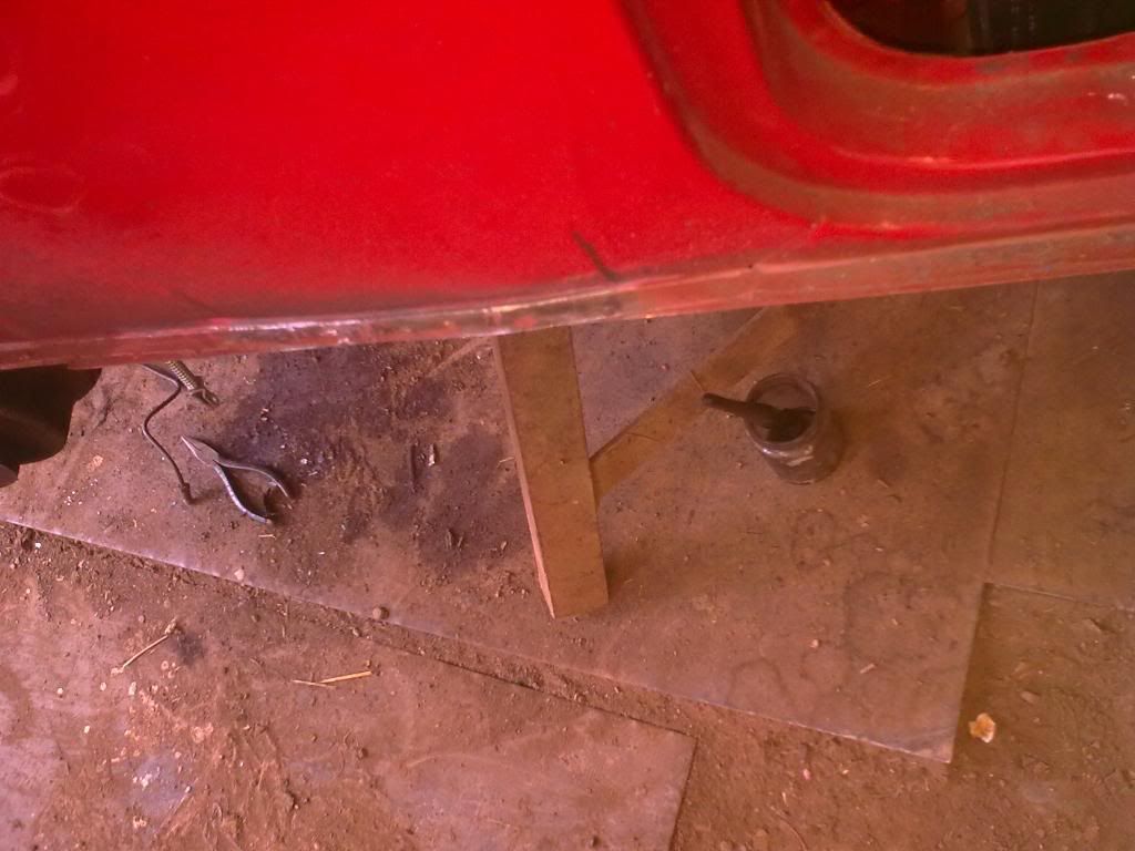

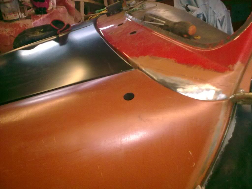

fixed this FAIL i made when put the sill on - the side popped out and i didn't notice
so i cut and rewelded with the side pushed back in, sooooooooo much better now!!!!

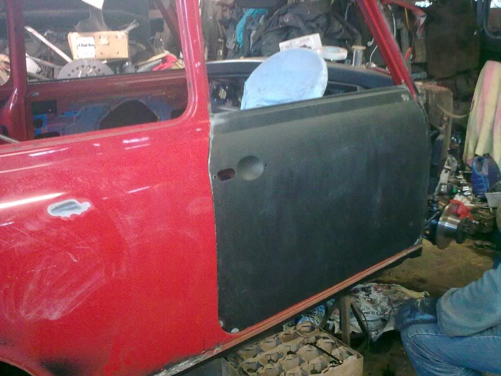

then me and wooo lined up the passenger door - taking the oringal shims out.... and then me and dad lined the drivers door up adding some shims...

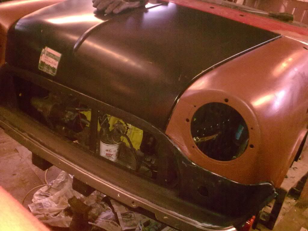

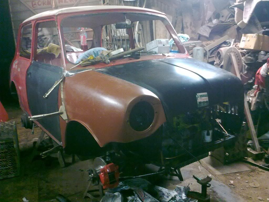

then fonzy fitted the a panel and wing
and then the bonnet
which still needs moving back towards the scuttle - and the hinges re drilling - the wing also bends out half way down the inner wing leaving a bit of gap :shifty:
Fonzy wants to lead load the seams, but didn't check what equipment has to do it untill today.... and the paint stuff you put on to prep the area has dried out :kiss:
so all the front will have to come off again to prep the joints :P - but at least it will all be line up!!!!

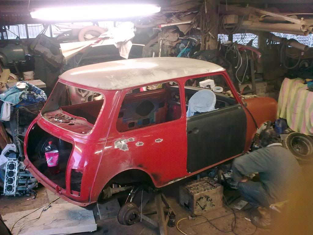

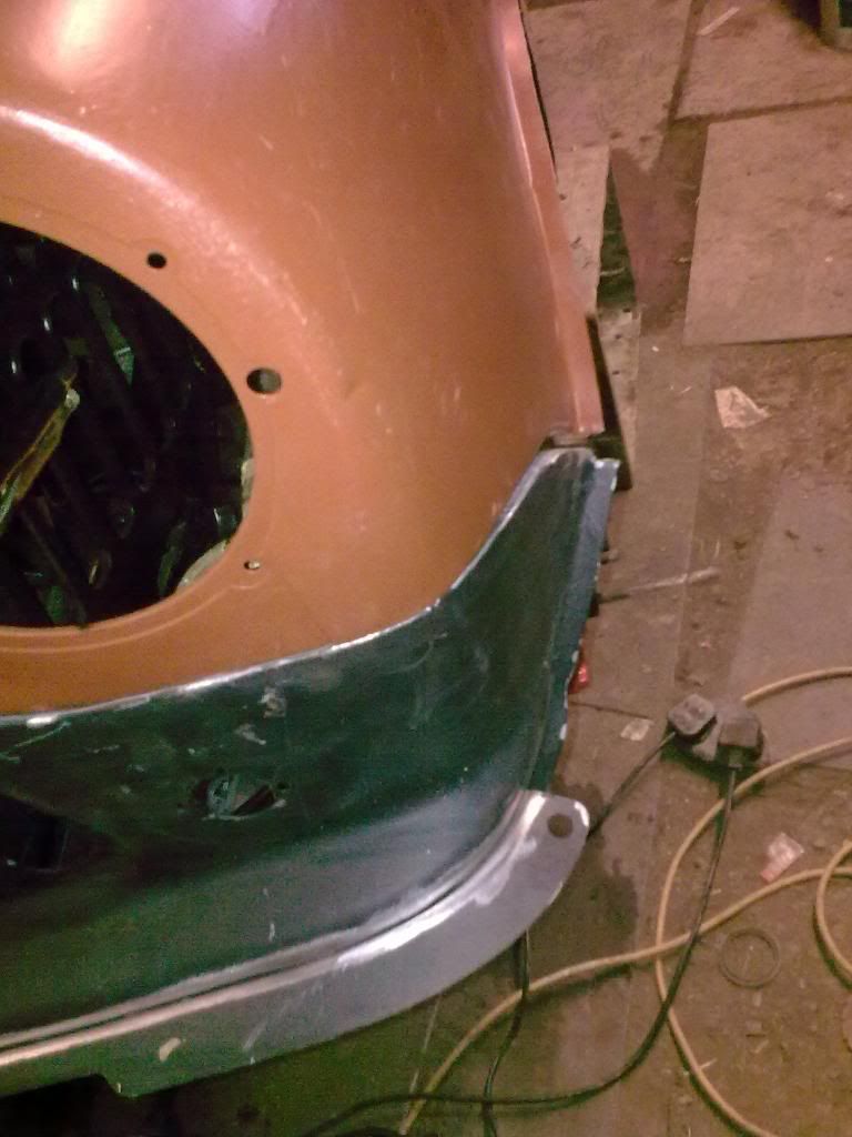

then me and pecks started rubbing the back end down ready for primer ;)

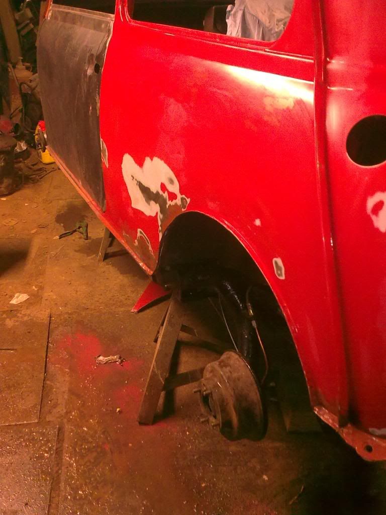

rear quarter with is random damage

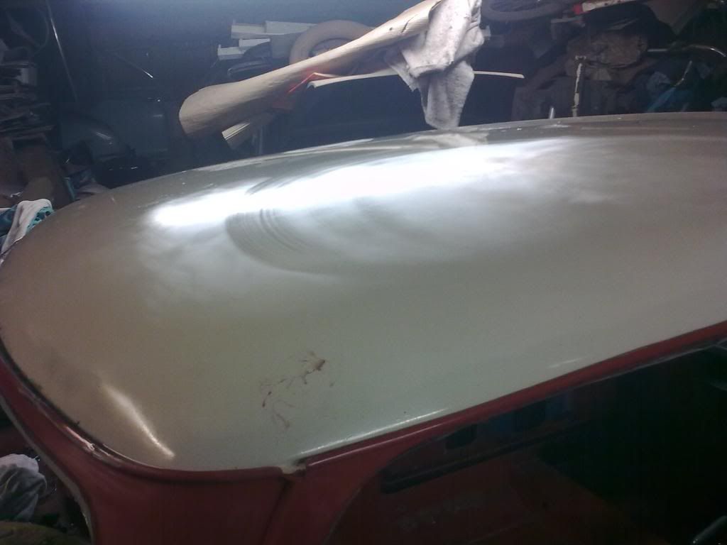

and half the roof!!
the roof looks really good, the back panel is ready for primer and the passenger rear quarter still needs a bit of work and some filler work over the repair

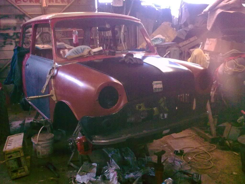

day 36.......
came home for Devon Mini cafe run to find.....

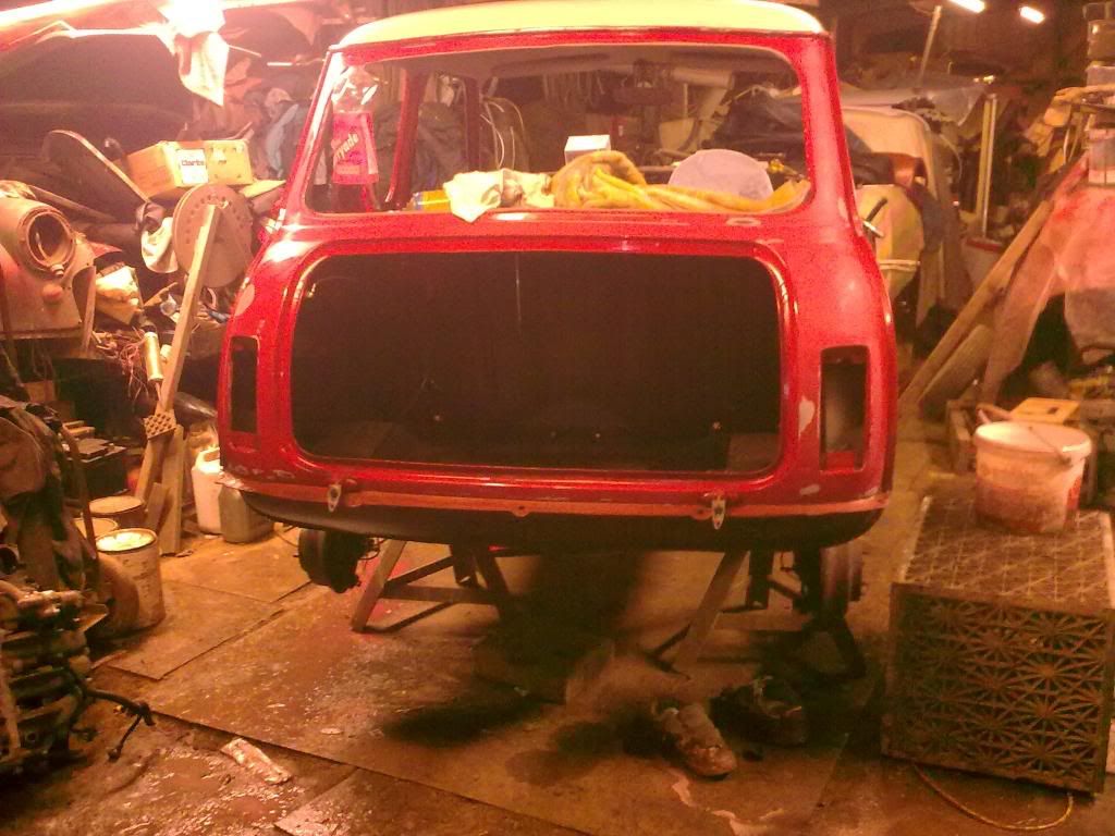

MINI!!!!!!!
whoop whoop

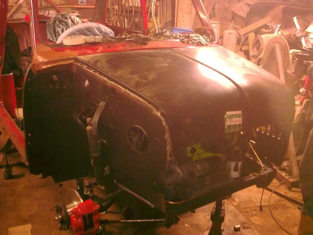

there is just the passenger front seam for the wing/front panel to 'make fit' but fonzy ran out of clamps...
but its looking goooooooooooood
i'm gonna weld up the drivers side tomorrow afternoon, and start on some filler work on the bottom of the rear quarters and i'm hoping the masking paper will arrive so we can lay some primer on it.......
