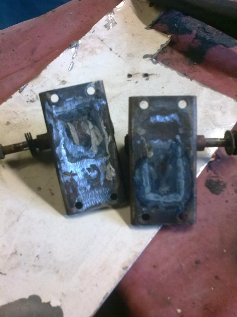

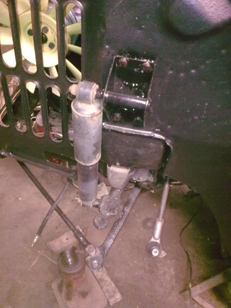

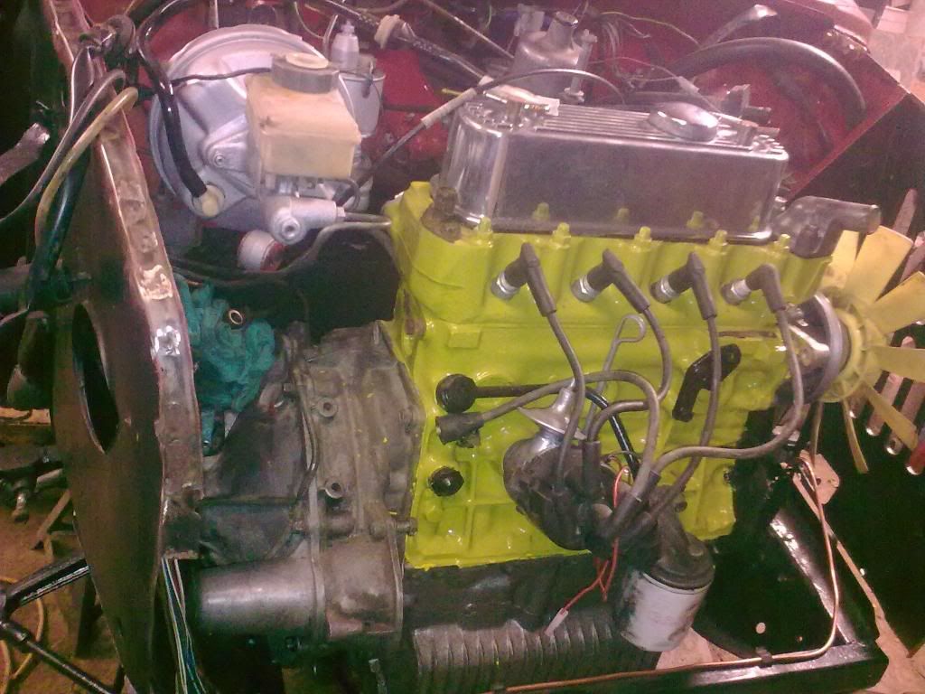

right shock mounts repaired

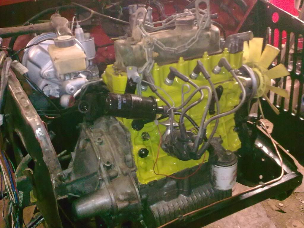

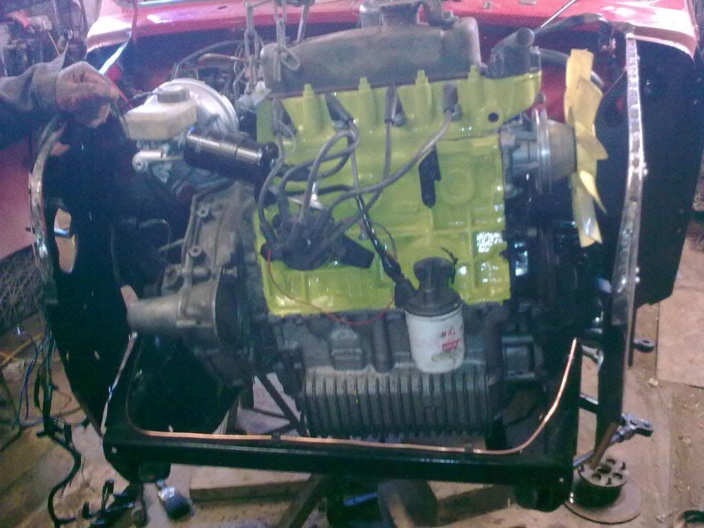

then fitted the engine
half way
and in
we've done up the bottom mounts, but thats it so far.....

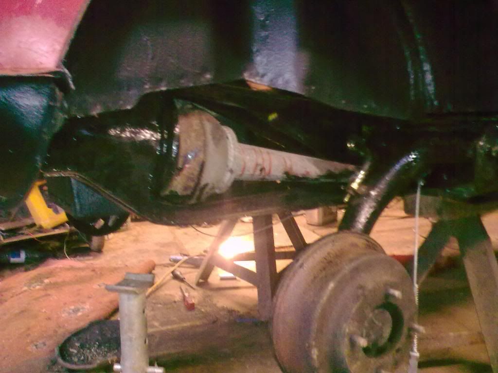

then i started on the rear sub, and put new flexis and the handbrake cable
and made up new cooper lines for the radius arms - and greased the play out of the arms - i think it will need new radius arms for next years mot!!!!
so with the new pipes and handbrake cable fitted, the subframe went on.....

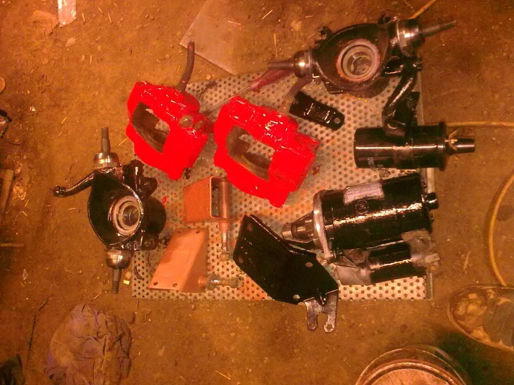

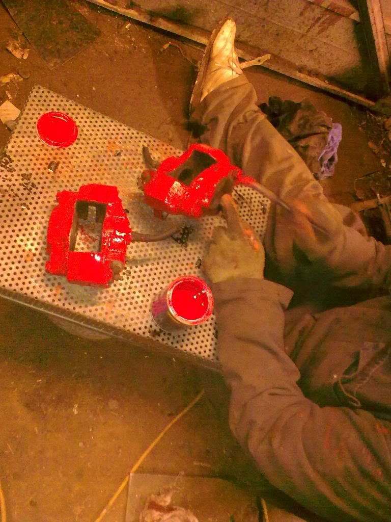

and i cleaned up the capilers ready for wooo to paint

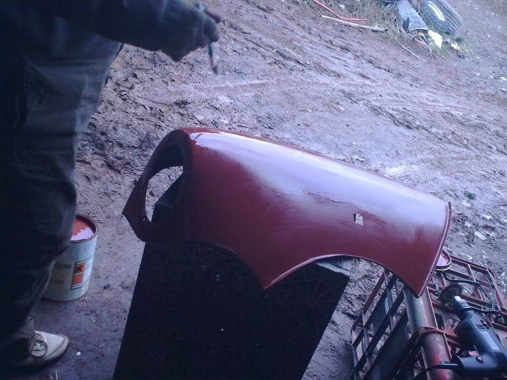

and pecks as been busy on the wings again...

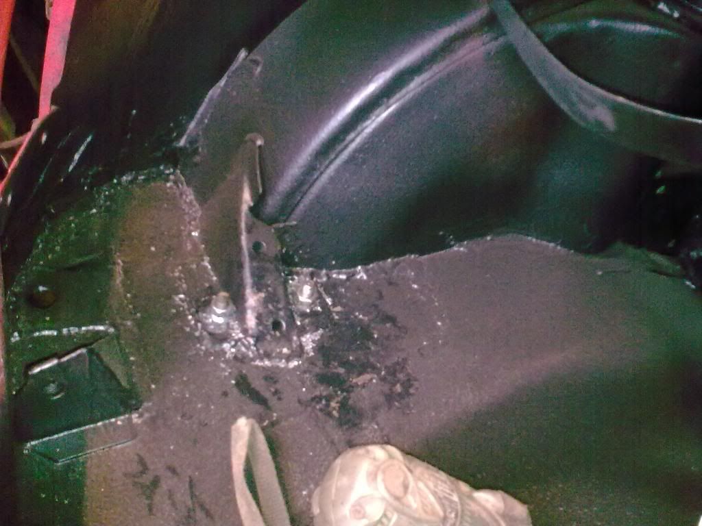

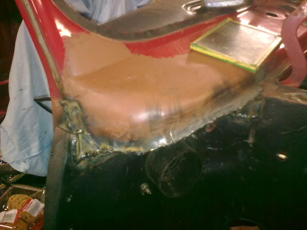

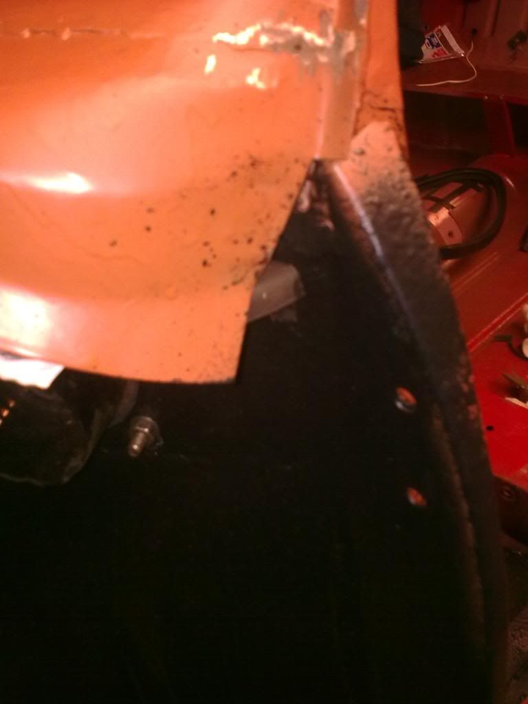

then i fitted the scuttle closing panel on the drivers side and closed it all up
still got the passenger side to do tho!!

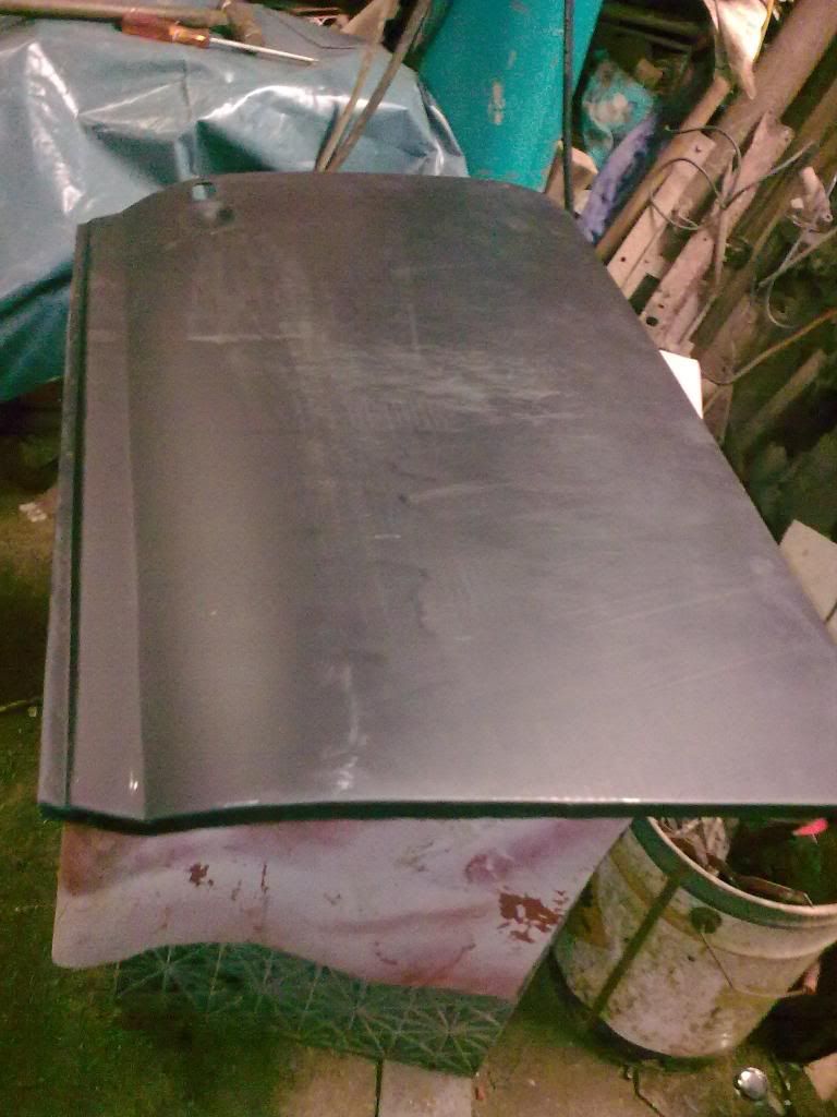

he did prep one of the doors for reskinning today tho and welded the nuts in the doors for the wingmirrors....

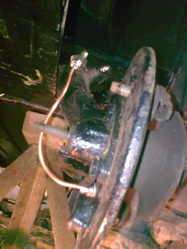

fitted the remaining front wheel bearing and all new ball joints :thumbsup:
and then pecks painted the hubs and all the other little bits on her painting table ;)

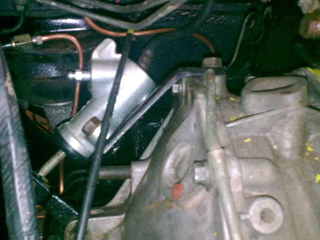

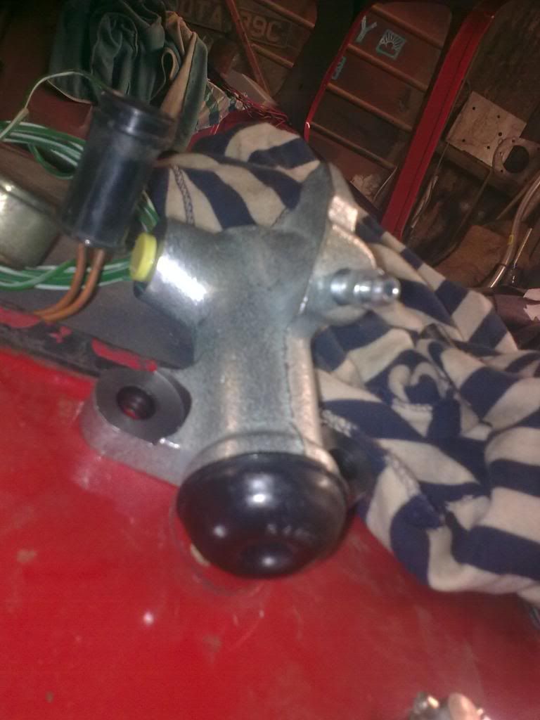

ohhhh new slave cylcinder ;) - the old one was WELL dank!!

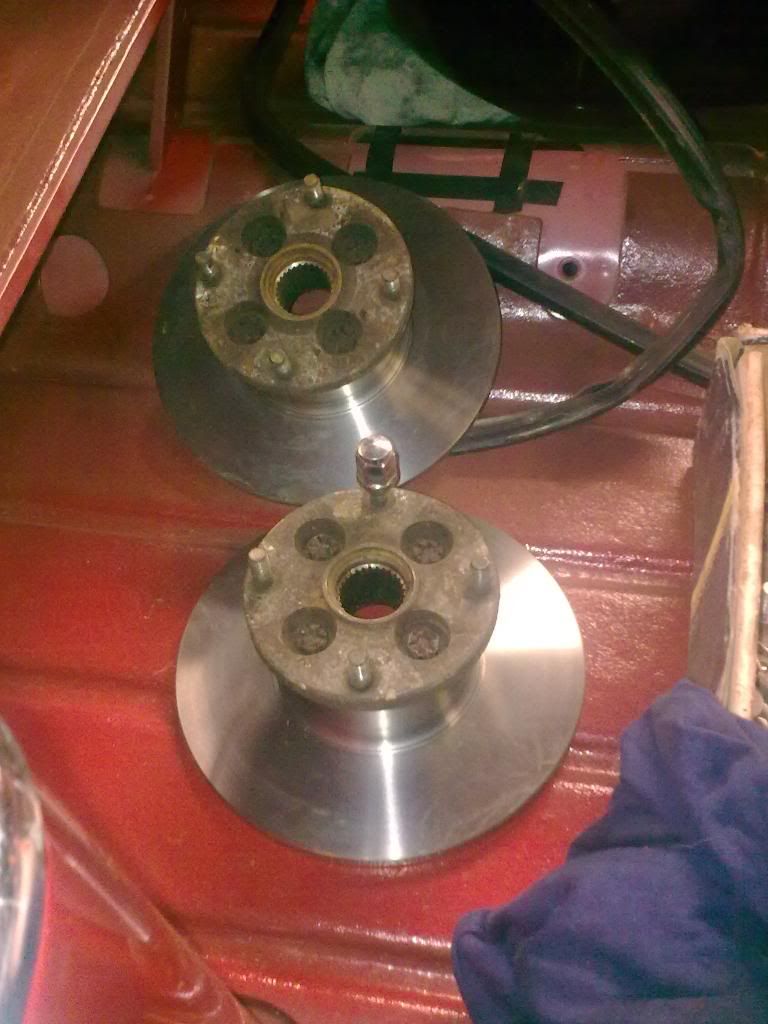

and bolted the new discs to the drive flanges
oh and welded the scuttle corner in on the other side :)

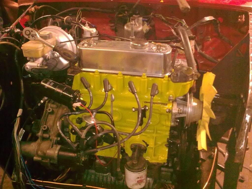

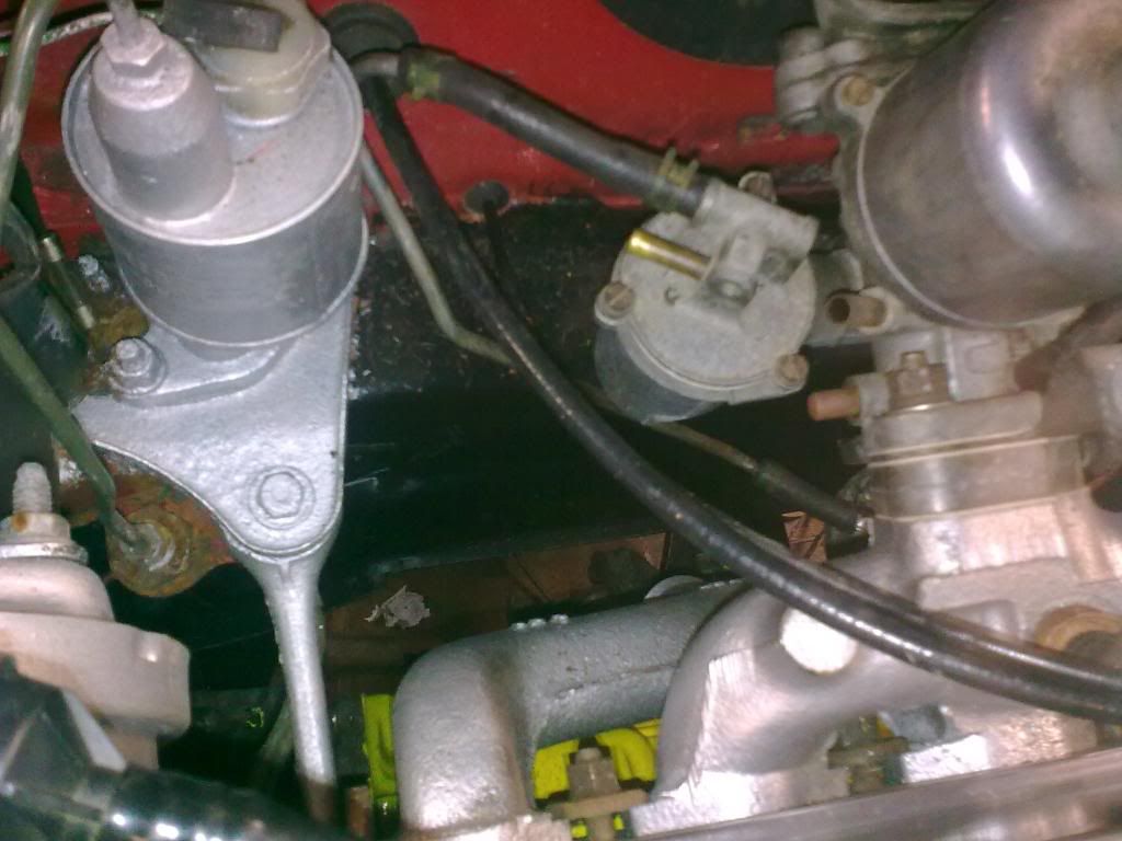

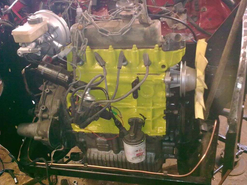

tonight i was doing a few bits and bobs on the engine new slave cyclinder
fuel pipe from Carb to pump and top and bottom engine steadys
then refited the coil(after i had to borrow it for my green mini after i have killed another coil........) and the new HT leads - the lead set was missing the lead from the coil to the dizzy cap :) - email to mini spares to sort that one out!! and fitted the new dizzy cap - and peckers fitted the starter motor

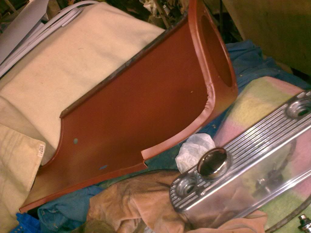

and cut the new bulkhead liner :dozing: - from a 'template' (one i made the wrong way round for my green mini!!!) - i'll post the link up from where we got the material for the postage is quite expensive - but the material is £10 per meter and will cover the bulkhead for 2 layers and the bottom dash shelf with plently to spare......
so the liner (2 layers) will go in once the heater hose clip on the heater valve decides it wants to undo - or is cut off!!! LOL

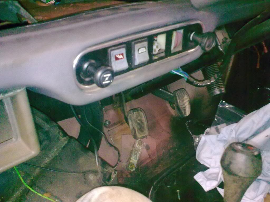

then i've been fitting the new choke cable
and the switch panel half back in
the old choke cable was a bit melted!! LOL

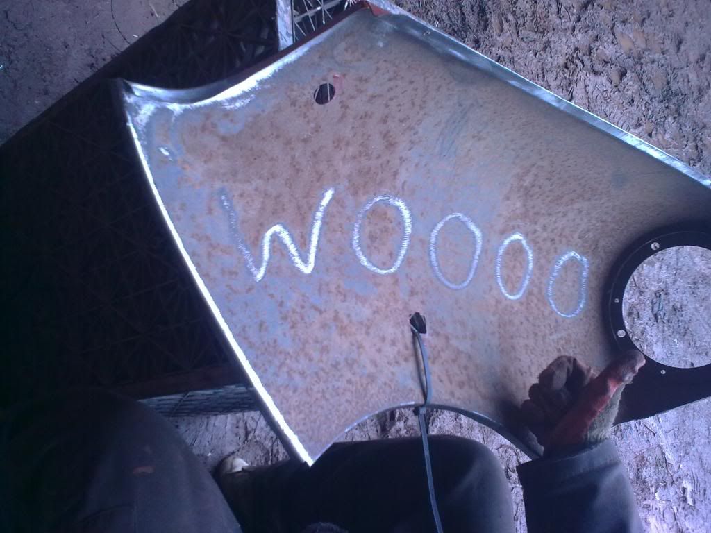

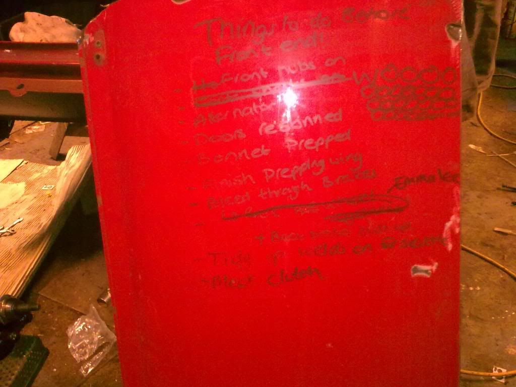

things seem to be going slowly at the mo - many because we are doing little fiddly bits which take time, but also because fonzy is tied up with my sisters car ;) - i'm REALLY hoping to get the front end on at the weekend...
so, have made a list for us to get everything done ready for the new panels:
written on the old door skin of course!!!
so to help with the door skinning - i took the hinge off the other door and welded the nuts for the wingmirrors in the new skins, as they don't come with them :wub:

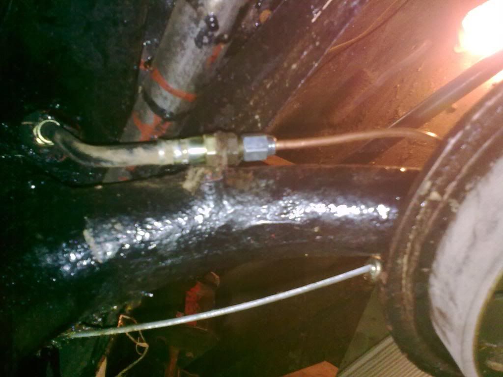

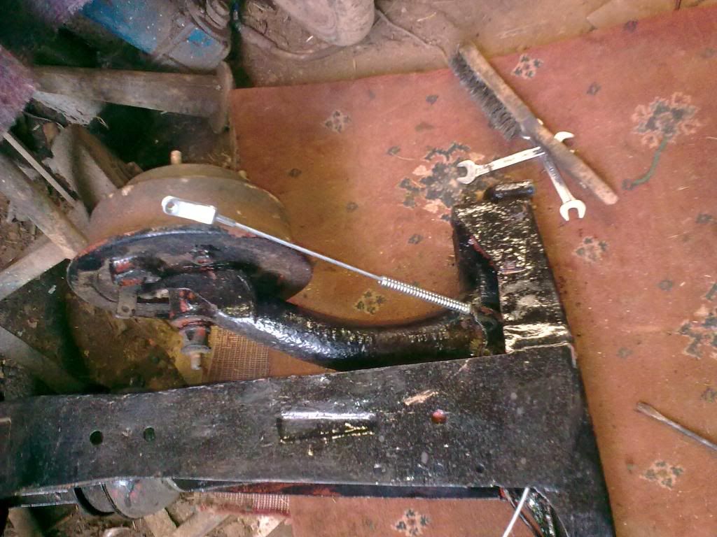

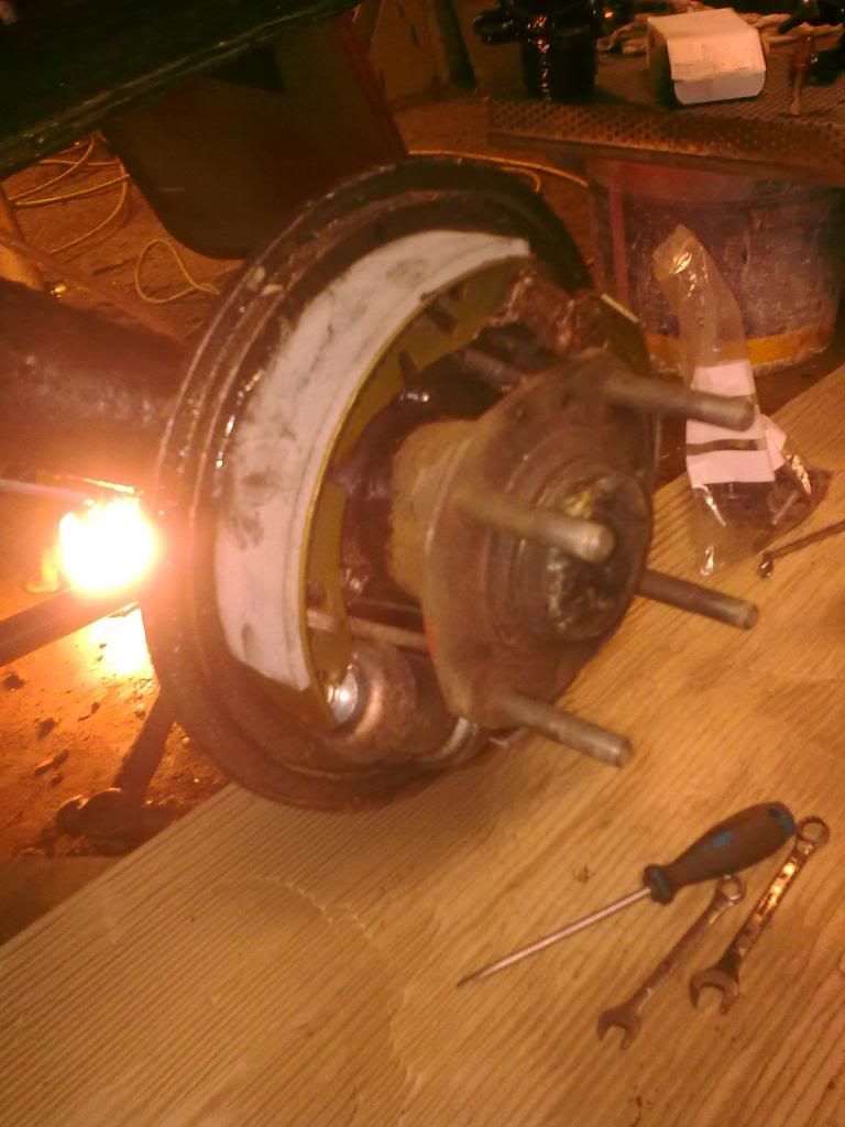

then i moved on to the back brakes and fitted the new rear wheel cyclinders, cooper fixed pipes on the radius arms, new shoes and handbrake gaitors, and put plently of cooper slip everywhere :huh:
i like the underneath of it, it looks pretty :w00t:
sooooooo glad i got them all done :huh:

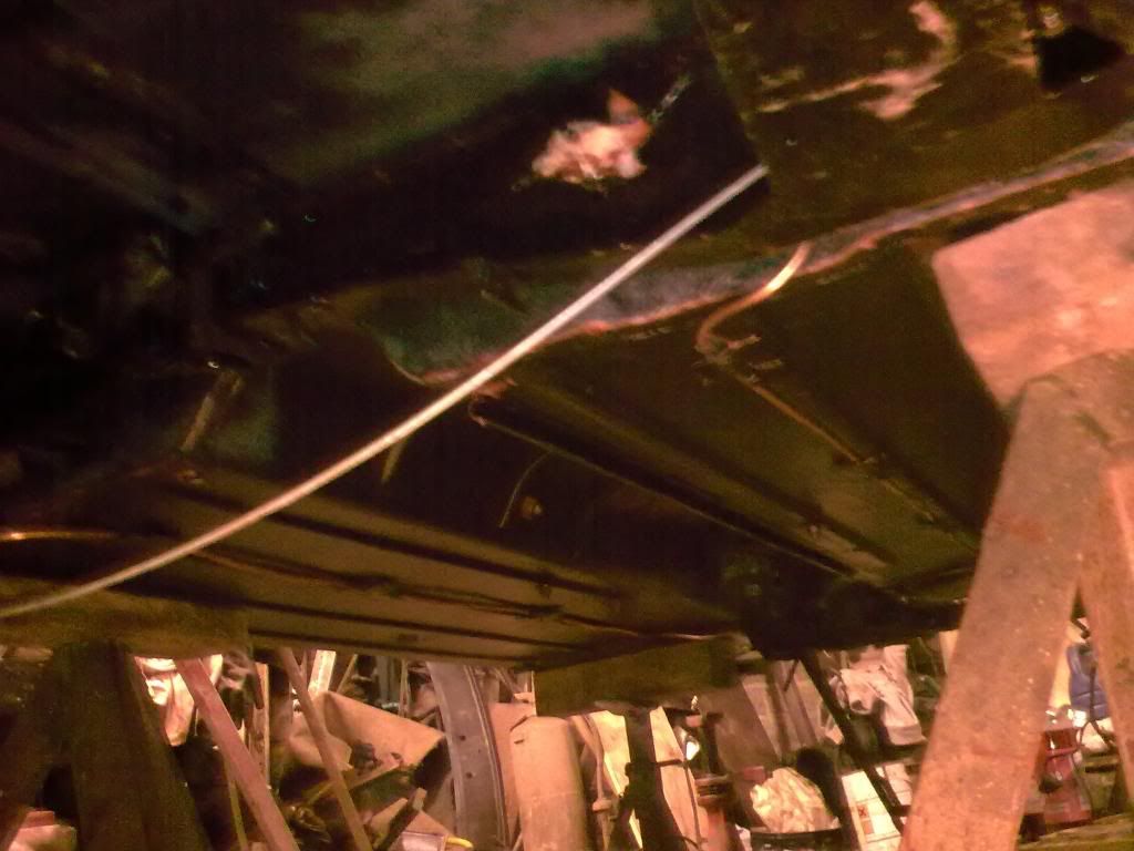

and removing the old brake pipes from the cailpers - they were well siezed on - but the hammer soon sorted that out!!!
and the list at the end of the night
couple of things crossed off - but every little helps!!! LOL - woooo did get a bit carried away tho.... LOL

Hi sorry if this is wrong but i think you have put the brake shoes on the wrong way round

Posted 25 February 2010 - 02:52 AM
is it me or y'all really like writing on your panels? lol
Top notch work mate, i like.
i'll have a look into it tonight.... it might well be - the do confuse me a bit!! LOL

Thanks for the comments guys, its amazing what we have done in such a short amount of time!!!,
and i do like writing on panels...... its always good to have a list......
