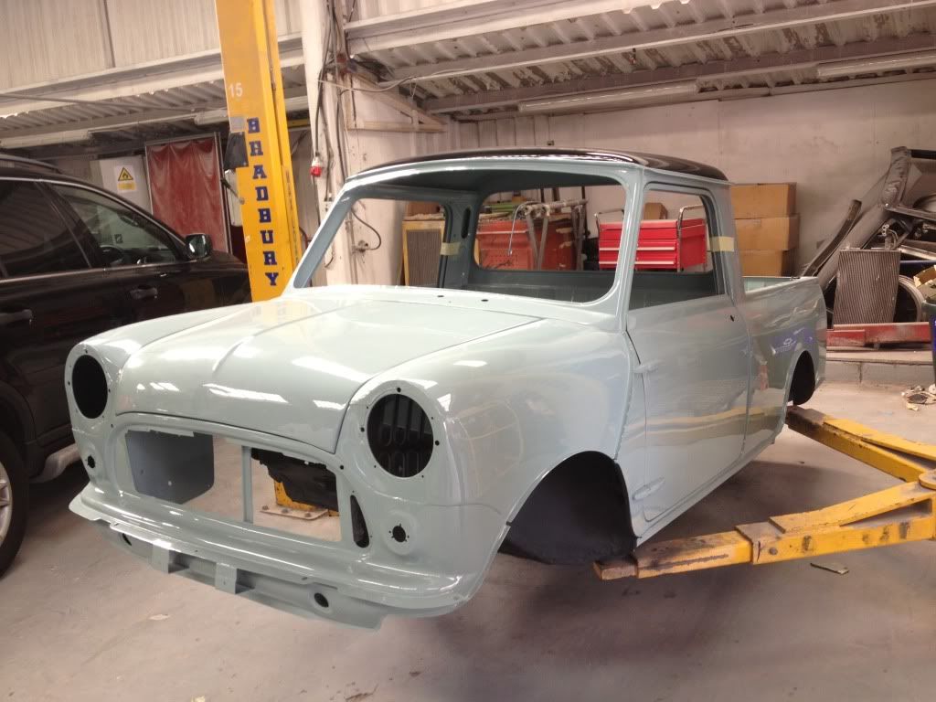

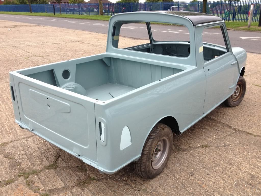

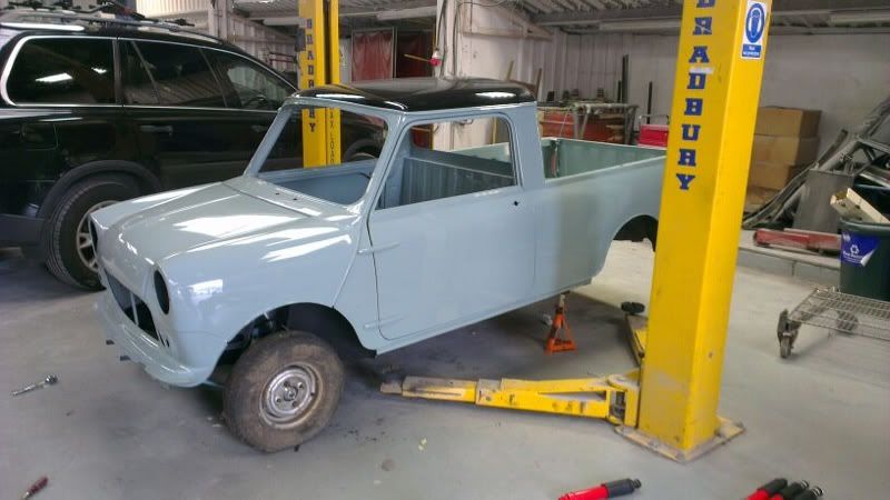

My freinds mates bodyshop, however he normally only does insurance work, engine will be being built soon :-D and then the sexiness can just continue !

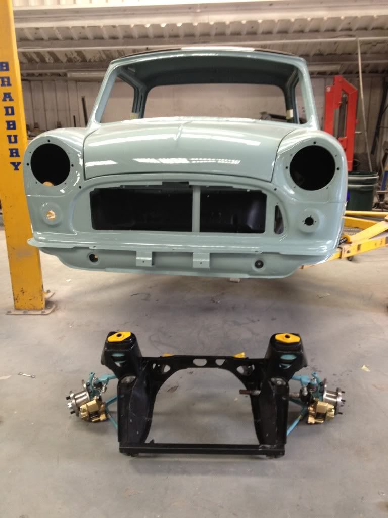

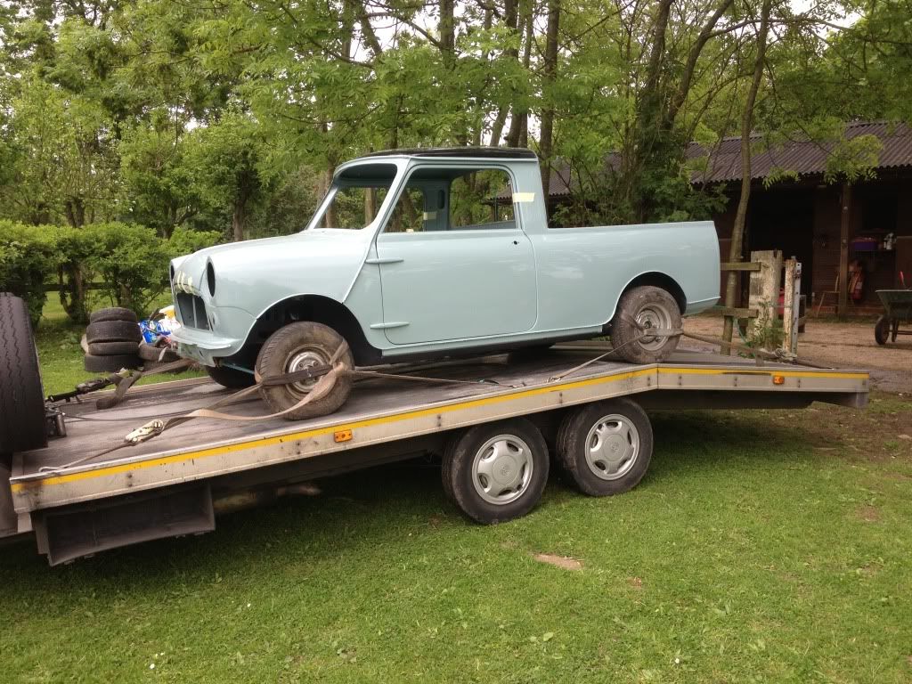

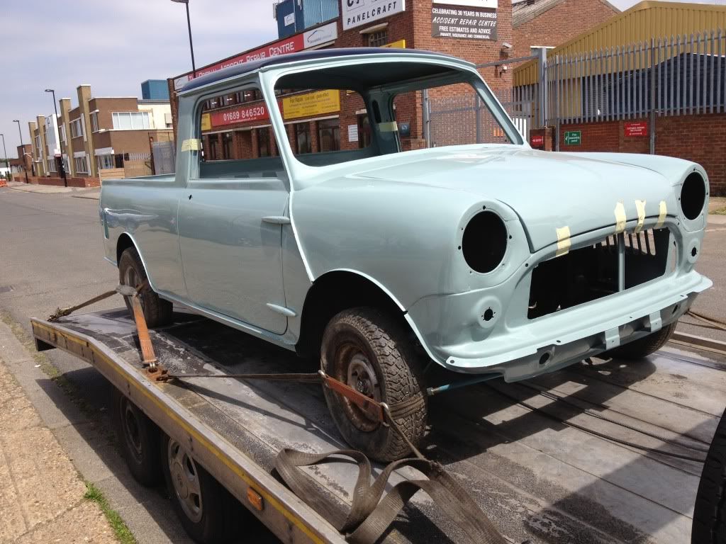

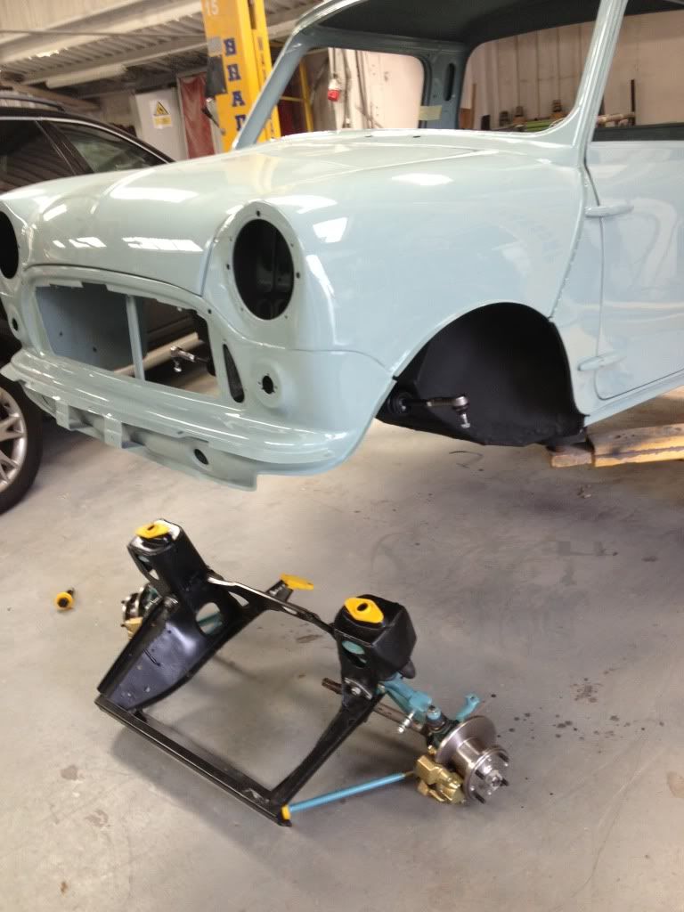

Got back from a week away with the mrs to a phone call of would u like to come pick up ure car !!! I was like HELL YEH so anyway had to get home and get things sorted, brought a couple of goodies from minispeed today,

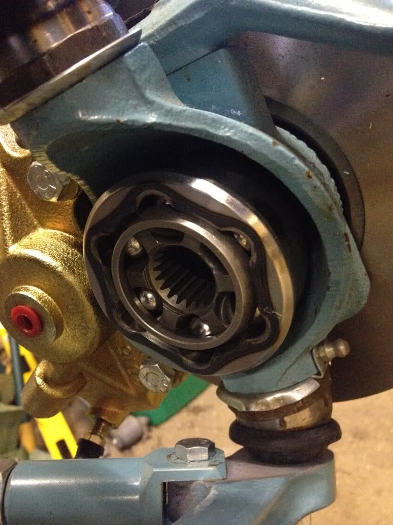

1 outer cv
Pair if genuine minifins
a cheap shock for its rubbers

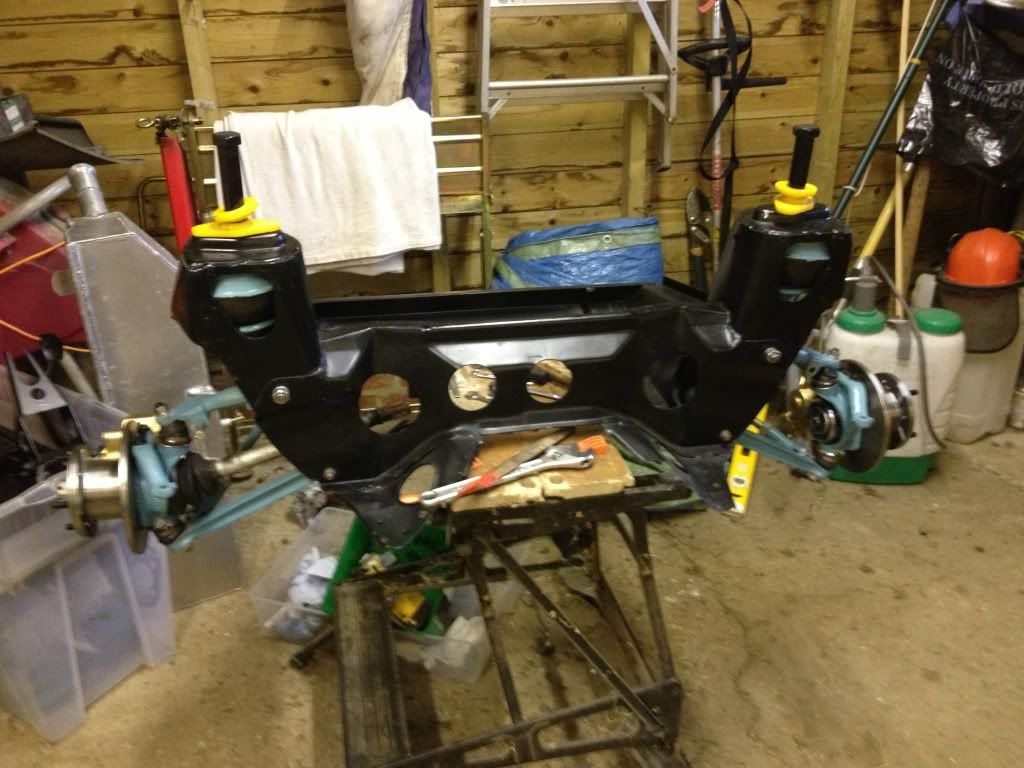

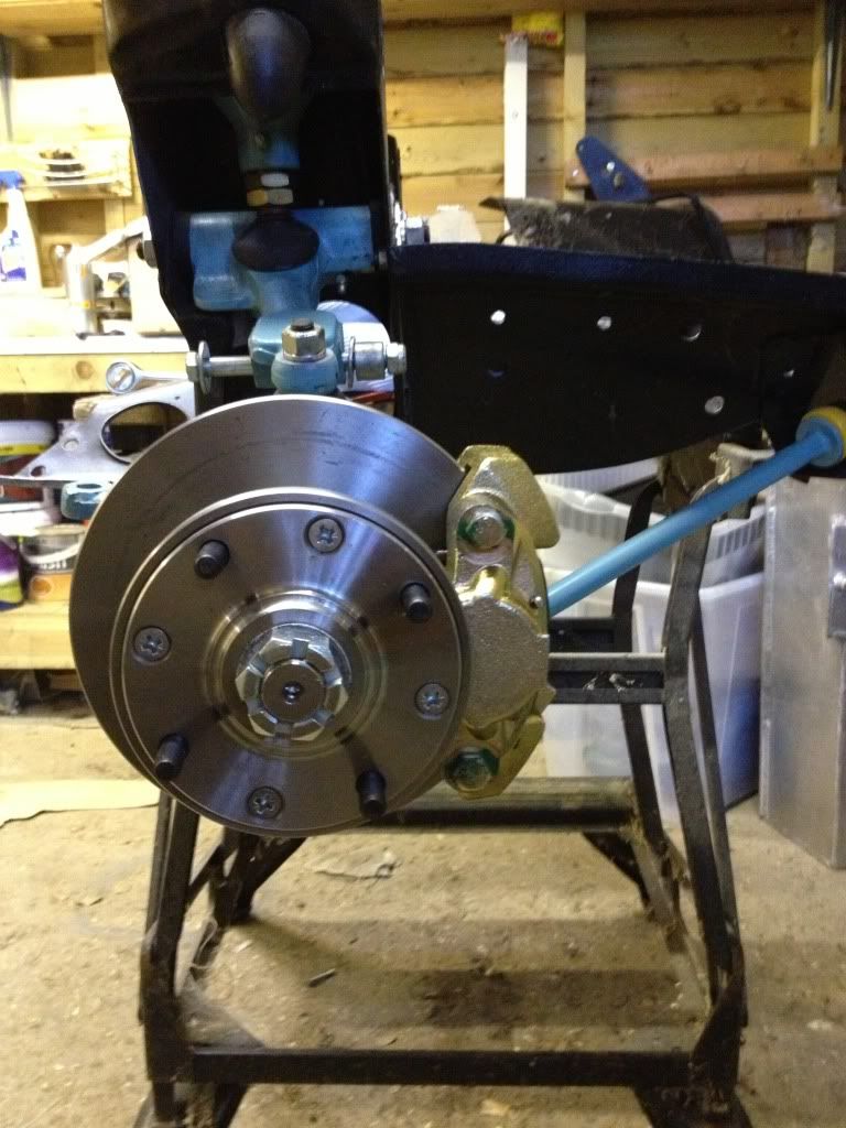

So had to get all the subframes ready to be put on in tommorows fitting:-)
Here's some photos
New cv

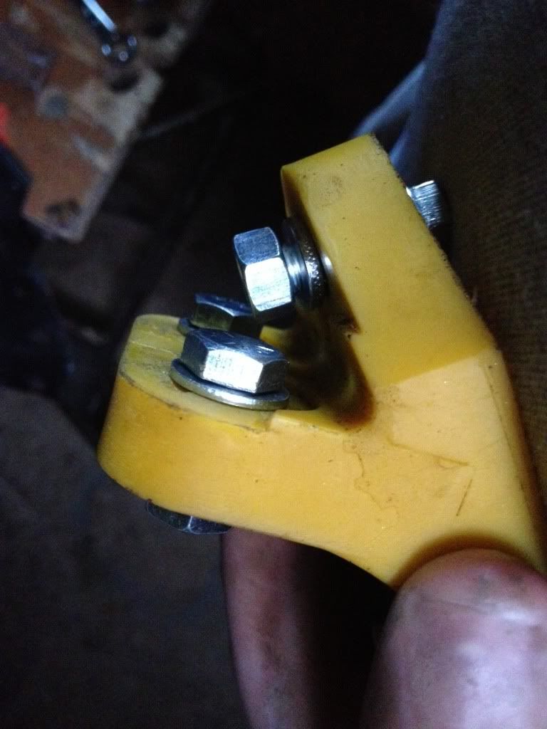

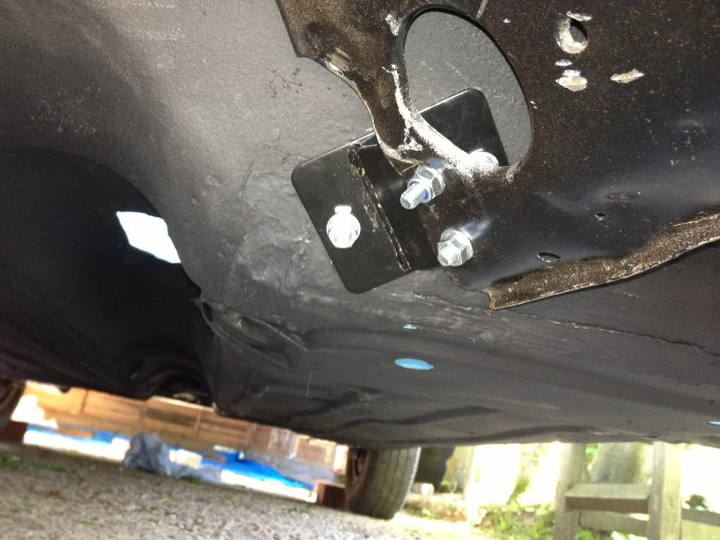

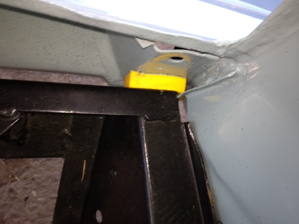

Struggling to get these on bolts seen too short but a subframe fitting kit any tips ?
New rubbers etc as old ones had perished
Nearly finished :-)
Cannot wait for tommorow :-) gunna be good
WOOOO !

Those poly subby mounts are thicker than the rubber 'n steel  originals hence the bolts been too short. I'd replace the mounts rather than the bolts. or do the lot with solid (metal) ones.

That top ball joint in the first picture doesn't look like its had its lock tab bent over.
Bin the poly mounts! The rears are a particularly bad design
http://www.minispare...|Back to search
These are what you need
Cheers guys all sorted lock tab just need a knock over and gettin the mounts today at l2b

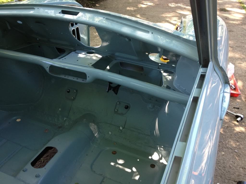

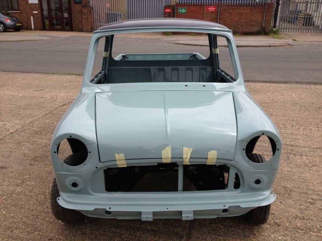

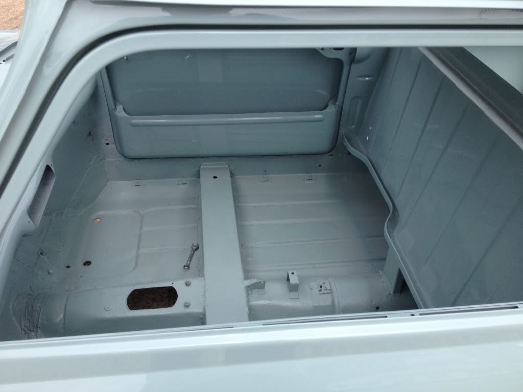

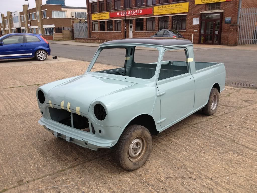

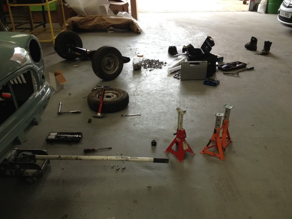

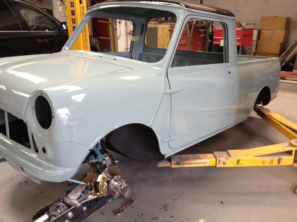

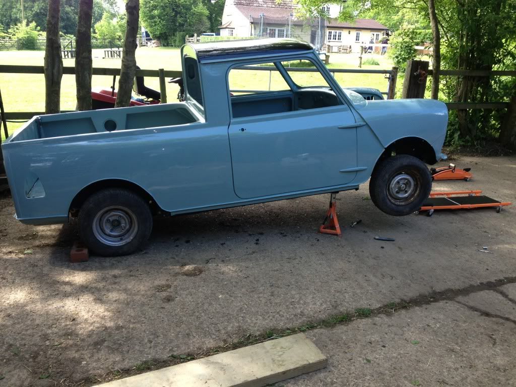

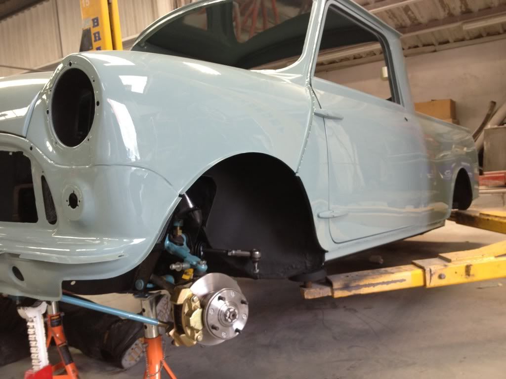

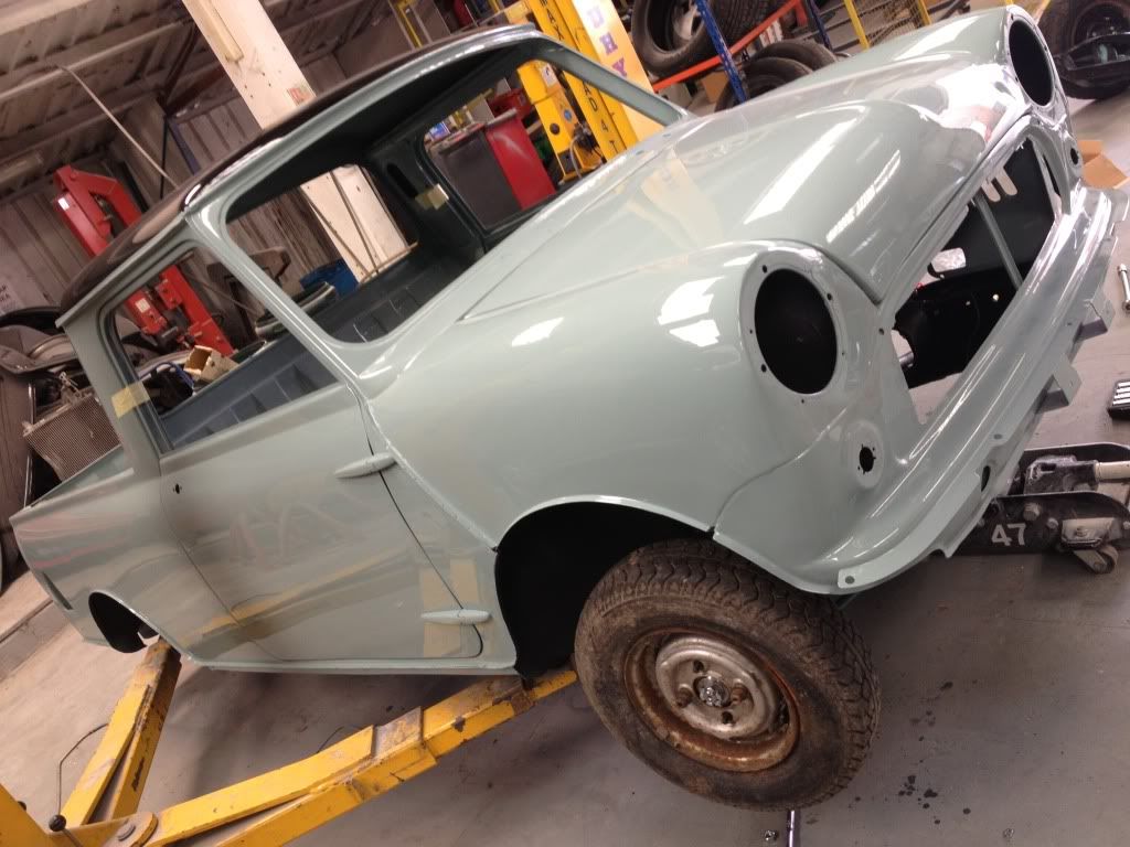

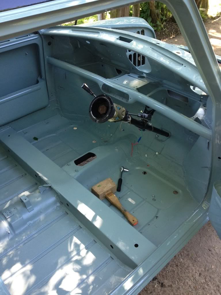

BIG update today ! It's rolling ! It's on old steelies as didn't want to ruin the rose petals but its looking the best is has in years
Ill let the pictures do the talking
Think it's screaming out for a cage now !
Tada!!! All tucked away ready for l2b for me to get all sort of goodies today :-)

got my solid front subframe mounts so then I can get rid of the polys!

First day back from my training course it was sunny today so it would be rude not to ......
Solid rear subframe mounts in and done !
Steering wheel bracket in

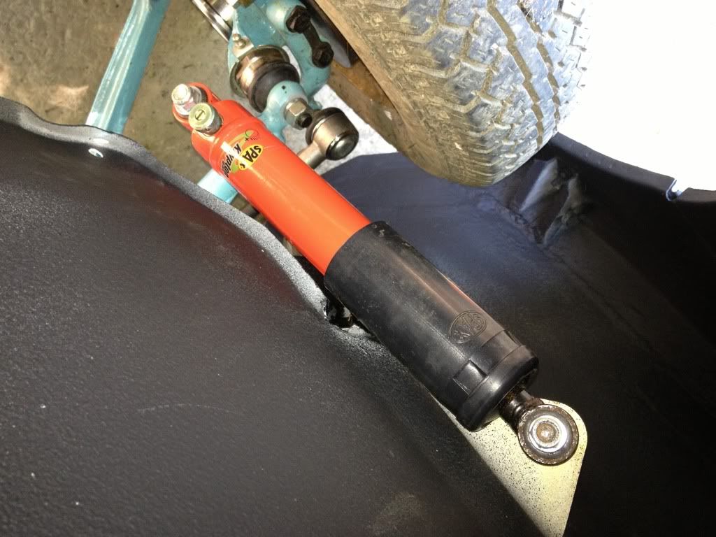

Adjustable spax dampers on

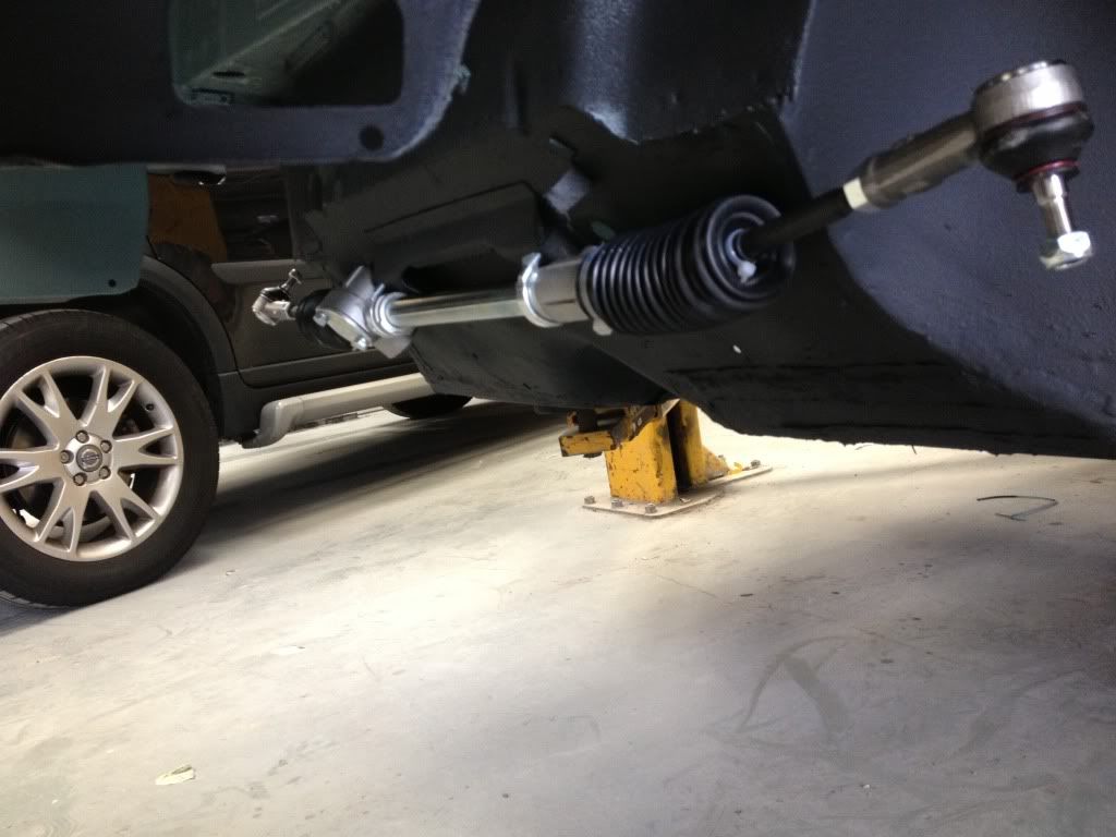

Front bushes modified
Steering colum + drop bracket

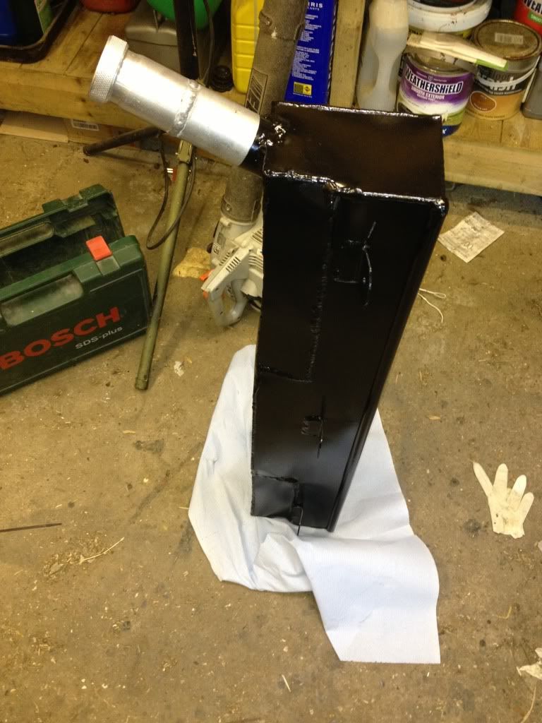

Full ally fuel tank made up and painted ready to be fitted just needs a new sender :genius:

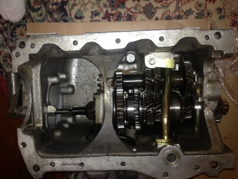

Gearbox back from guessworks !!!!

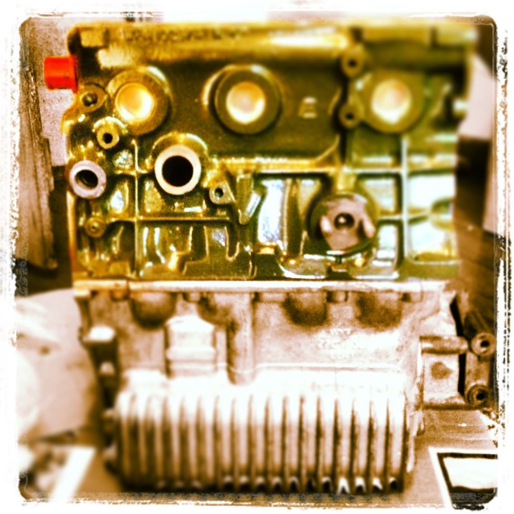

And on the mini se7en block :-) just to see what it looks like
Engine being built next couple of weeks so its all coming together :genius:

How come you have made a tank and not used an original is it cost ? And what shade of blue is that love it can't wait to see it finished makes me want to get my pickup finished haha

The colour is Smoke Grey (BU15), The reason for the ally tank is firstly weight secondly it was made by my friend who died before he could finish the car so thought I would use it, so In theory a free aluminum tank for nothing......
