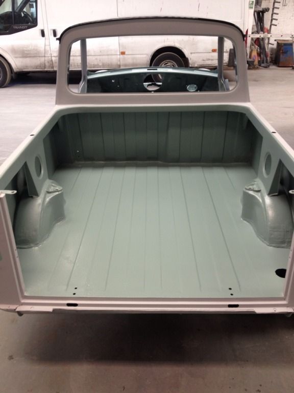

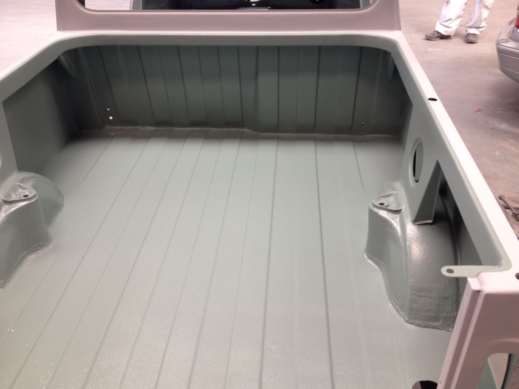

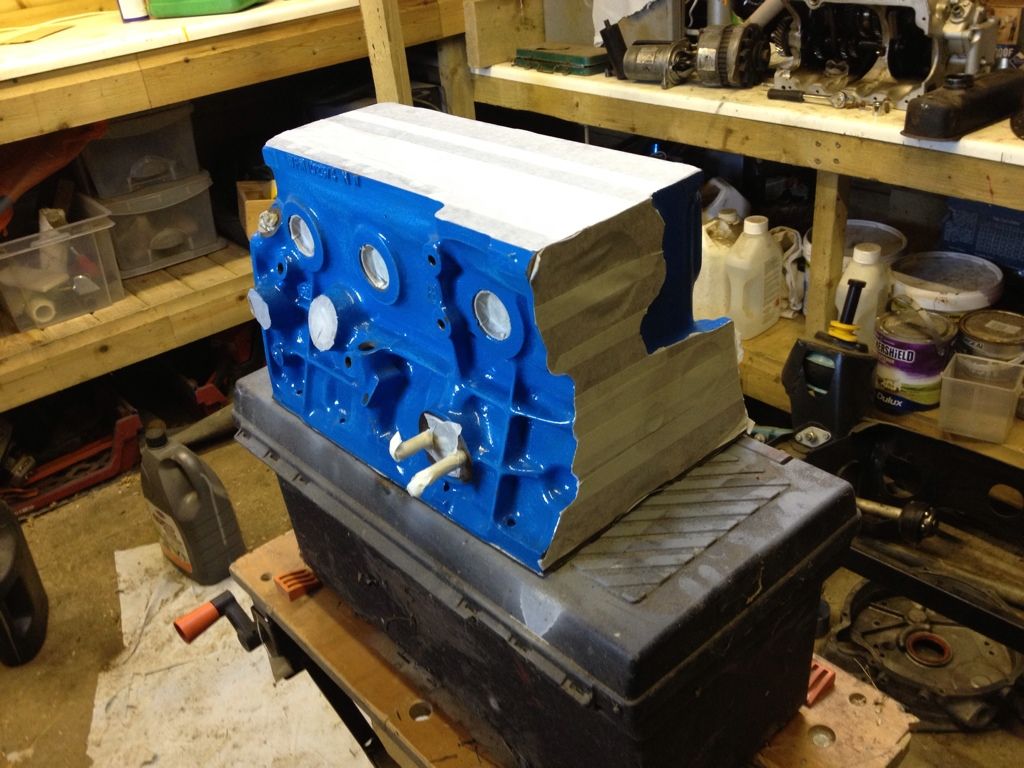

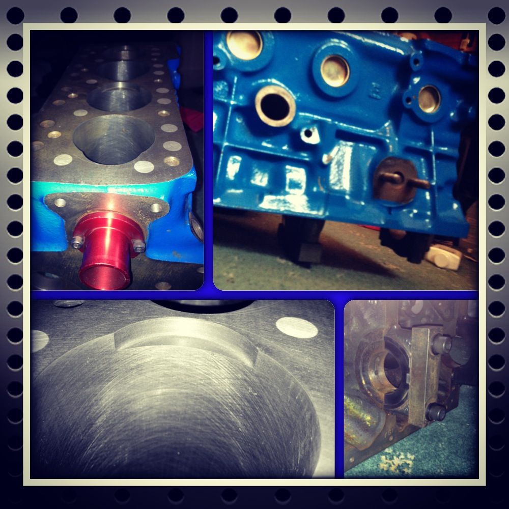

Right so an update,

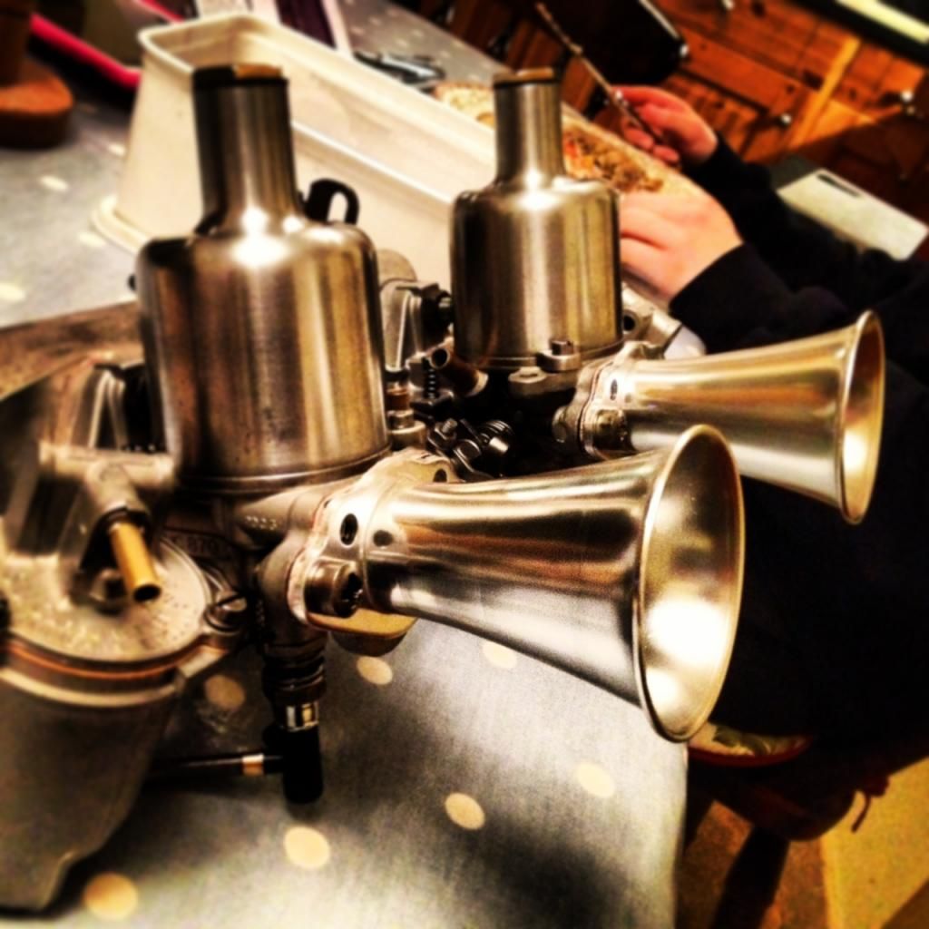

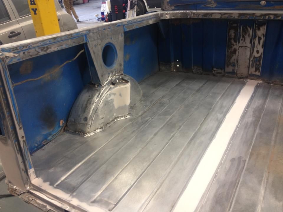

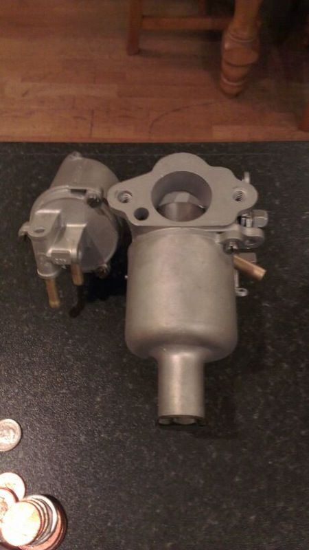

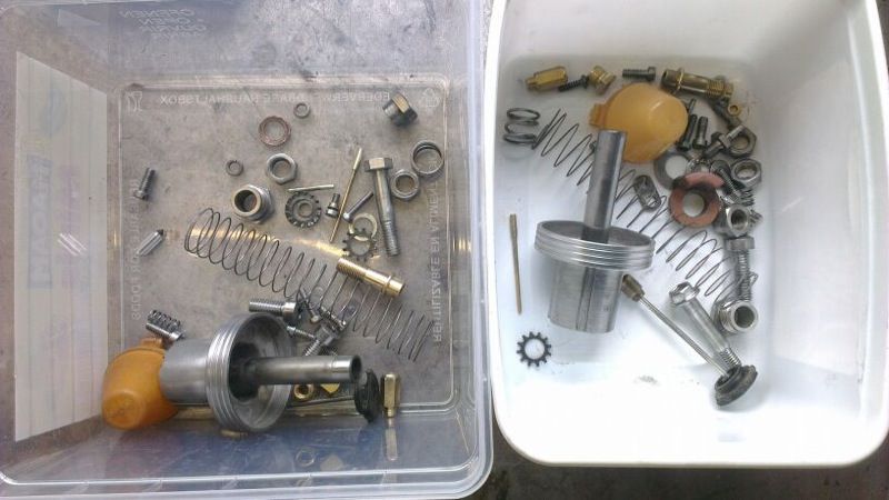

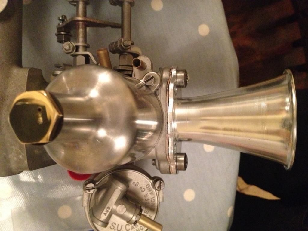

Block back from machining, valve pockets, bored, honed, Dry Decked, Waterways capped off, Skimmed, Posted Image

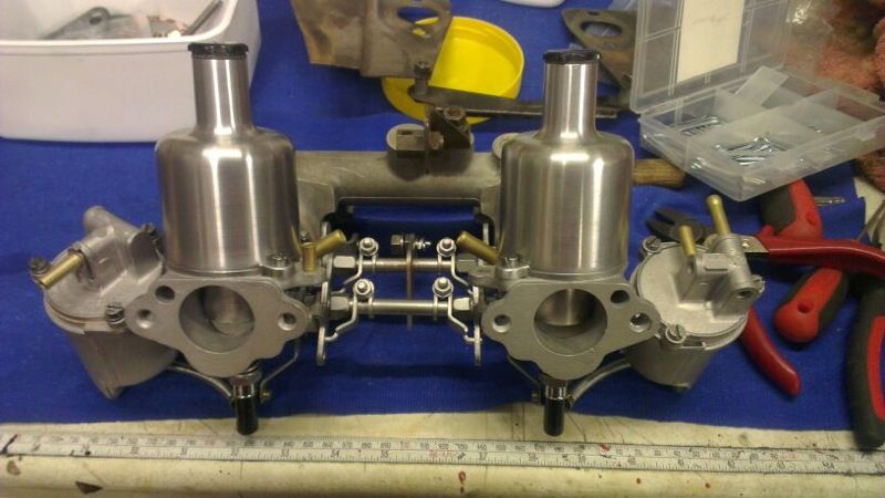

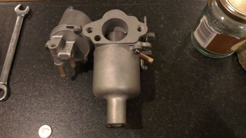

rebuilding the HS2'sPosted Image
just after bead blasting
Brass Tops Added
New Load bed :D

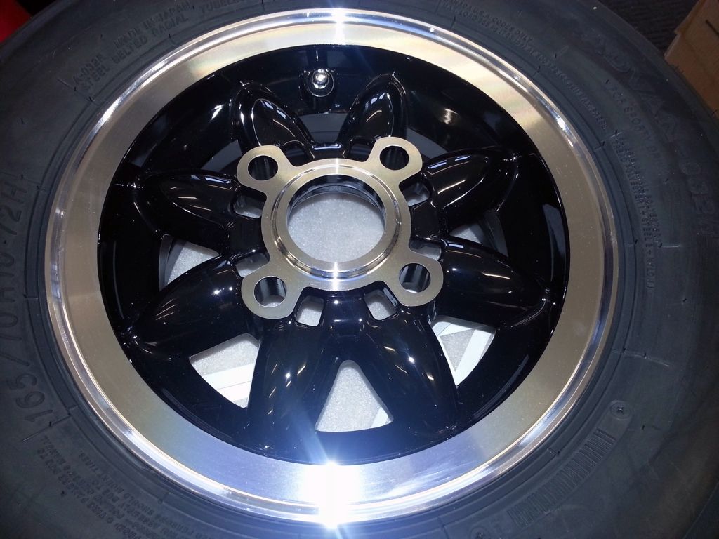

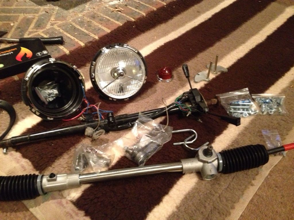

Went to brooklands yesterday saw some truly awesome cars and picked up this lot ! So now when the car comes back it can be rolling and Steerable !!!!

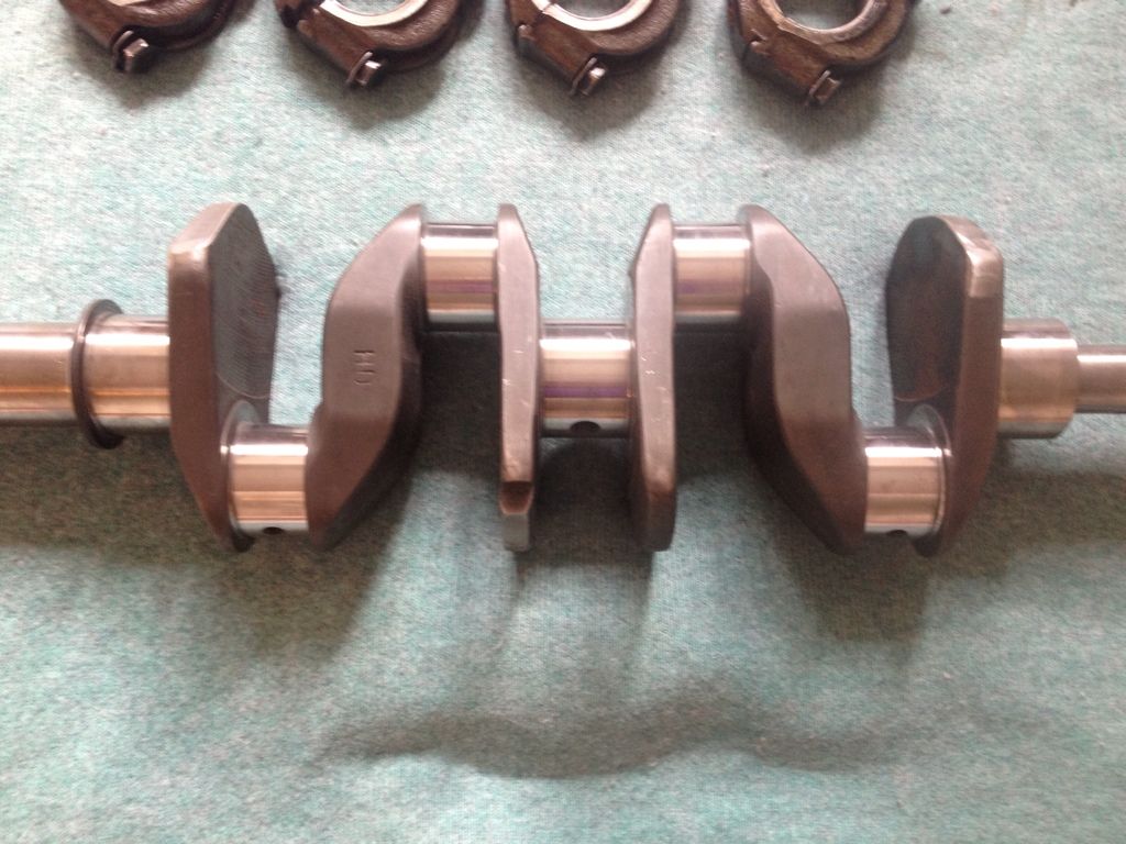

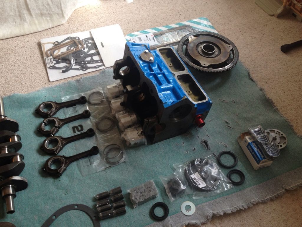

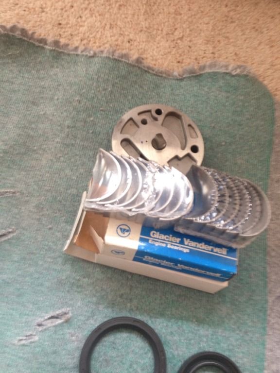

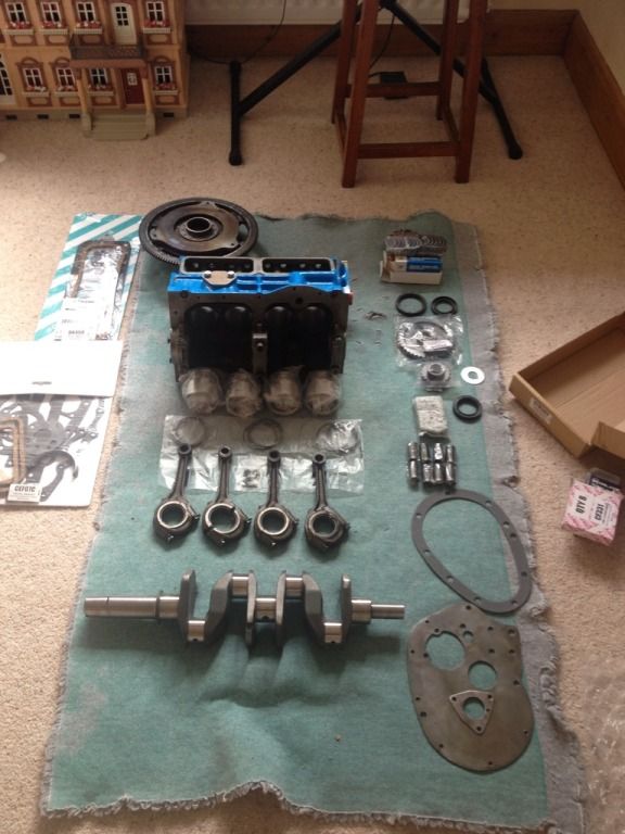

All coming together !!! little more of an update engine has landed, just waiting on the head to be dry decked and the gearbox to be refurbed by Guessworks, just a few more shots whilst its all being done :D Engine bits!!
The Finalised Spec for the Engine as i now have brought it is follow's 998
Head
12G940 Cast
Inlet 35.7
Exhaust 31
Fully ported and flowed
Bronze valve guides
Eibach Double valve springs
Concept valves
19cc combustion chambers !
Fueling
facet fast road electric fuel pump
Twin HS2 Carbs
Engine Block
Surfaced, Pocketed, Chemically Cleaned,
+020 Powertune Pistons
A+ Crank Balanced/Polished/Wedged &Cross Drilled
A+ Rods Lightened /Balanced
270 Piper Cam - Same duration as the 276 but more lift
High Flow Oil Pump,
Oil Cooler,
3.7KG flywheel and Backplate assembly+( from my mates Mini Se7en),
race clutch,
Vandervell bearings,
duplex timing chain,
centre main strap,

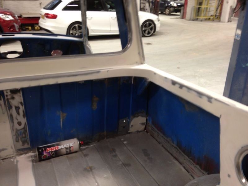

Right so the pickup is in primer ! And the 7.5 discs have all turned up so will get them on the subframe and built up ASAP! All I need now is the bloody shell and I'm good to go ! Dashboard has been ordered and should be with me middle of next week :-) exciting stuff

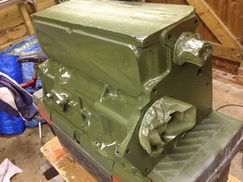

Posted 03 May 2013 - 07:42 AM

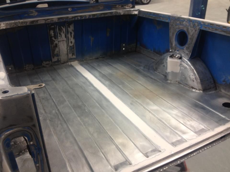

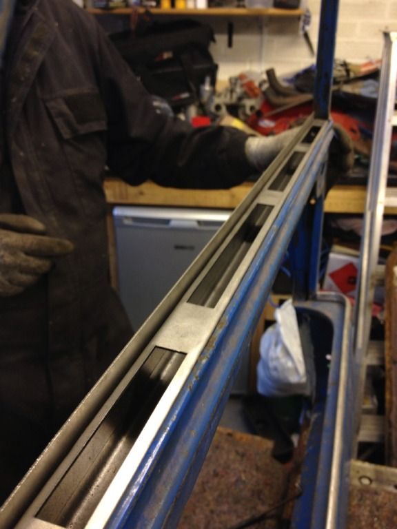

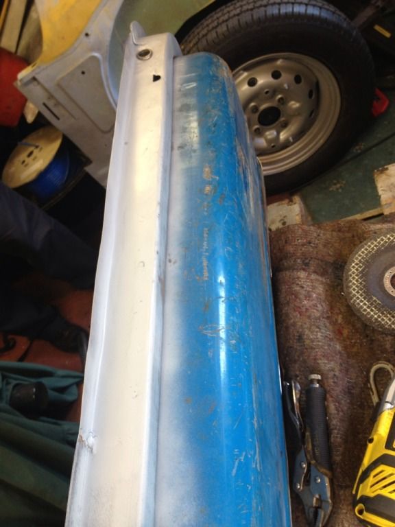

So after redo'in my doors as they were fairly similar to the job of a sieve
I replaced and repaired the bottom section of the door and the window runner for the car
C8AD93EE-F00A-4ED5-9CBA-DD64CF899711-510
FE109B55-B63E-4F17-BE9C-73CE6D0D54A5-510
Someone remind me not to arm my uncle with a new angle grinding disc and free reign on a door
E9BB0F8A-DAAA-444A-A56E-699339066C7A-510
The gear box is soon to be sent to guessworks
To then be mounted to my newly painted block !
D9F52396-B92D-4CBC-AE87-34320F6A1634-582
Bye bye boy racer blue
369AD6B8-15F6-4D26-BF92-7EEDB10FCE67-582
Hello sophisticated class in :-)

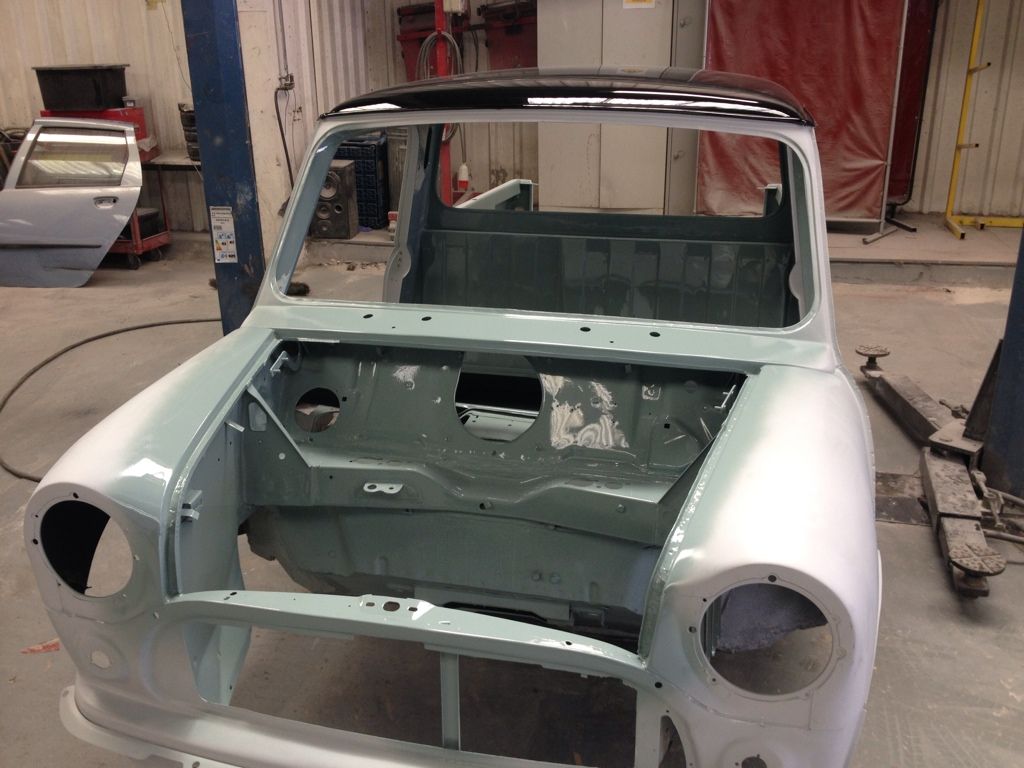

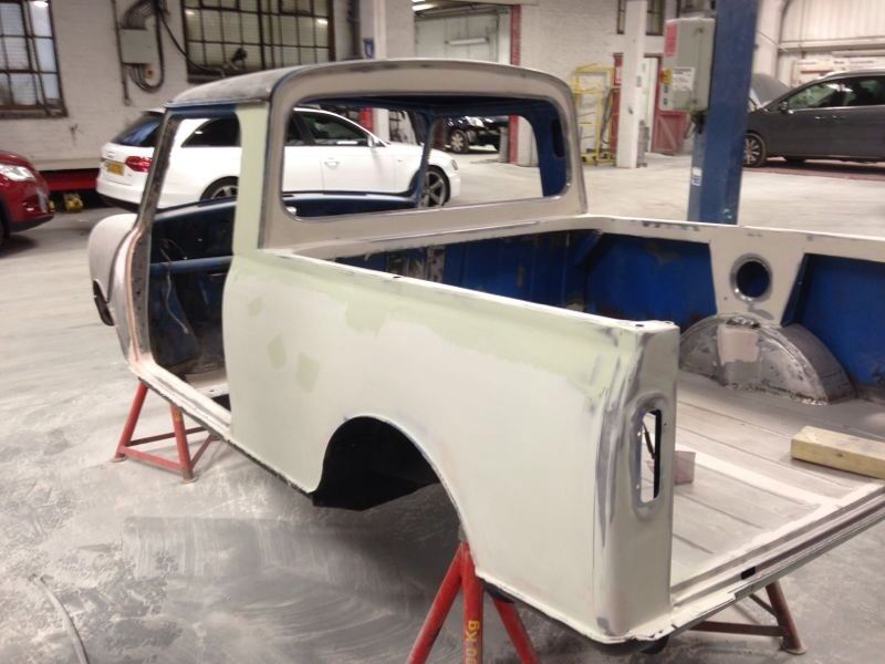

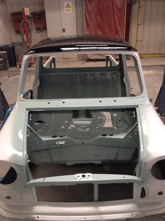

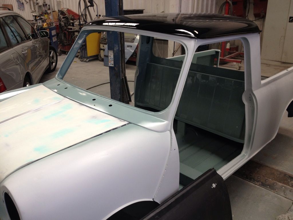

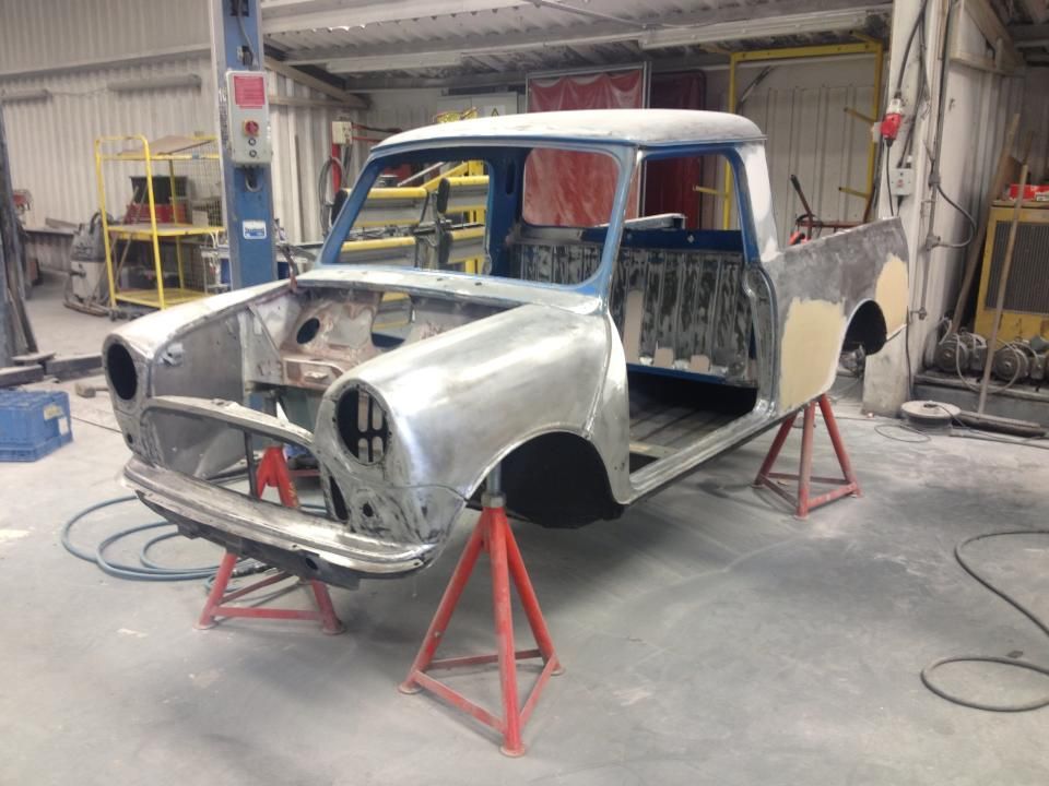

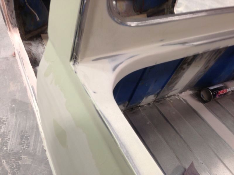

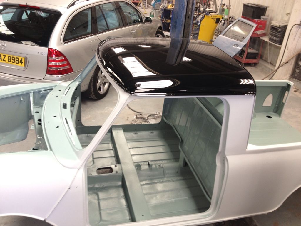

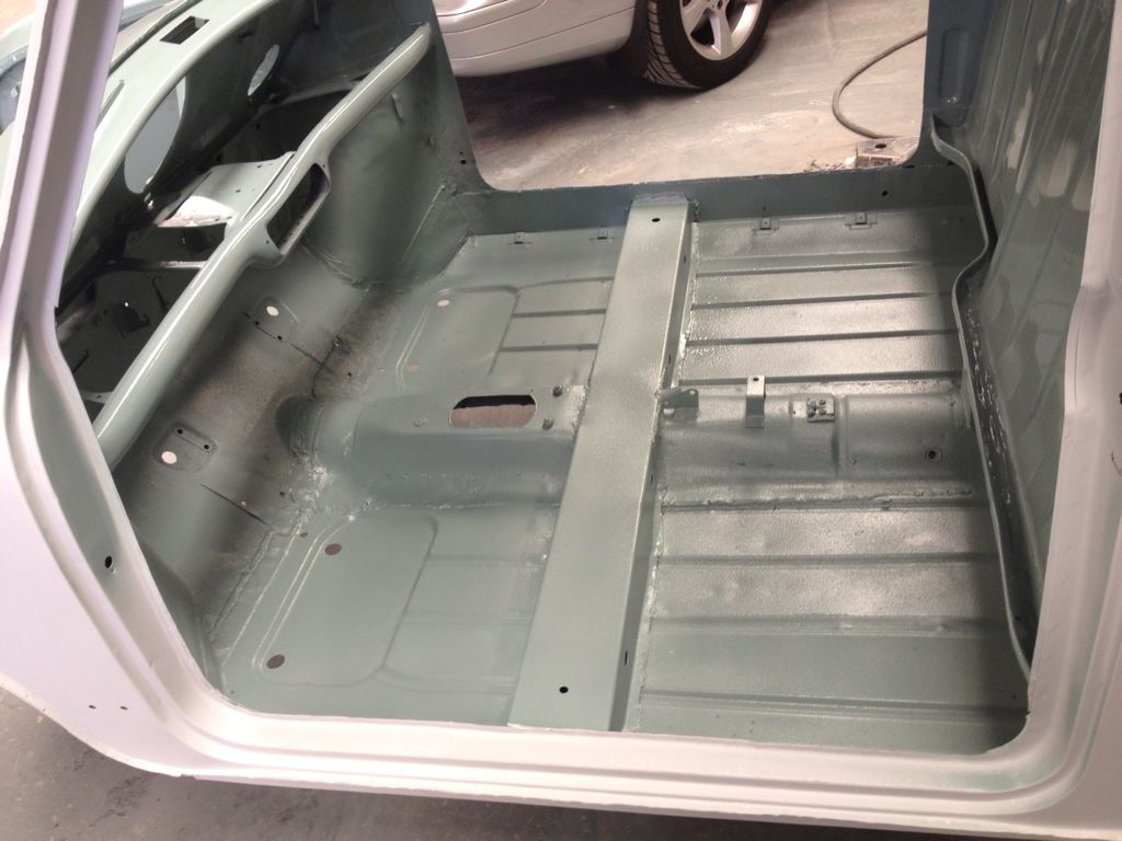

Went to visit the mini at the body-shop yesterday and its looking mighty fine!!!!! Finishing off te other door so that way they can paint the whole thing
51201E95-8334-451E-A62B-D6ED3B210A83-527
A3A220F4-65A1-428C-B239-7B519F142082-527
2698023C-1A6F-4AD5-AEB0-2321C2178549-527
E7AF6069-250E-49A6-87F2-8D8A04B7BAFE-527
E7920D41-9247-4123-BD02-64DC2D2D1738-527
D6E50ECD-A694-450D-A786-3A8A94E4CD93-527
D7BA085F-1D23-454E-813D-4AE9AC92ADF8-510
