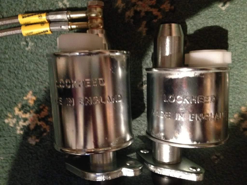

Also got these the other day so more bits for the collection, getting the bits so I can run the fuel lines and brake lines all at once too

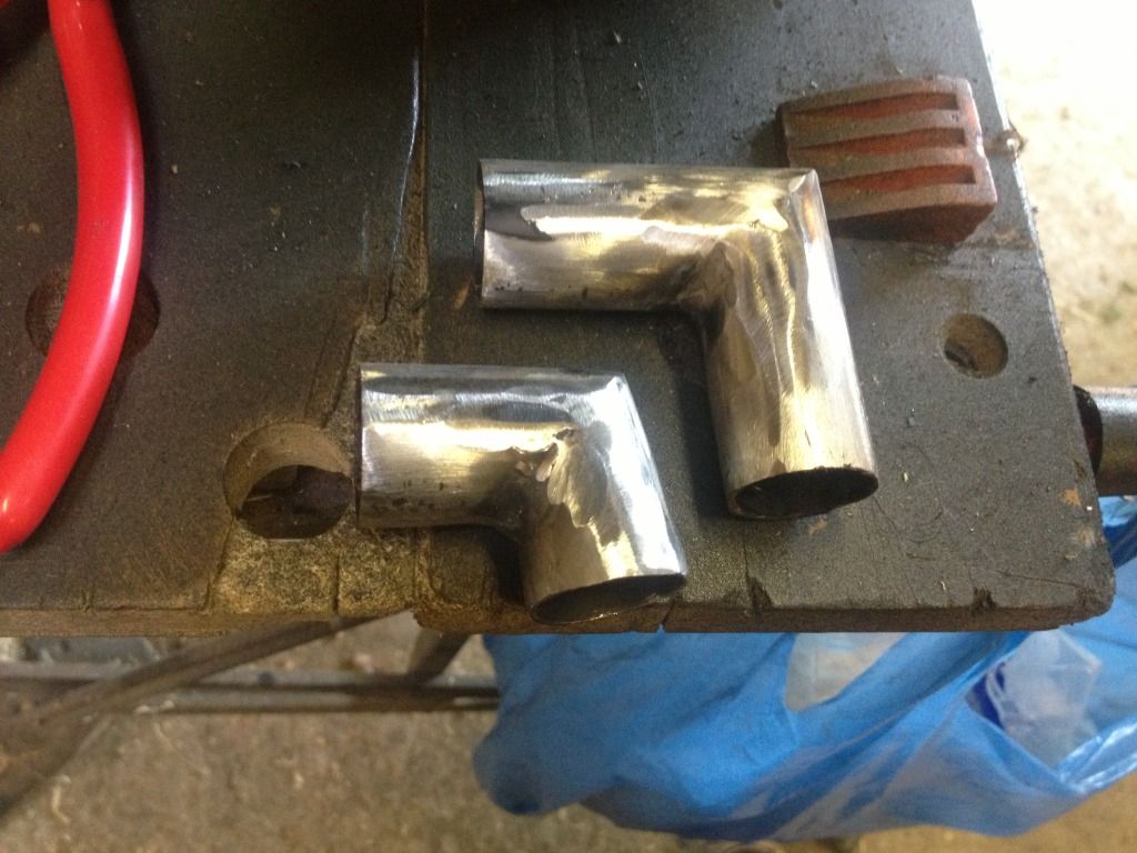

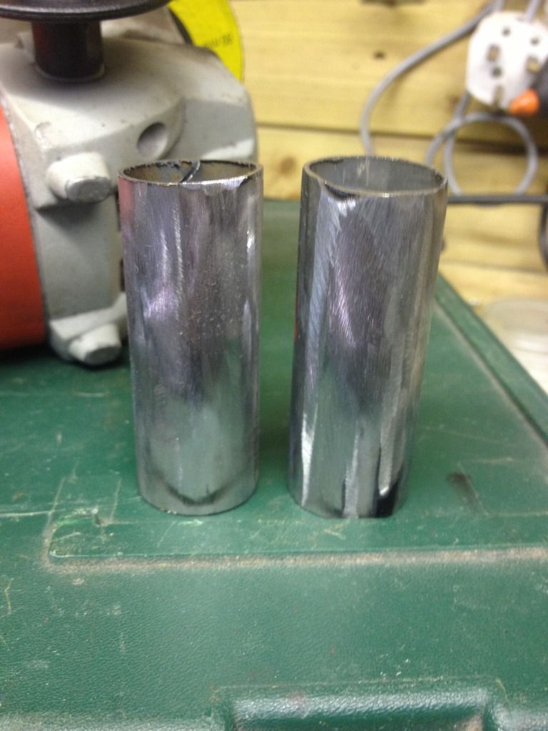

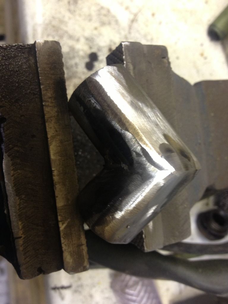

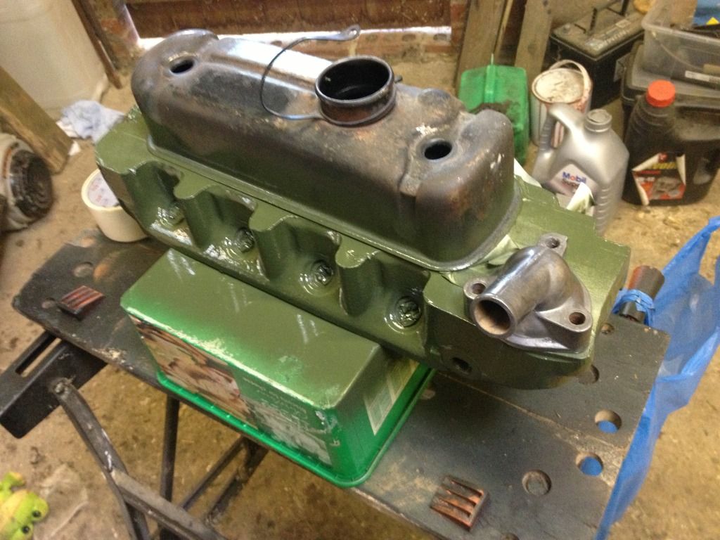

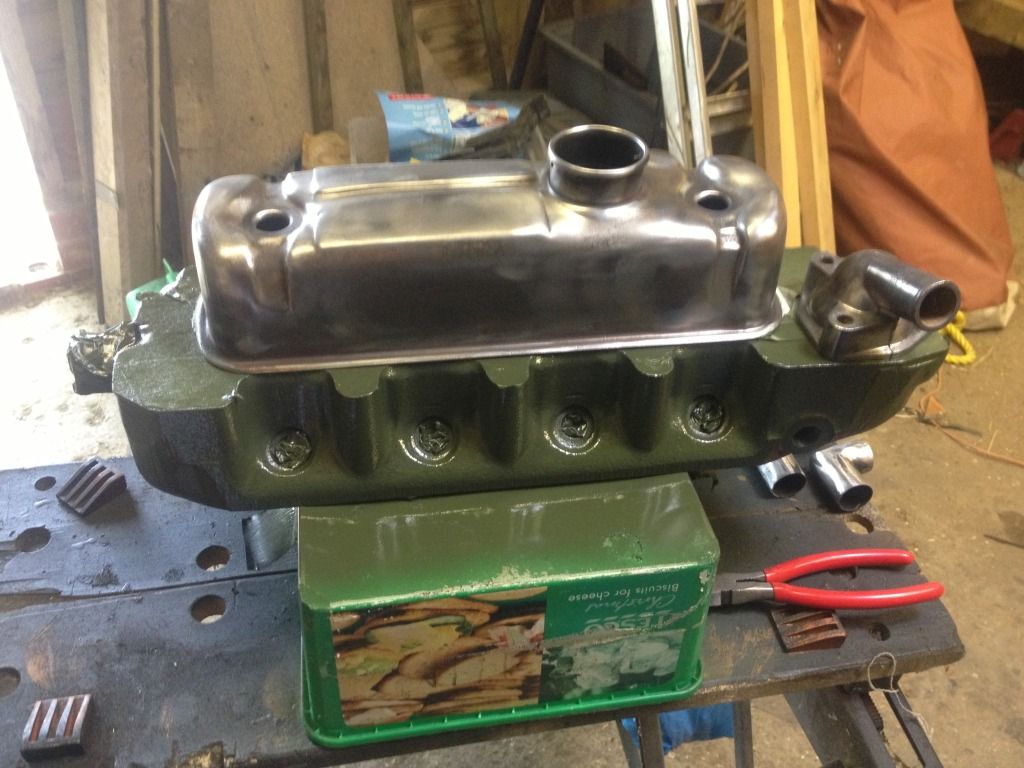

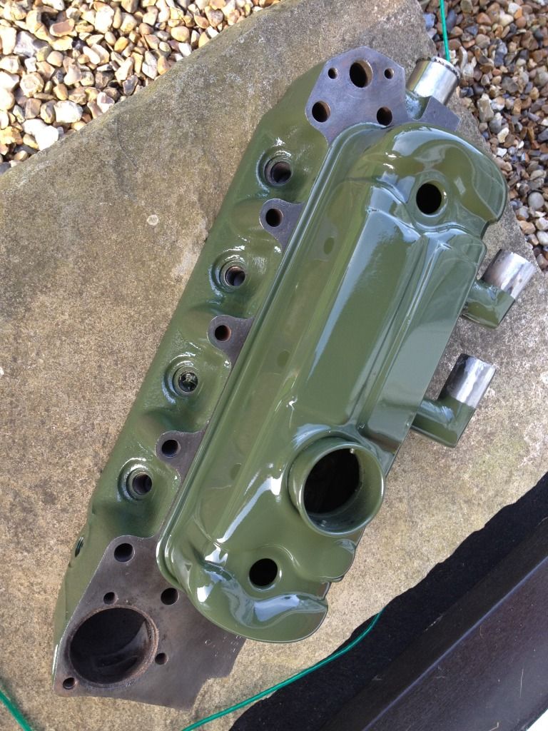

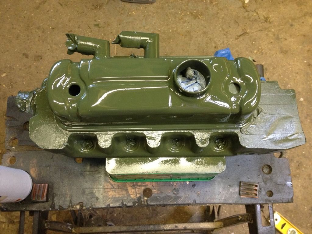

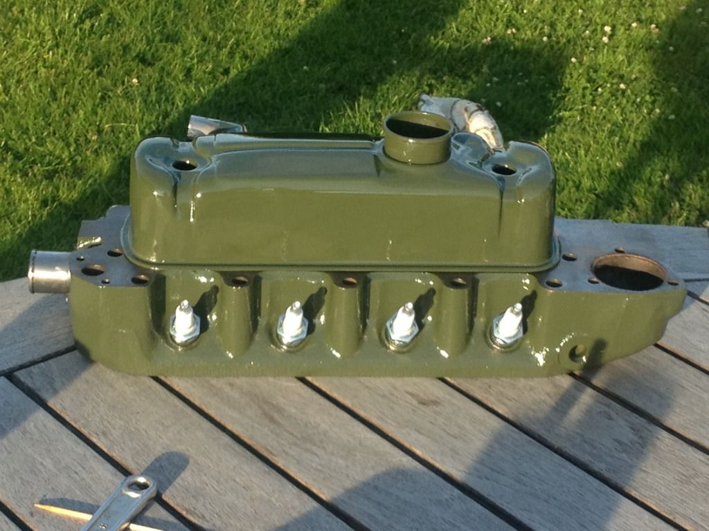

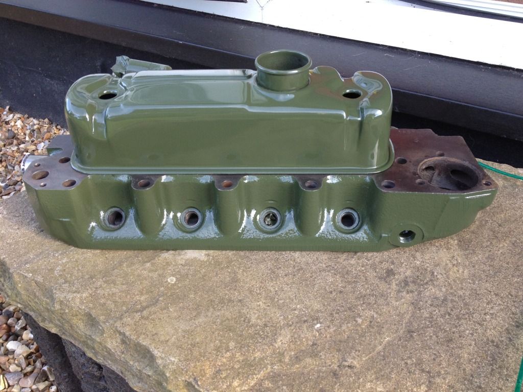

Whilst I ponder about what to do with the subframe mount today a cracked on and did some light mods and ment I got to play with my welder !
So my mods for the day was to create a modified rocker cover to allow for my crank case breather and also for my under wing catch tank
So I started with these so i could then modify then in to the parts required first things first make them right angles so they could then be welded onto the rocker cover
Catch tank junction
Both breather and catch tank junctions made on is smaller as they need to be able to clear each other with the pipe going across
Then cleaned up the rocker cover
Drilled the hole, which is 25mm but only had a 10mm bit so had to get the file out for an hour! Lol
All welded in and painted

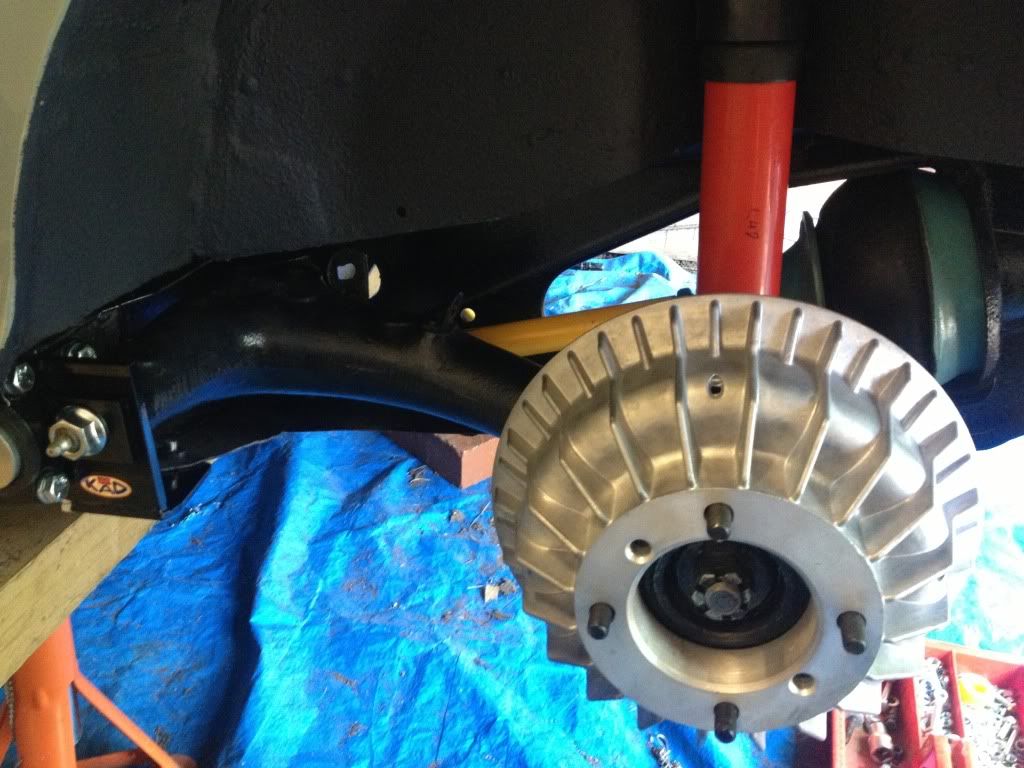

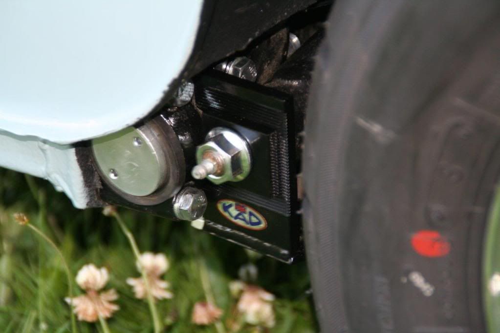

Didn't get to engine build this weekend, bit gutting so cracked on with the rear suspension, fitting fuel tank, master cylinders, steering coloum,
Firstly the rear suspension I had a bit of a problem the bold that go through the trunnion into the sill one of the internal captive nuts decided to give up so had to repair using helicoil kit very (very easy and strong)

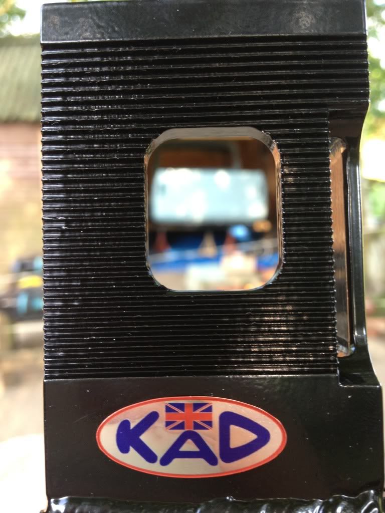

So got all my new bit together and finally the rear suspension fully fitted went to by some adjustable camber arms from Minispeed and Scott very cleverly showed me the KAD ones so they were double the price but O so nice !

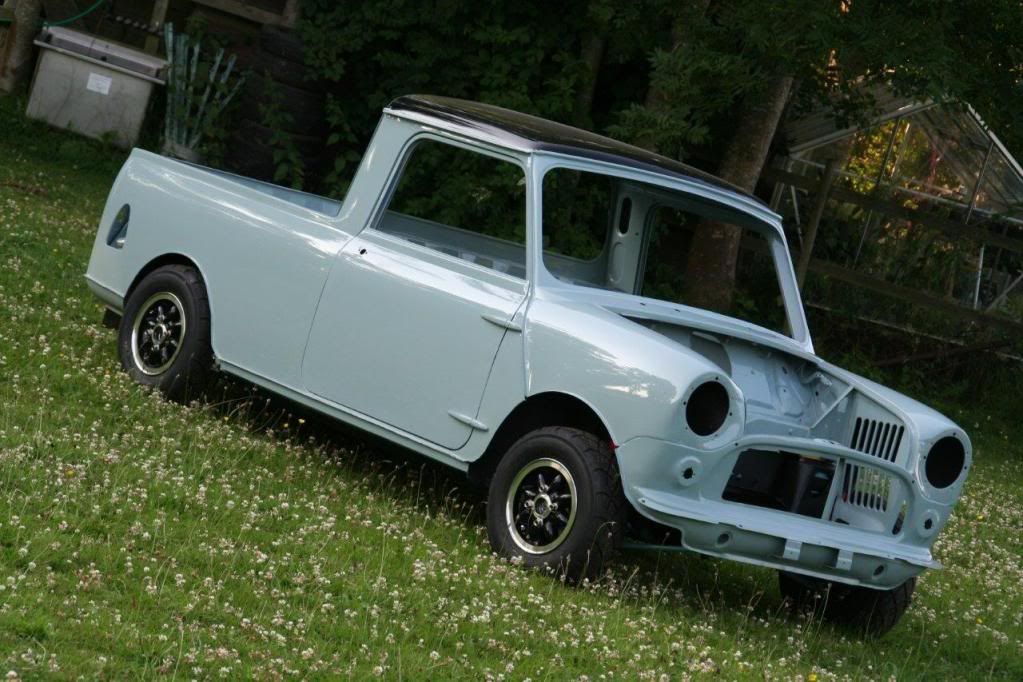

Then once all te rear suspension was back with my fuel tank on I then decided to put my new wheels on and check the ride height,
Hello negative camber ;-)

Front just needs it a lot of weight to reduce the ride height as the hi-lo's are pretty low ! Cannot wait until this is on the road, next stages looks and lines, brake lines, fuel lines fuel pump then loom in after some sneaky sneaky stuff ;-) should be fun !
