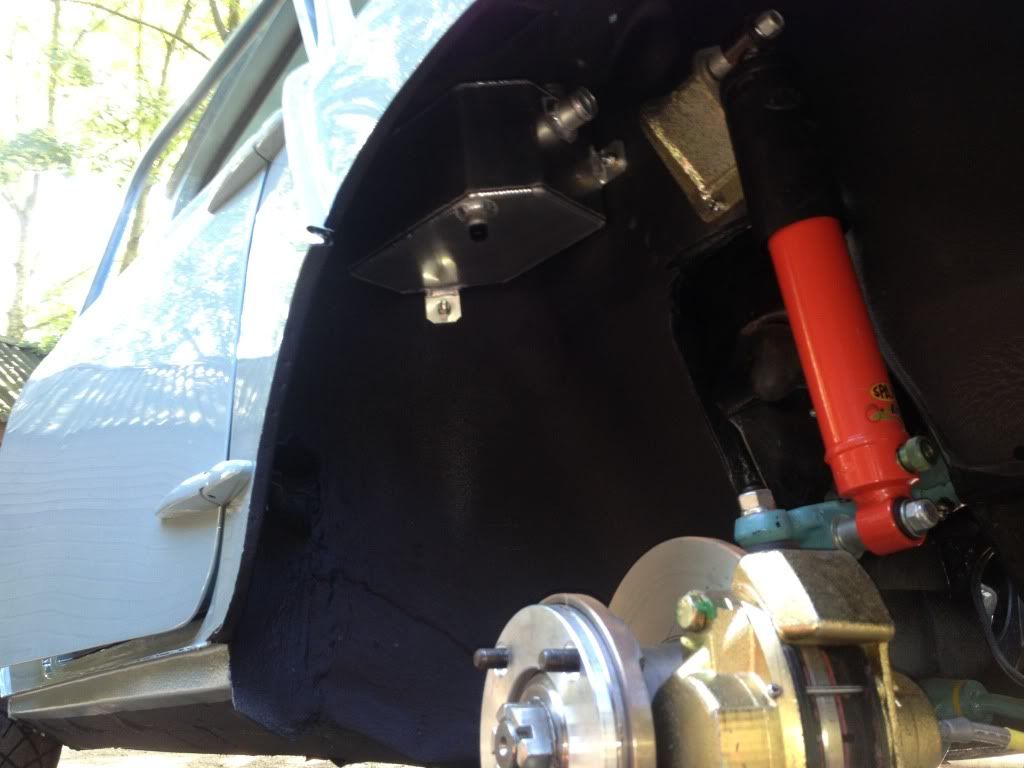

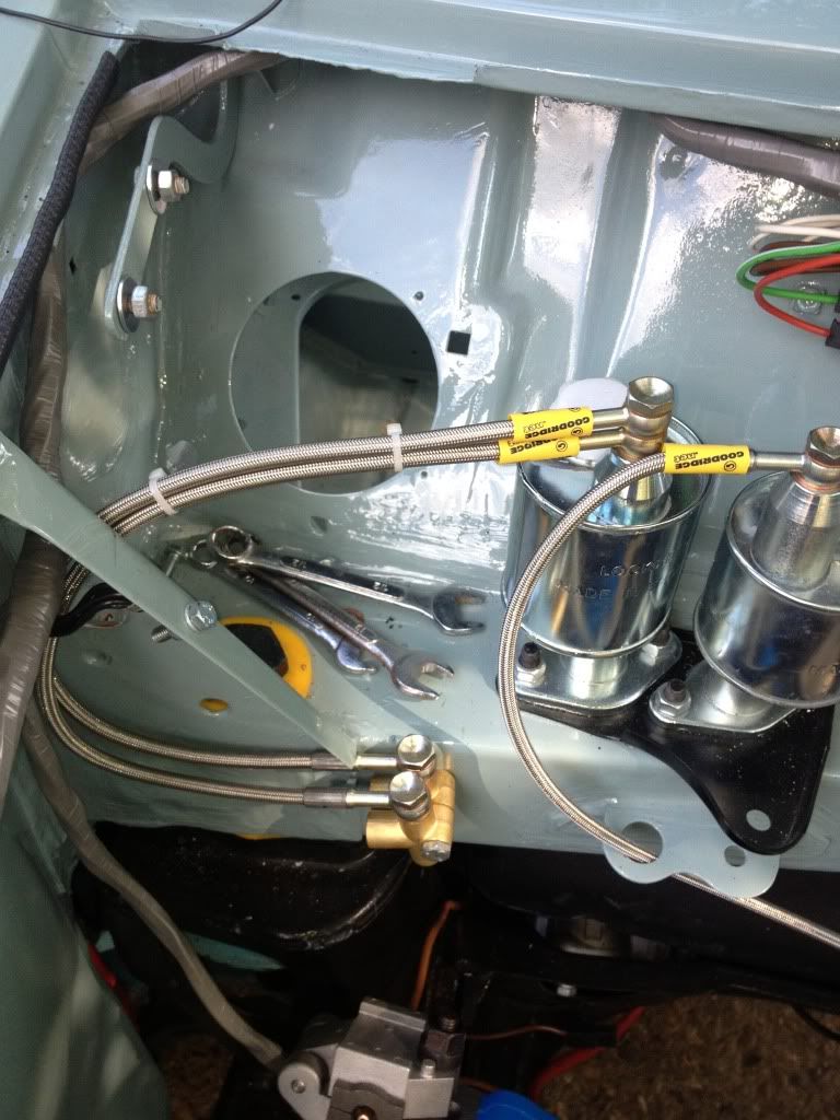

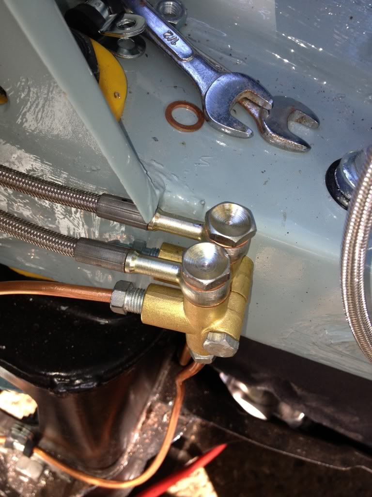

Finally figures out the double banjo setup too !
Woop woop will be bleeding soon,

Genuine question.....Whats the point in double banjo-ing the braking system ?

It's nothing major, just means I have a split front and rear straight out the master doesn't make to much of a difference also the rear is on a bias valve so less pressure to the rear than the front
So just something thats a little different and a little more expensive ? :lol:  bet Goodridge love you twice as much as other customers ;D
#202 crazirob
crazirob
  • 650 posts
Posted 30 August 2013 - 05:44 AM
Exactly ! But it looks the nuts when everything is clear ! Lol and yeh bit different bit more expensive ! Lol
#203 crazirob
crazirob
  • 650 posts
Posted 30 August 2013 - 02:22 PM
3 times as much aswell there clutch hoses ! Lol and I have 3 then full braided flexi lines too !

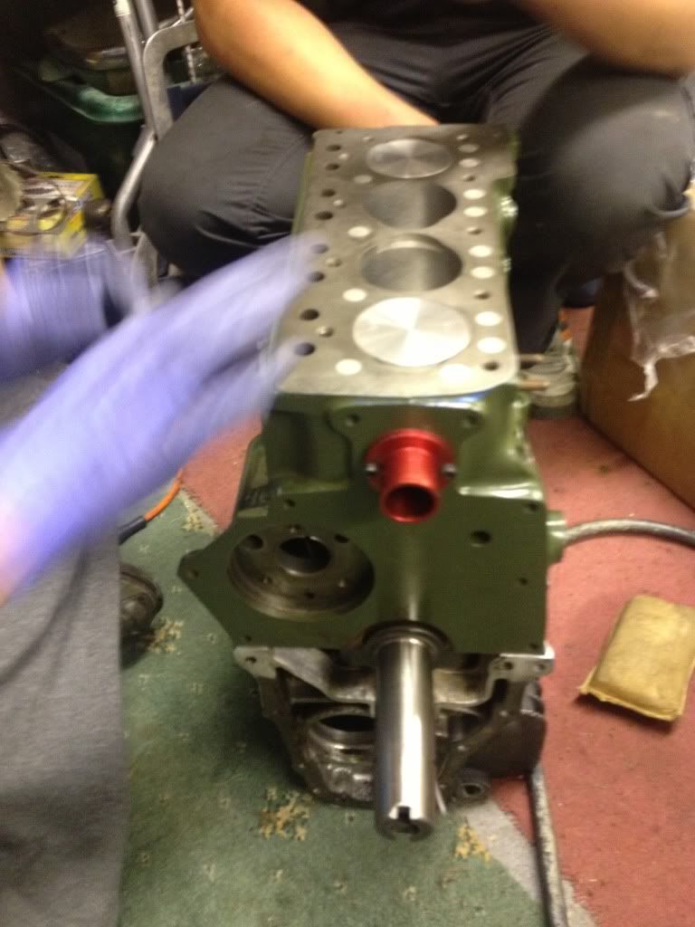

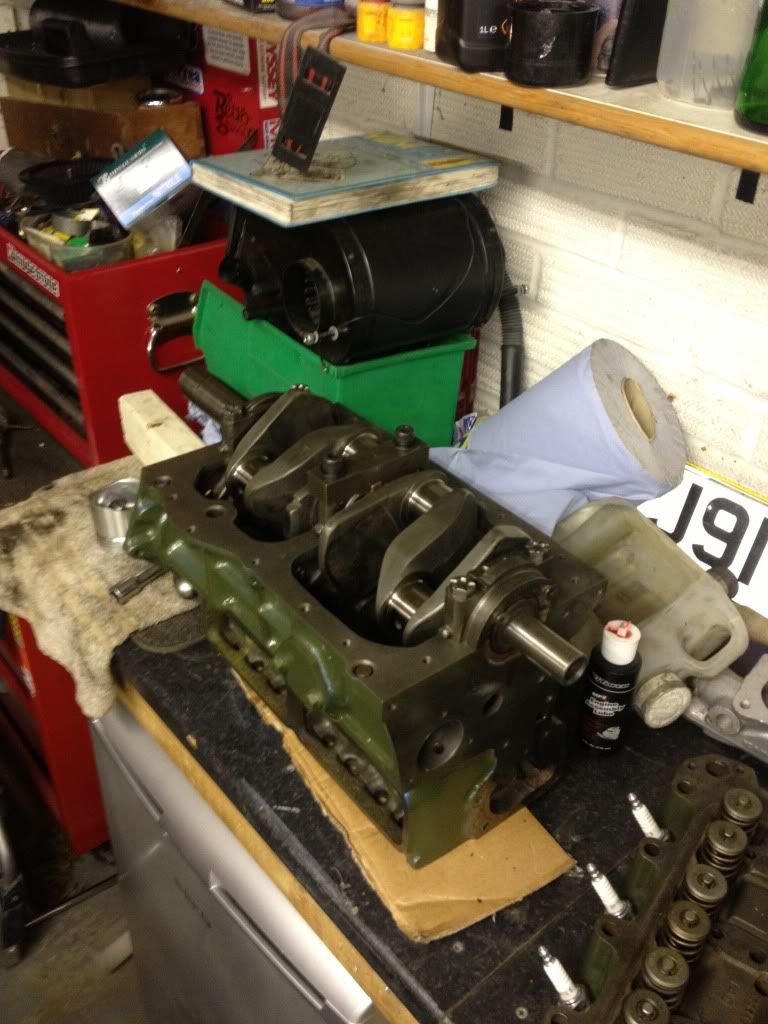

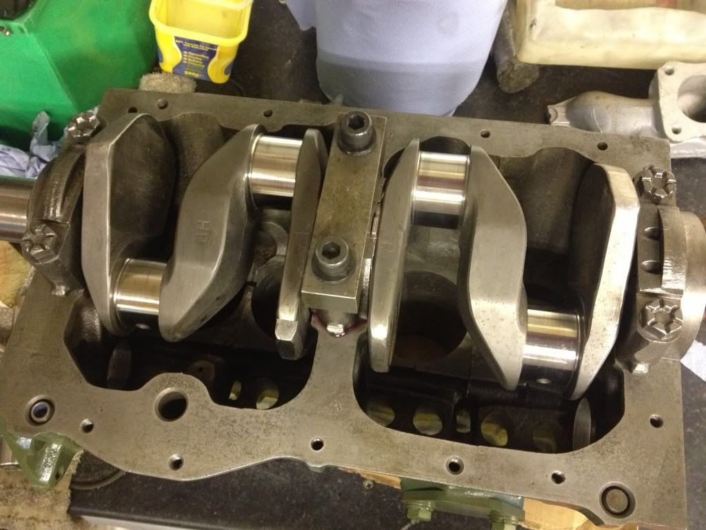

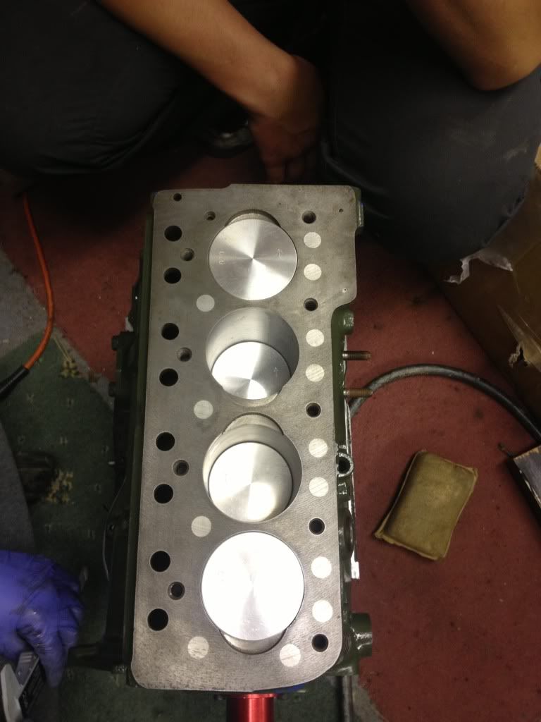

So Monday day I go shopping, get a call from Dom my cousin (minikenning on here) who builds race engines and cars for a living, and told me we needed to get the can in and done so we could check the deck height of the block and pistons so that way on Saturday it's wagons roll on the engine being finished, so we went down and met a. Few problems, firstly there were 2 types of conrods, which is ok as I worked out 1 part number for cylinders 1/3 and the other 2/4,
Once the pistons we on the rods we then placed in the crank bearings etc and check the float, which came to 2thou which is nice, then we check deck height cylinder 1/2/3 spot on 4 we though was just over flush, after much measuring it was decided that it was flush just bloody close ! So it was taken apart and rest for the build on Saturday!

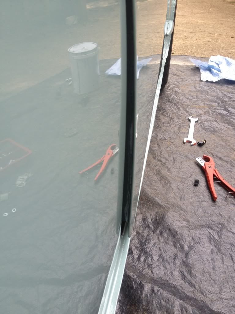

Yesterday I started on fitting the doors locks and handles and didn't have much success, without seal my doors lined up perfectly, with tem it puts a twist in the door, which I was not impressed about, I move the slam catch on the b pillar as far back as it can go and it got better then had to extend out the catch so I could located the door further into the car therefore bringing in the door,

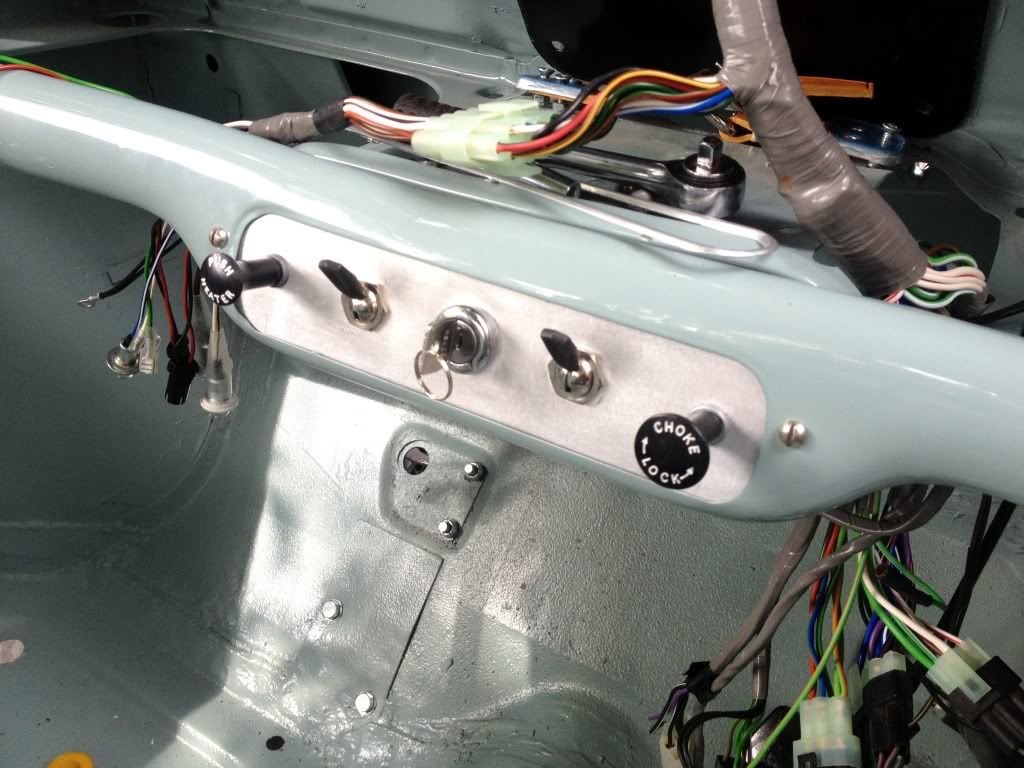

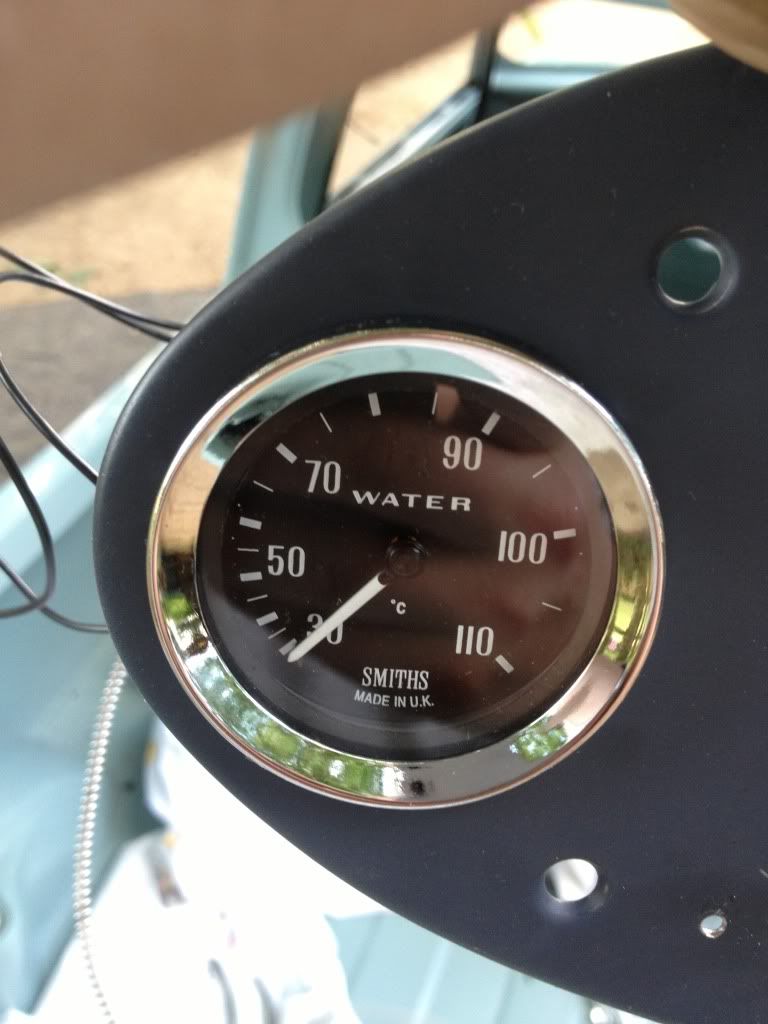

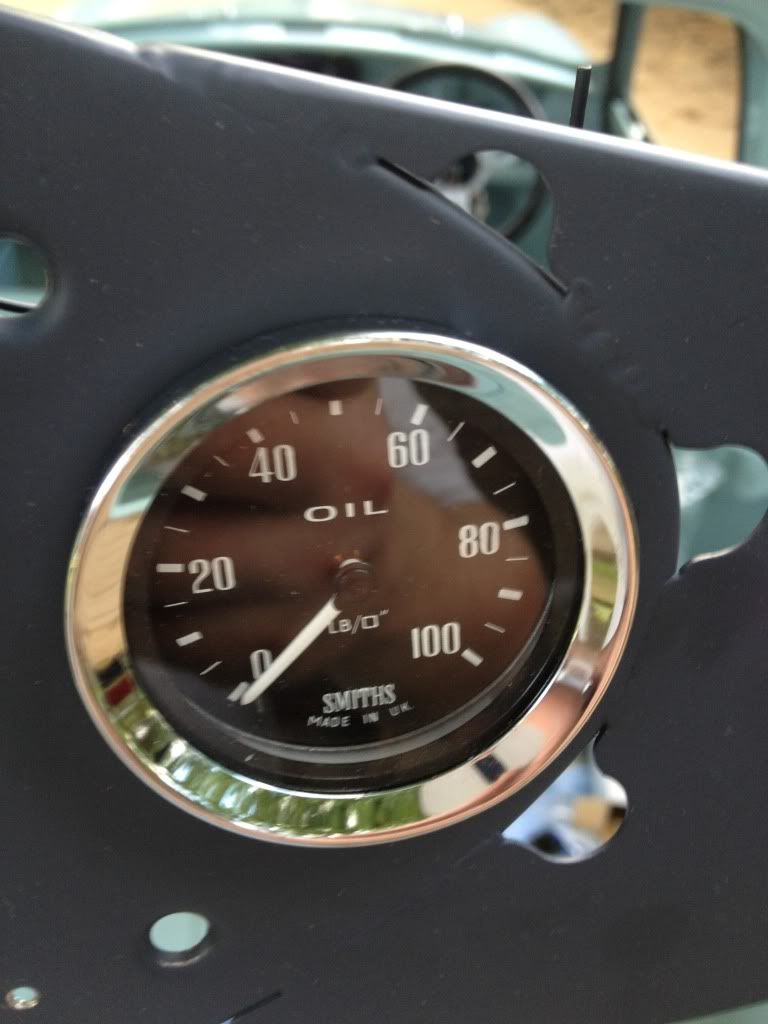

I finally got my switch panel sorted too! Will show some photos below but a busy 2 days and a busy 3 after Thursday too !

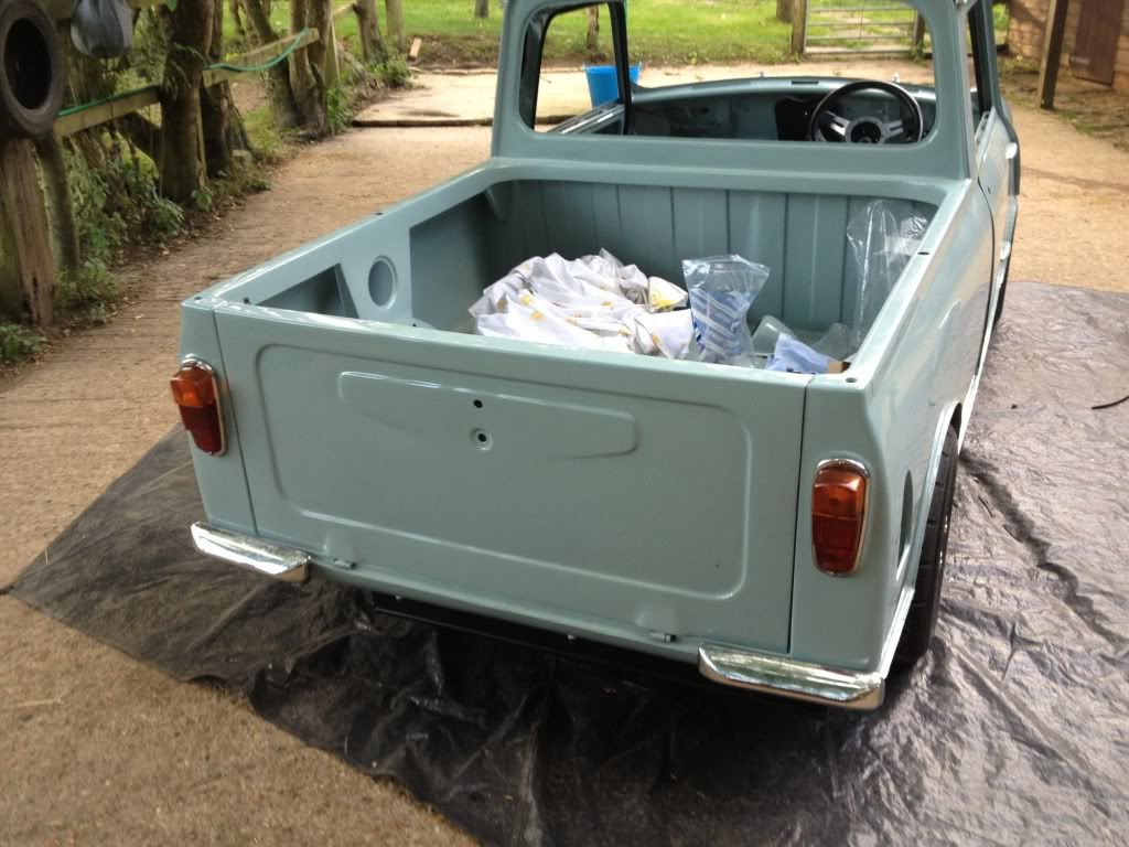

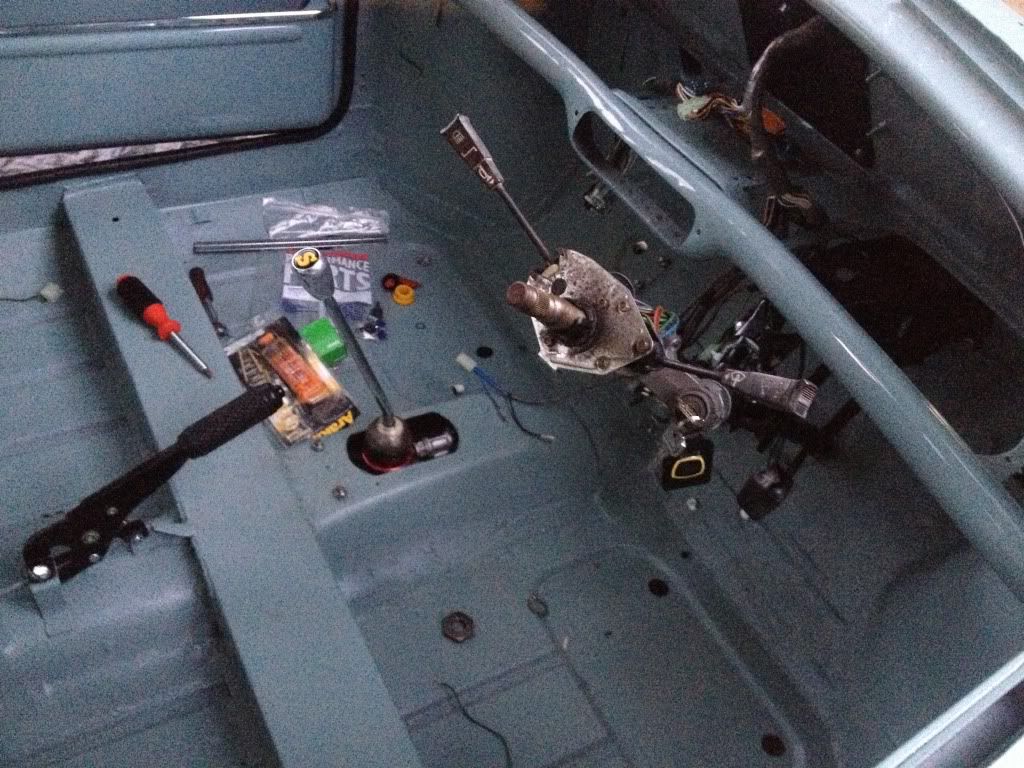

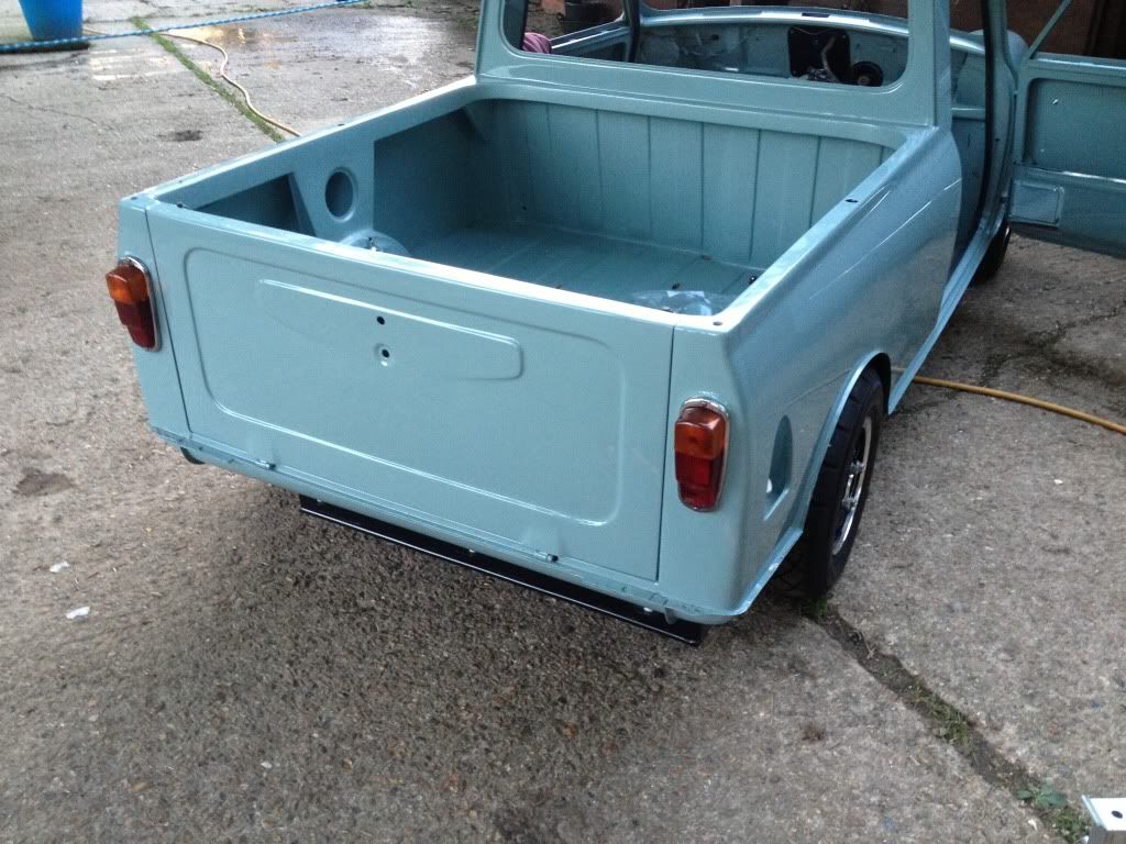

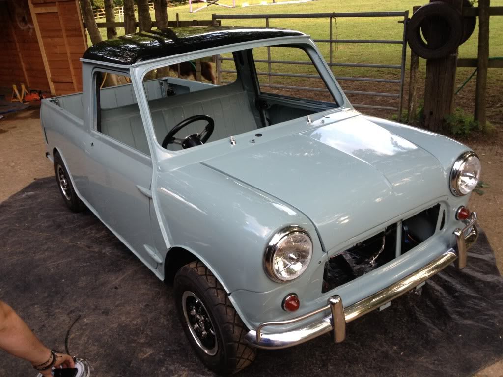

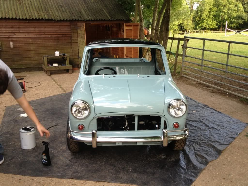

Switch panel all made up and in place,
Door gaps to start with !
With indicators bumper overrides new wiper boxes and chrome trim !
Bit of silicone here to stop leaking & rusting
New gauges ! woop!
That it for the time being the doors shut alot better but not perfectly in my eyes tempted to only use half te door seal but time will tell
This is a big update with bigger ones coming this weekend !
Robbie out !

How are you sorting the door gap?
