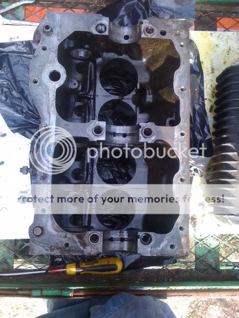

Got a free night and the puller i had orgianlly was too big. so i took your advice dan and amanged to get one from halfords and it worked a treat! i dont know what people complain about getting a fly wheel off, althoug it did go bang and fly off.......... but thats not the point :)
So i got the flywheel off pretty easily just put a scaffolding pole through the puller and had a big bar to turn !
This is how far it flew with a big heavy pole on it, would even like to know how far it could have gone. :)
so once this was done the structured destruction of the engine was continued :gimme:
so anyway once i was half way round my cousin comes over and i find ou that the flywheel that i have removed is the same as the one he has just brought ...... equals i have a lightened flywheel shamone!
Shiney :cry:
i had an old leak :turtle:
hmmm i wonder what is under here........ :wub:
oooo thats exciting a 276 kent cam ! :w00t:
what the head looked like :ermm:
Finally got the block and gear box seperate : :1eye:
I then removed all of the pistons and the crank
nice looking Gooey sump and gearbox
The block is now on my work bench so that i can start to get to work with cleaning it all up ready for either honing or going up a bore size..... but what to do ! Help me

otherwise i have checked the pistons and there is no were on them, or on the cam, what i am unsure of is either honing the block and keeping it as a +40 or wether i go the whole hog and +60, the block has been quote for valve pockets as i am intending to stick a 1275 head on the 998 block,
so what im a trying to say is will it be worth going to a +60 or trying to keep to +40
what performance roughly would i get from a +40 & a +60 ?
