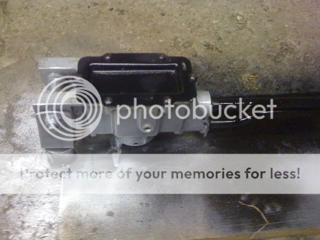

Afternoon ladies and gents after a loverly day at L2B i felt a BOOST of enthusiasum, so i left my house and walked down my garden to my workshop, and aimed to get as much done as my body would allow me, this resulted in being down there from 11m to 9.30pm with the occasional wee & coffee break i maangeed to get far more done than i antisapated :D
firstly i painted my flange as they had started to surface rust once again, so i sorted those out by wire wheeling them and then painting them, i then put them on my nice new shiney shiney discs :P
the i thought to go with my discs i would find my calipers and paint them so i found them cleaned and painted them
nice and yellow to go with the polys and the speedwell theme :D im gettin abit obbsessed about colour
i then decided to attack my gearbox i cleared out all the guck and nasty horrible oil and made it nice and clean, once this was done i clean the outter parts ready for painting :D
once i had done this i made a mock up of what the engine was going o look like, so all the major 3 parts together
and i came up with this :)
