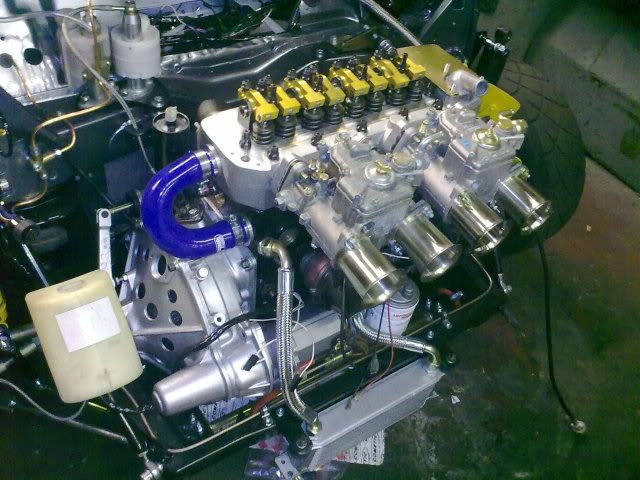

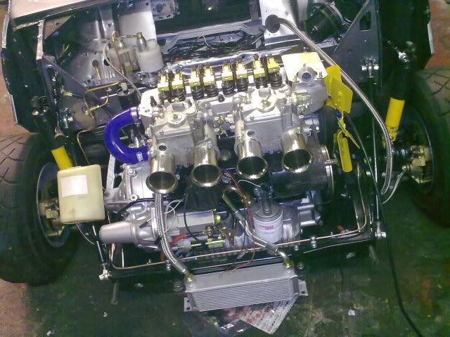

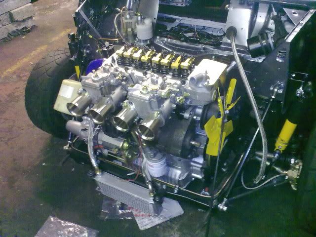

Here's an update on behalf of Sam.
I'll upload the pictures and let him explain all the details! :thumbsup:

wow very nice. could i ask who build the bottom end of the engine?
cheers

Looks great, what cam is in it?

And what filtration are you adding? Or none at all :s.
Is there any chance you could get some pictures of the clearance between the bonnet and the ram pipes (i want to do a 7 port build but not sure how much shrouding would occur over the air filters).

is there room for a rad with that brace bar?

The engine was built by Slark Race Engineering
The ram pipes will stick out of the bonnet, which is yet to be cut, painted & fitted. Wings will have to go on 1st.
And... the rad does fit, these brace bars were on the car when the old 1275 was in it.
Edited by mini-man-dan, 12 May 2010 - 05:46 PM.

the engine is
1380 cc with omega pistons 7cc dish
en40b steel crank,cross drilled nitroided ectect
steel rods with been shot peend and stress relived
the block stress relived and drilled out 5/16 gearbox bolts 11 head studs drilled
centre main strap
all new acl bearings though out
arp bolt though out
new med flywheel,back plate,race clutch,s dynamic crank pulley
belt drive kit
296 billet cam
alloy 7 port with 37.5 inlets and 31 ex rimflow valves,double valve springs
med roller rockers
twin 45s
maniflow stage 3.5 exhaust manifold
aldon red dizzy
hi tourque starter motor
sccr box with 1.1 sc drops with semi straight cut lsd
5 kad rose jointed steady bars
and as for the anti roll bars,very easy to fit,can be done in situ,
