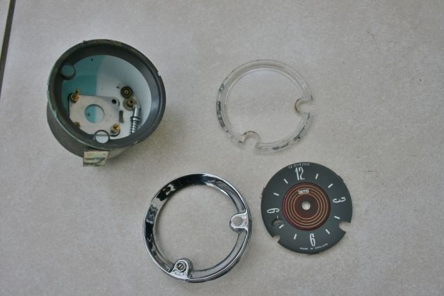

#780 grahama
grahama
  • 2,442 posts
  • Location: Warrington
Posted 16 February 2013 - 04:31 PM
Hi all,
thanks Phil, even though you couldn't help, will be working through the chart on the link on Monday, have posted in the tech section for HEEEELLLLLLP !!! lol.

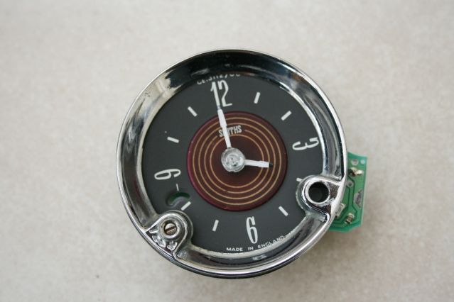

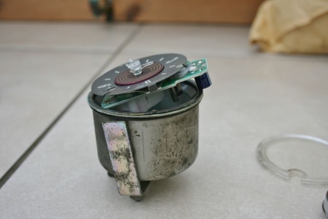

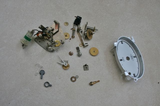

Not done much excepy buying off fleabay, a Smiths clock and oil pressure gauge to be precise. The clock was one I had been after for a while, 60's I think, but hard to get hold of.
I ttried to get it working but being clockwork and old it worked for 10 mins and then stopped, worked for a bit more then stopped. Not very good for accurate time keeping so I bought a mondeo dash clock and ended up with these left over.

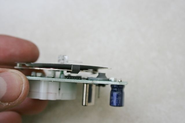

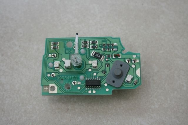

Now to get it all together, size wise not too bad but the circuit board is too big which will mean slotting the board into the original case.

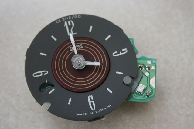

It's not far off but you get the idea and a rough mock up will see it look like this
Just got to do the metal work and silicone some bits in place. But it is accurate and should look pretty much identical when I have finished.
Finishing it is very much on the back burner till I get the engine to fire up, :shy:
Trying to keep motivated !!!
Graham
